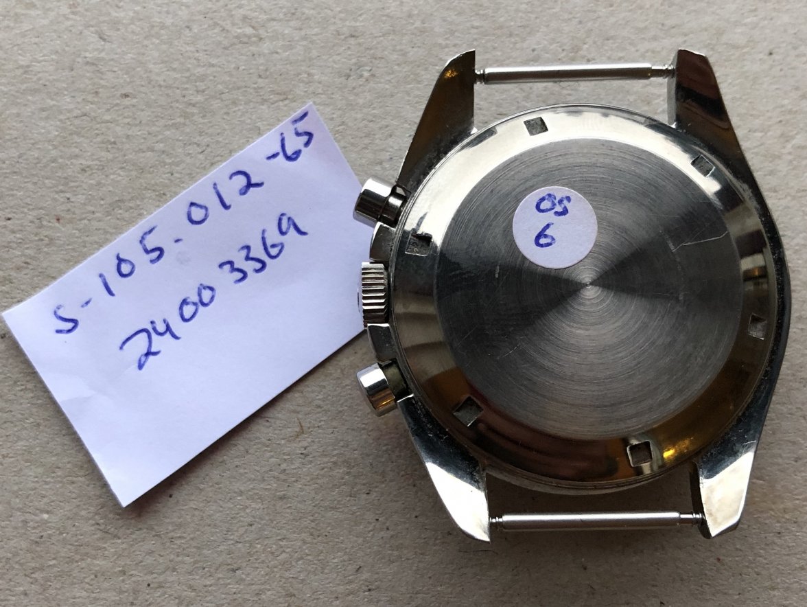

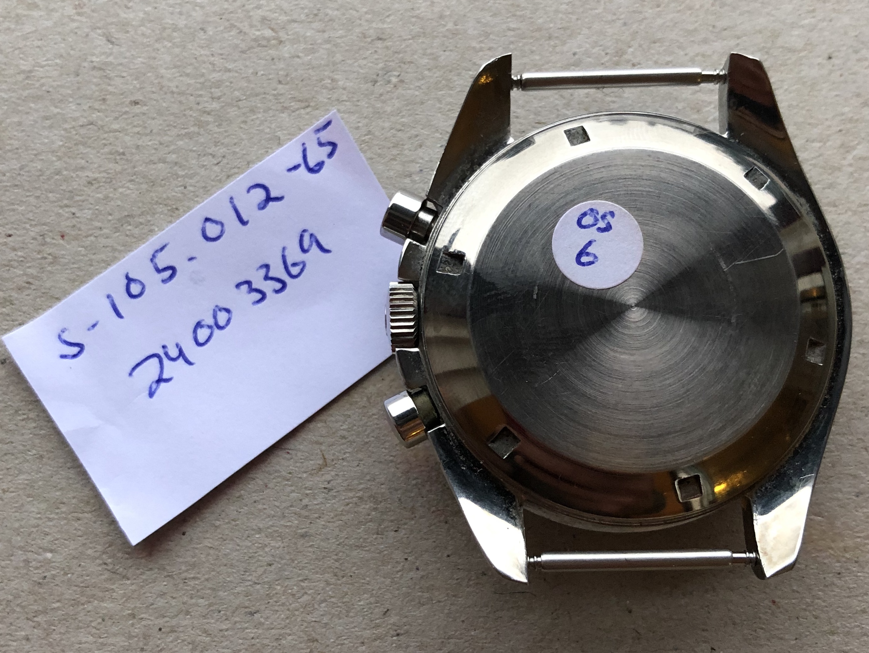

Hi guys

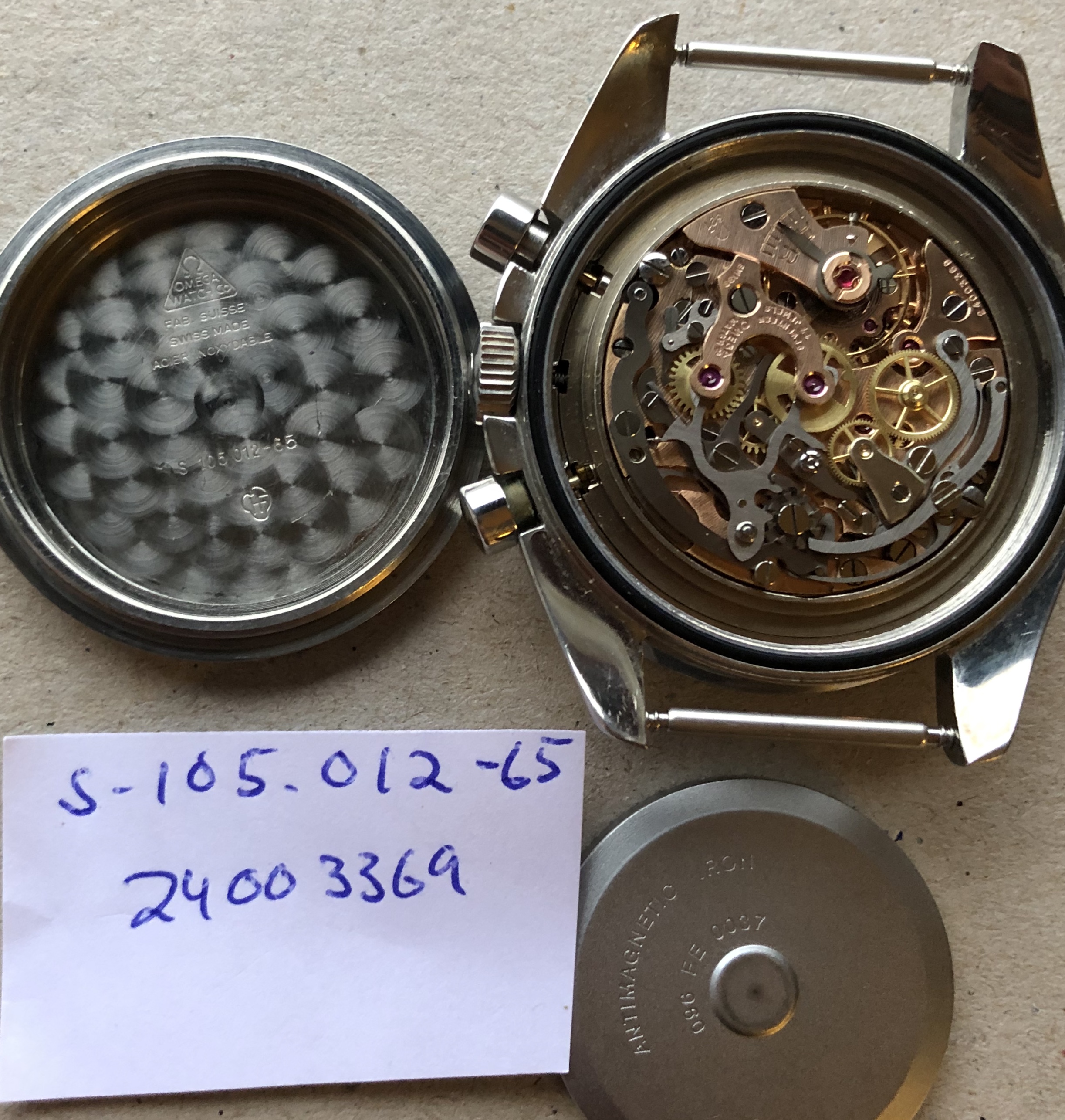

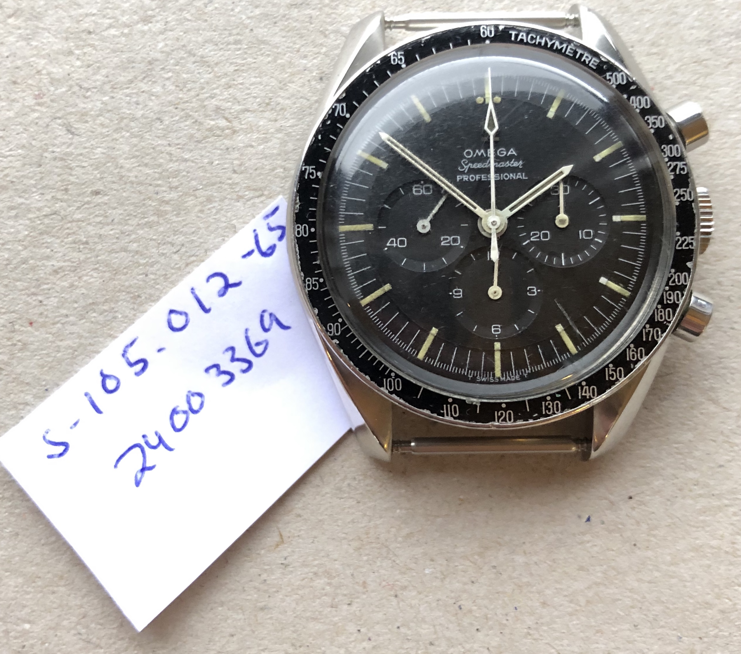

I have been through the “Moonwatch only” book, but found no answer to this. However - there is a thread by @kov where the blank caseback is discussed, but no clear answer.

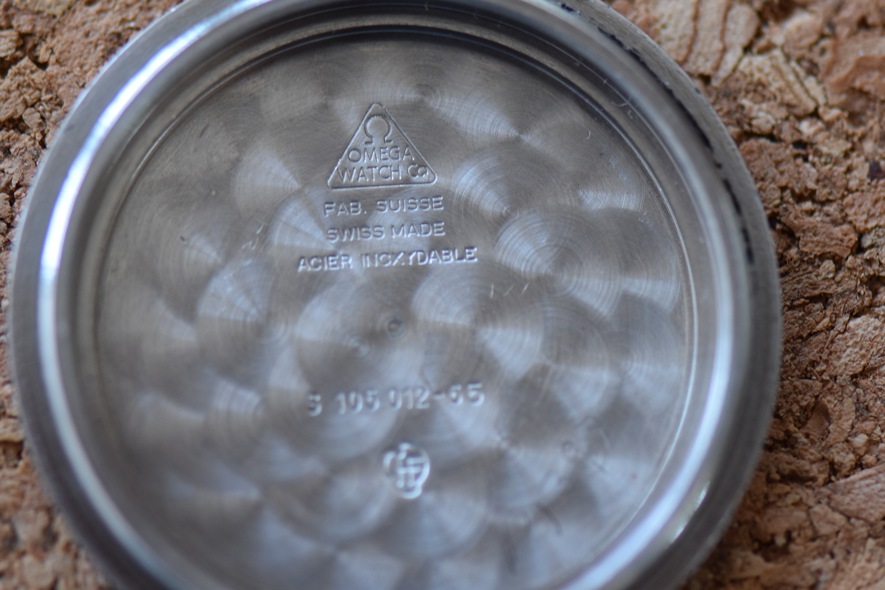

I have several 105.012, one of them has S 105 012 on the caseback. Also with a rounded side (no double bevels) and no inscription/ seahorse. Does the “S” means this is a service part?
Serial number is 24003369 (close to the flown watches)
Please see pictures above .
Thanks!

It looks to me that this caseback has just been heavily polished so much that the 2nd bevel has disappeared.
Now there are always exceptions we don't know (yet)

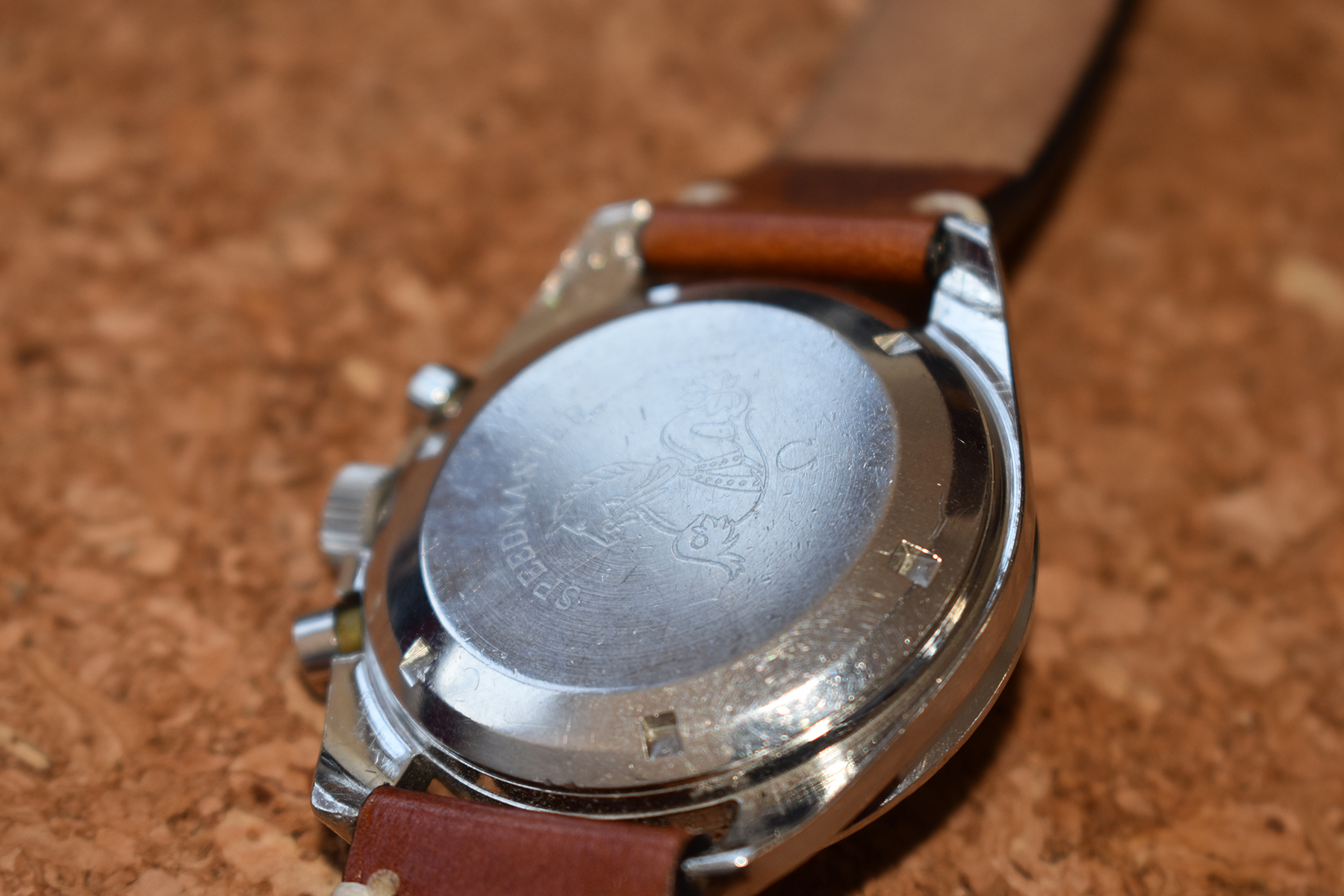

Here is a picture of my S 105.012-65 caseback with the seahorse and the double bevel (sorry for the bad pictures)

I agree that the most likely explanation is that the case-back has been scraped, i.e. turned down to refinish the surface. Consistent with this, the edge of the flat bottom surface appears to be quite close to some of the tool slots.

This is/was a double bevel caseback that has been polished. Maybe to get rid of some NASA engravings? 😉 Serial is indeed very close to the flown watches.... Hmmmm....
This didn't "Fall off a truck" headed to the Smithsonian now did it?

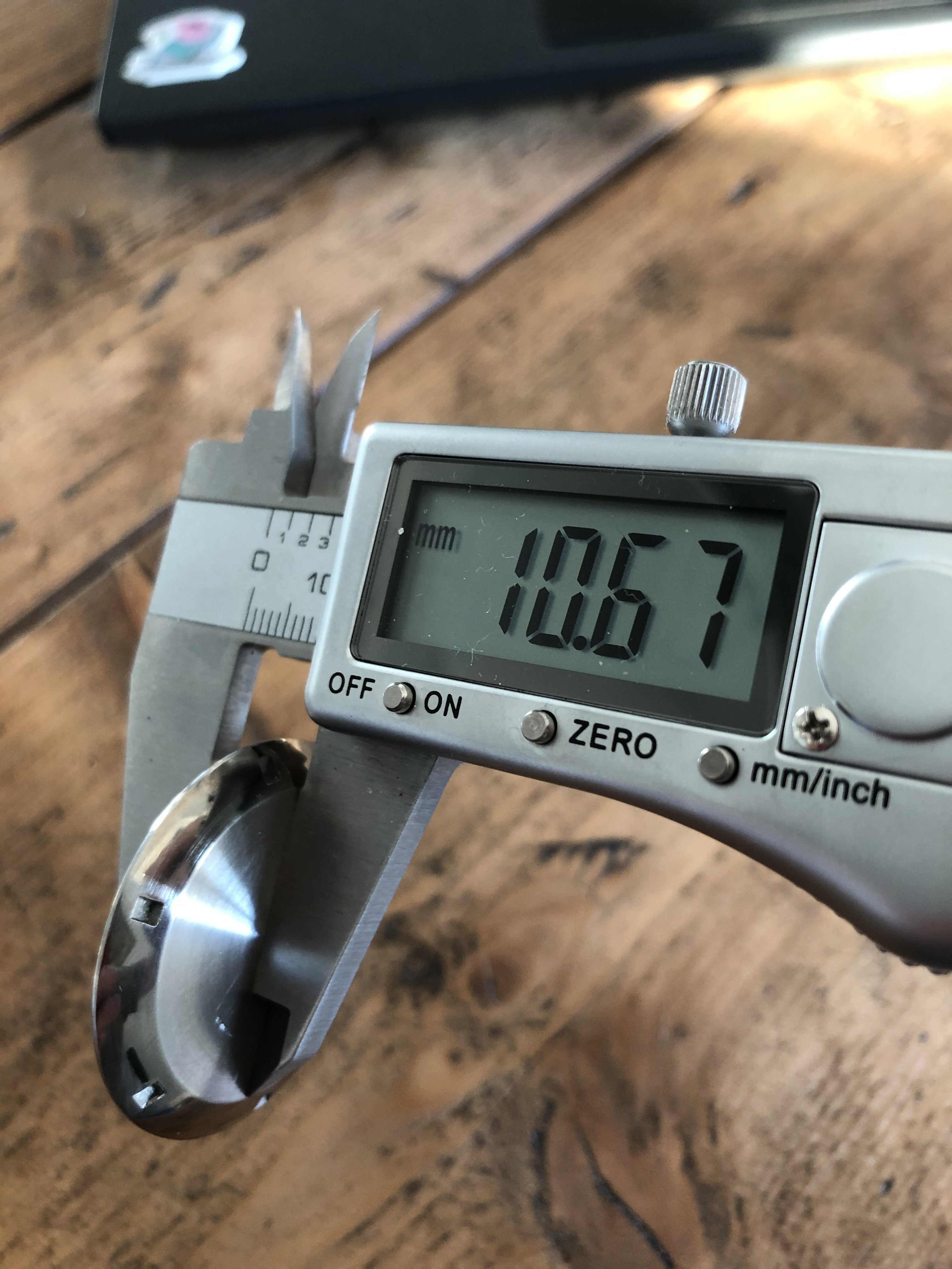

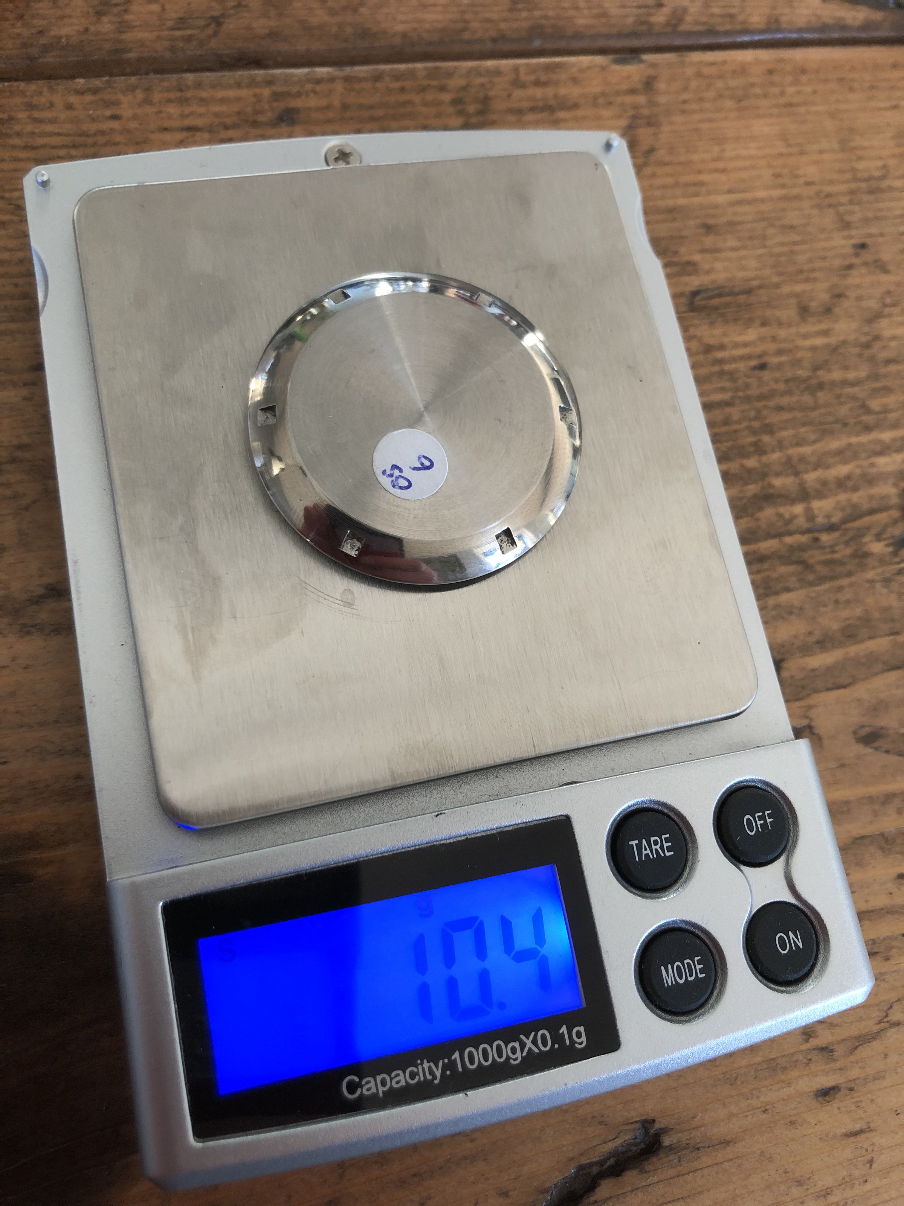

It would be interesting to measure the thickness of the flat, centre section of the caseback, with a micrometer, and compare with the best original caseback. Also compare the respective weights.
To my mind, this has the appearance of having been heavily refinished on a lathe.

The case back had a clear step but now nearly gone due to polishing. My guess would be that it probably had an inscription that someone did not like to keep so it was removed on a lathe.

The only annoying thing about this post is that I did't come up with this briliant idea myself. So simple, so smart and so easy! Thanks @TomGW !

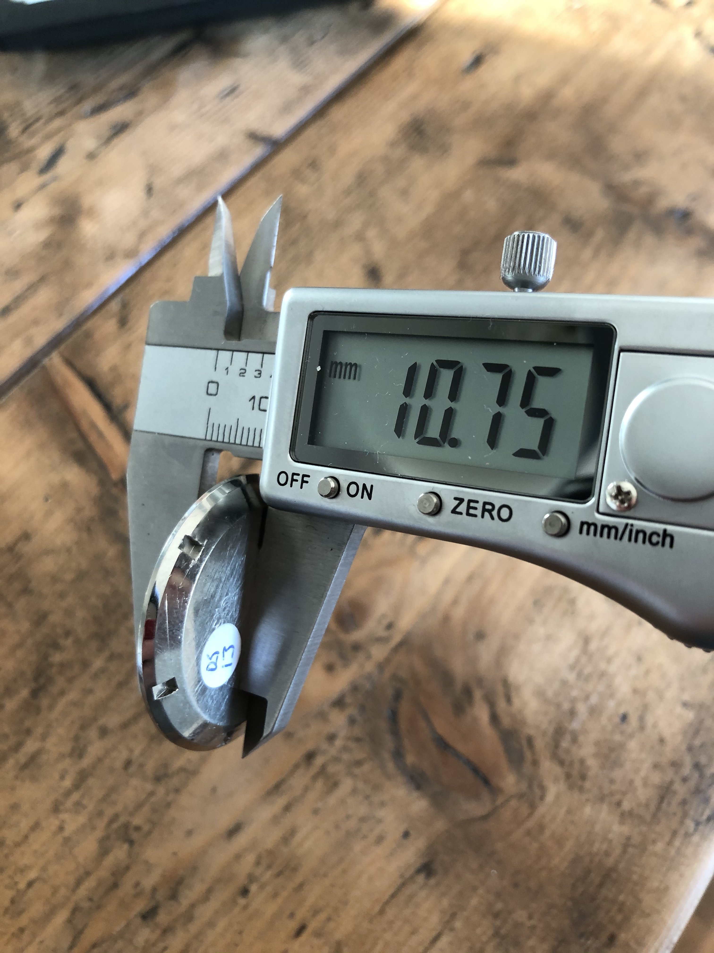

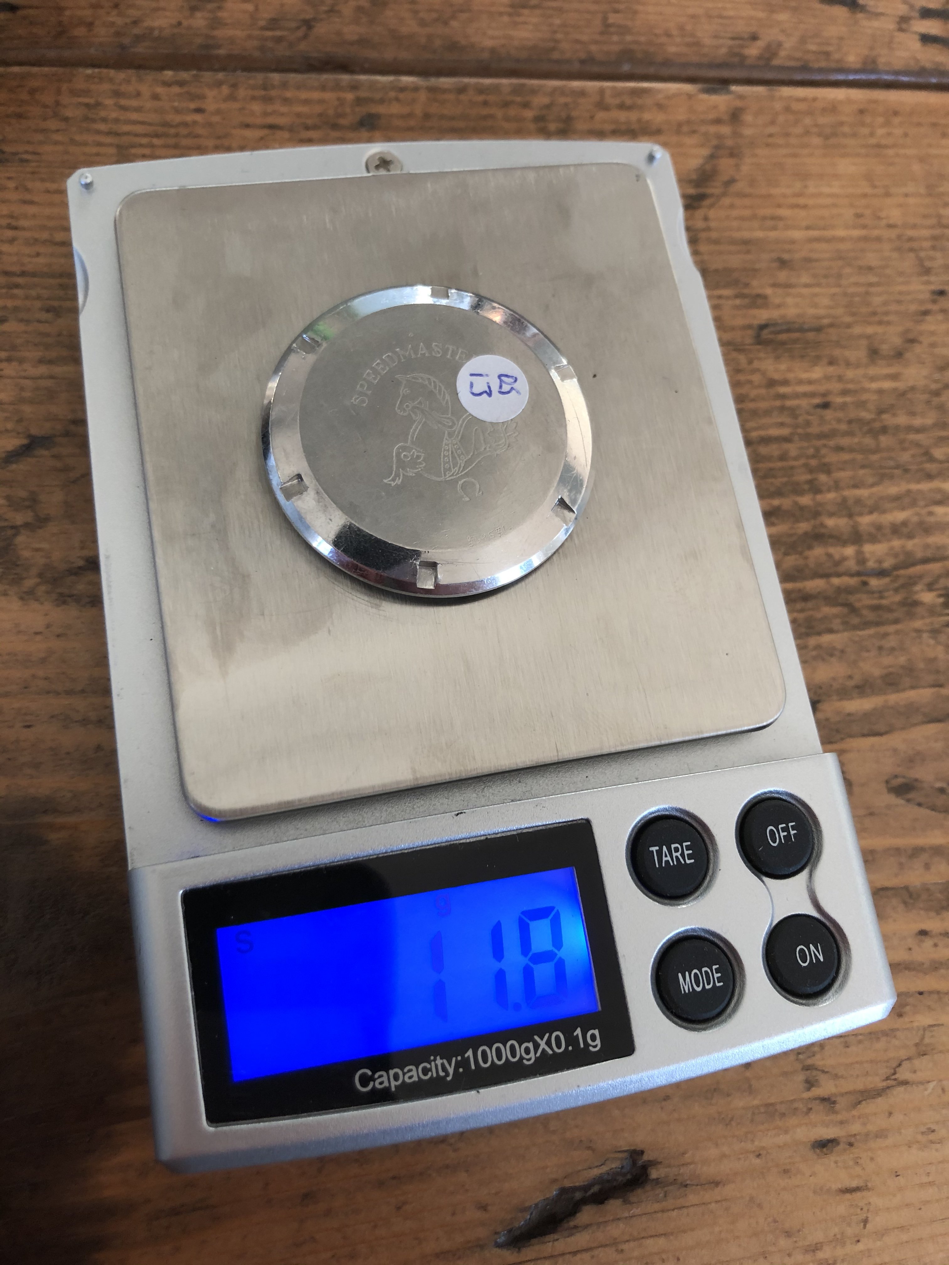

Here are the results:
Thickness:
To measure the thickness, I used a "spacer" to be able to measure the center of the caseback. The "spacer is about 9,9 mm. The "blank" one measures 10,67 mm, and the "ordinary one" measures 10,75 mm. The blank one is about 1/10 of a millimetre thinner.
Weight:
The blank caseback is 10,4 grams, the "ordinary one" is 11,8 grams. More than 1 gram heavier.
I think your theories about my caseback is polished/ machined down is correct.
Regarding the "NASA - theories", I'm awaiting the "extract of the archive" Will let you know - but don't sit up and wait.
Thanks for all you interest, and answers 😀
