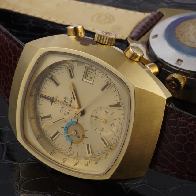

Well, apparently STS are unable to refurbish a Gold plated Omega watch from the 1970's. Solid gold is doable but not 20 microns plated Gold.
Can anyone suggest an alternative, bearing in mind that the Gold finish on some parts of the case is lapped.

Do you have a pic of the specific watch?
I've seen this done to a good level by local goldsmiths. Maybe the lapping need to go to a separate entity, but I've actually seen people do this really well, as well.

This is a picture of the kind of watch. I don't have one of the actual piece. It's a mixture of brushed and polished.
I appreciate the info on the Canadian company and if it comes to it, they appear a good solution but, frankly, I'm surprised that an Omega service centre here in the UK isn't able to do the work.

I can second the Replateit recommendation. I have had two watch cases replated and a crown with great results. They can do four coats to get you to the 20 microns you are looking for. I am not sure if they can replate gold cap, but they answer questions pretty quickly

OPs case restoration would be a two step process, first it needs to be lapped and then re-plated. Finding someone to do both may be difficult.

Replateit do lapping, as per their website.

I am not sure they do. The problem is that you are decoupled from information from them from they receive the watch and until they return it. The small shops have shorter communication lines and may ask you about details on the way.

Thanks, yes, not many offer that. I have had a Seiko KS beautifully restored by Kamil Dunkowski in Poland (Search "Lapinist" on Instagram). Replateit is the only other casemaker I know of.
