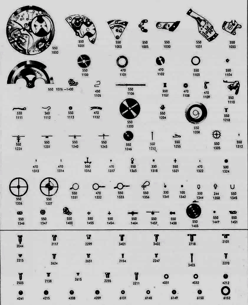

I was wondering if there were some charts for vintage spare parts available online?
For example, I’m going to have some crystals to change and I’d like to be certain of the references I need before ordering (one for a 2910, one for a 2938, etc).
Same thing with the hands, I need to source golden alpha lume hands for a 2937 but would like to make sure I get the correct ones (or A correct set as there are many variations on those vintage seamasters…)

The Bestfit catalogs are a good place to start. This will give references for common things like hands, stems, mainsprings and staffs. Ranfft also gives this but with the German indexes.
Most manufactures printed 'data sheets' These follow a set pattern usually with a picture of the eubosh then a disassembled view followed by an index of the parts in several languages. These can be found by diligent searches of the material house websites. There is not one place for all.
Sometimes one has to call or email the materials house.
There is some consistency to the number used for a given part. So a barrel bridge might be #105 a balance #1327. These can vary between the manufacturing groups.
Cases are a completely different story. These vary depending on export country. Often the movements were shipped uncased to avoid tarif laws. Crystals for the most part were sold by metric values of the diameter. Some companies like Omega used custom crystals.

For movement parts, search by maker/caliber, use watch supply houses who often have parts lists for cases (Cousins, Gleave, Boley Ofrie etc).
Crystals can also be found on the internet using your case reference.

You can find the dimensions of the holes in the hands in the ranfft database. The hands for 30t2 also fit 260 and 280 calibres. Hour hands of 26.5 and 30t2 could fit each other but minute hands not according to ranfft
Some parts have always the same number. For example the mainspring is 1208.
For plexi crystals without tension ring i would measure the crystal and order a generic one from cousins or similar place.

Yes, thanks for the help! From Ranfft, 26.5 and 30T2 are not inter-changeable sadly. But hands from a 267 should be! The hard part is that when I compare syringe hands from a suveran and from a 2639, they differ in thickness…Just how many different types did they make? 😲😁
I’m looking for suveran nos or almost nos hands…And a crystal too by the way, for which I cannot find the reference in any database…
