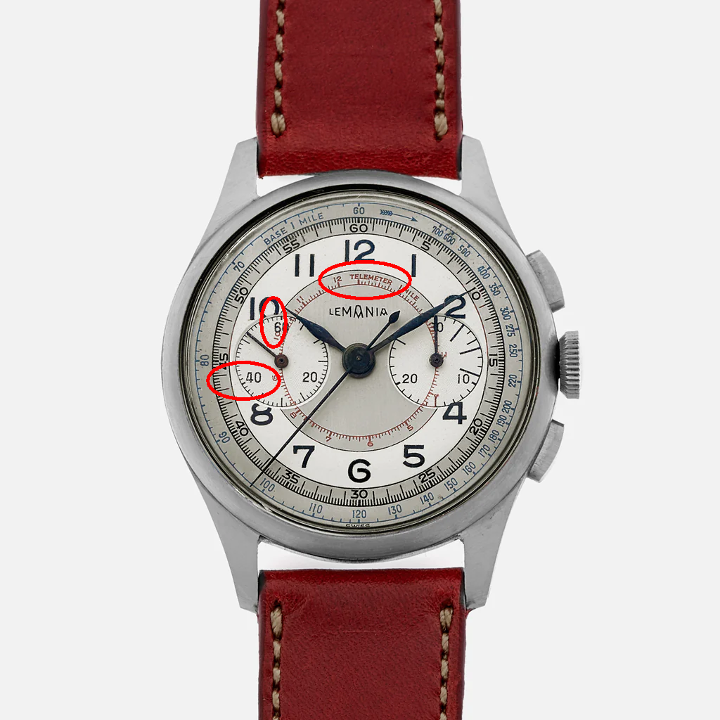

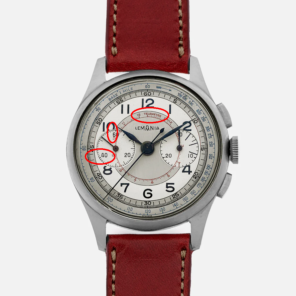

This watch was up for sale on Hodinkee some time ago.
(Picture borrowed from Hodinkee for reference).
"1950s Lemania Chronograph With Original Hang Tags":
https://shop.hodinkee.com/products/1950s-lemania-chronograph-with-tags-like-new-old-stock
From first observation a cool watch, and with some interesting hang-tags added.
My concern is the dial.
1) It looks freshly printed (always a concern for a 70+ year old watch for sale).
2) The print is VERY thick at points. Compare numbers on the minute track and sub dials to my example below.
3) The circular pattern on the sub-dials seems to be "missing". This would happen during a dial restoration.

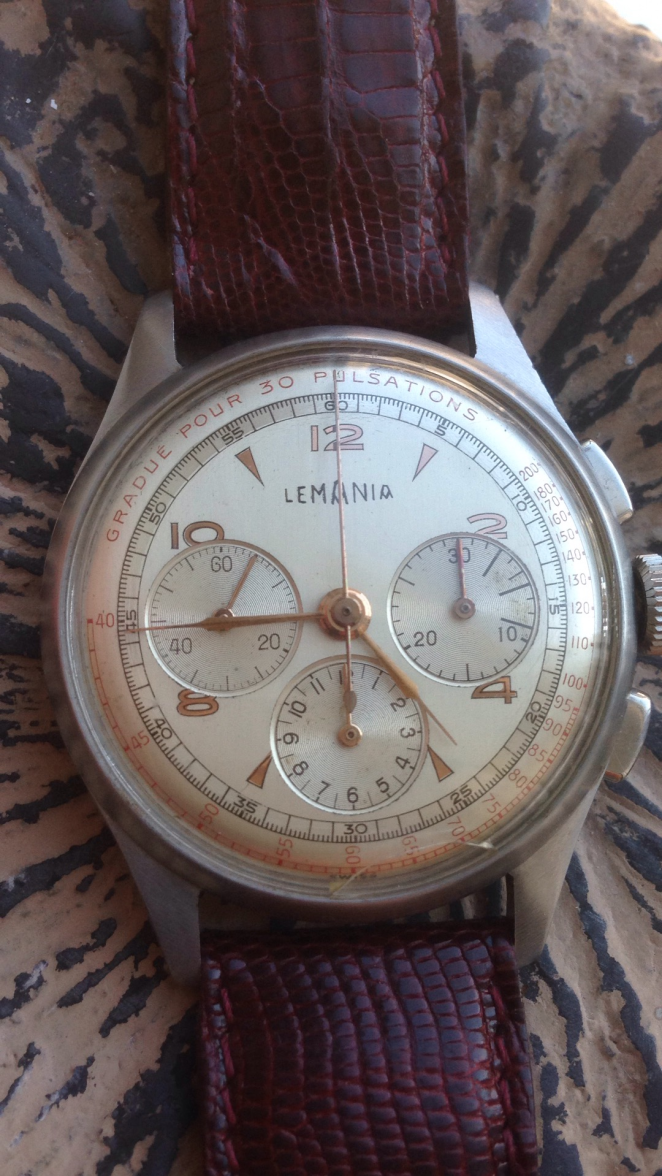

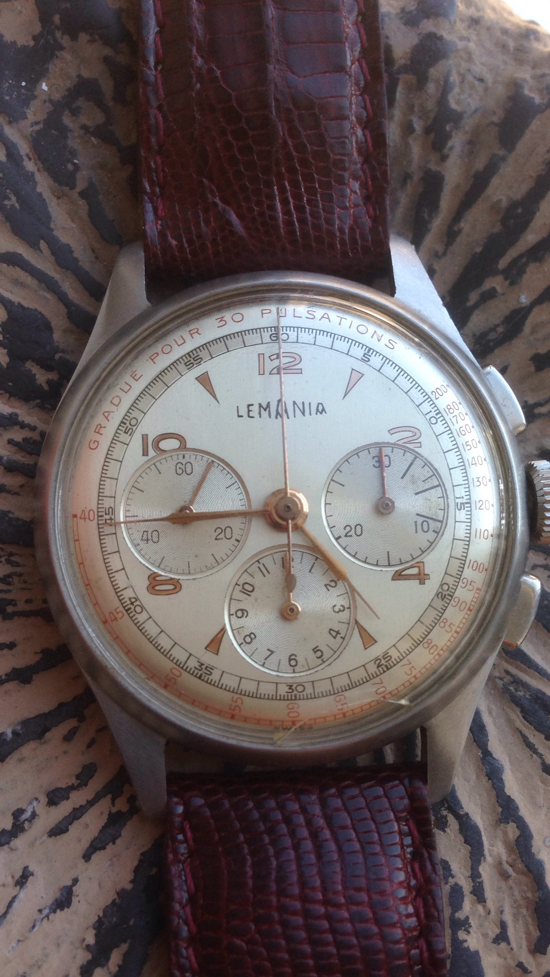

I have a watch, with the exact same case, and obviously as a result, is from the same period.
Mine has a different dial layout, and has a 3-register version of the CH27 movement, but this is not important for my concern.
If one compares the numerals and print, I am 90+ % certain that this dial is not NOS, but newly printed?
(My watch and picture. Currently undergoing service)

I am very close to certain it is a redial.

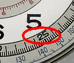

Especially the sub-dials lack of structure, and details like the 25-minute marker on the minute track almost smeared out to the inner ring looks very suspicios.
There are also other inconsistencies like:
1) The alignment of the word "Telemeter".

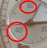

2) The print of the subdial numbers being "thick"/bold compared to contemporary versions.
3) The 6 (in 60 on left subdial) does not seem correct as Lemania seems to consequently have been using "coat-hanger" style 6 numeral.
