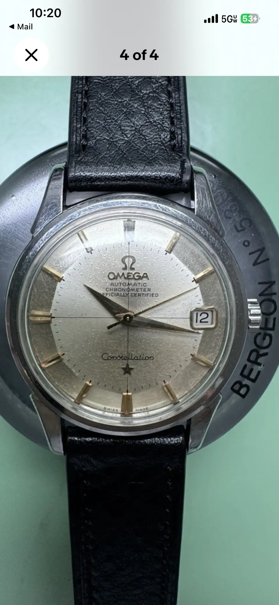

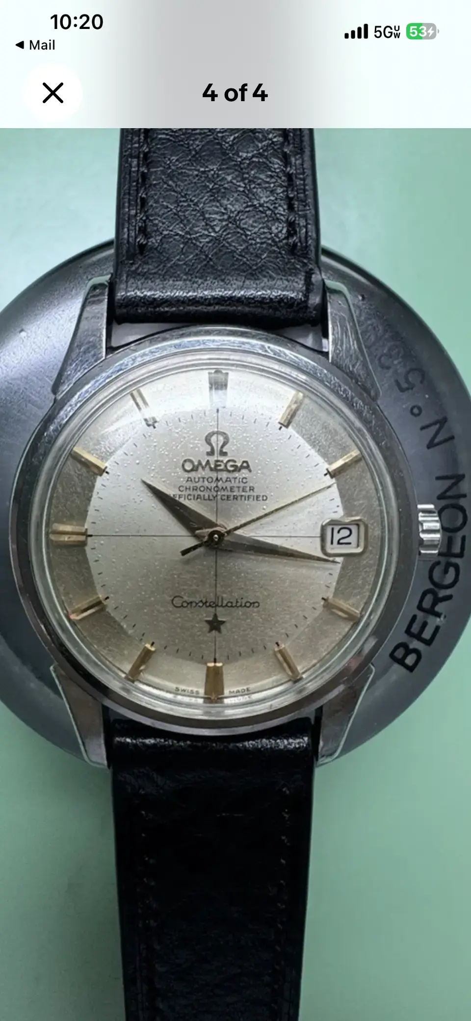

Posts 162 Likes 160 chrisinohio ·Jul 8, 2026 No pictures of the back, movement, or inside case back. Currently trying to see if seller can take some. I think it's an older redial, but I'm not 100% sure. Your thoughts? Chris
Posts 162 Likes 160 chrisinohio ·Jul 8, 2026 hoipolloi 99% of 14393 with officially certified are redial. There you go again with new information! This I also did not know. Thanks very much.
Posts 2,799 Likes 6,922 seekingseaquest ·Jul 8, 2026 Based on just this picture, the dial looks original to me. Crown is not.
Posts 6,893 Likes 55,043 noelekal ·Jul 8, 2026·Home For Wayward Watches Not tge greatest photograph, but it looks original to me.
Posts 6,635 Likes 10,246 Peemacgee ·Jul 8, 2026·Purrrr-veyor of luxury cat box loungers hoipolloi 99% of 14393 with officially certified are redial. But there are always exceptions to the rule. Very early and very late 14393/14381s can have the officially certified. Need much better pics but on what we can see, this one looks good to me too.
