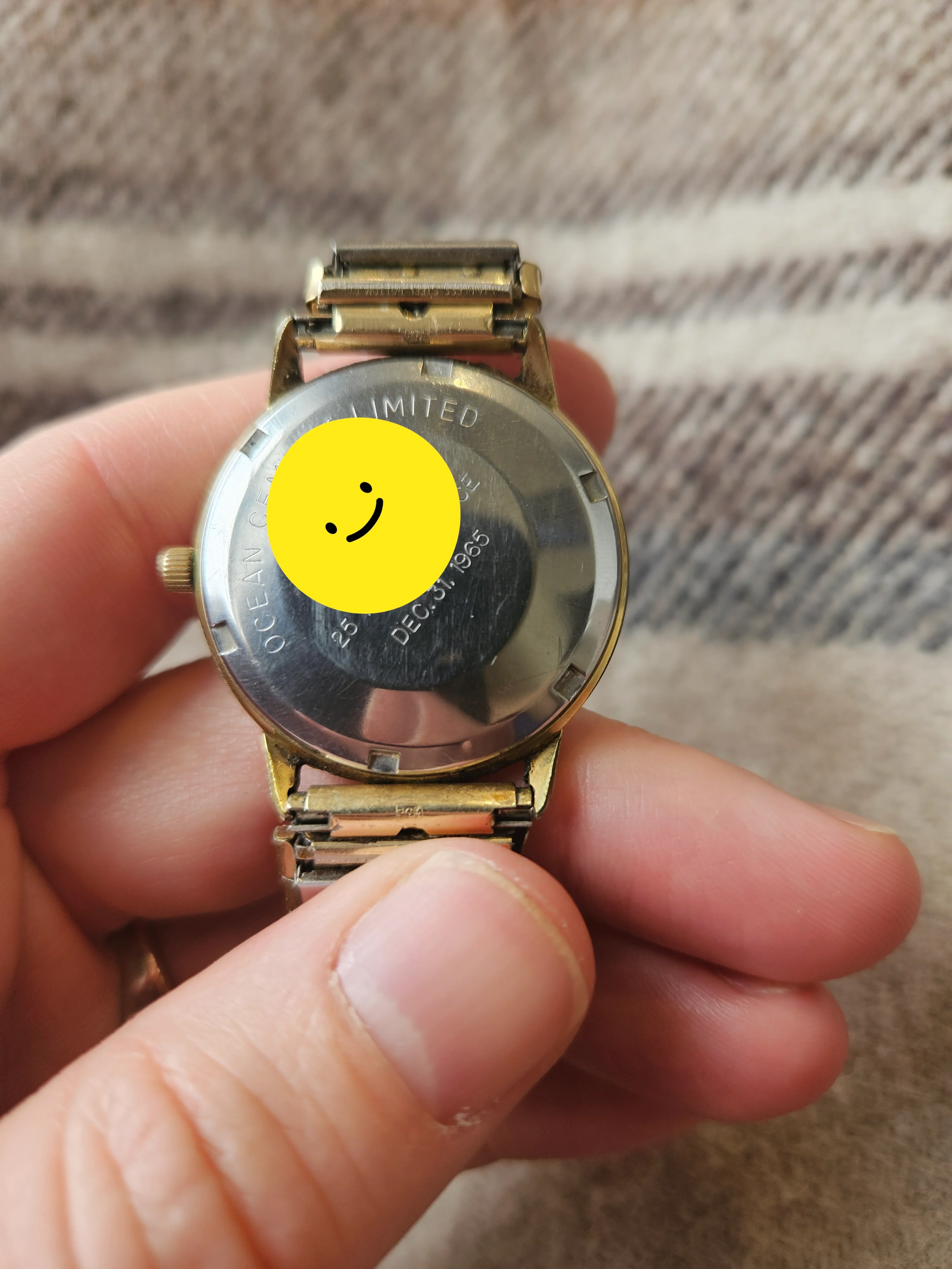

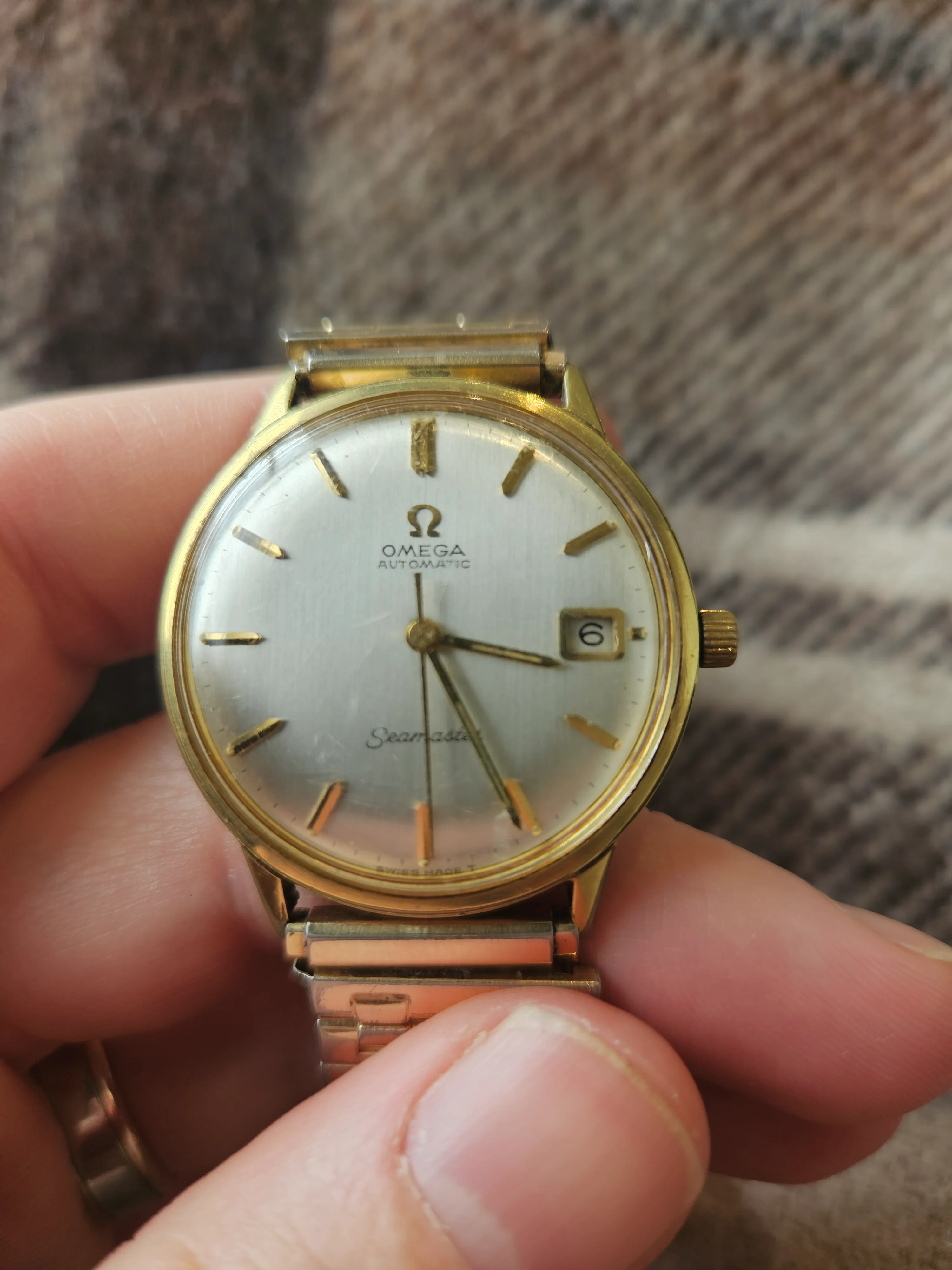

This watch was recently given to my by my wife's aunt. It was apparently a work gift for 25 years of service for a family member according to the inscription on the back.
It seems to run a little fast, but otherwise seems to be in great shape.
Just wondering if anyone can tell me more about it. Should I take it in for servicing?

Its a pretty run of the mill gold plated auto model from the 1960s as you suggest. Unfortunately that expanding bracelet has destroyed the inner faces of the lugs so I am afraid it will never be super valuable. It's up to you if you want to service it and get it working but it wont be money you will recoup if you choose to sell it down the line. If you are considering moving it on, do so as it is and let someone else take the pain!

Thanks for replying, I actually really like it - has character and it's a good addition to my collection so I'm not going to sell it.
I even like the beat up old Speidel band but now I'm worried about further damage to the lugs.
Also I'm curious how you could tell its gold plate and not gold filled given the sides of the base have maintained their integrity quite well (to my clearly inexpert eye anyway)

Yes the Speidel bracelet will continue to eat into the lugs as it is spring loaded at the lugs. Personally I'd put that on a leather strap. One way to mask some of the inner lug damage would be to fit a slightly oversized strap, ie a 19mm on 18mm lugs for instance as it would bunch up a little and fill/cover the damage.
In pretty much 100% of examples, a gold coloured watch with a steel back is gold plated, capped or filled, not solid. It is a requirement of hallmarking that solid pieces need to be fully solid. Of course it could have been modified with a steel back for inscription purposes but I doubt it. You do get mixed metal cases using solid gold and steel but not like this. More info will be found on the inner caseback inscription. It will be worth you removing the back with a non marking case removal ball to see what is written there.
I just realised you were asking about plated vs filled, I wrongly assumed you meant plated vs solid. It could be filled but it makes no real difference. Gold capping or filling is just a thicker layer vs plate and all 3 are treated similarly by the market with steel or solid gold usually being preferable. My money is still on plated for this. It's deffo not capped as the lug backs are gold coloured and the steel caseback suggests plate.

Thank you, learned a lot. Sucks about the lug damage from the Speidel, it's so easy to put on and take off and i like the look. I searched for a fixed lug width adjustable but they seem in general quite terrible.
