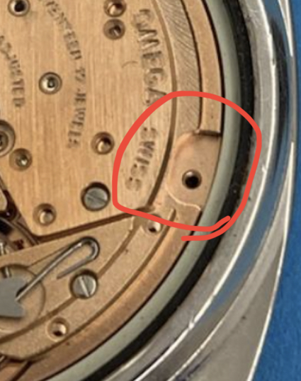

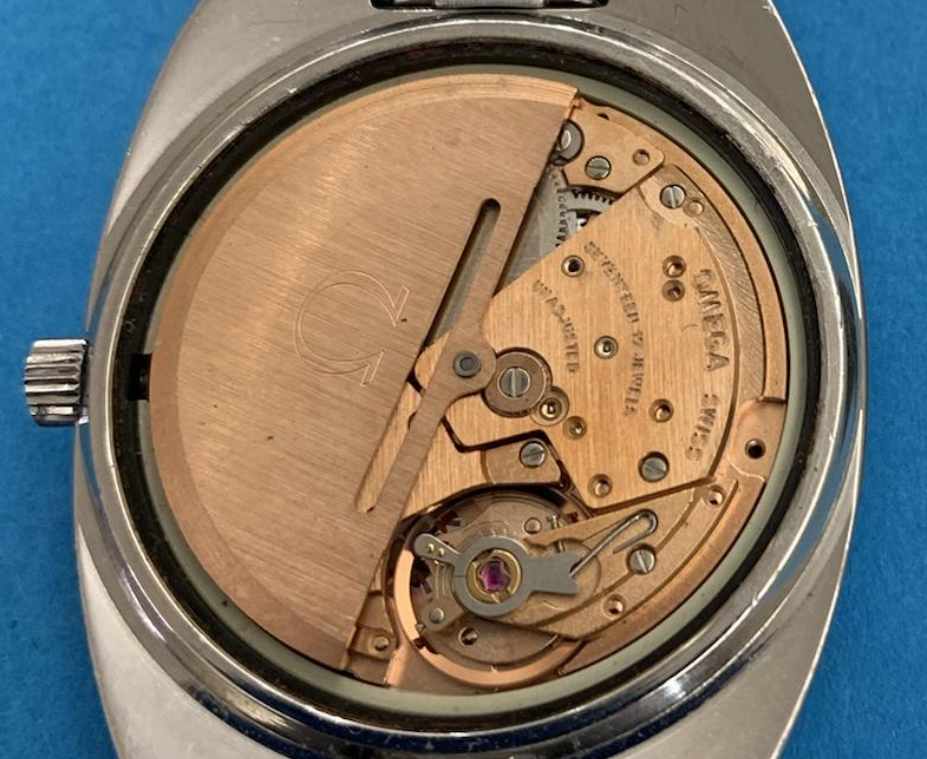

J Posts 1 Likes 0 JR Omega ·Jun 18, 2021 All, Seller communicated that the piece was recently serviced. Looking at the movement here, would you say that seems accurate?
Posts 35,766 Likes 40,042 dsio ·Jun 18, 2021·Ash @ ΩF I’d ask for an invoice and see if the watchmaker that billed him is known to be any good
Posts 152 Likes 151 JohnWoo ·Jun 18, 2021 Needs an independent watchmaker to check if lubricated, and timings.
Posts 2,710 Likes 48,963 Alex Cheers ·Jun 18, 2021·Go!!! Take a look here: https://omegaforums.net/threads/when-the-numbers-lie-omega-speedmaster-caliber-861.133086/ That is very educating how much you can judge the movement by just this one picture. And welcome to OF
Posts 2,442 Likes 4,232 wsfarrell ·Jun 18, 2021 MtV Shouldn’t there be a movement clamp here? Good catch. That's a pretty good sign it was NOT serviced recently.
