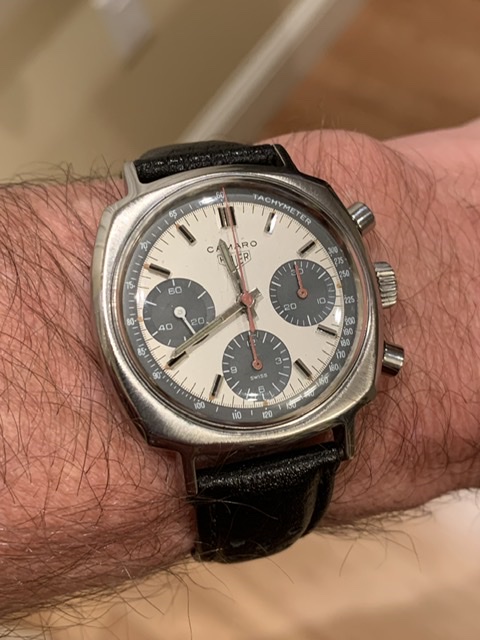

Such great feedback, didn’t reply directly to everyone but appreciate your comments.
Here’s the beauty that has me contemplating proactive service even though running nicely.
