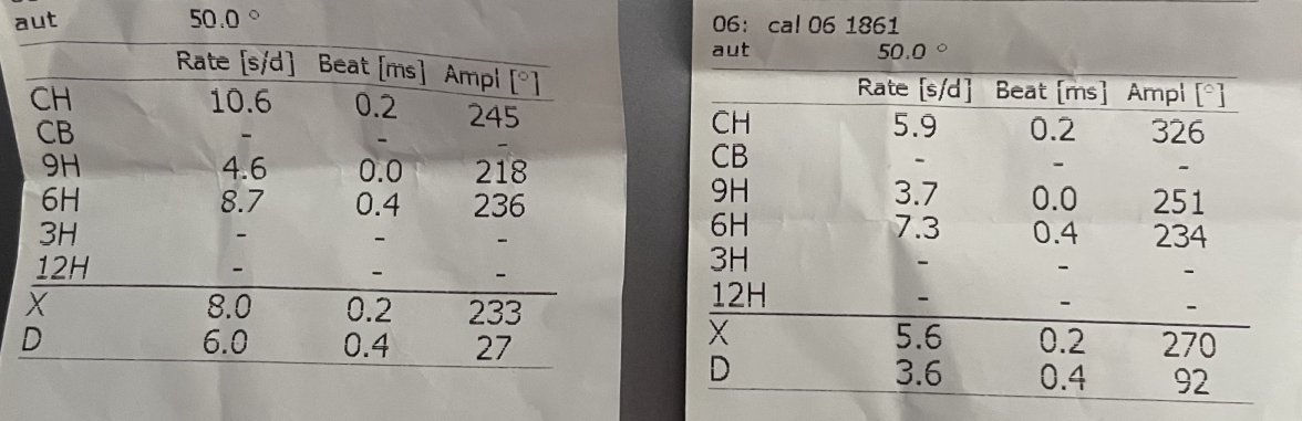

Hi everyone, long time lurker first time post. I recently got my 3570.50 serviced and it was running perfectly for the first three months but then started having issues. I had it put on a timing machine this weekend and it looks like it is +5 no matter what but when the chrono is off the amplitude drops considerably and the timekeeping is poor. Does anyone know what the issue could be? My watchmaker is great and has serviced multiple watches for me but for some reason my Speedy has had a few issues since the service. I plan on taking the watch back to him since his work is under warranty but just wanted to see if anyone knew what could cause something like a steep amplitude drop with the chrono on.

Sure thing, here are the actual readings. As far as poor timekeeping all the watchmaker at the omega boutique said was that with the chrono on the drop in amplitude would result in the watch keeping poor timing no matter what.

Well, technically the watch is within specs, but there are a couple of things that bother me. So when the "watchmaker" at the boutique did this test, I assume he fully wound the watch, but did he then wait for 30 minutes before taking these readings? That is what Omega procedures dictate should be done.
Also, for him to make a blanket statement that the chronograph being on will automatically mean poor timekeeping, I wonder if this is an actual watchmaker. Do they perform full services there? If not, this may be a "boutique technician" who is essentially a salesperson who has had a bit of extra training, rather than a fully trained watchmaker.
The fully wound horizontal amplitude on the right slip is quite high - not completely unusual as these tend to have quite high amplitudes sometimes., However the two vertical amplitudes are much lower than I would expect to see given how high the horizontal amplitude is.
Omega specifications allow the balance amplitude to drop as much as 40 degrees when you turn the chronograph on for an 861/1861. The horizontal amplitude has dropped basically twice that. The verticals, one is less than 40, and the other went up. Again, these readings are very odd.
So to me, I would question if the service on your watch was done properly or not...
