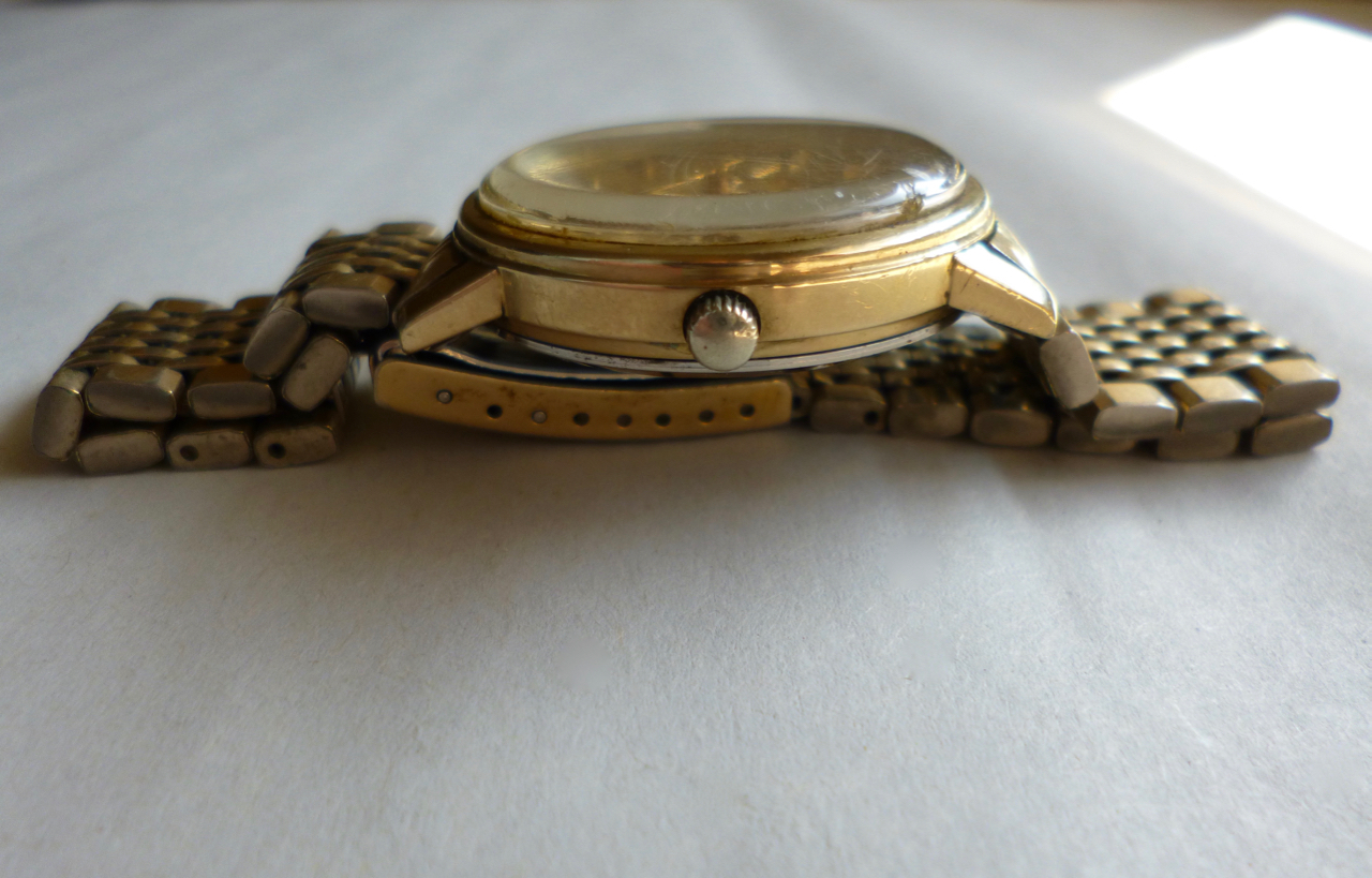

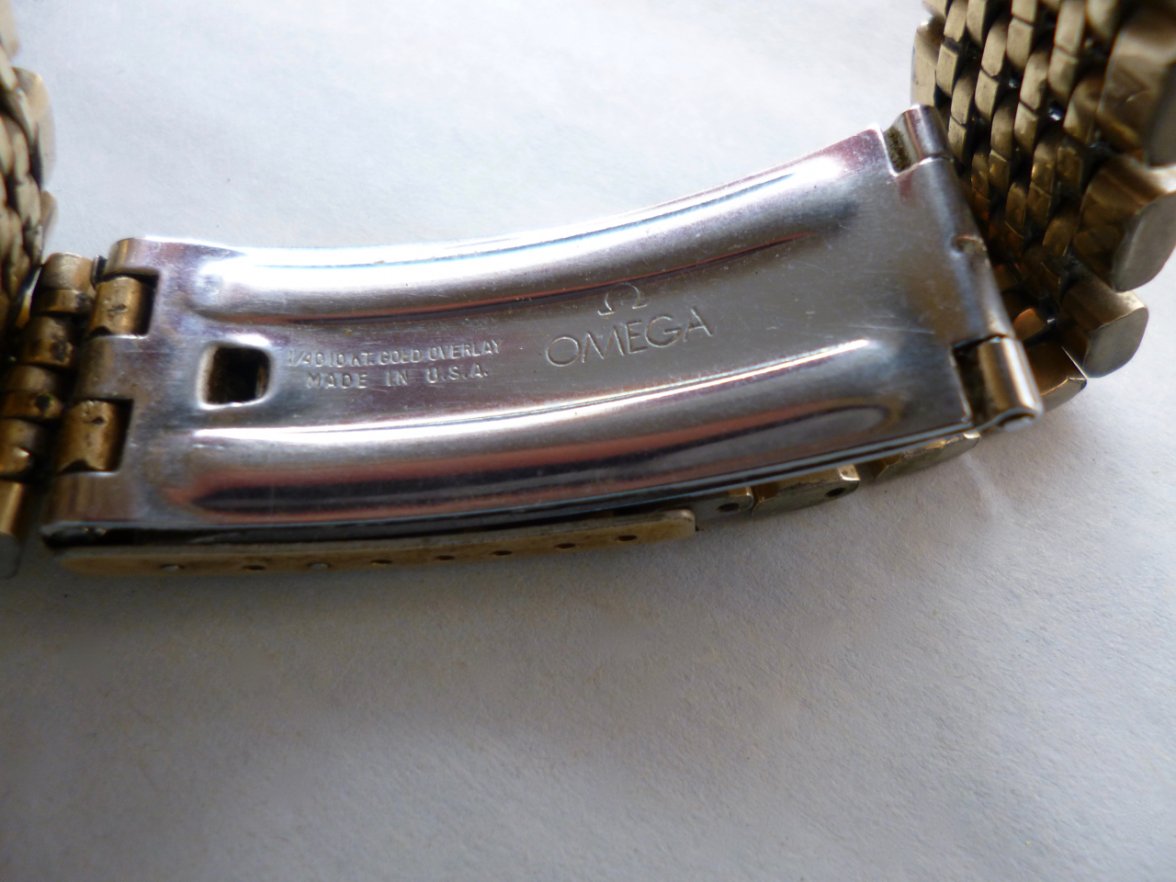

    I need some help. I thought this was genuine and the bracelet looks original, but noticed the crown isn't marked and the "1020" is printed inside a circle on the movement (instead of engraved) which I haven't seen in my research. Any info is greatly appreciated.

    Genuine watch with a replaced crown. Movement is just as it should be.

    Hi, the watch is genuine. The crown is a generic replacement one. In movements from the 70s Omega had the number in a little circle like that, before that they were engraved. Watch isn't one in high demand so you shouldn't be spending to much on it.

    Thanks for your help. Is the movement missing a bumper?

    This is not a bumper, but, yes, the rotor and auto-wind assembly is missing.
    Serial number, below OMEGA and above SWISS within the little circle, dates this to ca 1972.

    bumper no, but oscillating weight + 2 parts that go with it and a screw, yes.
