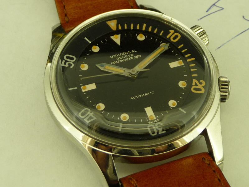

    I'm not sure why someone finger-painted the bezel markings from 0 to 20 minutes, but apart from that (and the price tag) I kinda like it at first glance.

    I did not realize the finger-painting, till you pointed it out. Are the luminous dots on the hour-markers an add-on?

    I am not sure, but I suspect the luminous dots creating a fried-egg appearance on the hour markers may be replacements of an original feature. Here is an example with the same arrangement of luminous dots, blackened with age:

    Are you so sure of this? You are usually so skeptical of SM 300s, but quick to declare here. I'd suggest a close read of this thread before issuing a definitive judgement. http://omegaforums.net/threads/early-polerouter-sub-discussion.3630/
    I'd also suggest we not be so quick to dismiss the one under discussion in this thread. It has several features that are undoubtedly more authentic than many others.
    Dots are original. I need to spend a little time with the rest of the pics for the rest of the watch....

    The real thing I am referring to are the sub-divisions from 0 to 20 minutes. The original ones are clean and even, while that found on the watch in question are uneven.

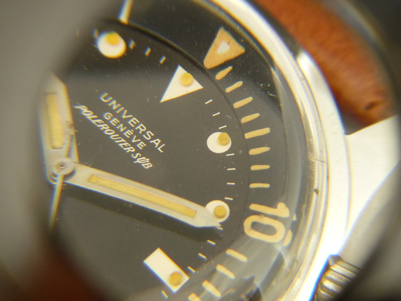

    The lume on the inside bezel certainly looks to be a later modification. If that supposition is correct, then based on the perfect matching of the lume dots and the bezel, I'd guess that the original lume dots were probably picked off and redone during a watch servicing.

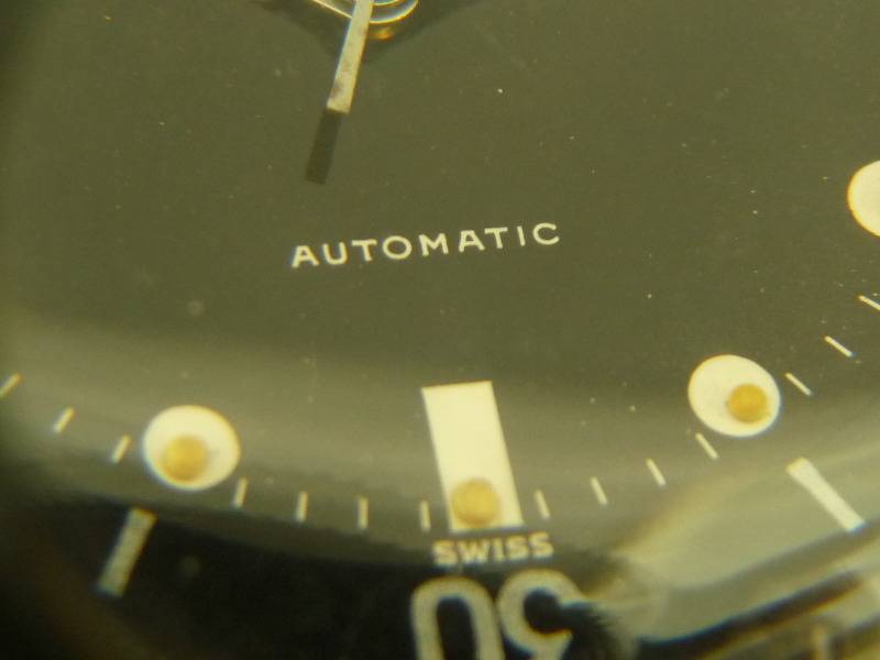

    Tough one here. The dial is correct and original. The little lume dots are interesting. It would seem intuitive that the whole hour marker ought to be filled with lume, but nearly all of the watches that are certainly original have only little dots of lume. IN fact, the dots are even smaller and more consistently placed than the ones on this watch, so I'm not even certain about my earlier assertion that these are original. The rotating inner bezel is original, with the relatively narrow font for the numbers. I've seen that heavy-handed application of lume on a fair number of older ones so wouldn't rule it out as original. Case and movement appear original.

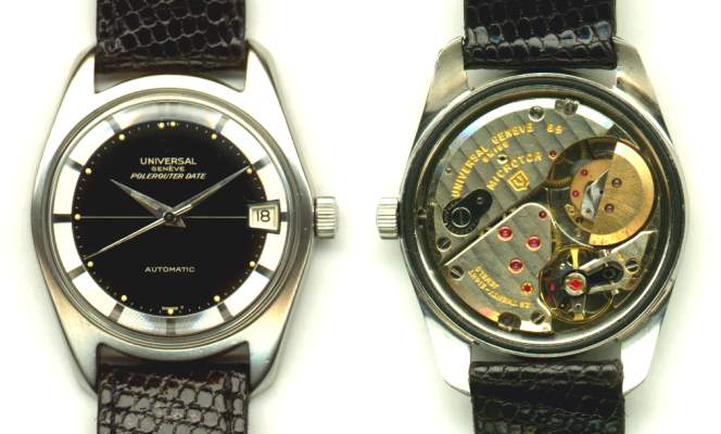

    I agree with Lou that I've seen these little dots of lume on too many examples for [the style] not to be original. Anyone have a clear pic of the lume dots on the dressy polerouter models? The size and overall appearance looks very familiar.
    I still don't like the bezel lume, it looks very amateurish, especially compared to the precision of the dots. But I've seen some sloppy lume on some 100% real vintage pieces before. Some of the JLC divers, in particular, come to mind.

    There's the dots that I was recalling:

    As someone who has worked with lume kits before, I can say that it is much much easier to play paint by numbers and simply color in the circles than it would be to create uniform little lume blob or dots like this freehand. It would almost be easier to stamp out the dots from a mold, allow them to dry, then glue to the dial. Another tick box on the authentic side for me.

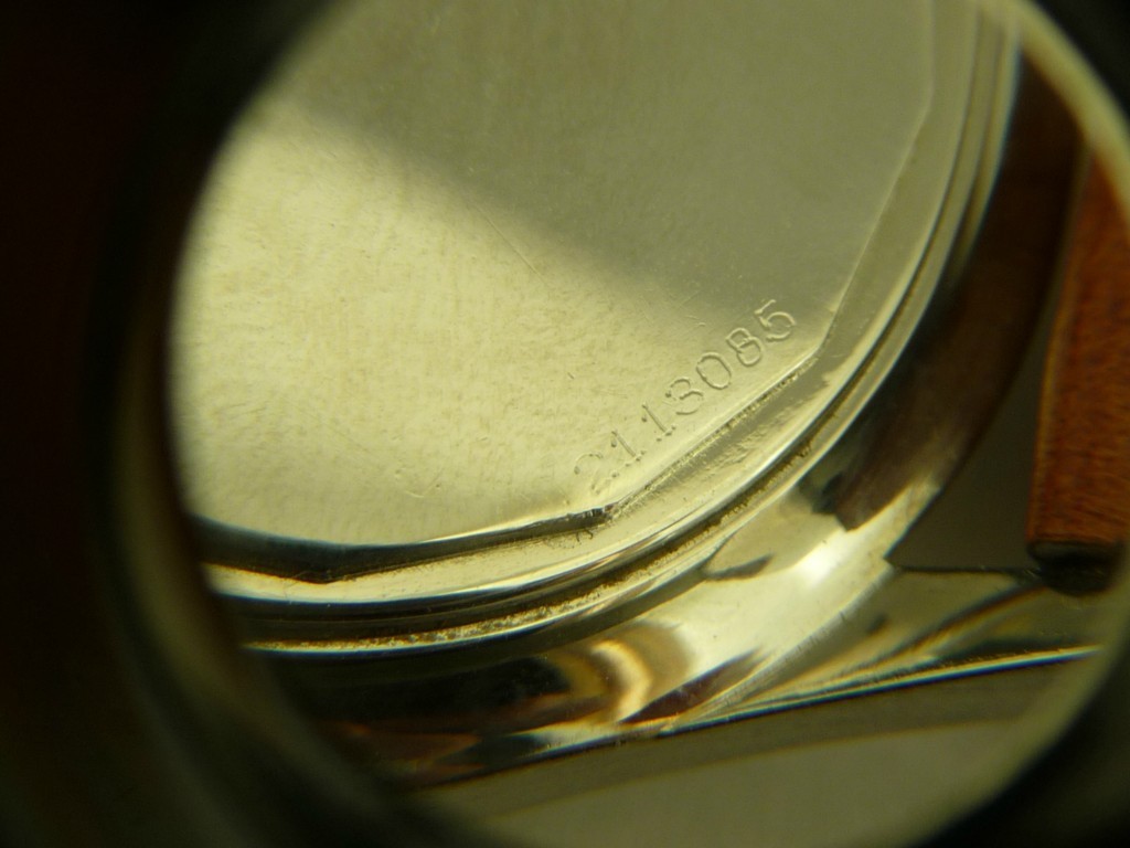

    One thing I do NOT like is the look of the serial number on the caseback. I haven't bothered yet to look up the actual number that is marked, but the digits look like there were done freehand. We know Universal possessed a nice, uniform set of punches that they used for serial and reference numbers and they sure didn't involve that "8" even if this case has (clearly) been polished and resulted in some distortion to the numbers. $T2eC16FHJHYE9nzpcDiuBRN73J606!~~60_57.JPG

    UG case numbers in the later years weren't stamped or punched - they were engraved, and very lightly at that, such that they are easily polished off. This looks completely legitimate.
