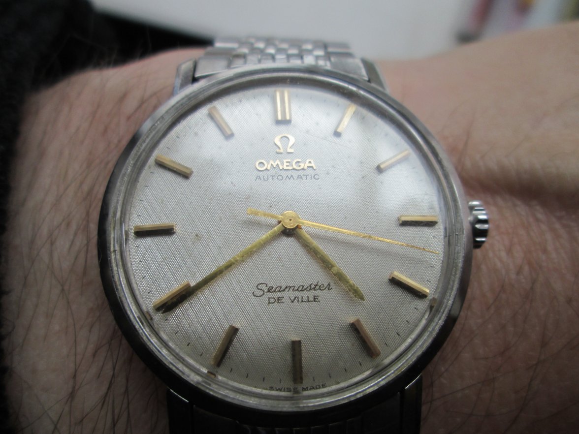

  15. Edward53 Jun 13, 2017
    3,127
    5,384
    I would not judge that watch by the "heavy" lettering. The light can make a huge difference to a photo. This is the same watch:

  16. kreyke Jun 13, 2017
    626
    838
    But the M itself in seamaster, the left side is thicker than the rest of it. Looks unequal heavy handed text.
