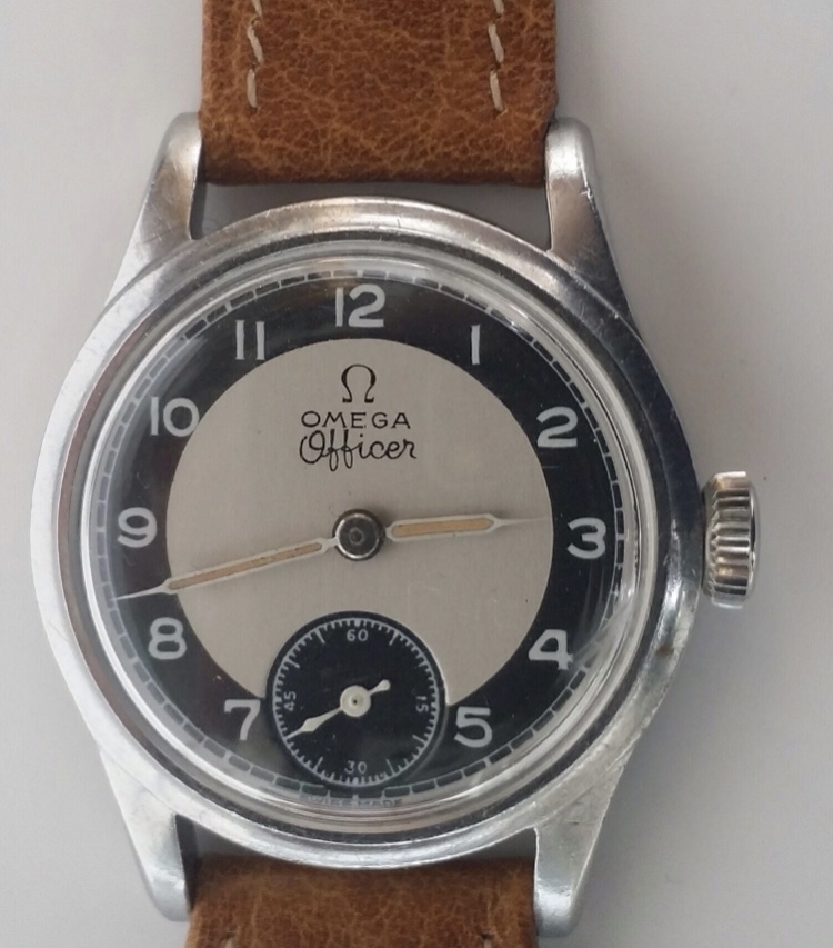

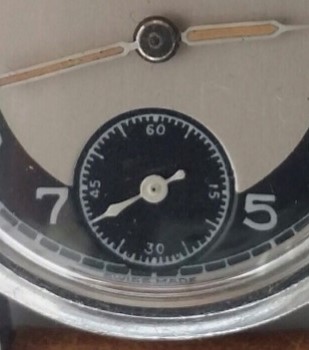

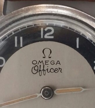

Posts 56 Likes 8 FinnishVintage ·Mar 26, 2021 So, what do you think? To my eye it looks just like a very clean example. Opinions appreciated!
Posts 8,174 Likes 36,709 cristos71 ·Mar 26, 2021 I don't follow these but my feeling says redial. Study the logos and sub dial.

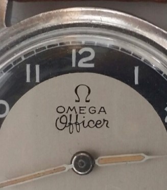

Posts 609 Likes 789 Franco ·Mar 26, 2021 Based on the rounded edge of the sub dial, and the distance between the scripts (Omega and officer too close). I would thing it is a good redial. Also, the zero of ten is touching the edge Edited: Mar 26, 2021
Posts 56 Likes 8 FinnishVintage ·Mar 26, 2021 cristos71 I don't follow these but my feeling says redial. Study the logos and sub dial. Will do! I actually thought the 'Officer' is a bit too big but I have seen variation between these vintage ones a bit.
Posts 1,625 Likes 6,077 bardamu ·Mar 26, 2021 Looks like an evident redial to me, even if not the worst around.

Posts 16,918 Likes 48,150 STANDY ·Mar 26, 2021 Nice obbicer The loops on the FFs is supposed to be at the top of the F 😗
Posts 6,609 Likes 26,780 Scarecrow Boat ·Mar 26, 2021 STANDY Nice obbicer The loops on the FFs is supposed to be at the top of the F 😗 There should be loops on top and bottom ☕
Posts 16,918 Likes 48,150 STANDY ·Mar 26, 2021 Scarecrow Boat There should be loops on top and bottom ☕ Be like the Dead Sea scrolls that soon.... Not taught in schools anymore....

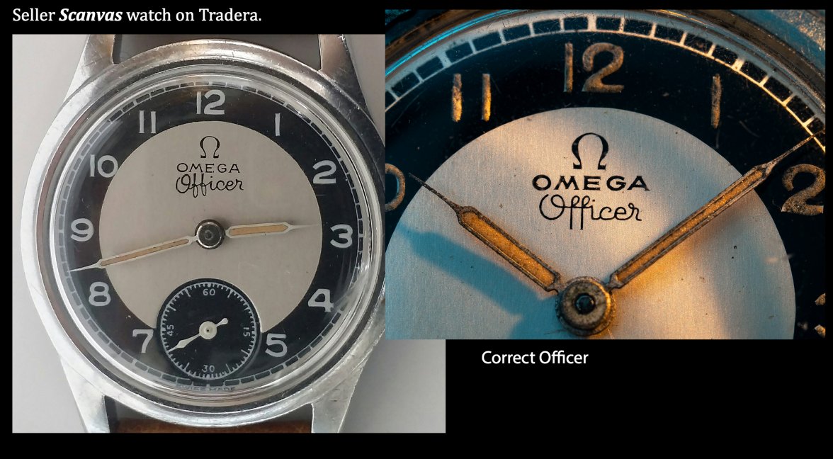

Posts 365 Likes 455 Maskelyne ·Mar 27, 2021 The seller Scanvas https://www.tradera.com/profile/items/430763/scanvas on Tradera sells plenty of non genuine watches like this. And he doesn't care at all...
