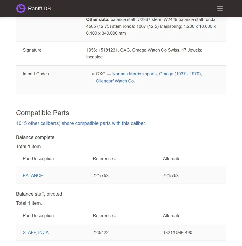

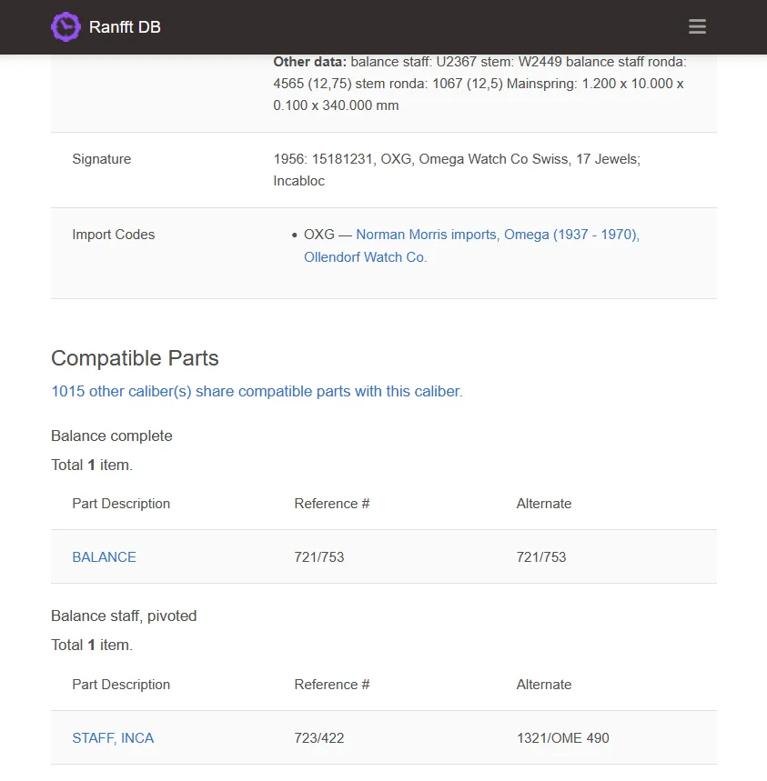

🔧 Find the part - and one you can still buy
For any caliber you get the spare parts that fit, grouped by type (mainspring, balance, barrel…). Discontinued parts are automatically collapsed onto their current replacement, so the list shows what you can actually order today instead of a dead reference. Open any part to see every caliber it fits, its manufacturer-stated equivalents, and the full supersession chain.

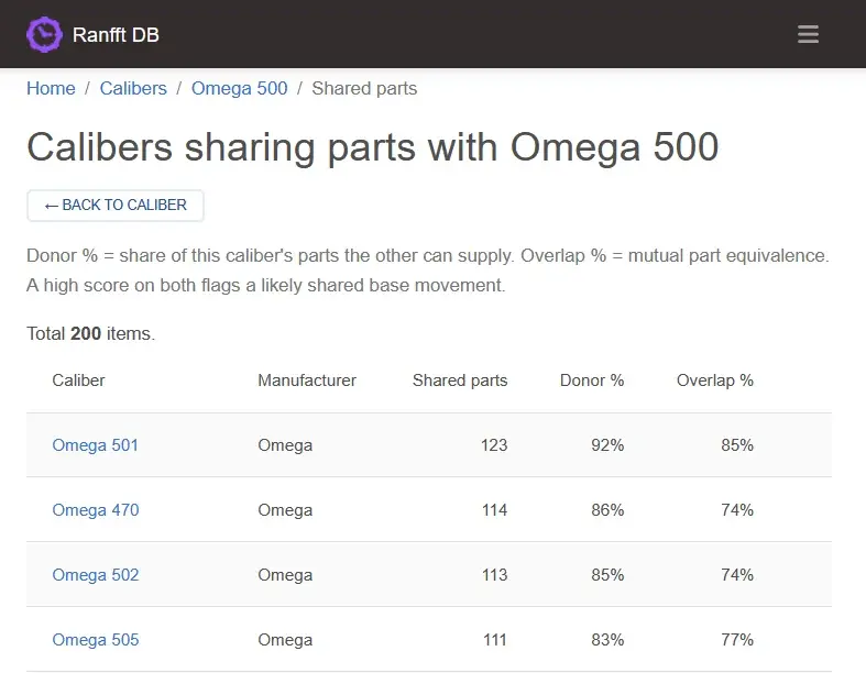

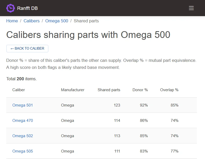

♻️ Source a donor when the part is NLA - the Shared-Calibers Explorer
The one I think you'll get the most out of. From any caliber it ranks other calibers by how many parts they share, with two numbers:
- Donor % - how much of this movement's parts another caliber can supply.
- Overlap % - how interchangeable the two movements are overall.
Movements that are essentially the same base ébauche get flagged "likely same base." When the exact reference is unobtainium, this points you straight at a donor or an interchange part instead of guessing.
