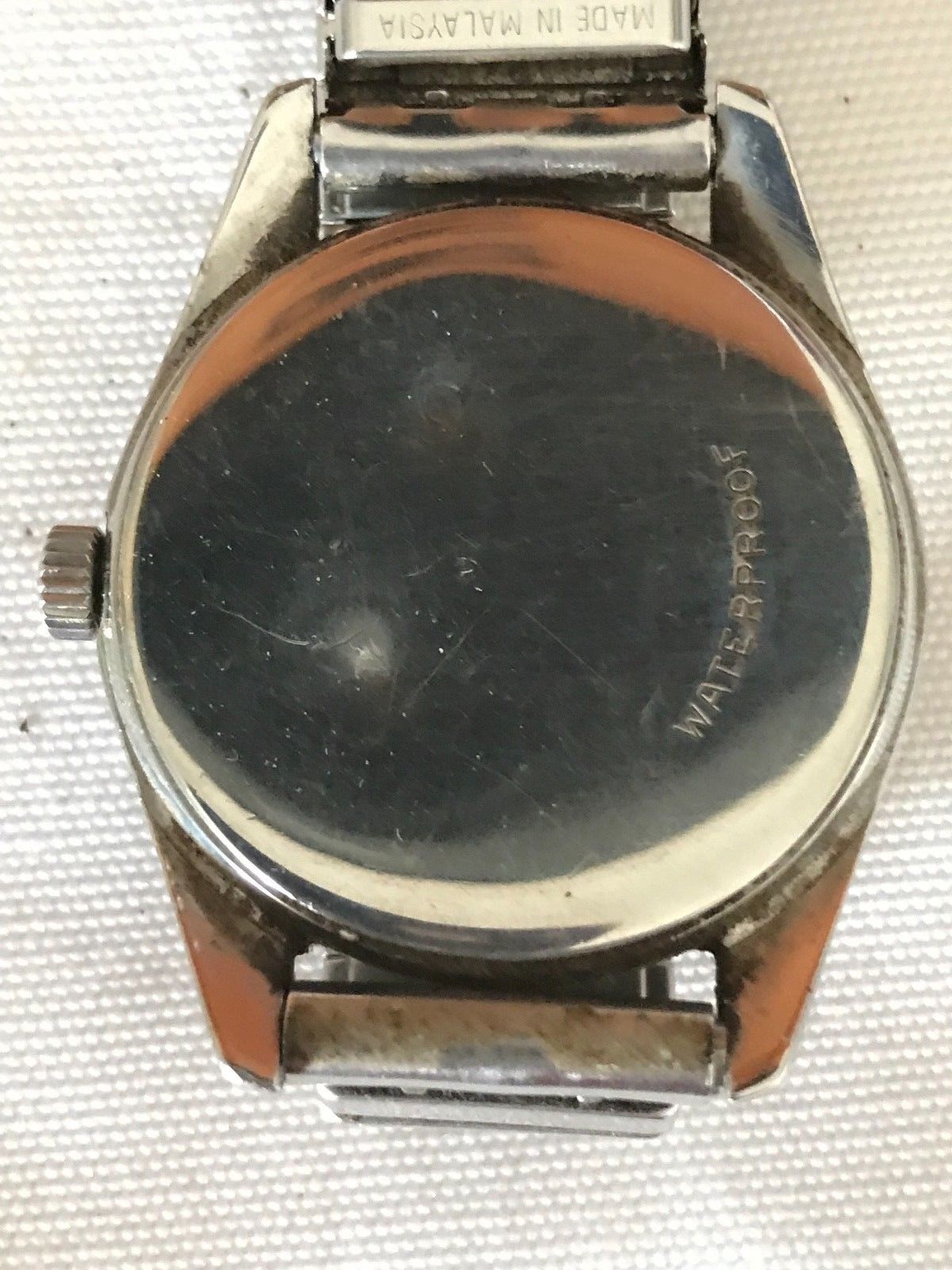

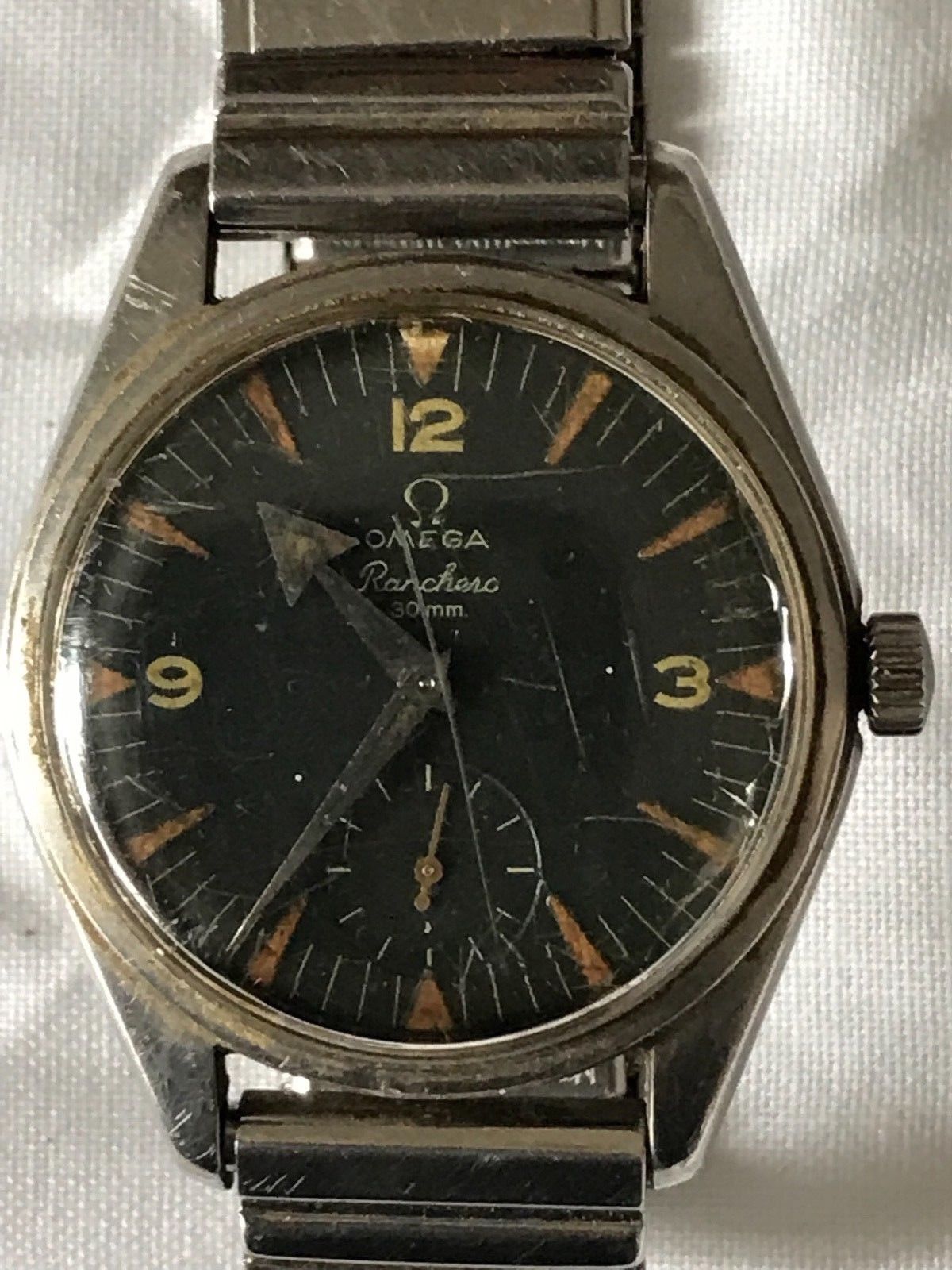

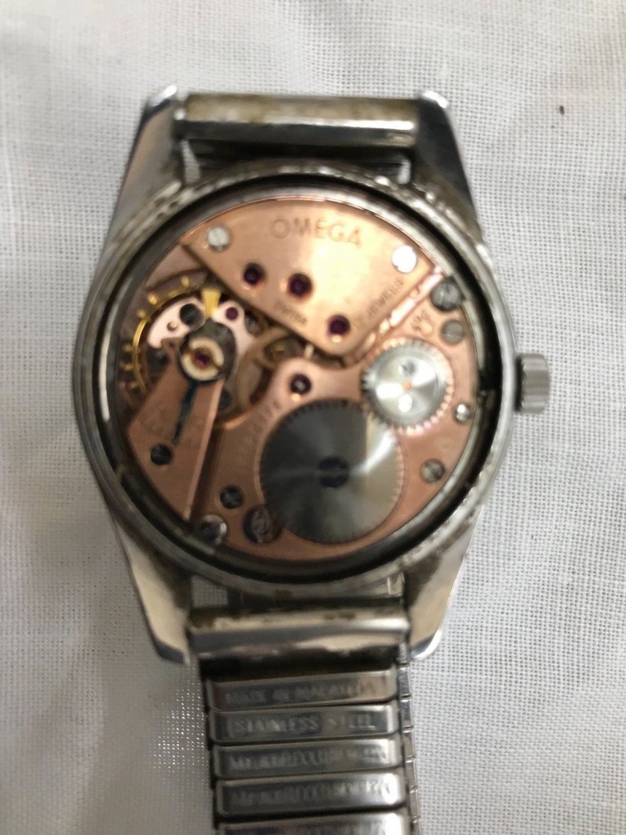

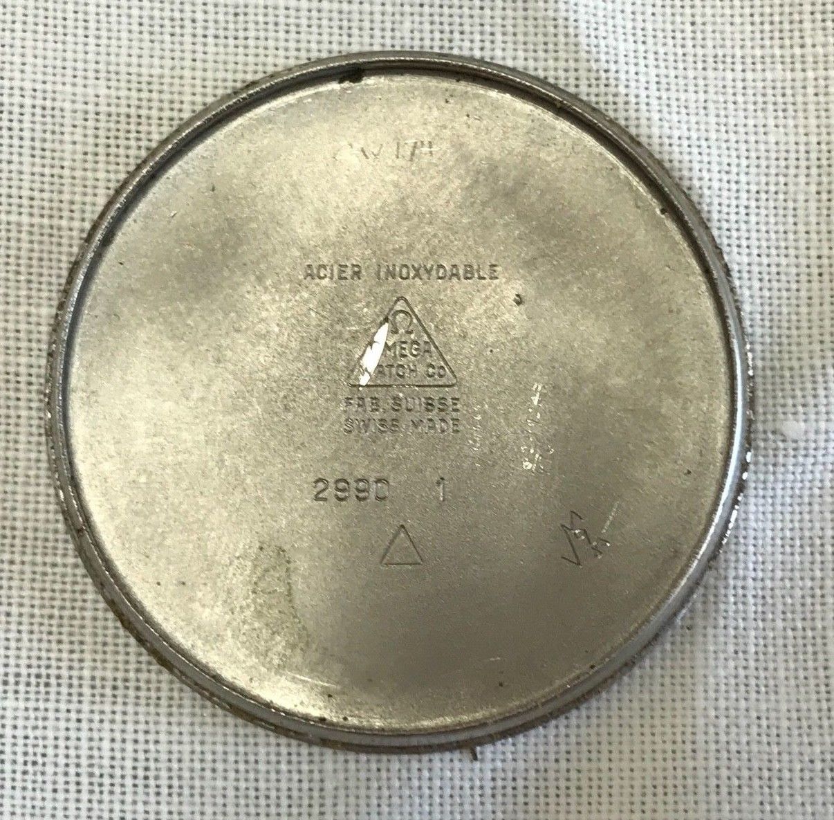

    Hi guys,
    This Ranchero 2990 is up for auction and wondering if anyone could comment on the condition/authenticity?
    I'm guessing other members may already be watching this one.
    Photos in the listing are average, but the hand patina looks gunky, however they are broad arrow (which I think is correct?). The dial lume looks nice, but would be interesting to see without the crystal and nice and clear!
    I don't know much about Rancheros but could add one to collection at the right price.
    Thanks!
    Ed
    Etp095 likes this.
  2. tritto Oct 12, 2018
    340
    504
    Hey Ed. From the reading I've done lately, I think the dial and H/M hands are correct. I've read that the second hand should be painted white, so that may be a replacement. I think the crown is probably also a replacement.
    EdtheAussie likes this.
  3. Vintagewtchzilla Oct 12, 2018
    946
    2,029
    hey
    seconds hand is replaced and wrong style, crown is also replaced, the caseback had originally a circular brushing. thats all. after a cleanup and a new crystal i think i could turn out as a good one, which u can enjoy as a daily companion.
