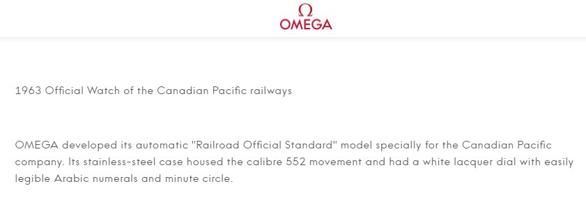

That Omega supposedly designed a "special" watch for the Canadian Pacific Railway is a surprise to me. The only Omega watches of which I am aware that were ever railroad approved for Canada were the Louis Brandt and freres, 16-size CCR and CCCR models, and 18 size DDR and DDDR models. And among the lists I am referring to, the only railroad approved mechanical wrist watches did not include anything by Omega. Even among the electro-mechanical and electronic watches that were railroad approved, there are no Omegas. And among the mechanical watches approved for use on railroads in Canada, I am only aware of manually wound wrist watches. No automatic winders. The Omega "railroad approved" wrist watches shown in this thread have 12-hour dials on them. Any of them that might have been railroad approved in Canada would likely have 24-hour dials. But I also am here to learn. So let's see what the experts say.
This is from Omega's website - here: https://www.omegawatches.com/news/news-detail/966/

Hmm, rather mysterious.
Omega says they "developed its automatic "Railroad Official Standard" model specially for the Canadian Pacific company"
There appears to be no immediate evidence that Canada Pacific actually came through with approving or purchasing the model.
But we do know that the "Railroad Official Standard" model (w/ automatic 550 movement and hand wind 600 movement) was sold to US in late 1963.
