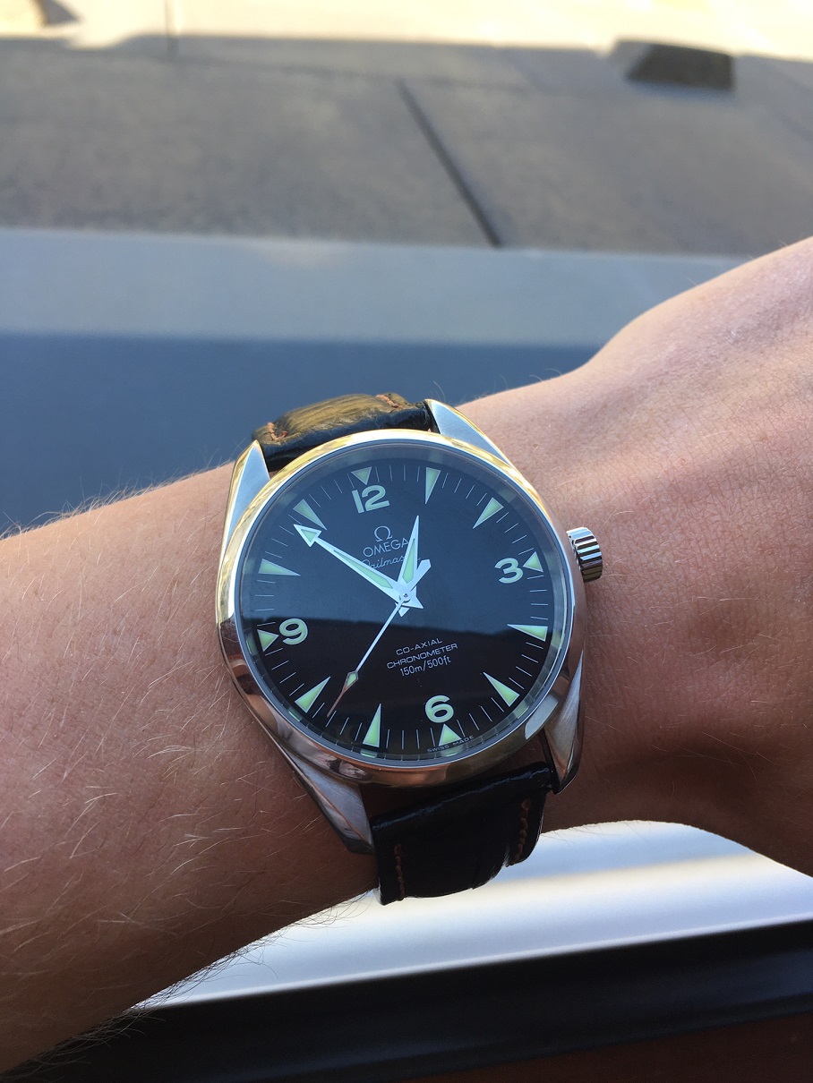

My younger cousin says hello 😀

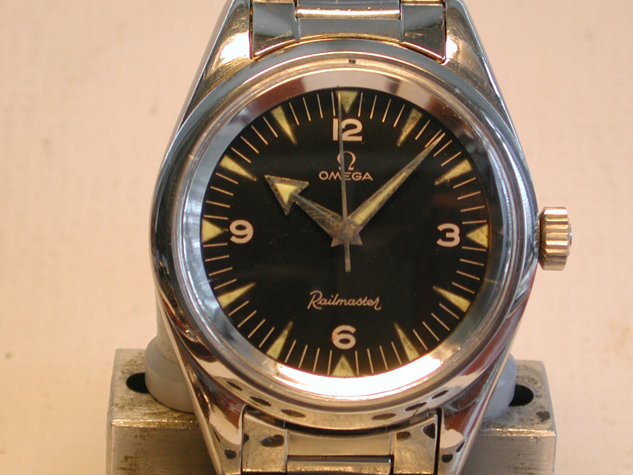

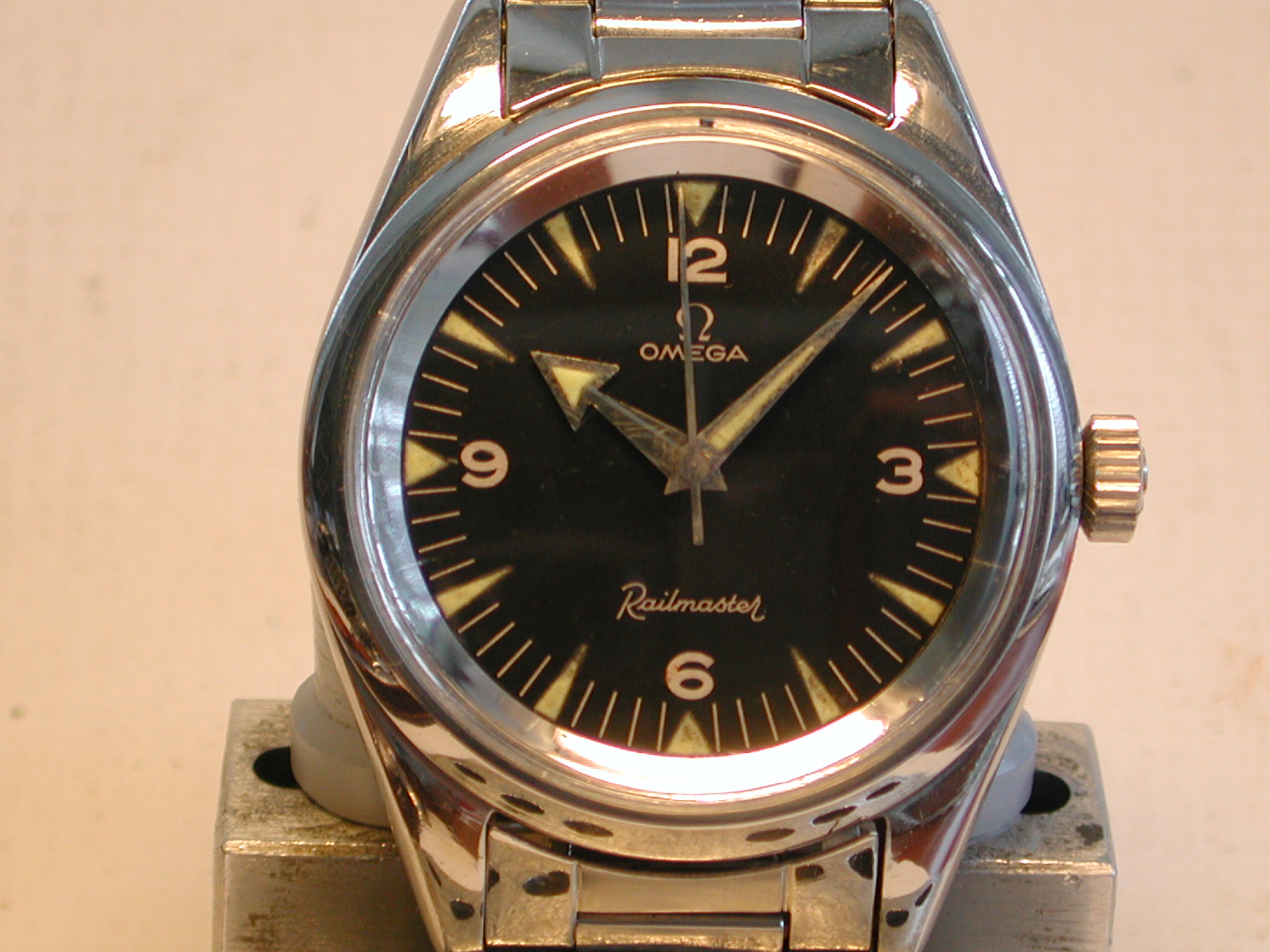

and another one on the original band......
in the OP watch the Amag inner movement holder ring and the Amag. inner cover are re-manufactured. no longer Amagnetic now. many have rusted away and with his dial it shows, this Railmaster had seen some moisture in the past........ kind regards. achim
Thanks for the Insight: why is it Not anti-magnetic anymore? Wrong material used?

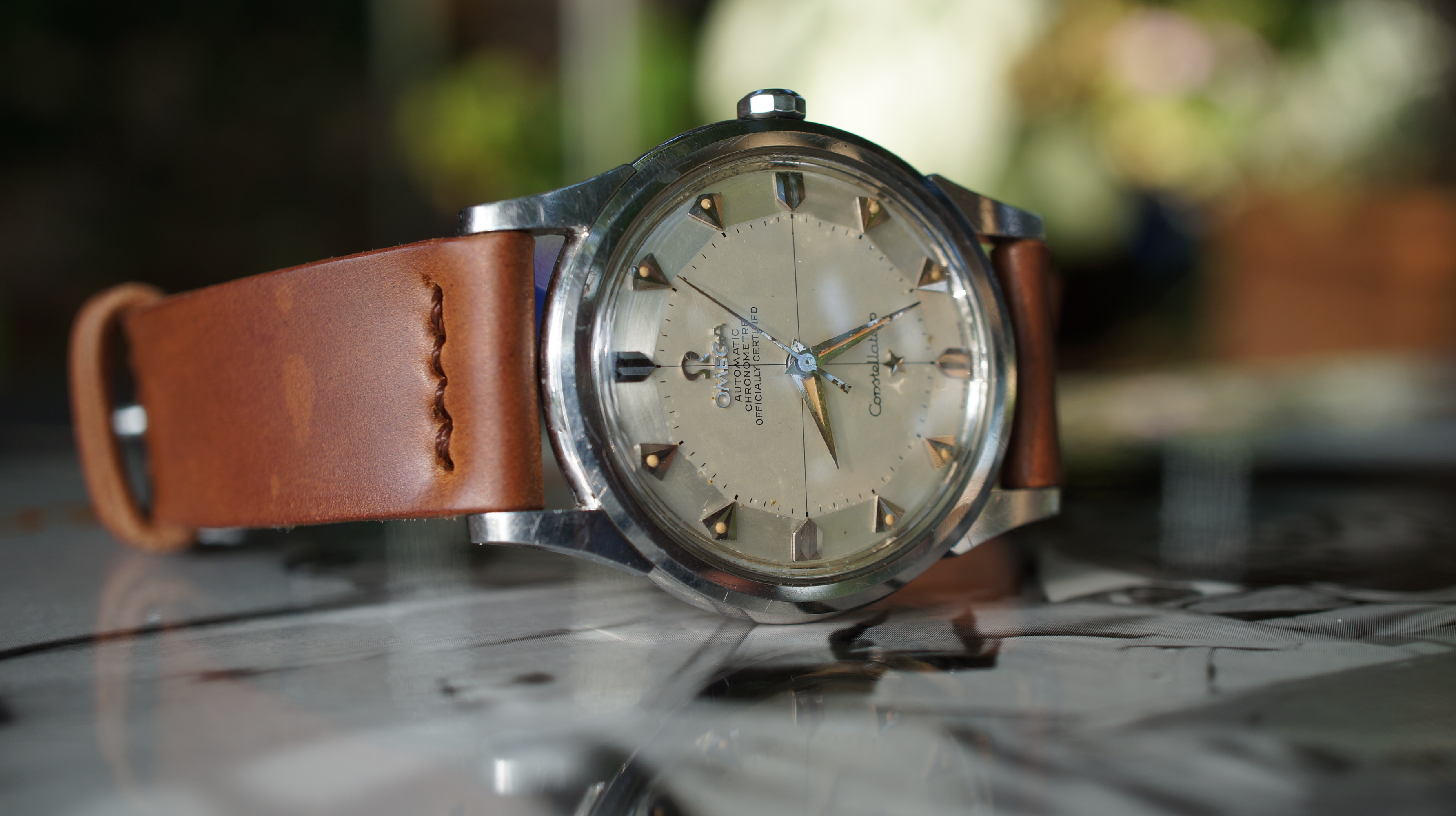

Its a beauty...the dial condition is very typical as the lume crumbles and sits on the dial burning the finish. I would assume the hands were relumed...but those hands are quite uncommon, ive only seen two others with the larger lume hour hand. Here are mine, 2914-2 and 2914-4
With a special order Factory Lume addition in this era, one received the larger lumed triangle hour hand.
Example for the Constellation:
