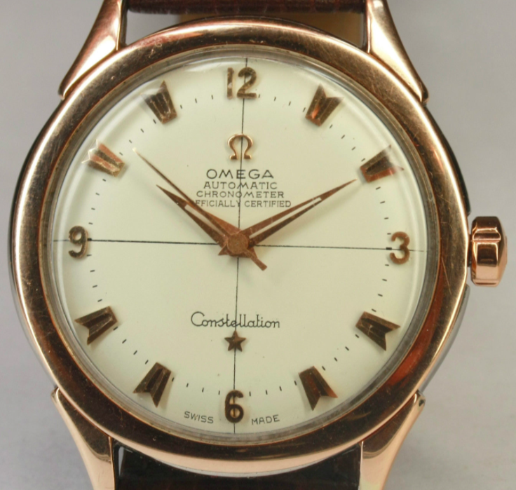

I am a Connie lover -so was looking at Ebay.co.uk this evening and came across this
-it was beautiful watch once upon a time
it kind of fits in with the theme of the thread -although it could also feature in (subtly) worst redials
-do you think they got just got bored at 'five to the hour'?
I'm sure the eagle eyed will spot the additional inconsistencies....
in case someone wants a slightly squiffy Connie -here is the 'Bay link
