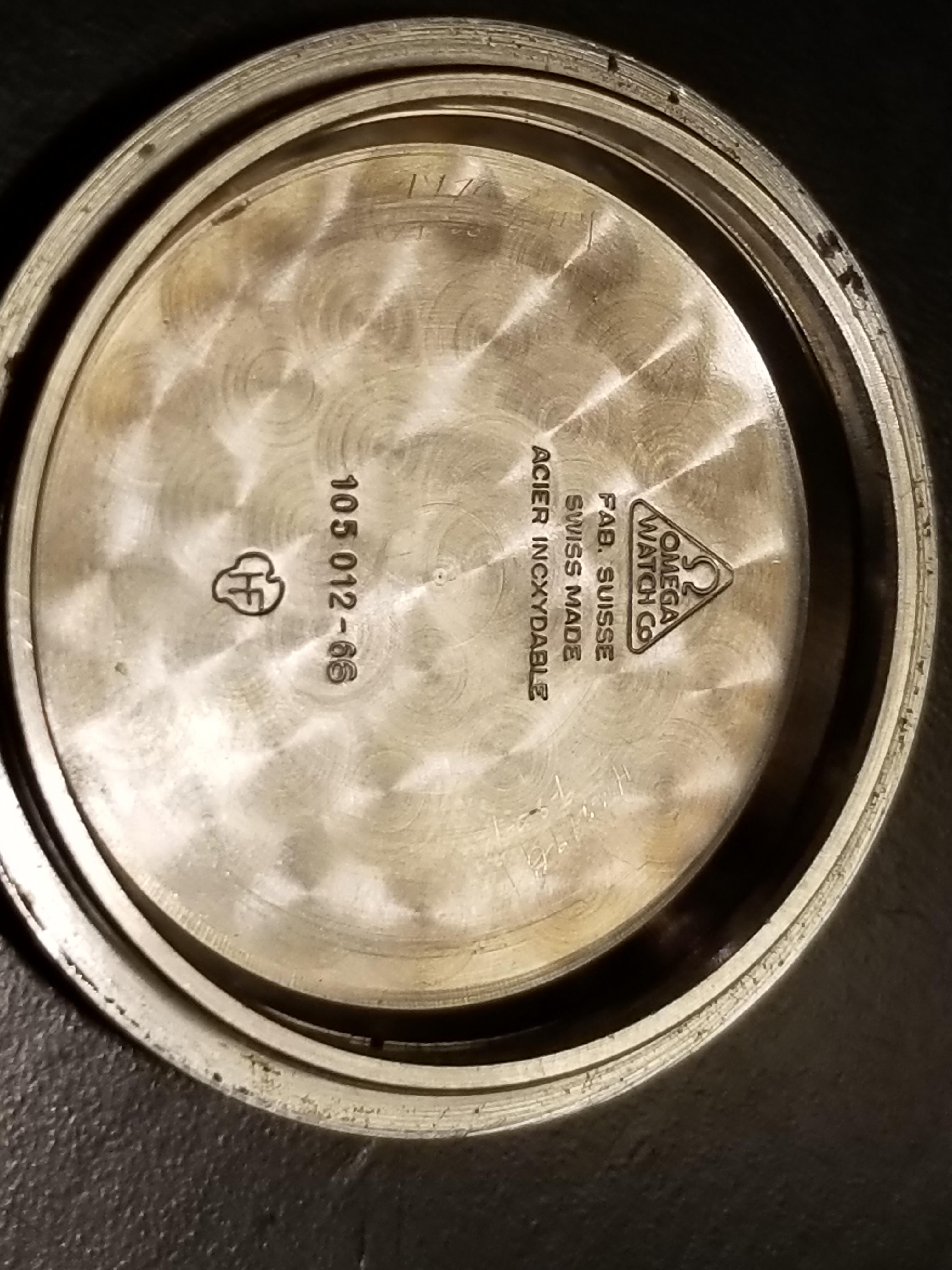

    Hey guys, long story short, I purchased a ref 105.012.66, the stamp on the other side of the case back says "66" but when I requested paper work from Omega it shows the watch was produced in 1967...
    Is this indicative of a fake or was it common for Omega to switch some parts? Also, are CB cases more desirable or HF more desireable?

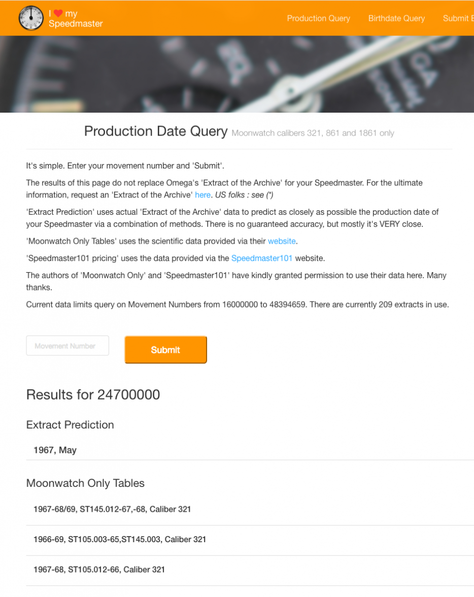

    Just as an illustration, I put a hypothetical serial number into the calculator at ilovemyspeedmaster.com. You can see that it is predicted to be manufactured in 1967 but one of the watches it would have been found in was a 105.012-66.

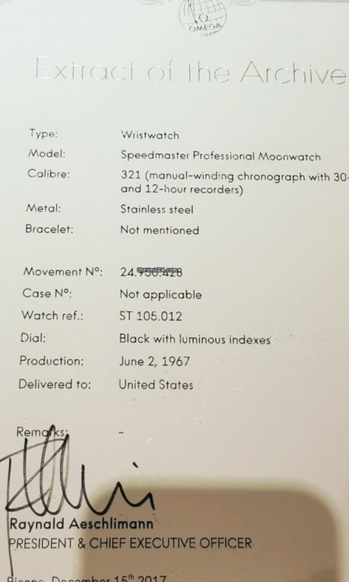

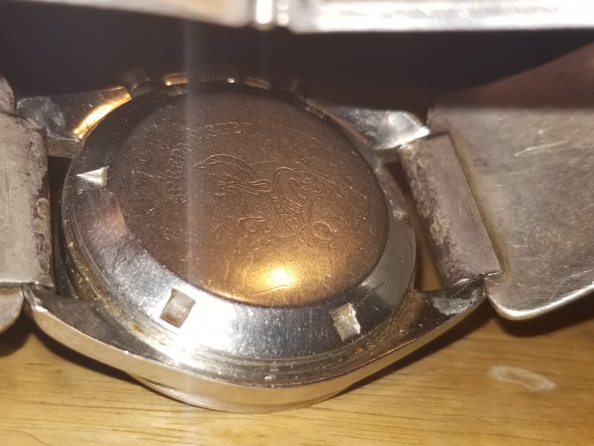

    Hey guys, sure here's what I'm looking at.
    Also, does it look like a double bevel case back?

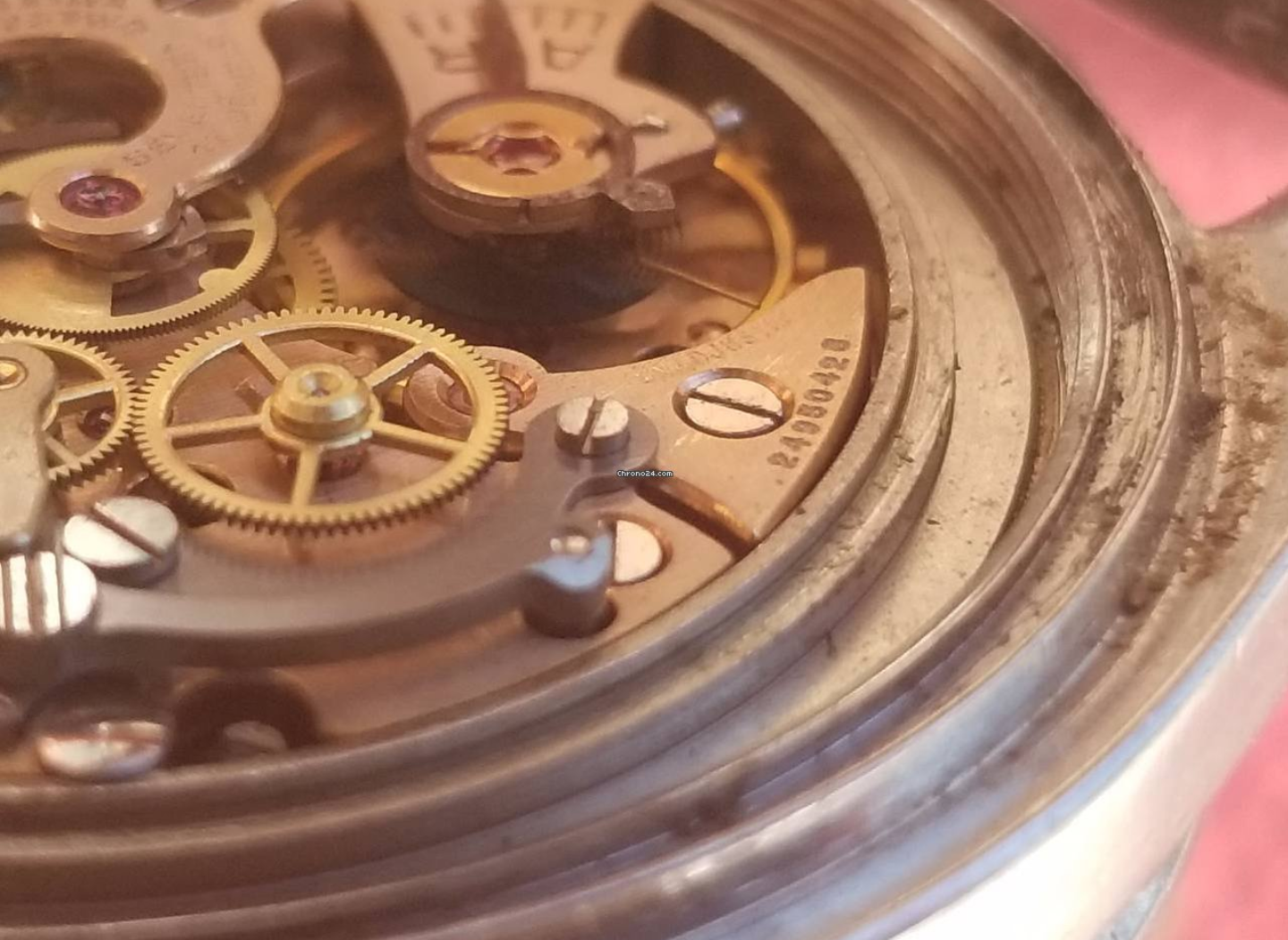

  6. Deltasig1218 May 9, 2018
    6
    Here's a picture of a part of the movement from the seller, I'm not home currently so more pics can't be had for now but maybe this helps?
  7. Dgercp May 9, 2018
    1,072
    1,454
    All is good. If the caseback said 105.012-67 then you would be in trouble.
    The 105.012-66 was priduced in 1967 and 1968 and your serial number is in the correct range.

    I don't see any problems so far, except with your story that you requested the extract from Omega. The extract was obviously ordered by the seller, not by you, since it has the "chrono24.com" stamp on it. FYI, it can take months to receive the extract from Omega, it's not something that comes overnight. But it looks totally legit to me.
