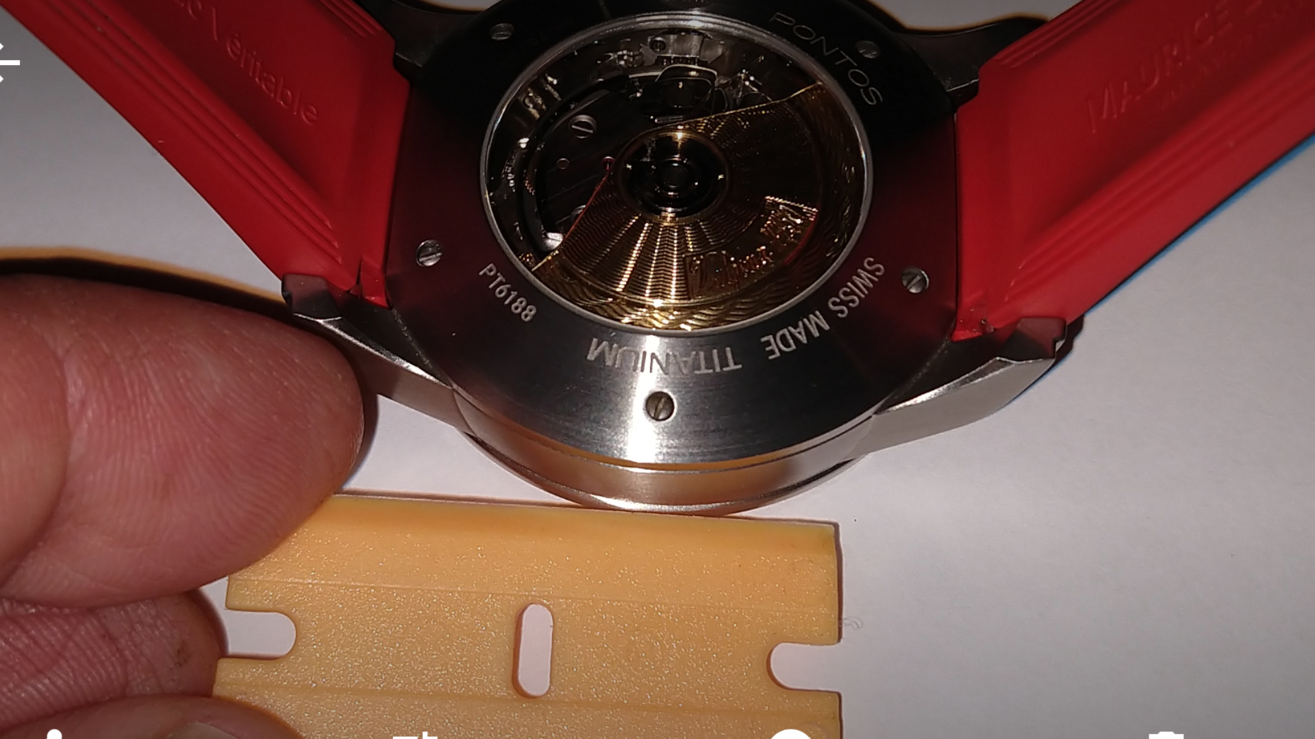

    Lastly, this is just a little tip for, or another option to removing fix watch bezels without scratching or leaving marks on the case. This is usually done with a polished case knife, but will still leave a mark.
    I use a painters mini plastic scraper.You can order the replacement plastic blades in different hardness ( I use the orange ones) and they will need to be replaced every time you remove a bezel.
    This will only work on the fixed bezels that are held in place with a plastic gasket. It will not work on removing snapped on bezels.
