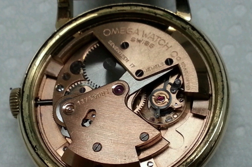

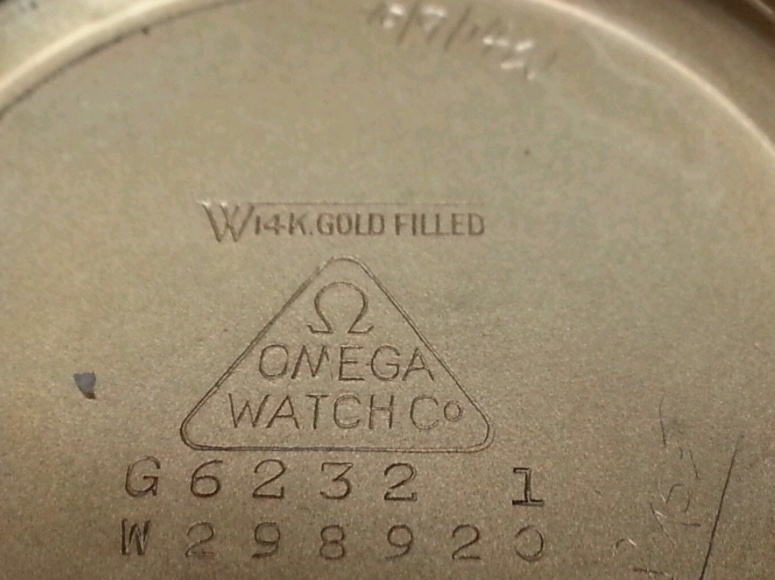

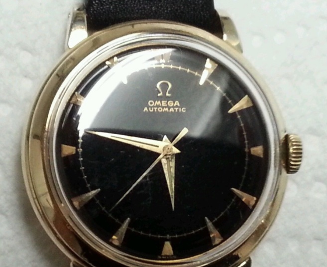

I am considering this watch, but I don't know enough about Omega watches to be sure that it is real. Will someone please help?
25,980
27,692
Not fake, just a repainted dial. It's a Wadsworth case - an American contractor for Omega back in that era.

Thank you, thank you! I definitely do not want a repainted dial. What would look different on the original dial?
4,449
11,333
I don't think it's repainted, would need better pictures to be sure though. The swiss is there, lume is aged and you can see the lacquer age.
3
His asking price is $350, which ***seems*** OK for a nice looking watch, but I am a total novice in this arena. I am passing on it. I'm guessing it would be best to buy when I know what I'm doing. I have no idea how to identify a repainted dial, among the many other things I should know before I buy.

I'd have to agree with kyle on the dial. I wouldn't write it off without better photos.

Even at $350 it's not a bad deal, but I'll agree that maybe better pictures would be good. I still think it's a redial because the letters in AUTOMATIC are unevenly spaced.

That poor leading "A", looks like the other letters are running away from it, must have BO.
Or maybe it's a new model, the "A Utomatic".
