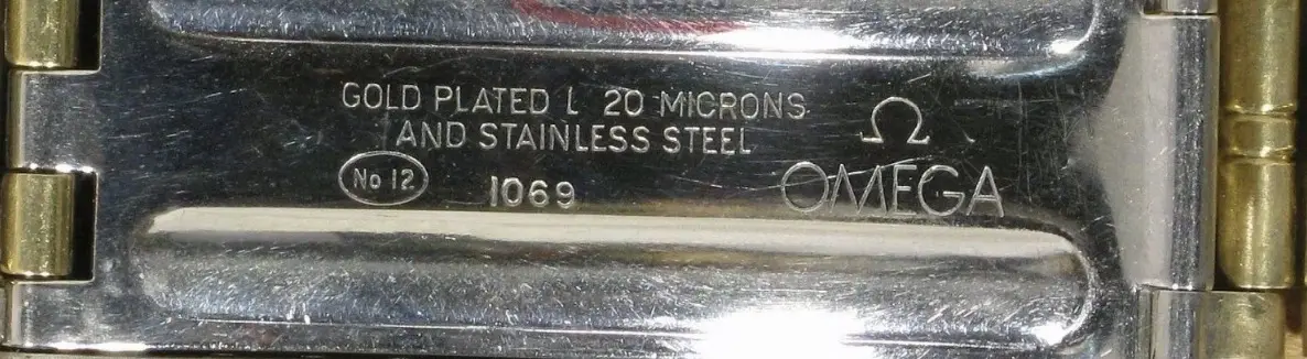

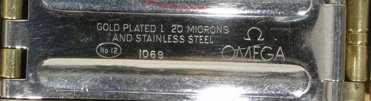

Early Polerouters had very thick layers of gold. Up to 300 microns if memory serves. This is more than the contemporary Omega Constellations.
Older gold plating was around 20 microns and modern stuff is as little as 5 to 10 microns for comparison.

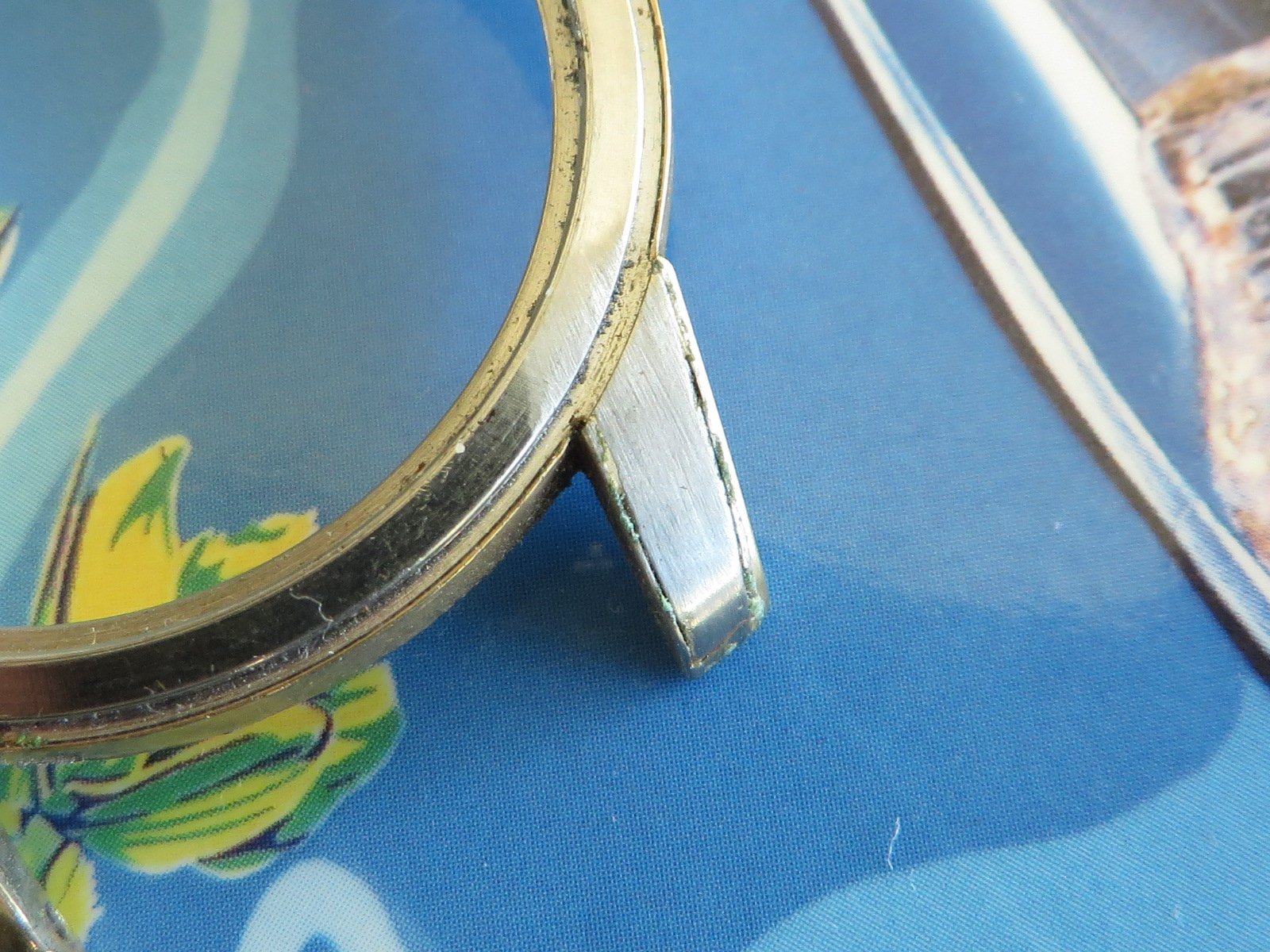

So I tried this experiment sometime ago on a trashed 1950s gold capped Seamaster case and this is as far as I got. That layer of gold is pretty damn thick.
