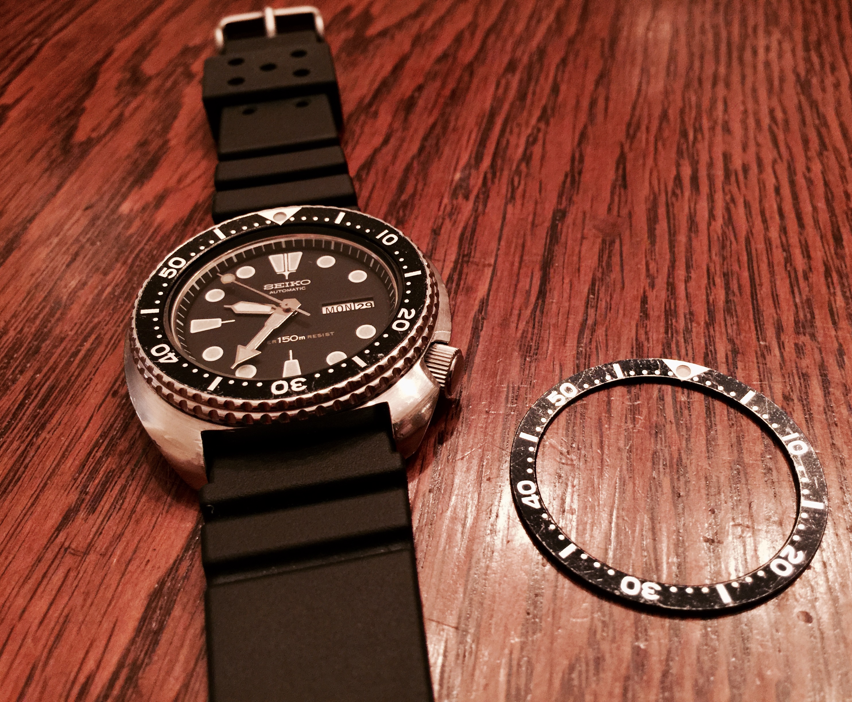

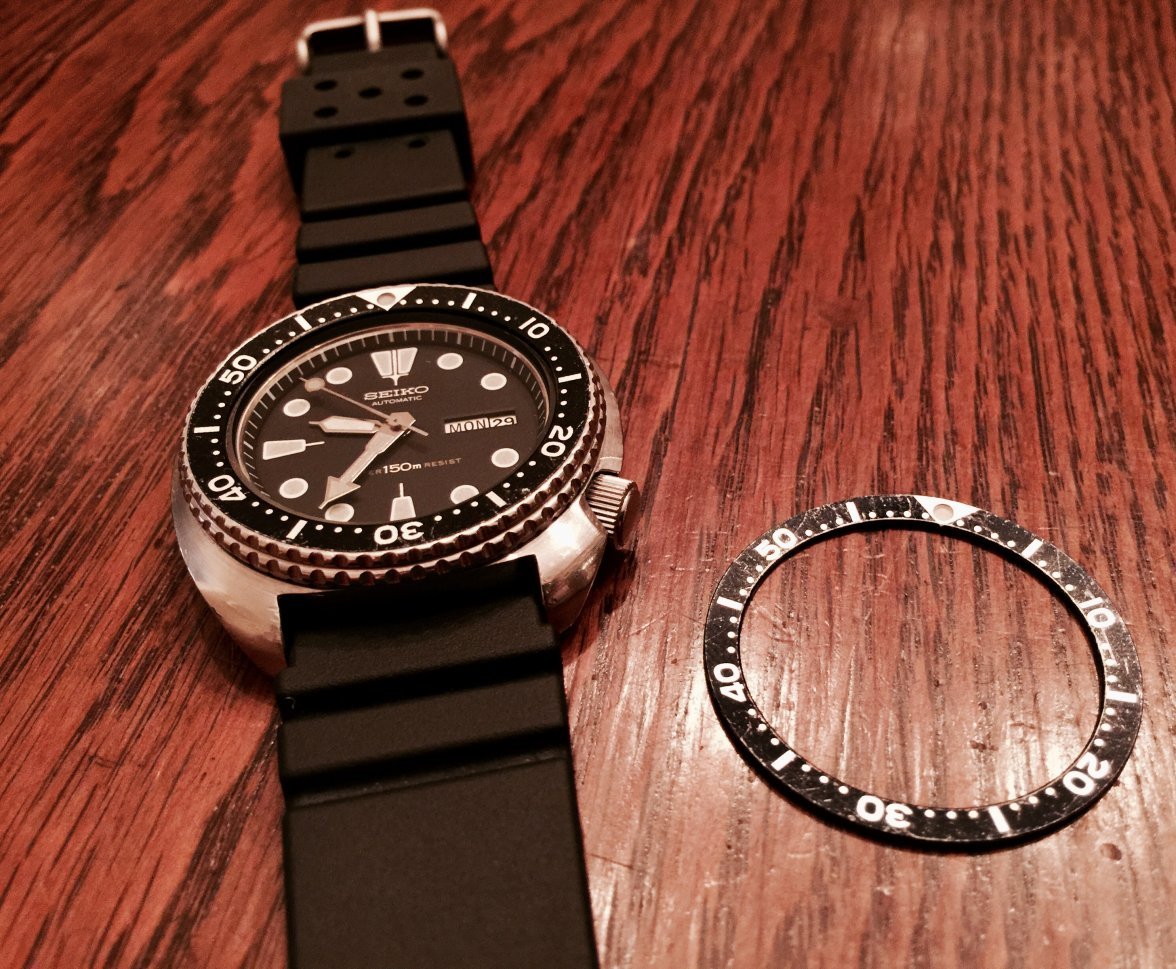

    I was wondering how the rotatable bezel on my Seiko 6309-7049 may be removed in order to install the original bezel insert [pictured below on the right] back on my 6309. A less worn bezel insert was installed [at my request] when I had the watch serviced a few years ago...but now I have a hankering to have the original back on the watch [difficult to explain...other than I'd like to have the original back on].
    Any tips regarding bezel removal and insert removal would be appreciated...it's something I'd like to do myself.

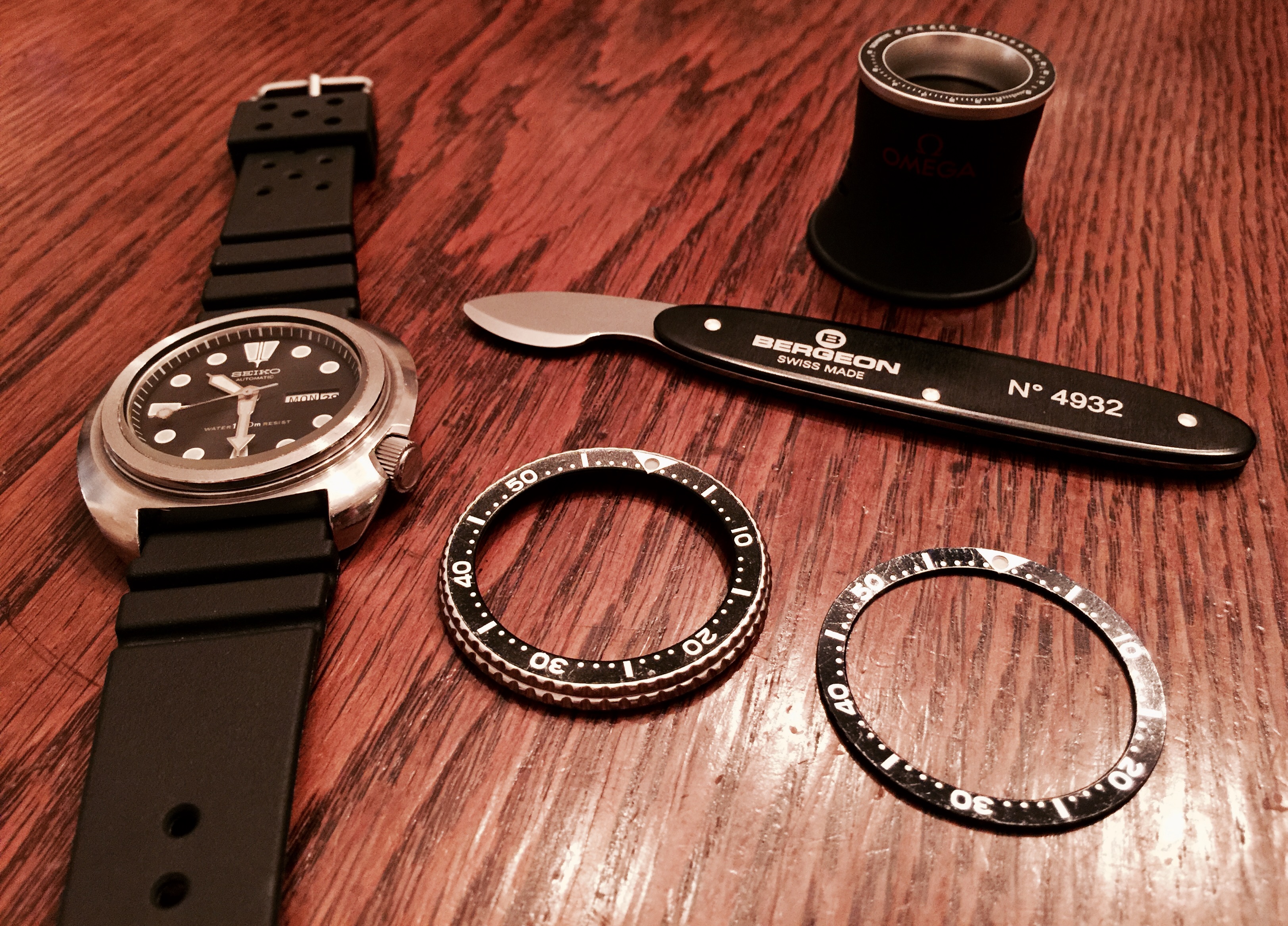

    EDIT ADDITION: Using my trusty Omega Speedy Gonzales presentation box set loupe, I was able to locate an engineered recess at the base of the bezel. Gave the Bergeon No 4932 case back opener the old college try at the engineered recess location and the bezel popped right off.

    Good question...that's what I'm trying to determine right now. The insert is in the bezel fairly tightly...I'd like to get the insert out without damaging [bending] it.
