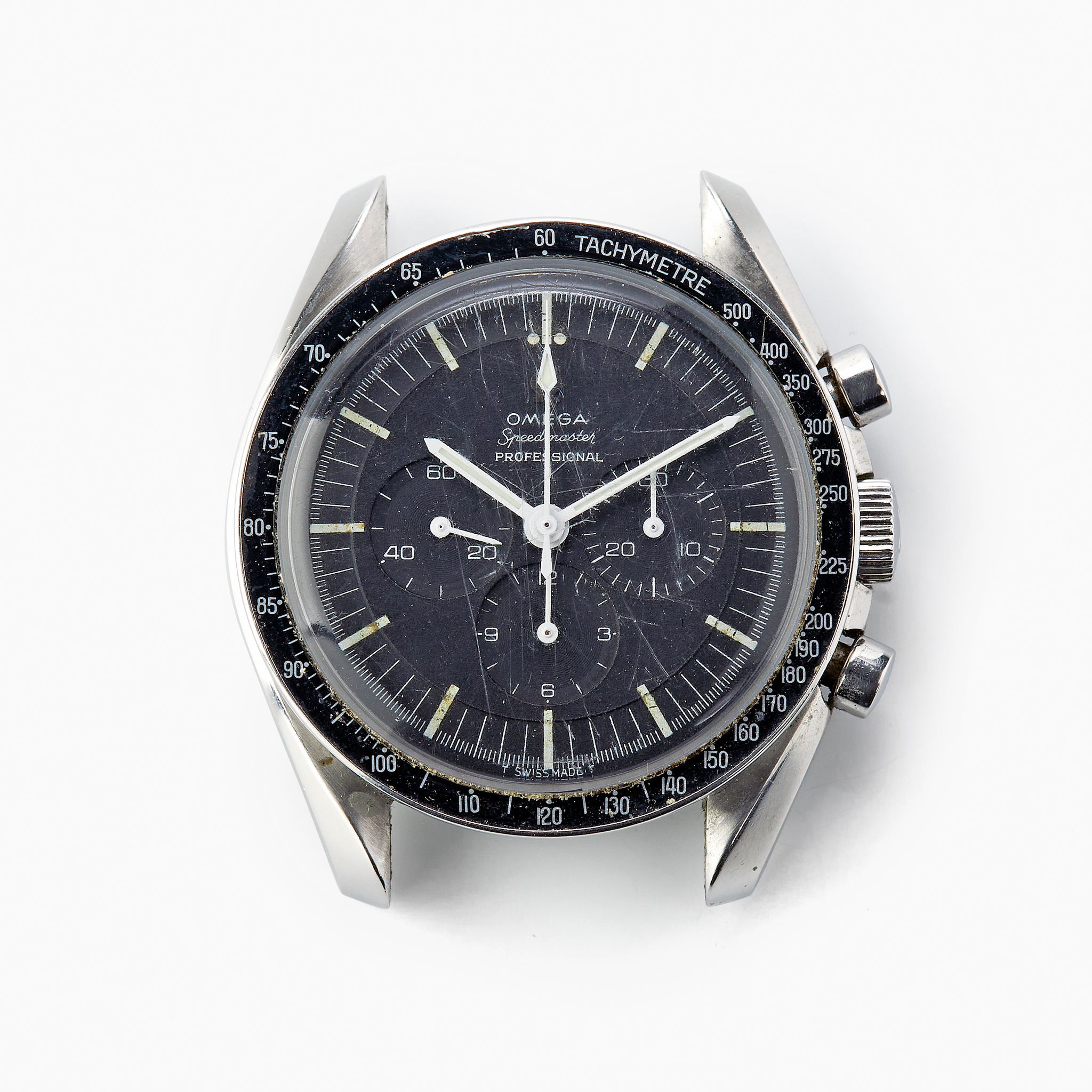

Hello,
I just bought this Speedmaster 105.012 from 1966.
I Would like to buy the correct bracelet since it is head only.
Which bracelet is correct for this reference? If someone here is selling one i am interested.
BR,
Albin

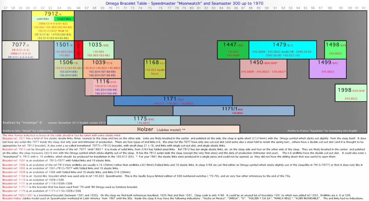

Here's a chart that will help. Also, you may want to familiarize yourself with the forum's WTB policy.

Thank you Very much, i sure Will.

It has lots of service parts already, so I think you should feel free to pair it with whatever bracelet you prefer. The 7912 or 1039 options are expensive.

Agreed. The watch is not fully original, so not much point in spending a small fortune on a period correct bracelet.
