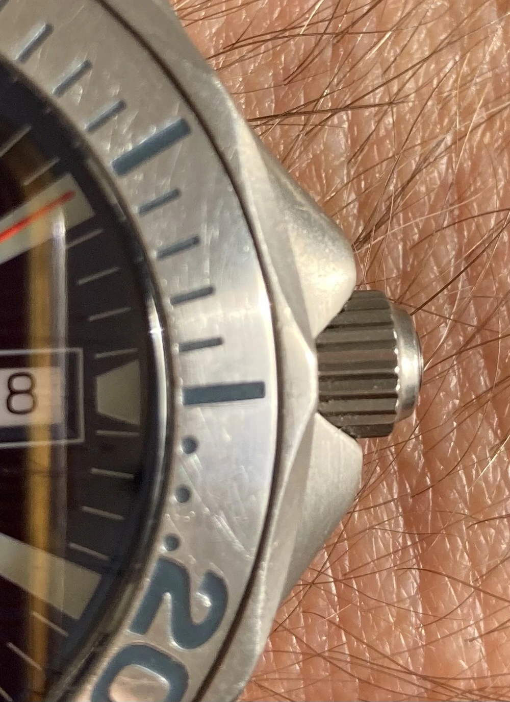

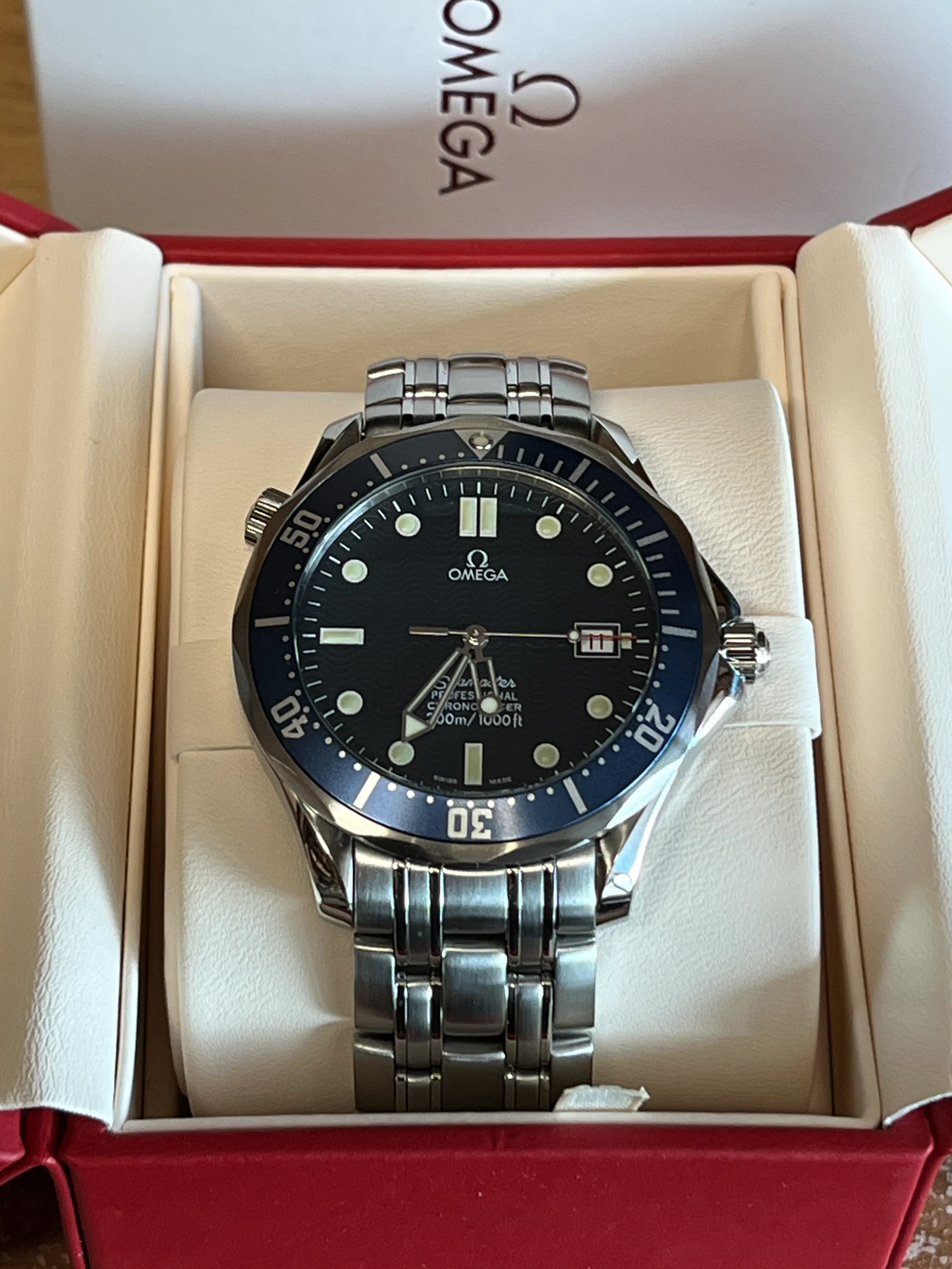

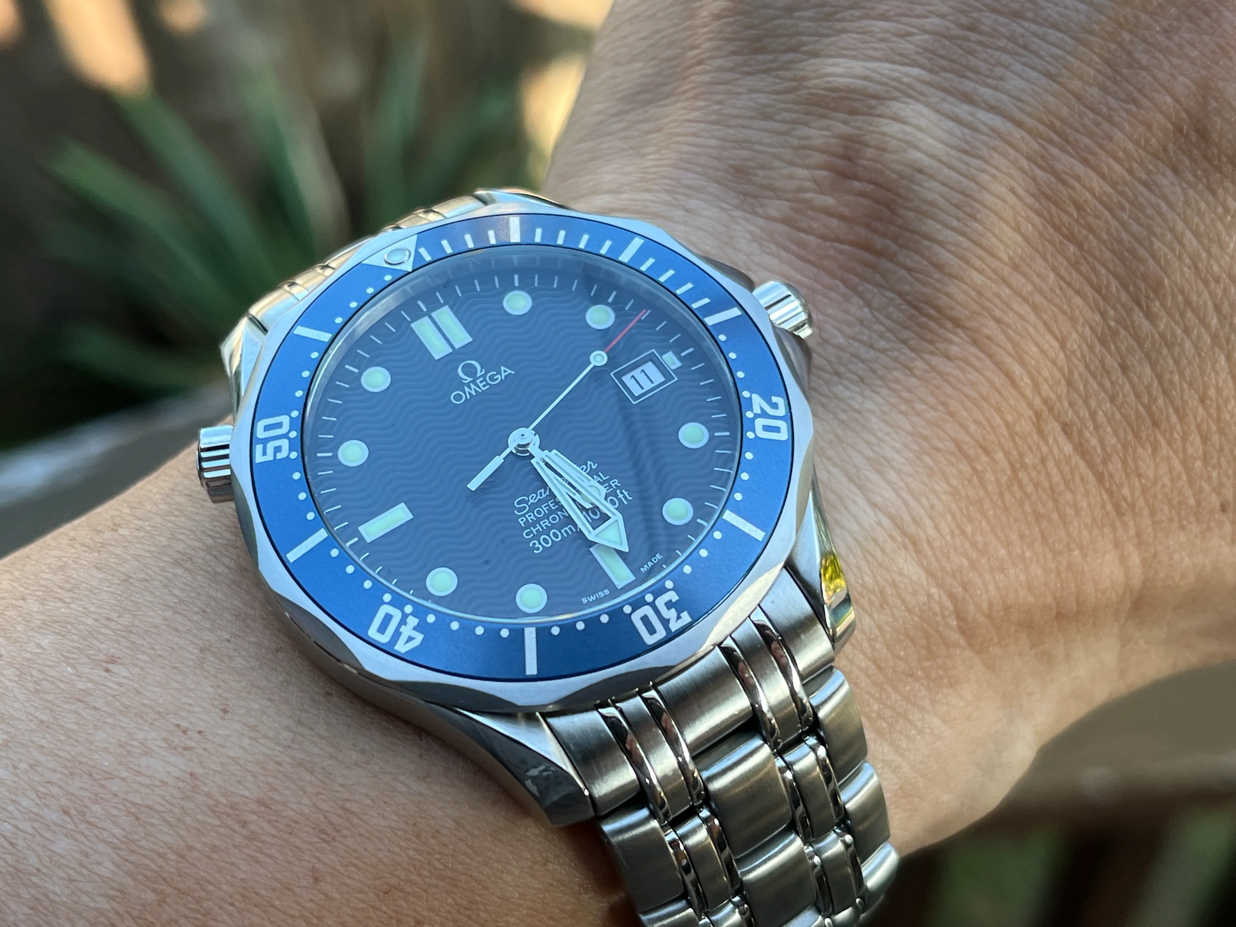

Hello fellow Omega enthusiasts! This year I took my Omega SMP Bond (2531.80) to the local Omega Service Centre for a full service. The process took about 10 weeks, and I think they did a really nice job. One thing I noticed is that the crown no longer screws down so it is flush with the case. I discovered this while setting the time to the atomic clock. I went back to the service centre and they explained that on older Omega models, some of the parts are no longer available and Omega now supplies "updated" or "replacement" parts, which resulted in my crown no longer screwing down flush to the case. They further explained that this does not affect the performance of the watch, as it still passed the water/pressure test. To be honest, this issue is hardly noticeable, but I (being a watch nerd) notice it of course.
My question to you (more knowledgeable folks like @Archer), does the above explanation from the Omega Service Centre make sense? Anyone else experience this issue?

Interesting, but never sent mine back to the mothership for a service. Mine were by a local watchmaker and didn't notice any difference. Probably didn't replace the seals the last time, so didn't notice anything different.
342
538
Probably due to a new seal on it.
That does make sense. I wonder if the new seals/gaskets have changed? They did replace the crown but it looks identical to the original crown which they returned to me in a bag full of other parts that were replaced.

From the angle of your original photo the gap between the case and crown seems only barely noticeable, but if it is due to Omega moving to newer spare parts, I presume this is a fairly recent change. My older SMP (albeit in titanium, so might be different parts availability) was serviced at the UK Omega Service Centre last year and the crown still screws in fully flush.

Did they change only the crown? My opinion is that the gap could be due to new crown model inserted in old crown tube model.
545
1,302
Archer will come in with the true magic knowledge but I can tell you my 1998 2541.80 originally had a soldered crown tube, the modern service kit involves a threaded one so they had to use a special jig to tap the case for a new tube. May be related?
In short, no.
Did the paperwork you get back indicate the specific case number for your watch? There were 3 different versions used, so it would help to know what case number yours is. It will be one of these 3:
168.1503
168.1603
168.1623
All three cases show that the specific case tube and crown are still available, so nothing is discontinued that I can see, and these parts have not changed for the last 15 years at least.
You can have issues if you mix the wrong case tube with the wrong crown, but that is not a common cause of this sort of issue. Keep in mind that a crown that doesn't screw down fully can be caused by very simple things - the most common cause is that the winding stem was replaced and was cut just a bit too long, which is likely the case here.
The "new seal" as someone suggested won't have anything to do with this, and the seal contacts the outside diameter of the case tube, and there is no seal that contacts the face of the case tube (the only way a seal would cause this).
The service center was correct about one thing - this will not affect the performance of the crown. It will still seal just fine, even with the crown unscrewed and pulled out to the setting position.
If the gap between the case and crown is excessive, has to be judged by looking at if from the case back - that is the only way you can really see what the gap is, without the bezel getting in the way. If you can show a photo of the back that clearly shows the gap, I can tell you if it looks normal or not.

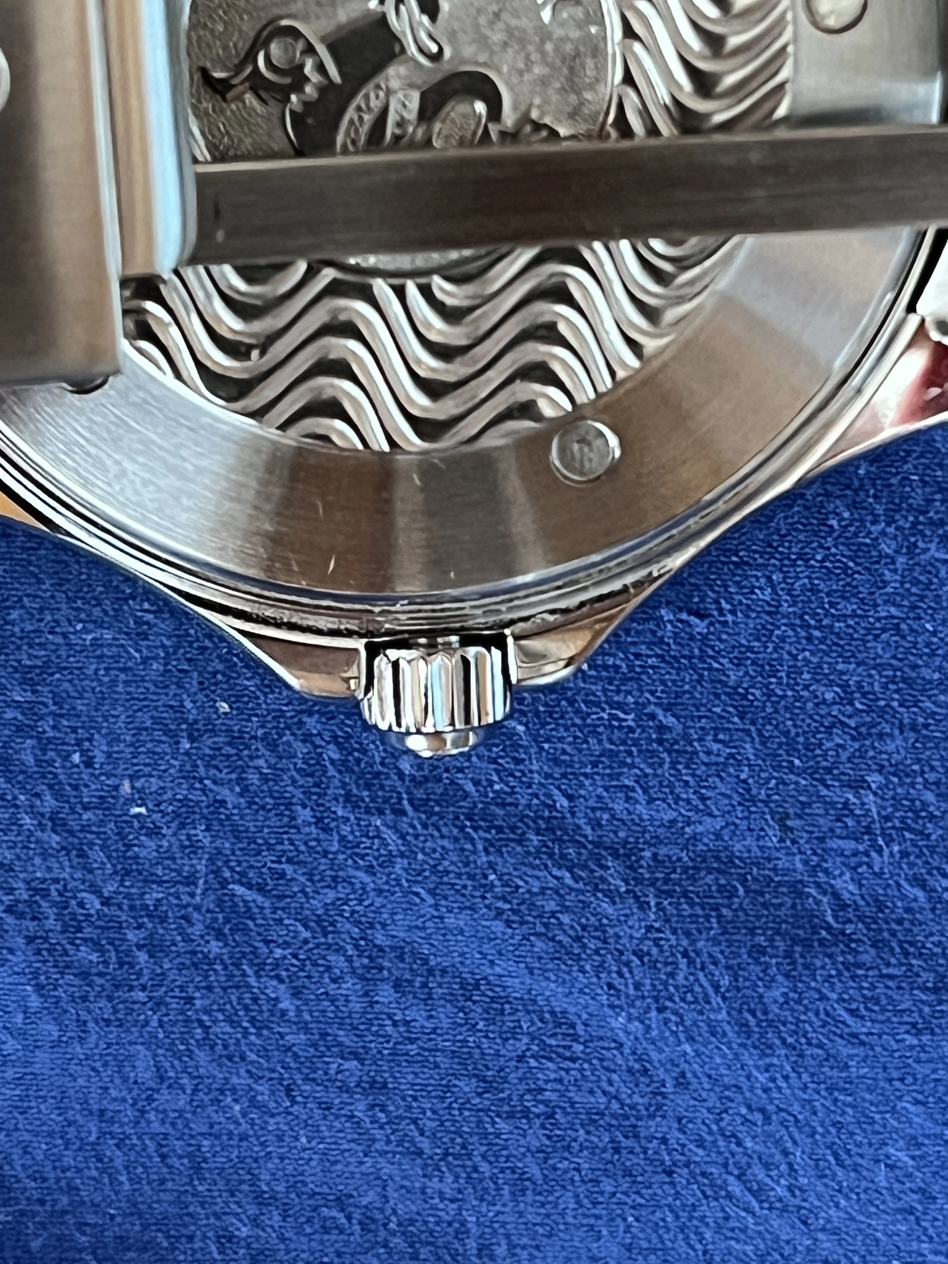

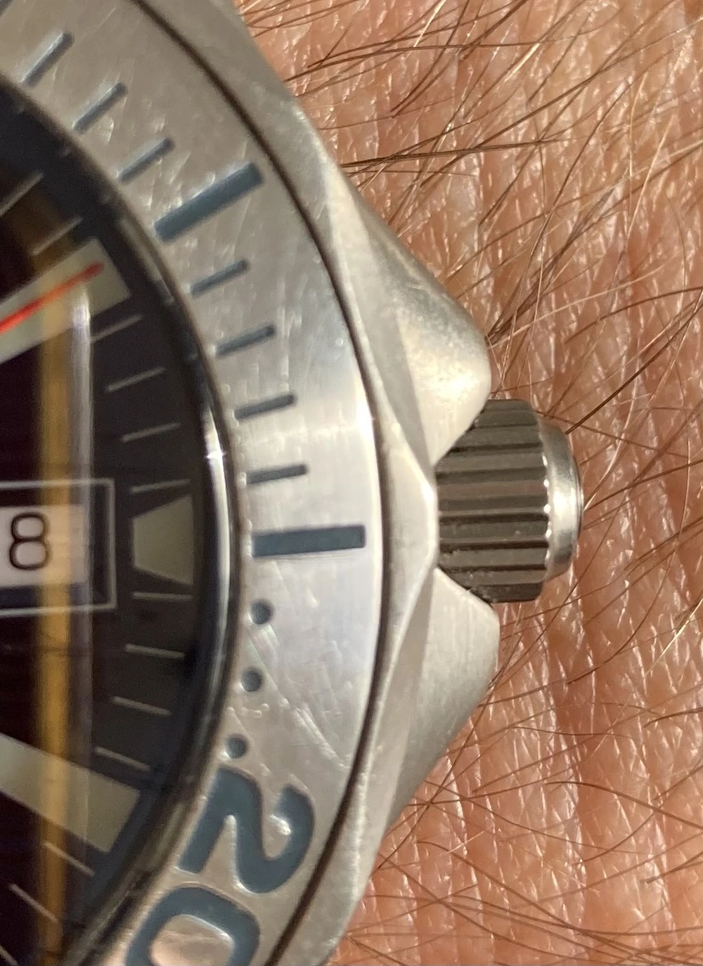

Thank-you @Archer and others for replying. This is quite educational!
Unfortunately, the paperwork I got back is just an invoice showing I paid for a complete service by Omega. There's no detailed information such as the watch case number. Just some general information that they conducted a complete service, water resistance maintenance including crown, gaskets, valve, and set of hands.
I received some "old" parts back including the original crown and He escape valve/crown, bezel spring, hands, and some gaskets.

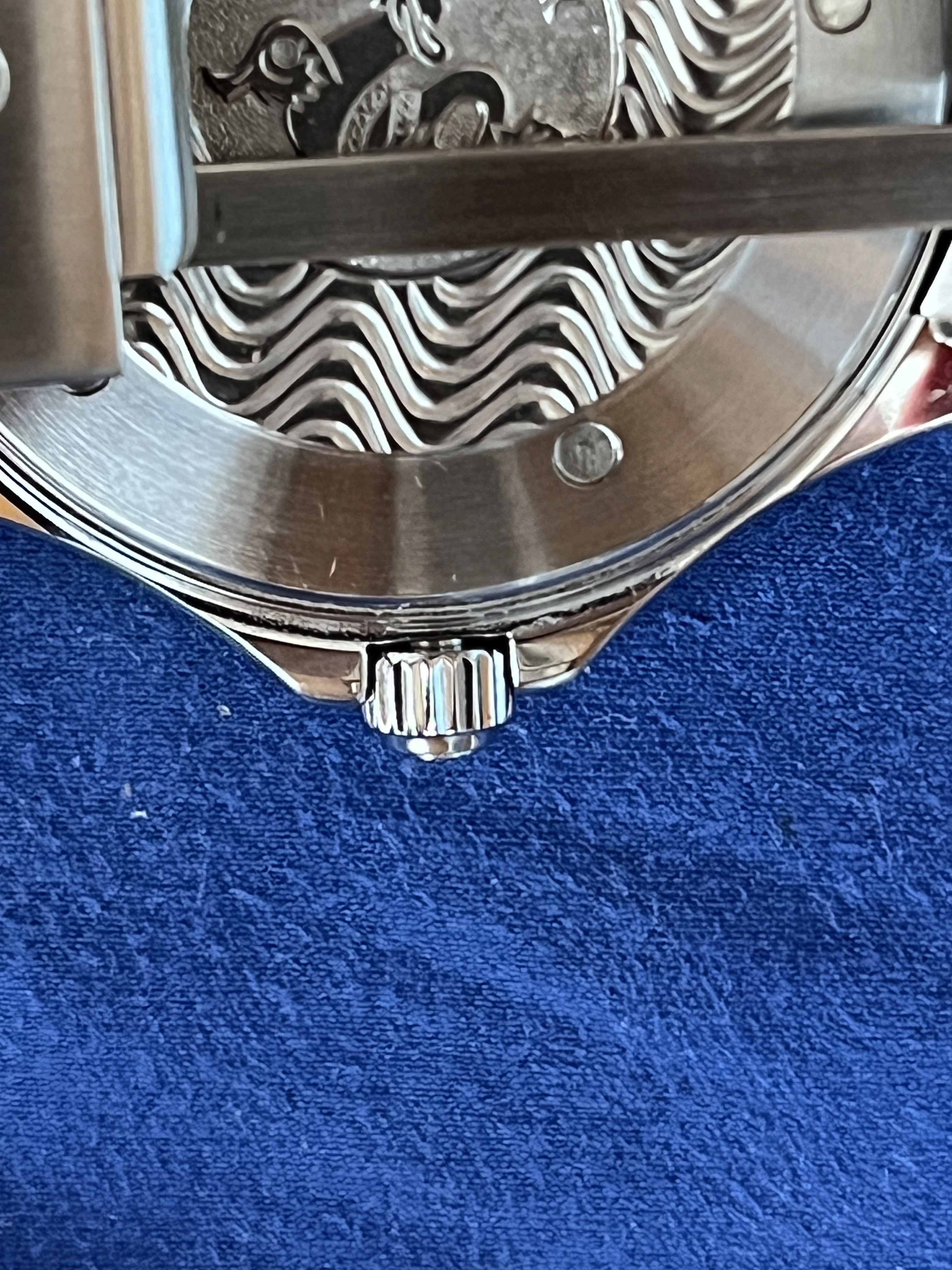

I'll include a photo of the case back. You are correct. The gap between the crown and case is more prominent from the back. Your explanation of the winding stem being a bit too long is interesting. Would this be an easy fix? I certainly paid handsomely for the service, as I elected to to with Omega over an independent watchmaker.
Thanks again.

I'm 100% certain they cut the stem too long. It's not a difficult fix.
29,079
75,151
It's out a bit farther than I would make it, but honestly it won't do any real harm - I would just refrain from cranking down on it too much, as this will want to push the stem into the movement.
342
538
Sounds good, thanks! I'm glad to hear that it won't cause any real harm. That would be my main concern. It's hardly noticeable to the naked eye.
