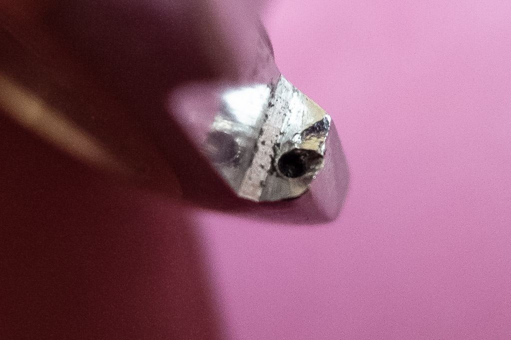

  7. slater529 Jun 2, 2018
    16
    80
    Here is a photo of the tear out...
    The other side looks ok...

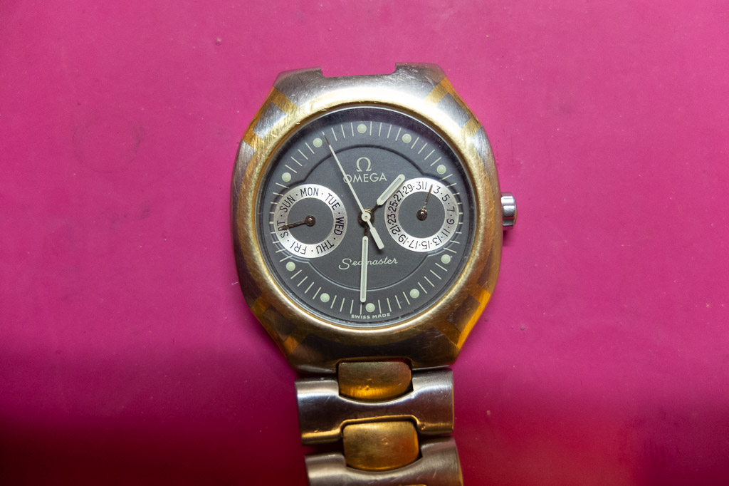

    My watch...

  8. Meme-Dweller Jun 2, 2018
    1,912
    3,009
    Wow, that looks like fatigue in the steel. A repair would work, but it'll likely happen again on the undamaged side, which looks like it's about to go too.

    Nice to see your love for a Polaris. As yours looks like steel/gold, and you are looking at a titanium/gold donor, unless it also comes with a titanium/gold bracelet, there is going to be a mismatch between the bracelet from your original and the donor case even if it's feasible to do a transplant.
    Laser welding seems to be the best option unless you can get hold of a compatible steel/gold donor case.
