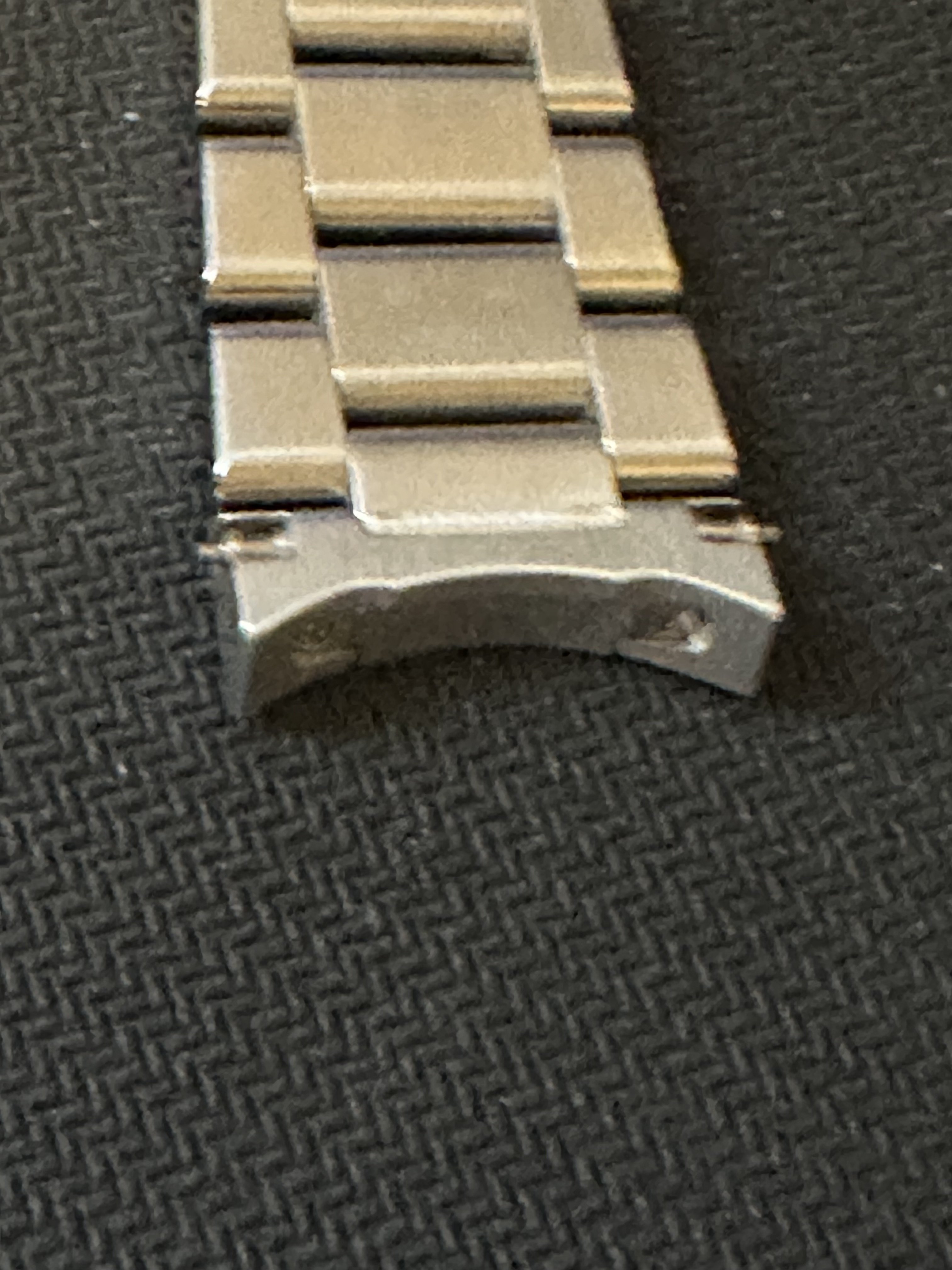

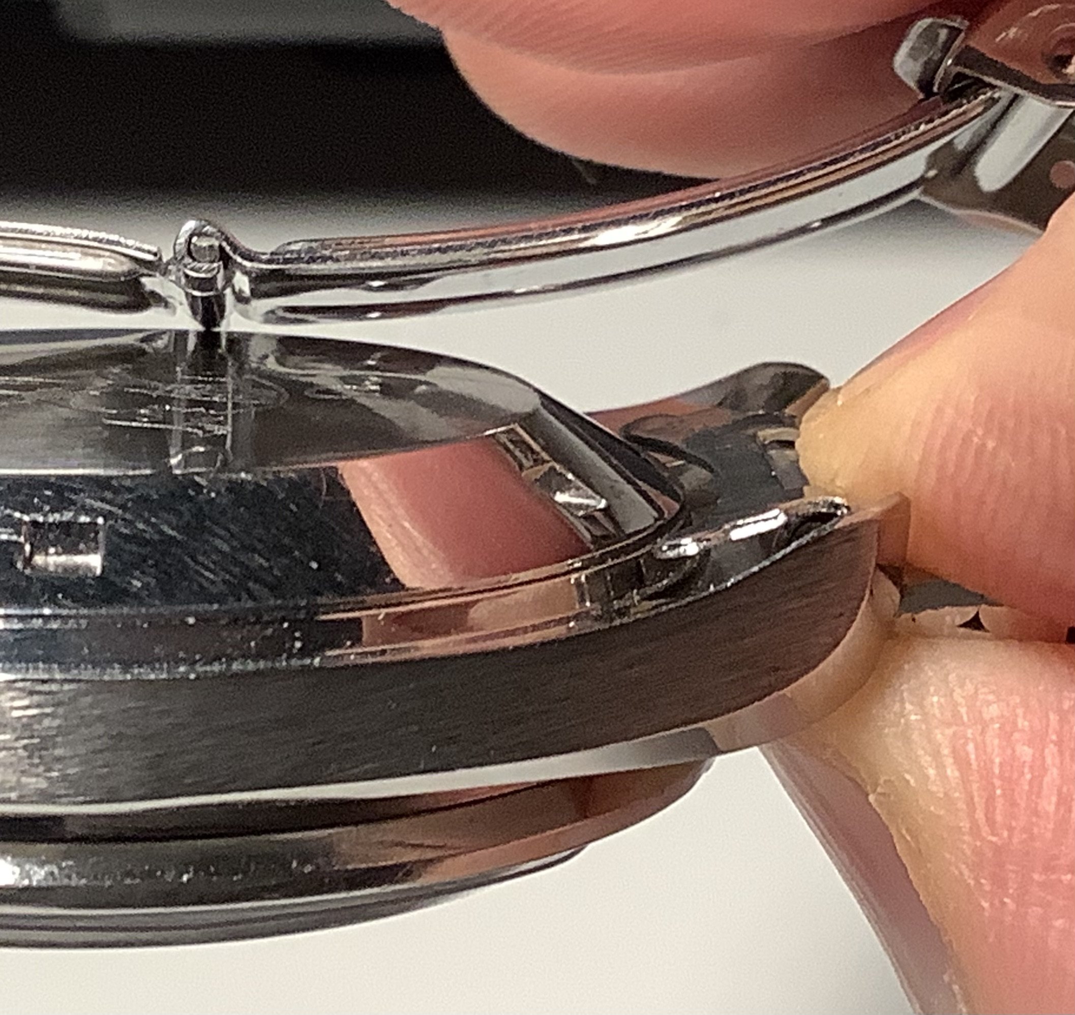

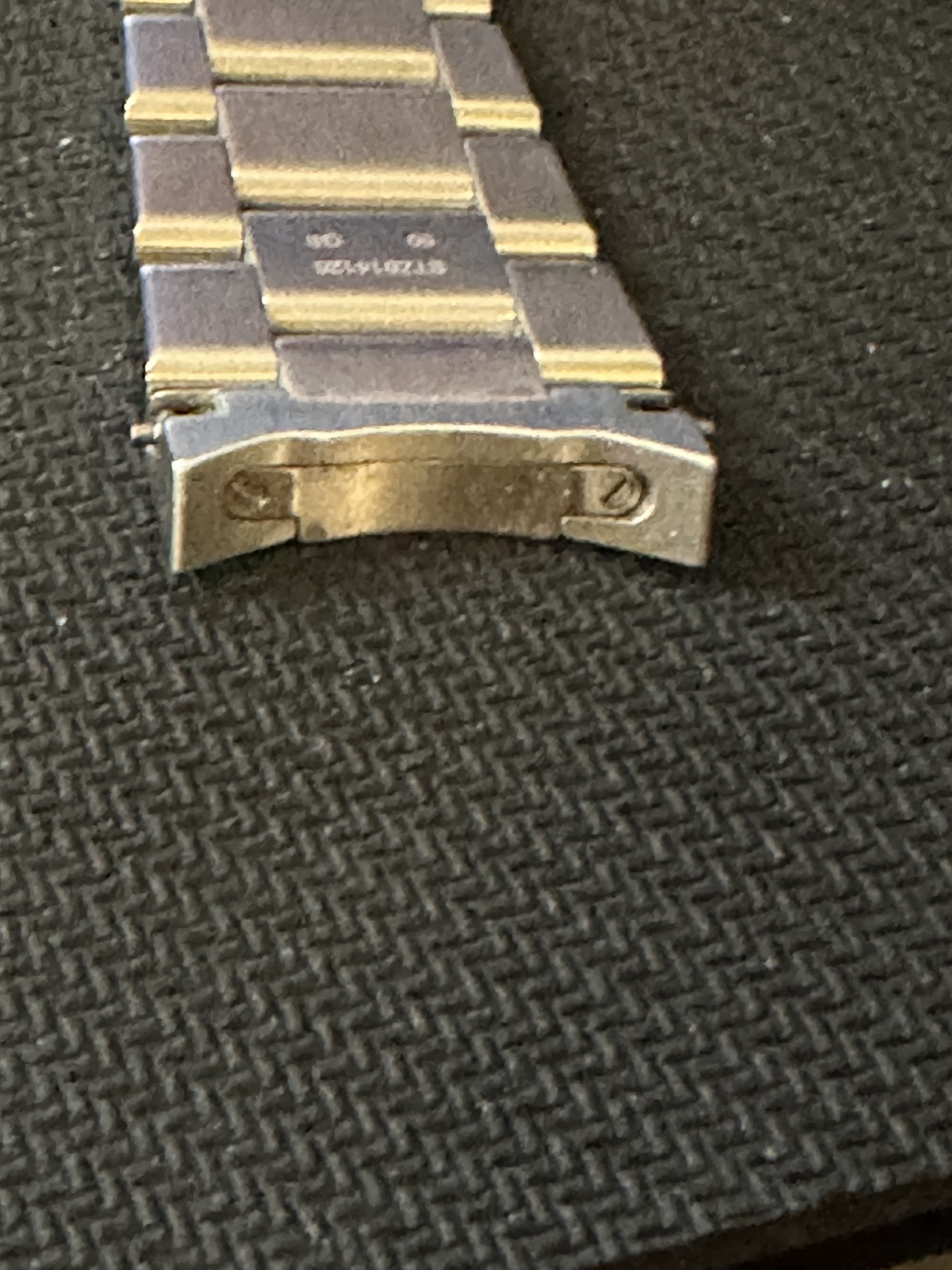

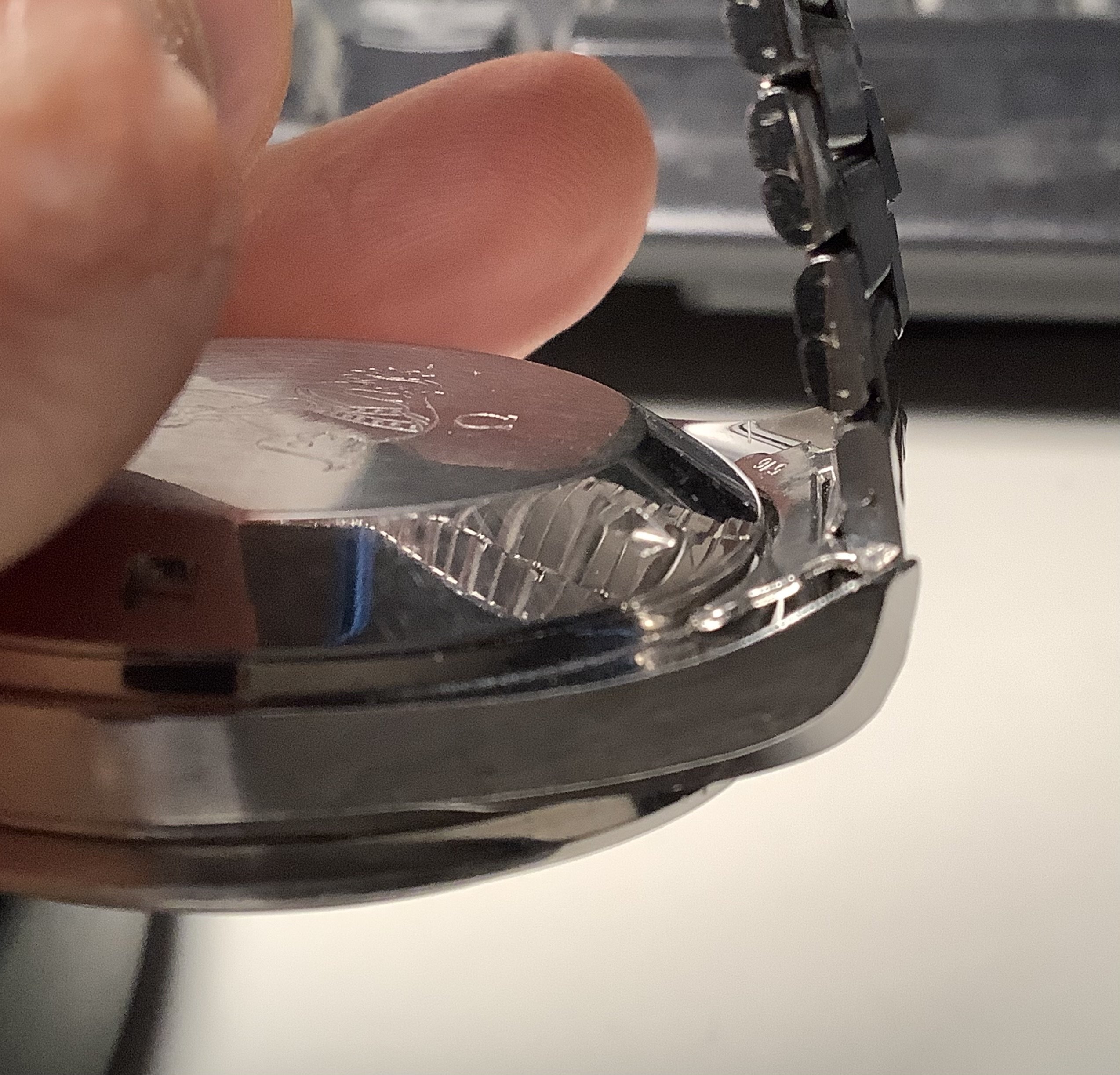

If you have a flat-link bracelet (or a few), I’d appreciate your take on this:
If you look at the little tabs on the back of the end-links, where the reference number is, and where it interfaces with the back of the lugs:
I find that these flat-link end-pieces are rarely firmly sitting against the lugs. In other words, you will see from the photo below that there is a small amount of play, that the end-link can be wiggled, rather than being firmly set.
This is the case with every flat-link that I own. I was curious if yours, too, have play, or are they tightly set. Thanks.

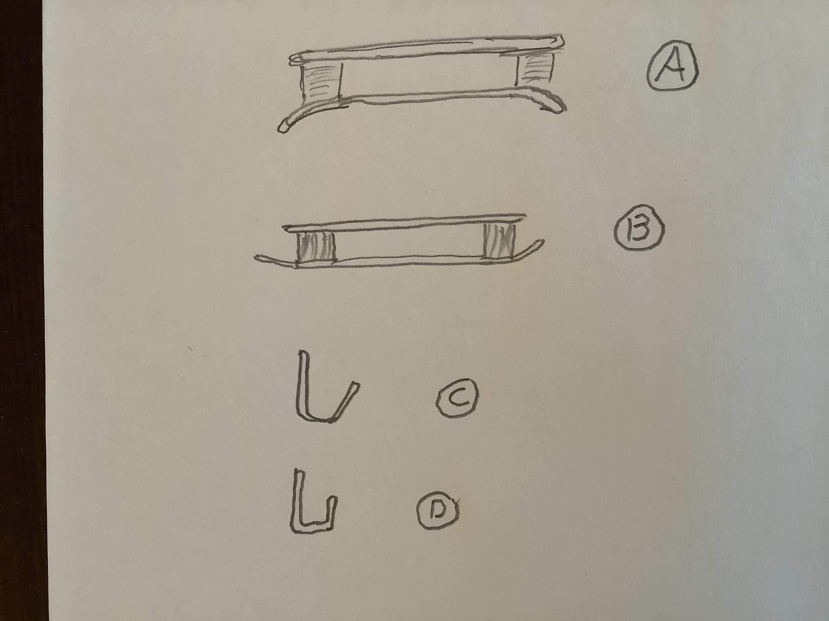

David, does it look like there’s a fairly significant bend in those tabs towards the lugs on the watch from STS? I’ve seen some try to minimize the play as noted below, in “B.” I’ve also seen them bend the entire link in like “D,” but that changes the way it sits in the lugs.
Strangely enough, there isn’t.
I’ve had others where DIYers have clearly tried to bend the links or the tabs as per your diagram B, but it seems more like diagram D was used to ensure a snug fit.

One can always adjust hollow end links with tabs to fit the particular watch by bending them until there is no play. This is not unique to flat-link bracelets. Most people don’t do this, or don’t adjust enough because they are concerned with the metal tabs scratching the back of the lugs. But it can be done with patience so that the end links don’t rattle. At least I’ve always been able to do it.

@M'Bob you can probably adjust your end links to minimize play, a bit. You did not show, but of course there are some end links which have been shaved down.

From my experience, they all have some level of play which can be somewhat controlled by bending the tabs as needed, but they’ll never be 100% snug and tight as solid end links would.
I find that out of all the hollow end links fitted on vintage Speedmasters, Seamasters, etc. the second version of the #6 end links with the wider bottom and interior ‘flange’ have the tightest fit and the least amount of play.
