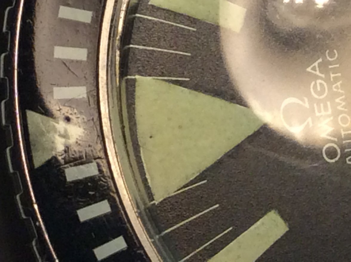

    seller asked me to remove pictures as I ended up not taking the watch

    Yup, looks good.

    Looks good.

    While I’d like to see a higher resolution pic, from what I can see I’ll add a +1 to the above

    Looks like a correct 1966 with correct type C bezel and very nice.
    Is there something about it that concerns you?

    It might have been relumed. The big triangle is quite large on the right side.
    Better pics are necessary for assessment.

    edited as above

    This pic appears to show the correct pinhole found in some original dials?

    Looks ok, no ?
    No pinhole to me.

    Not all had a pinhole, it seems later dials did not have them. The close up pic you’ve provided is a little blurry, but the dial in previous pic (non close up) looks good to me from what I can see
