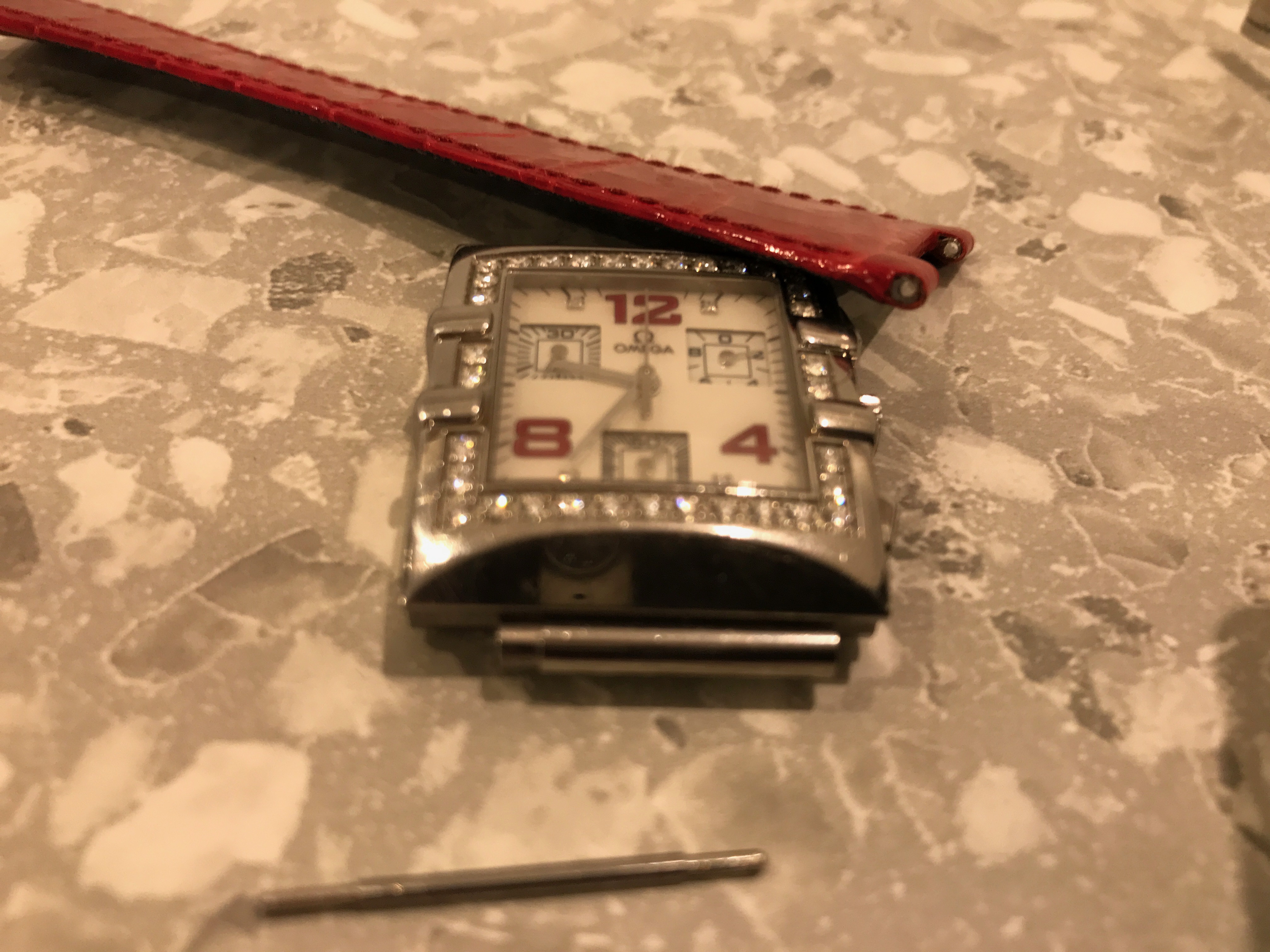

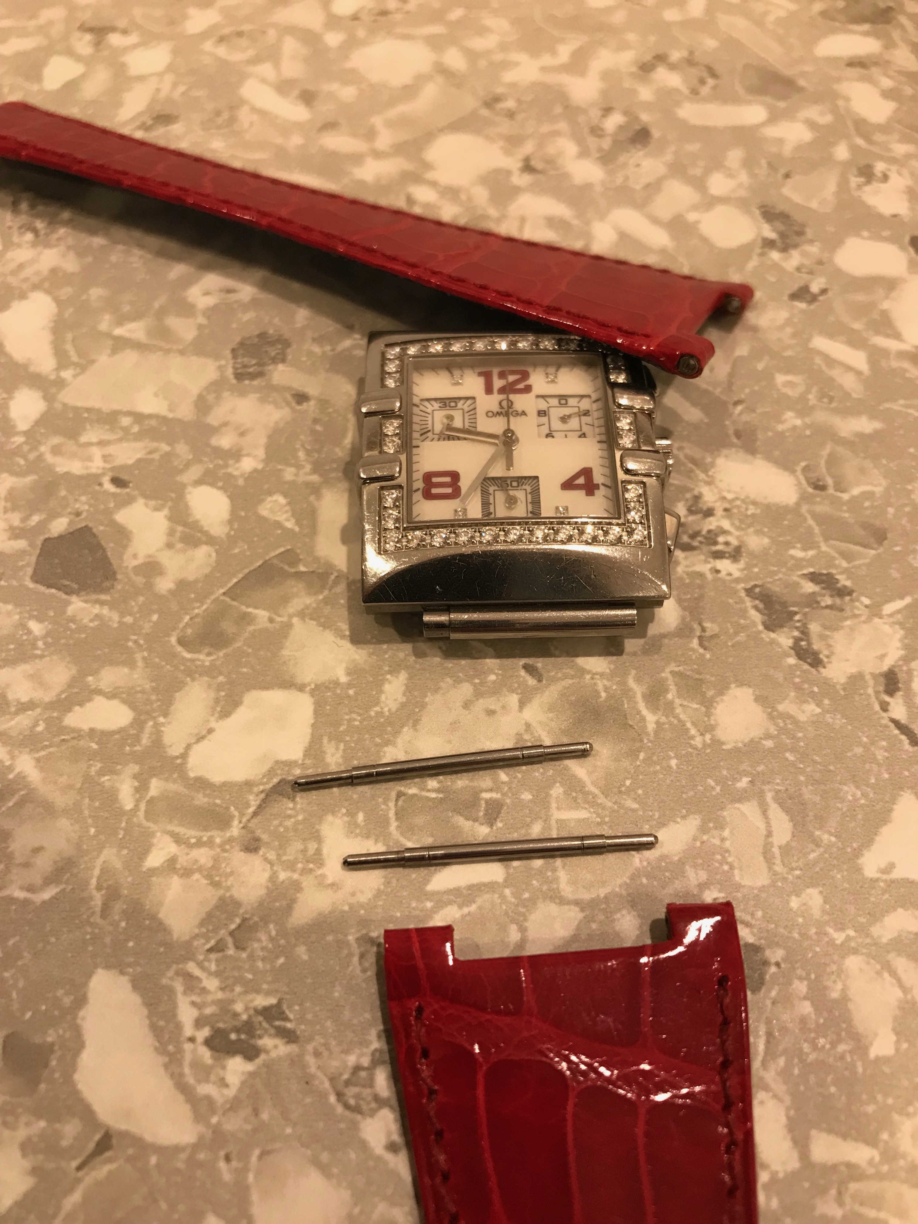

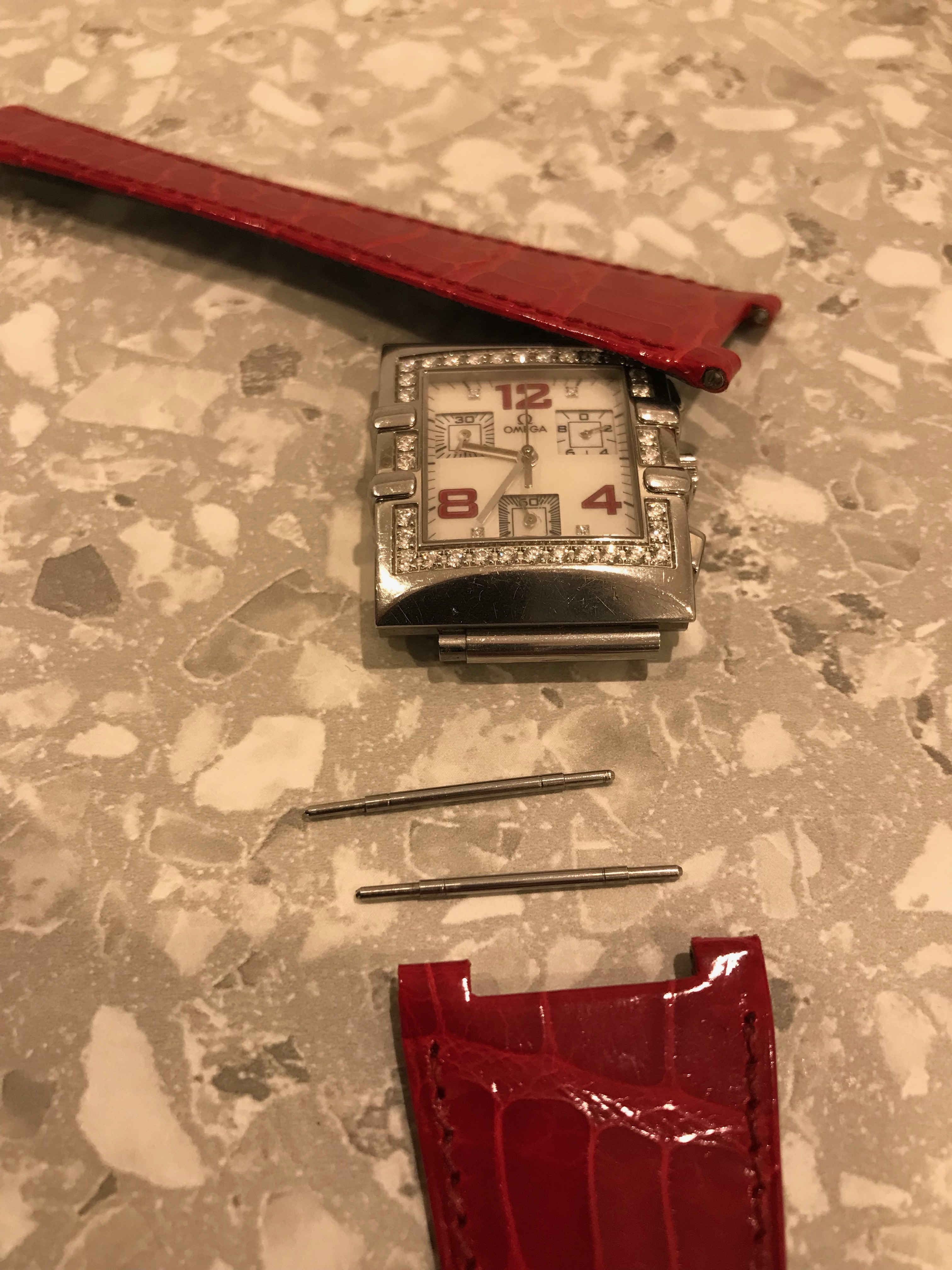

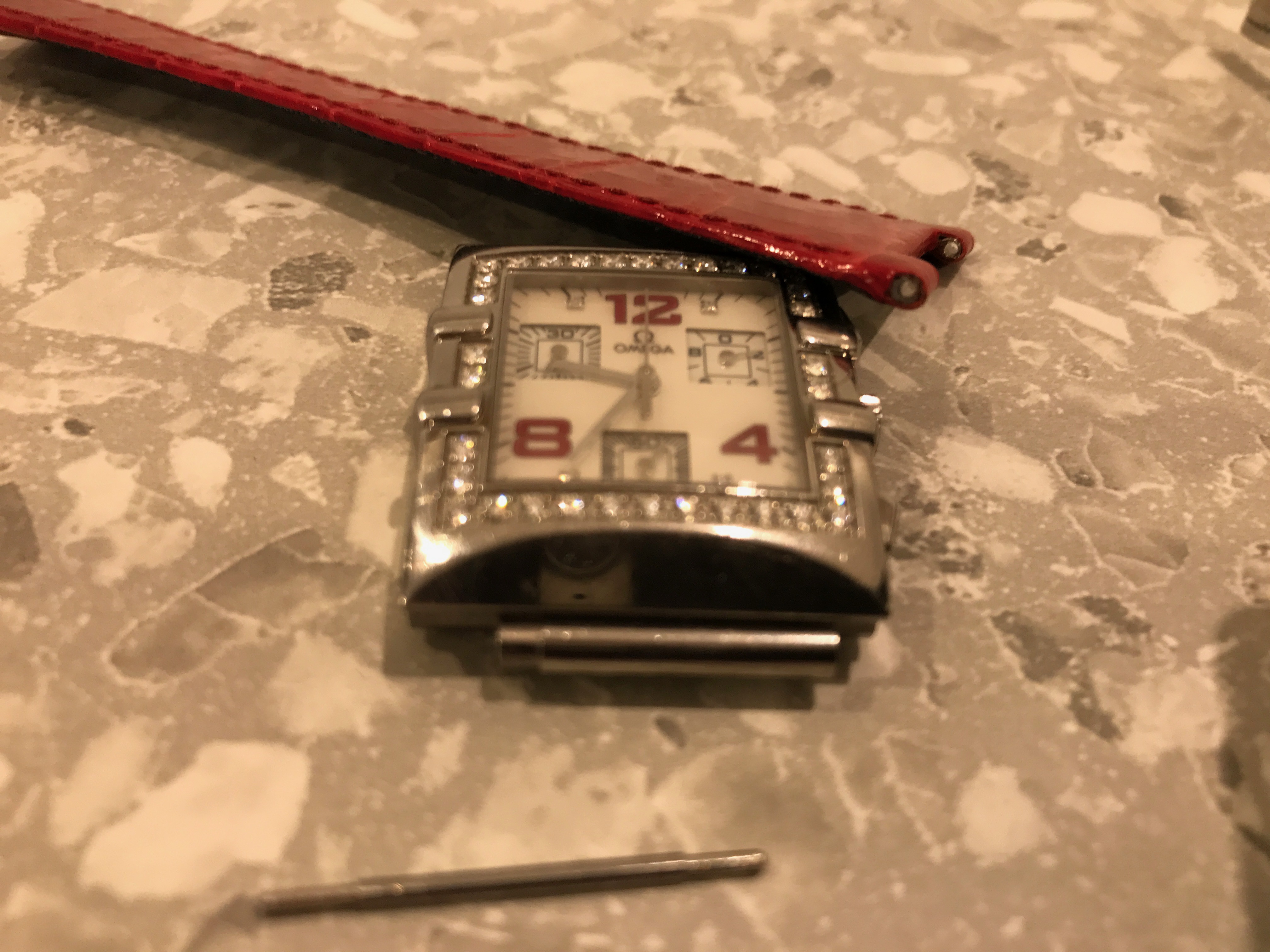

Cant find any help on this issue!! How do I fit my brand new, very expensive, Omega strap to my wife's Quadra? I do not want to force anything. The pins are the original ones. Do they need tapping through? Any help gratefully received.

I can see that there are pipes in the ends of the strap. I've not mounted one of these, but from what I see the pin should be put through the case first, then the strap is mounted to the pin. You would have to put the strap on one end of the pin and tap the pipe onto the pin, then do the same for the other - might be able to do both if you can stand the watch on edge and line everything up somehow.
Note the if the pin and pipe don't have a good solid press fit, you may have to replace the pins. Not one of Omega's greatest designs for holding a strap on to be honest...
Hope this helps.
Cheers, Al

................................ Do they need tapping through?
Are they spring bars?
Do they spring in and out if pressed at the ends?
Nope

I think they definitely need tapping through, I am not brave enough !!
