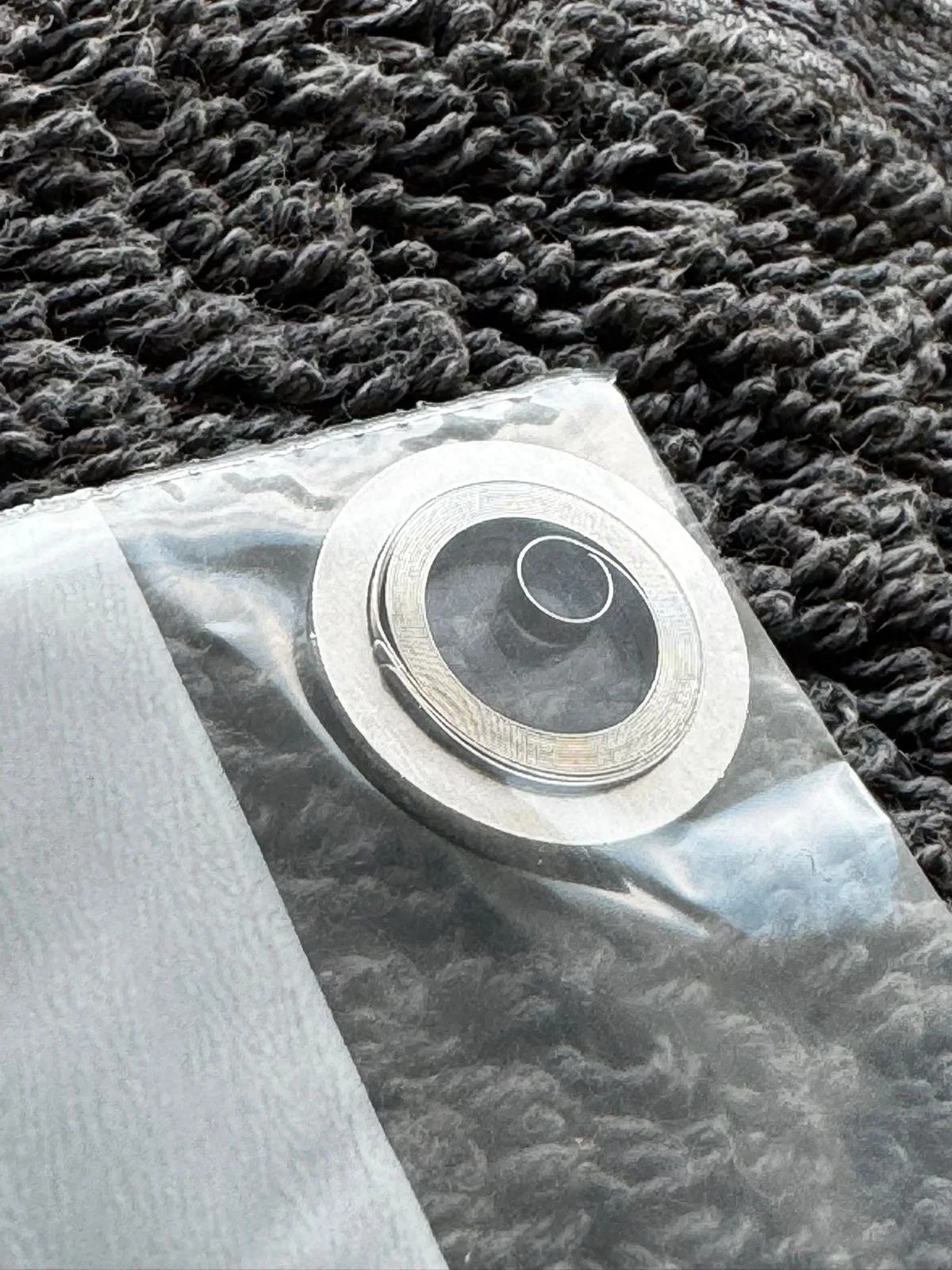

Hello,

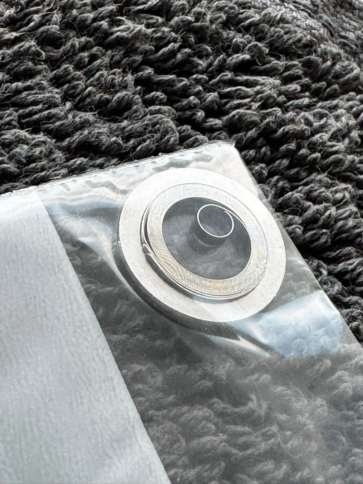

So I ordered 2 new mainsprings (for a 471 and 491) and they were marked as new.
I received them in a plastic bag (even tho they are within the plastic/metalic holder).
The seller mentioned that Omega usually sells the mainsprings in a batch of 10 and that he tooked them from his batch and sent them within the plastic bag.
Now my question is, as I m not quite aware how Omega sells new mainsprings usually, can his mention be true? Or indeed they may be refurbished and sold as new
Thank you

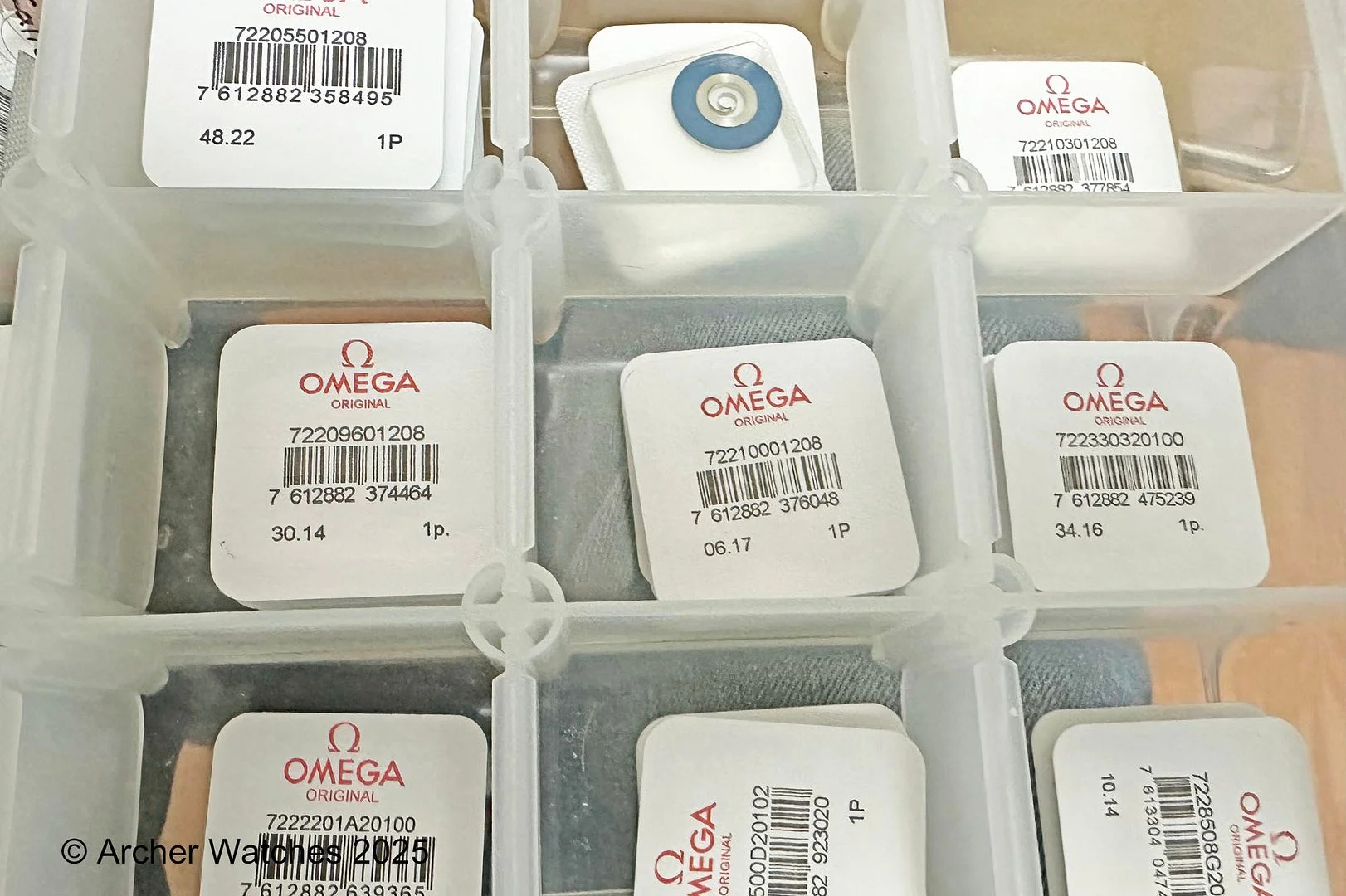

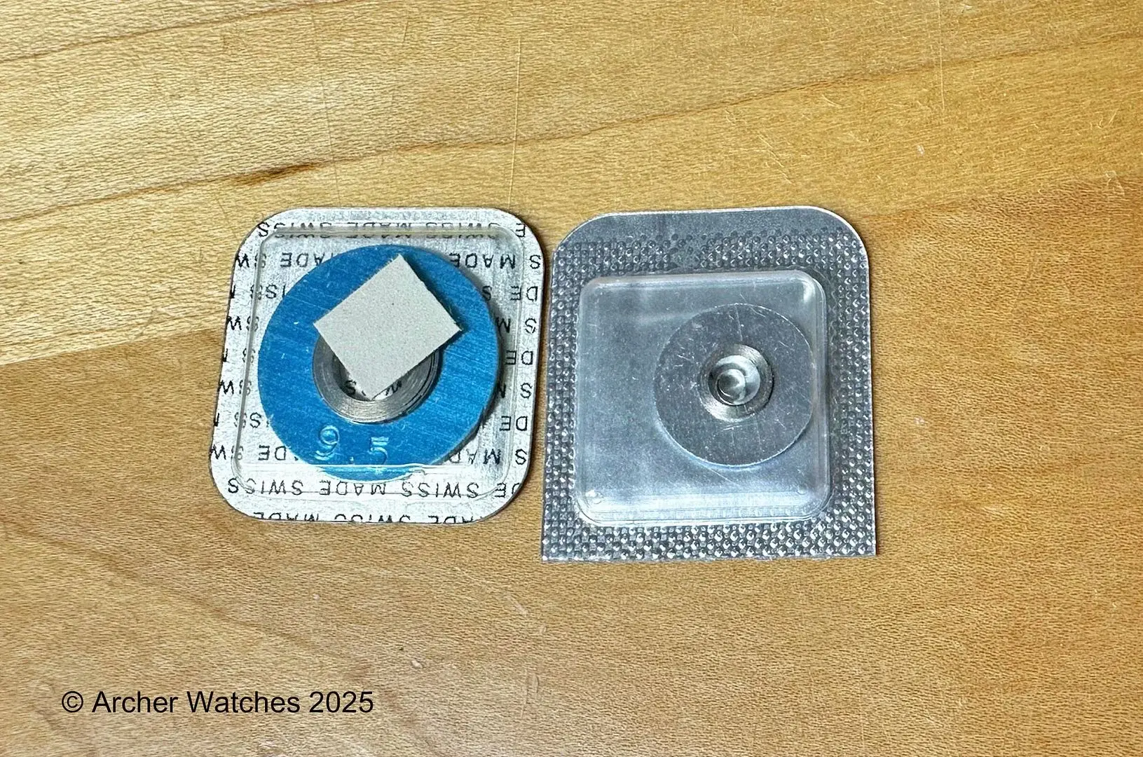

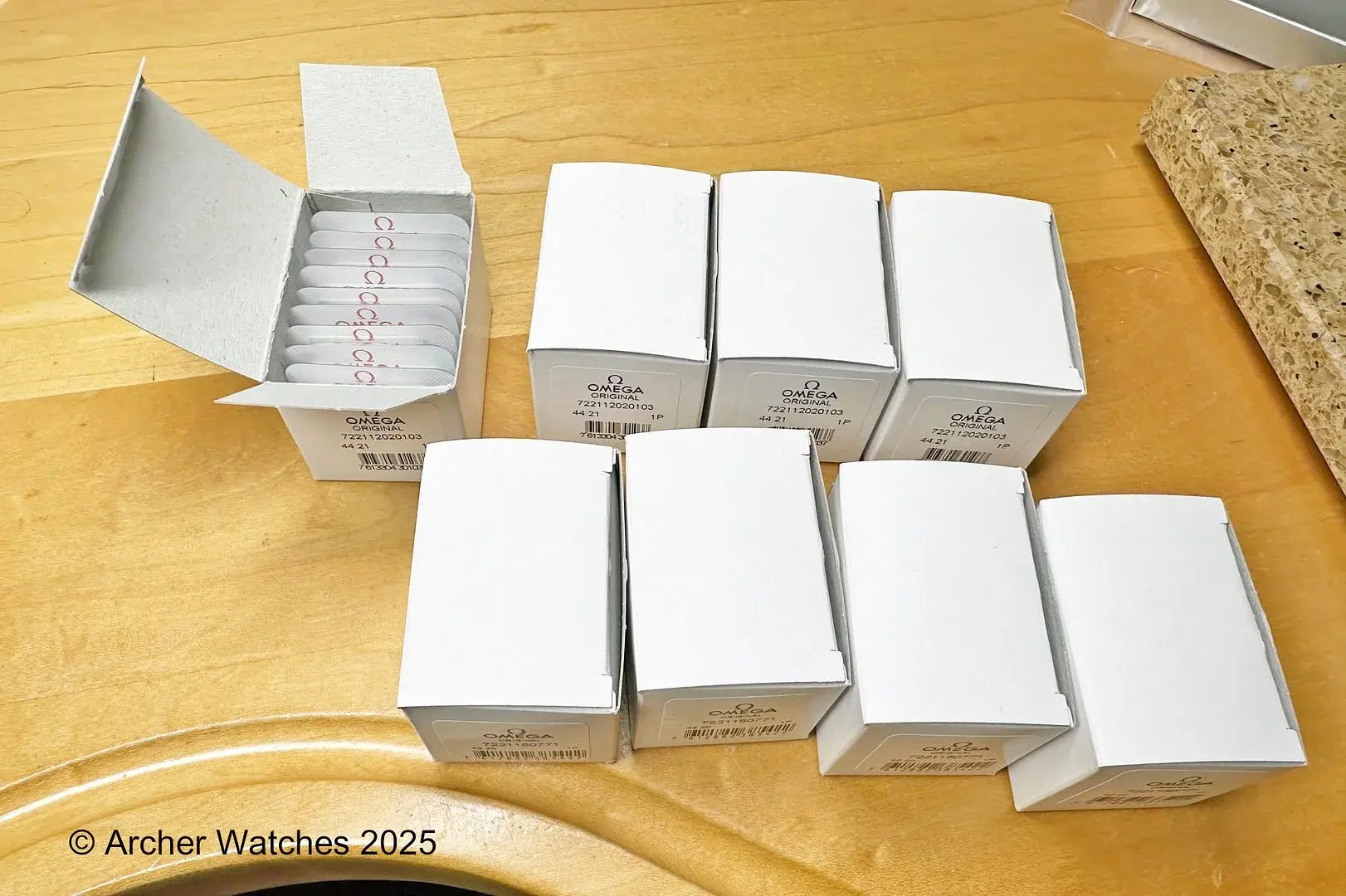

Nope. Omega packages mainsprings individually - they look like this:

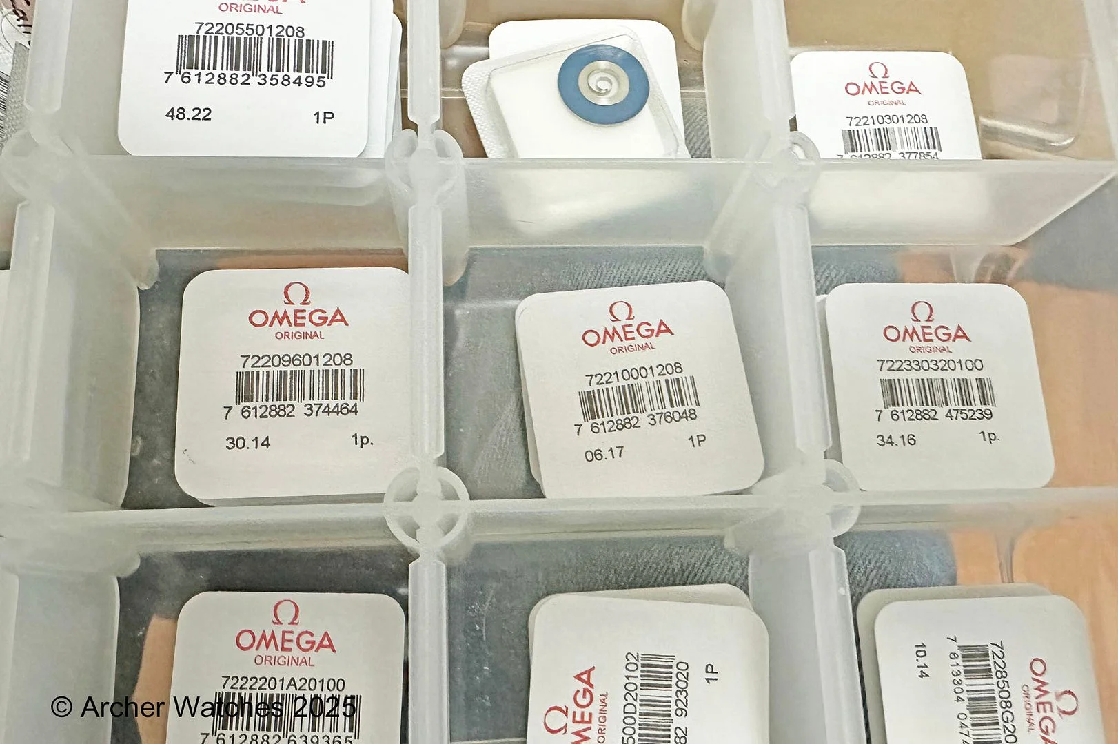

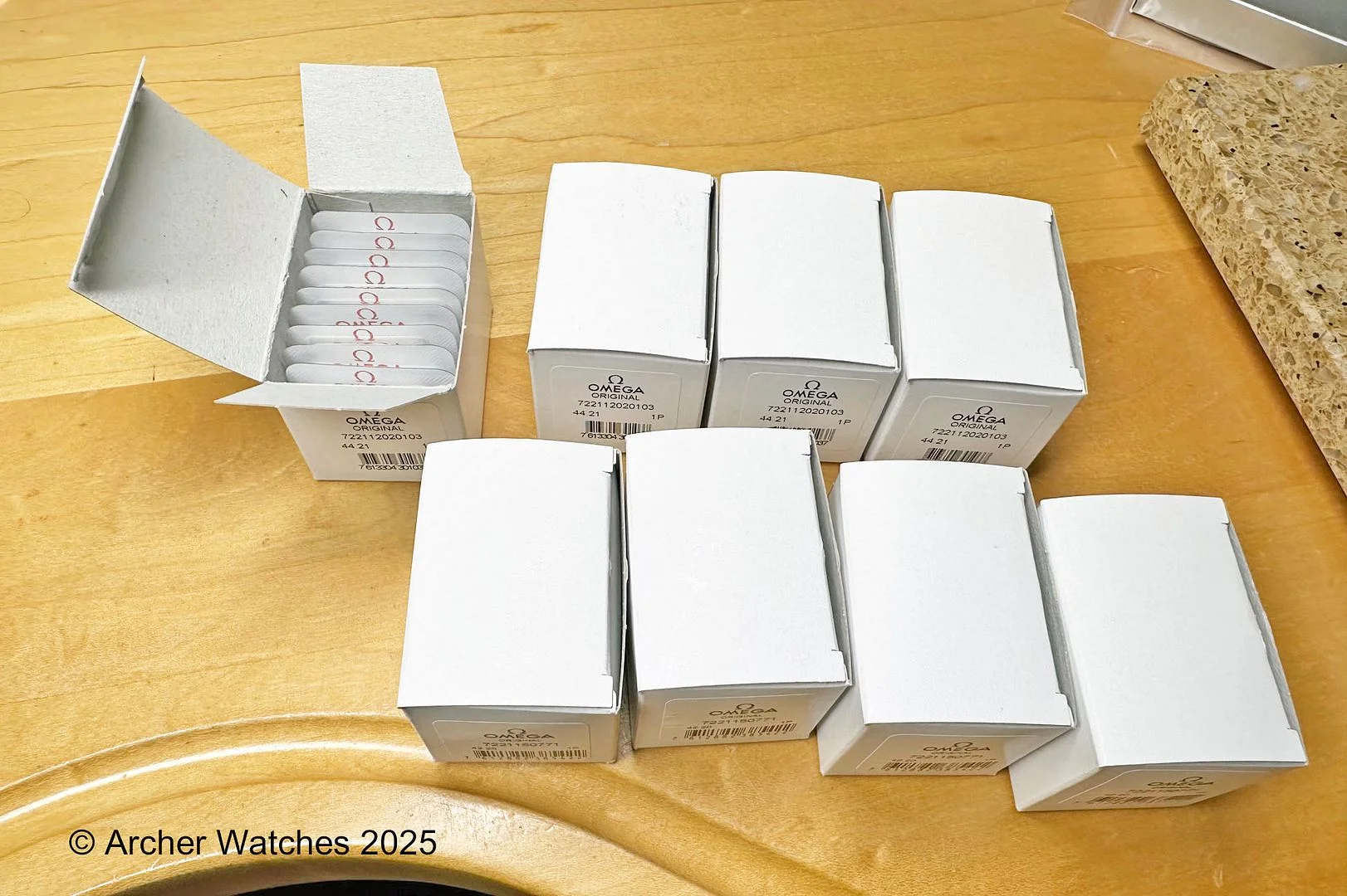

You can buy springs in bulk, in packages of 10, but those are just boxes of individually packaged springs:

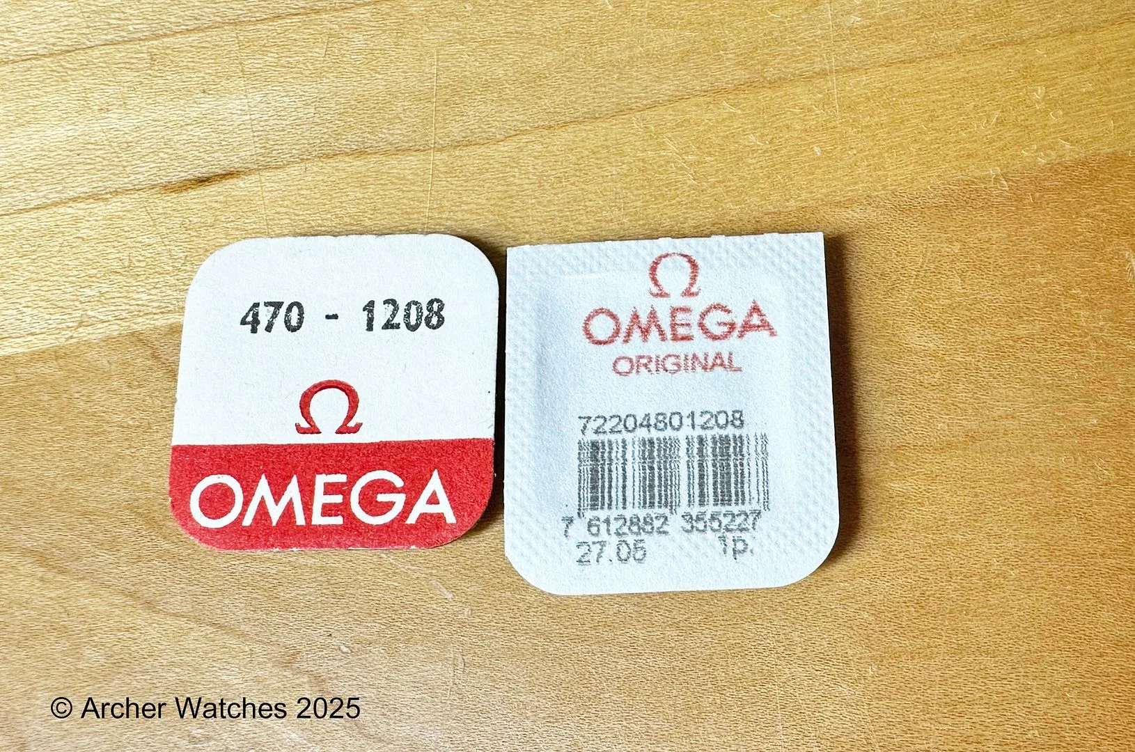

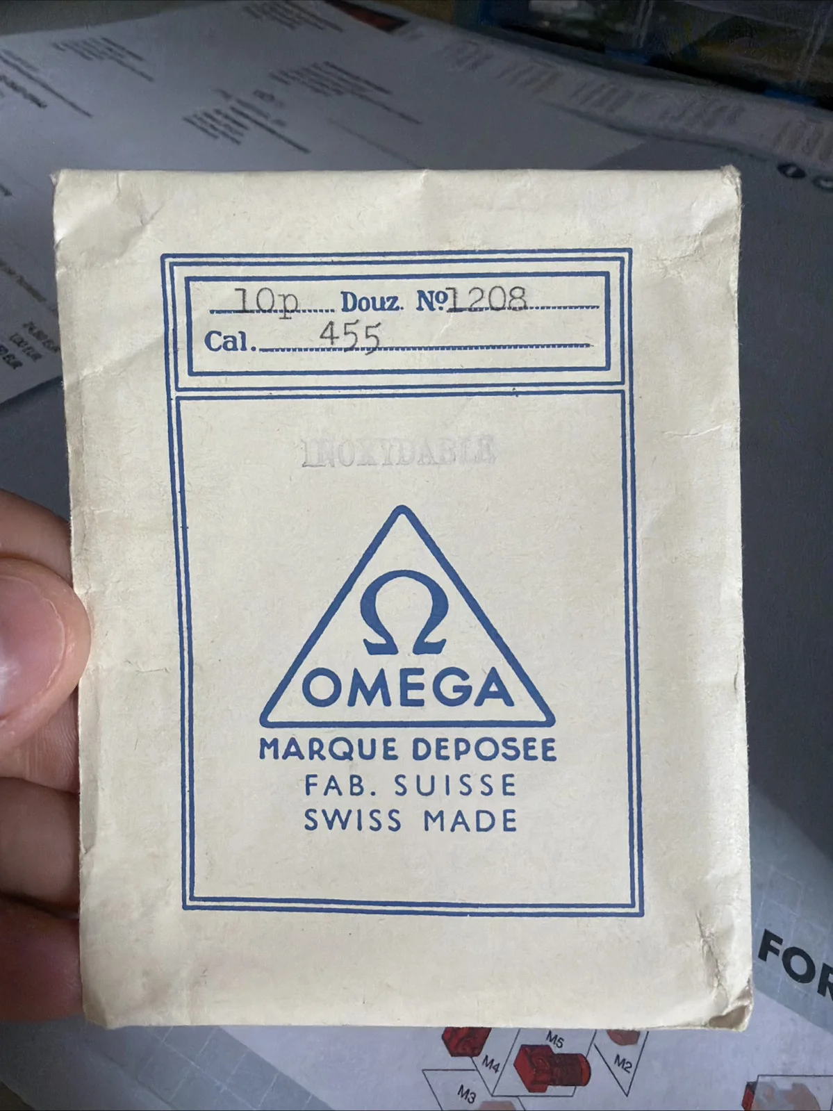

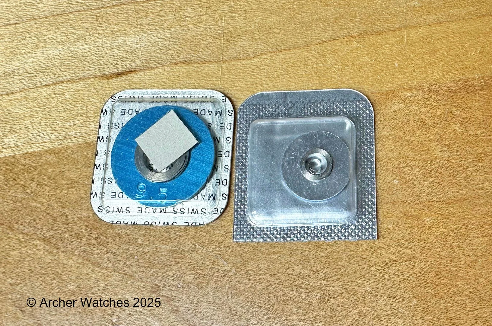

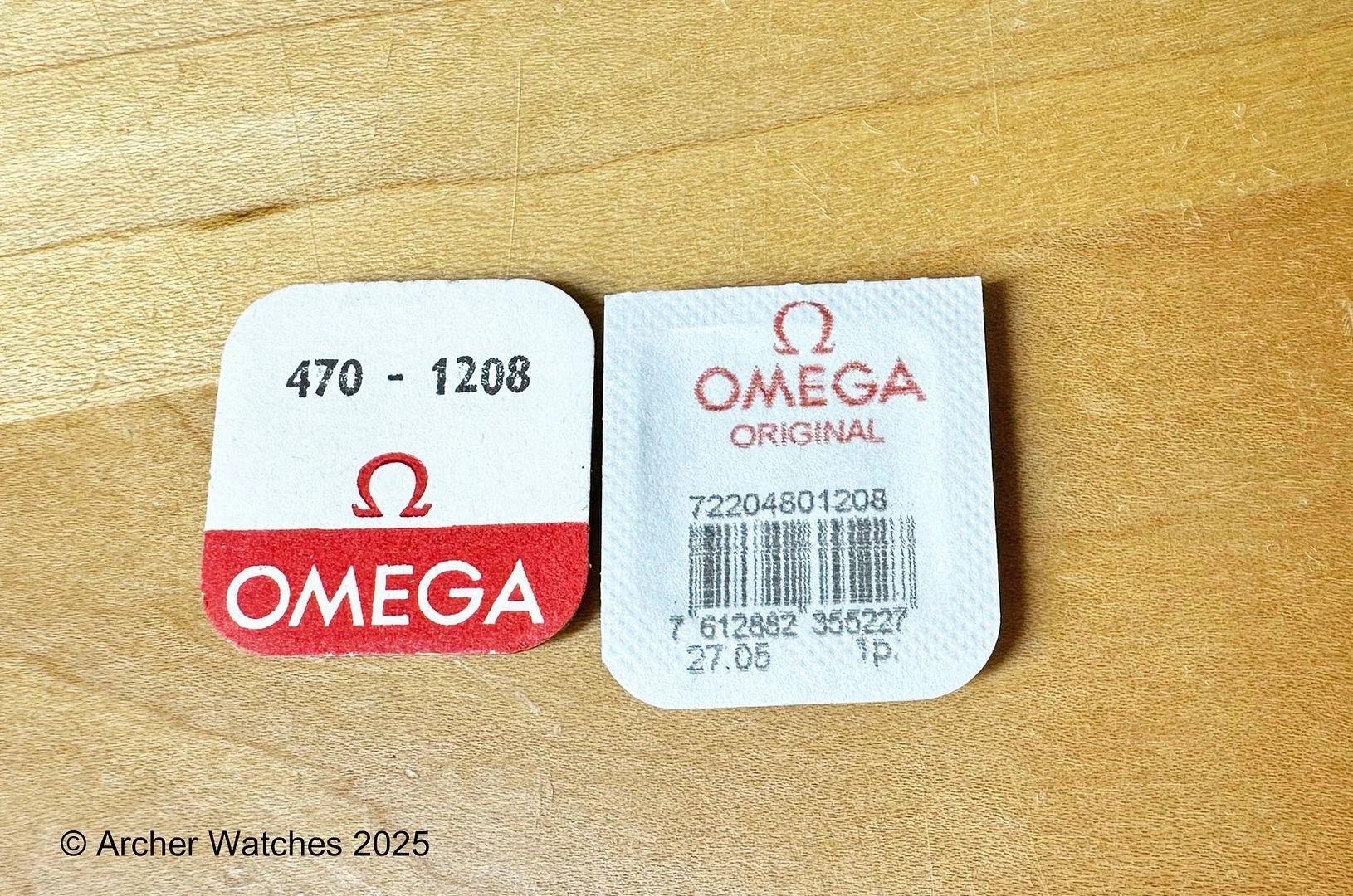

They have been packaged this way for 20 years or more. If you look here is the oldest of the "new" style packaging that I have in stock, alongside the previous era packaging:
The spring on the right has a production date of the 27th week of 2005, which is shown as 27.05 on the package. Previously production dates were not included on the package, like the old style beside it - here is the other side:

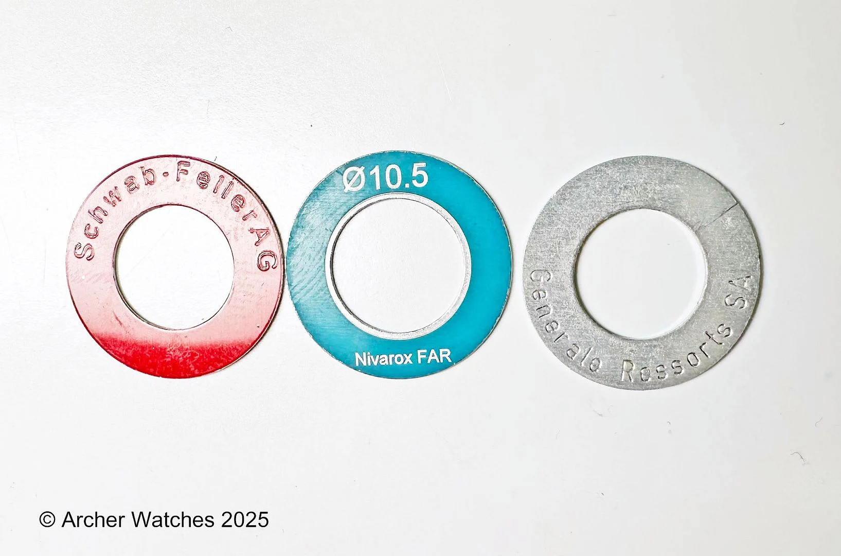

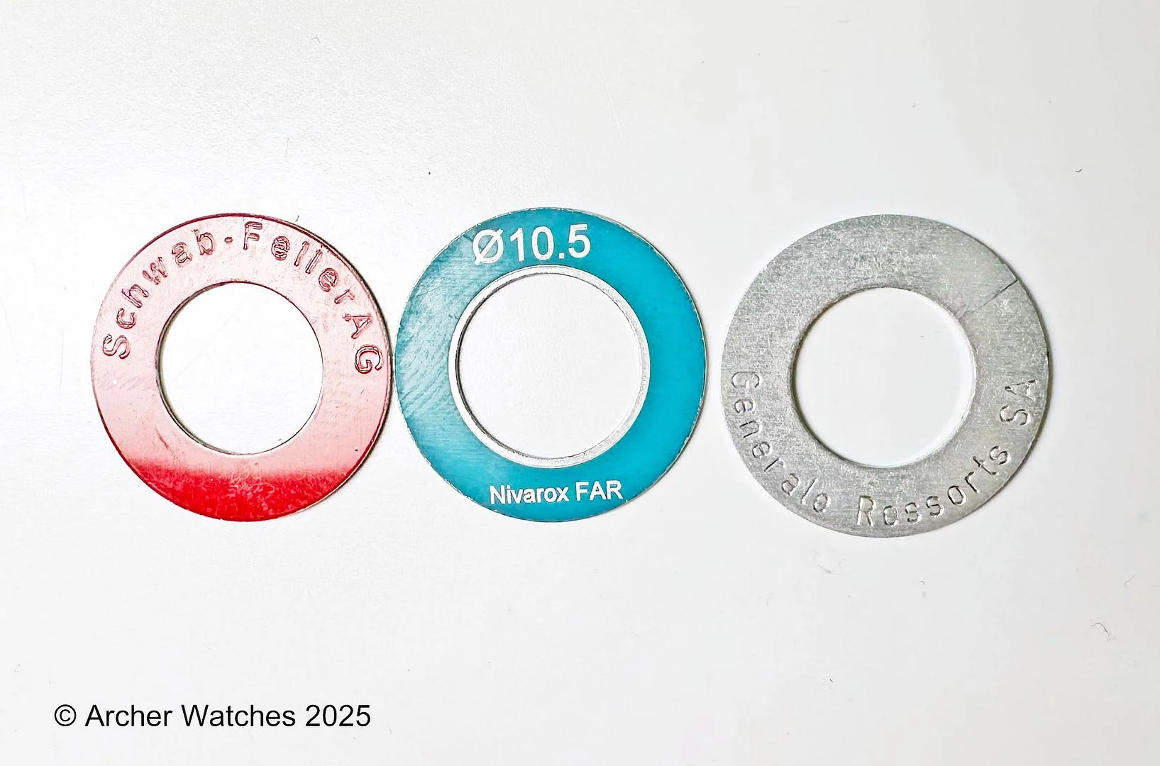

You will typically see 3 manufacturers for Omega springs, stamped on the shipping rings:
Schwab-Feller, Generale Ressorts, and Nivarox-FAR. Some older springs may not be marked.

Thank you @JimInOz , @Archer
The guy is telling me got it from as this batch of 10 pieces and that none of them have on the shipping ring a manufacturer stamp
29,115
75,242
Well, that's really old packaging. Those springs are old enough I would remove it from the shipping ring, and make sure it has the correct "S" shape to it.
