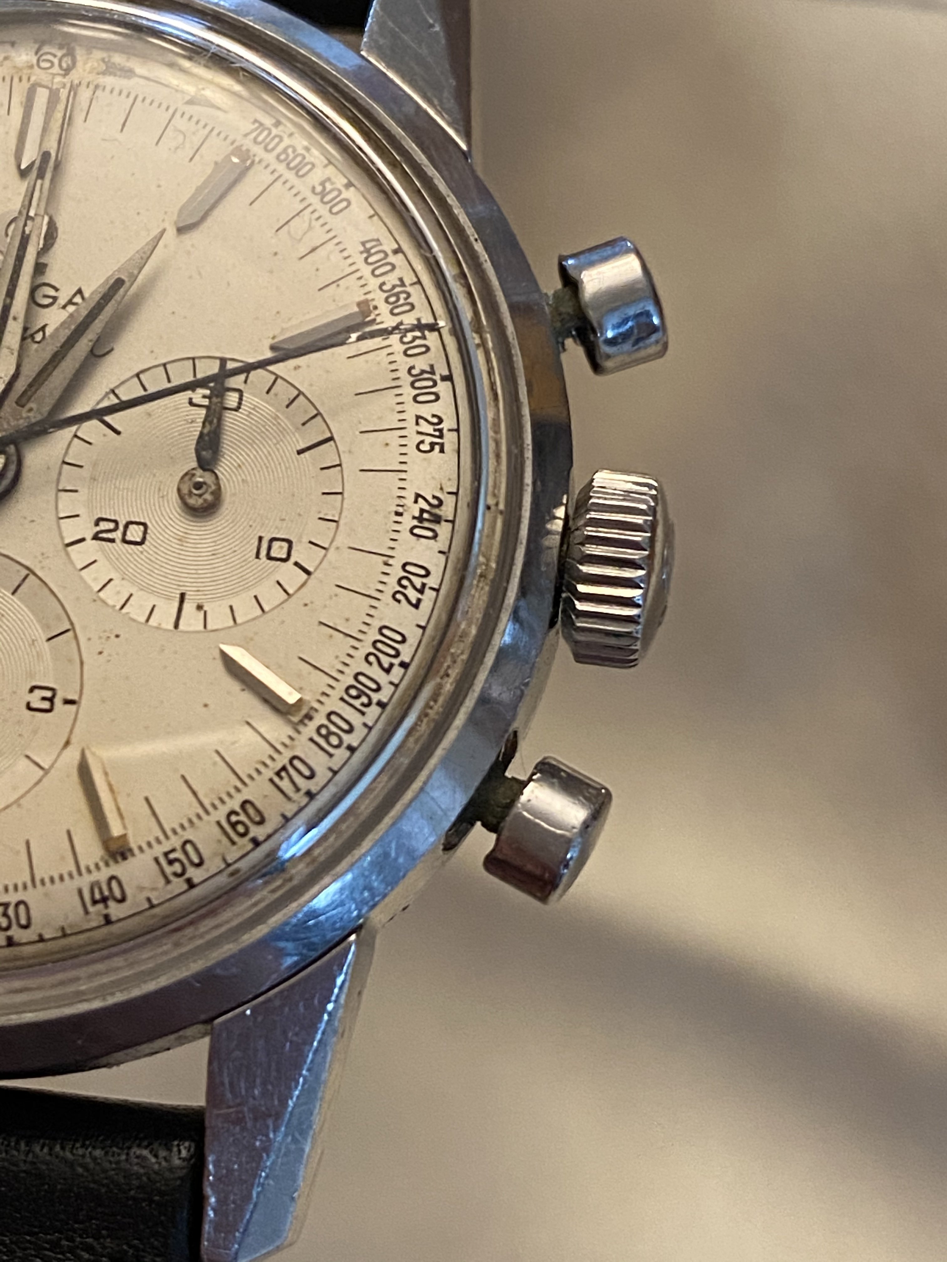

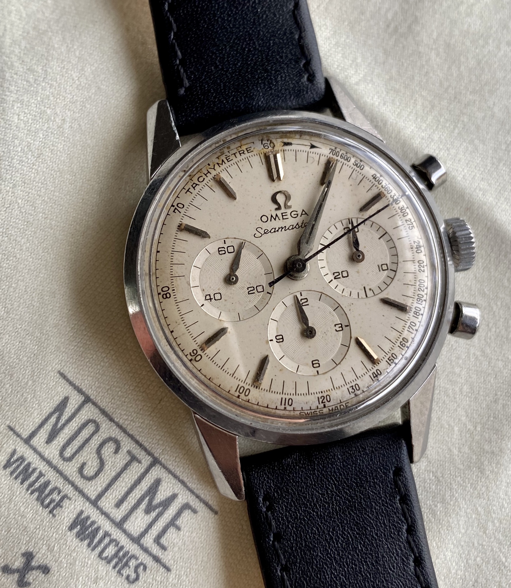

Here’s my new watch 🥰 a Seamaster Chronograph with a caliber 321 movement.
Unfortunately, I need to find some pusher tubes (sleeves? Casing?). How do these disappear?! As you can see in the photo, they have...
Any chance anyone has some lying around or knows where I could get some? I’m assuming I may need to get new pushers altogether but before I send this off, thought I’d ask around.
I’m also in need of (1x) Case clamp 🤦 it has the screw but the metal bracket is not there. I’ll be checking eBay for that as well. I’m guessing they aren’t too hard to find even for a 321 😵‍💫

What is the case number?
14364-2
That corrosion looks like it would do the trick 😲

Have to buy the whole pusher - tube is not available as a separate part. Pushers are different, so 2 o'clock pusher is 086ST0018 and the 4 o'clock pusher is 086ST0019.
