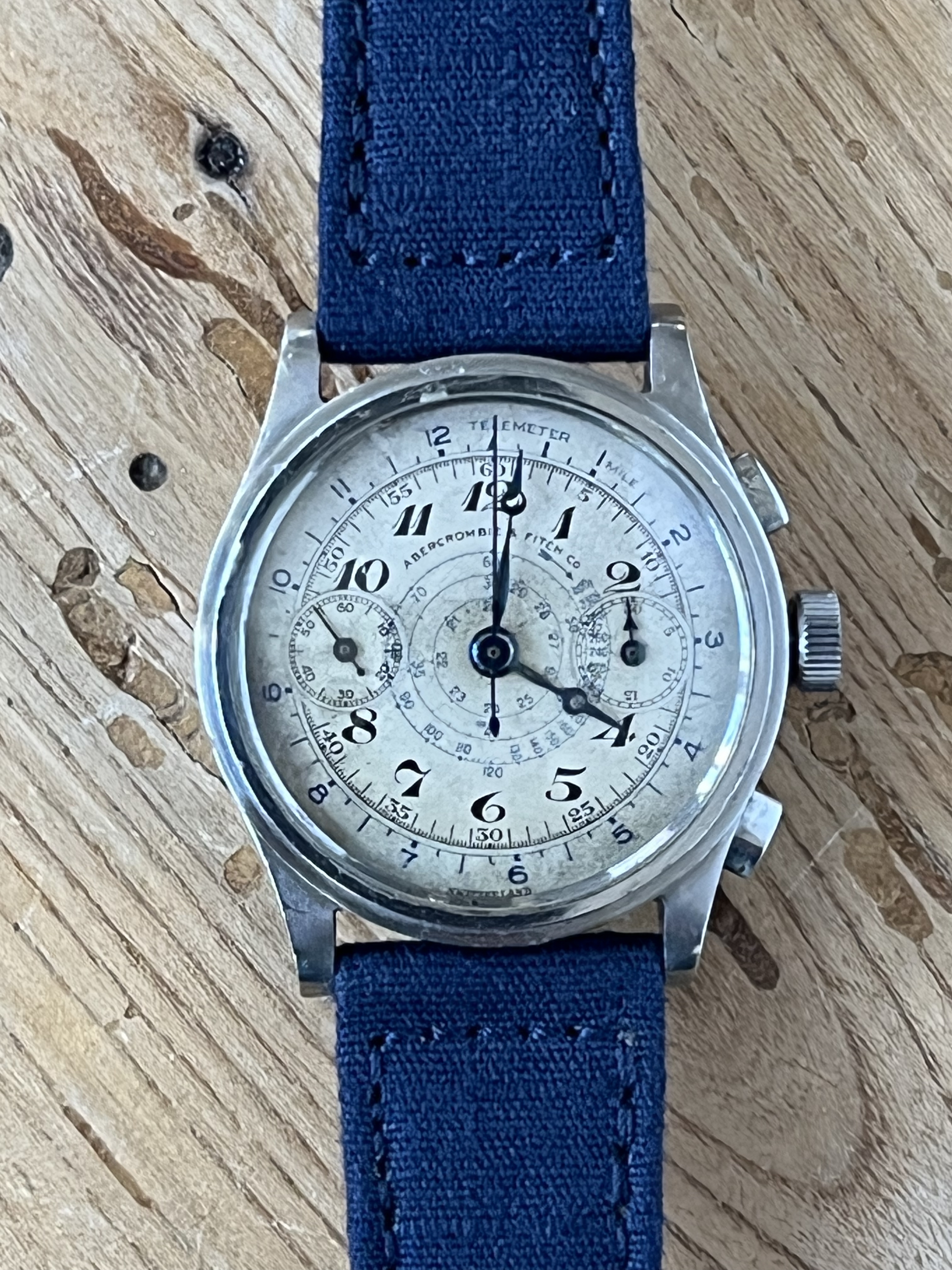

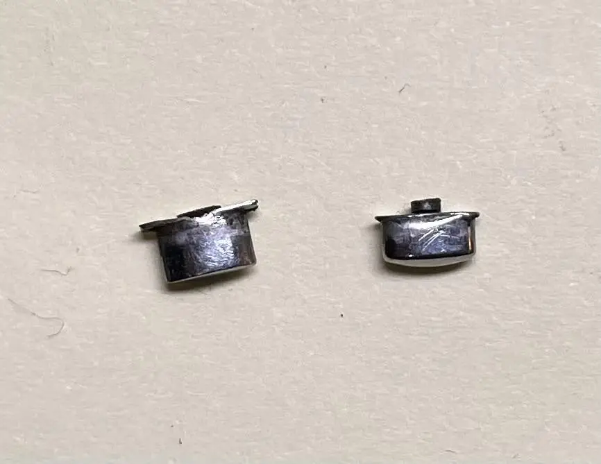

Hi Everyone,
Not sure where to post this, so thought I'd try here since I'm not yet at 200 posts. I've got an Abercrombie & Fitch 1936 chronograph that had a pusher replaced at some point and I'm looking for a better replacement. The watch was made by Heuer for AF and is believed to be a ref 2403 with a Landeron 13 movement. Attached is a photo showing the replacement pusher (on the left) and original pusher with a small post (on the right). My watchmaker said a BestFit 623A or 633A pusher might be close in size to the original. The dimensions of the original pusher are: 4.65mm wide by 1.80mm thick and is 2.60mm high, excluding the post.
Any suggestions who I might contact to find a potential replacement?
