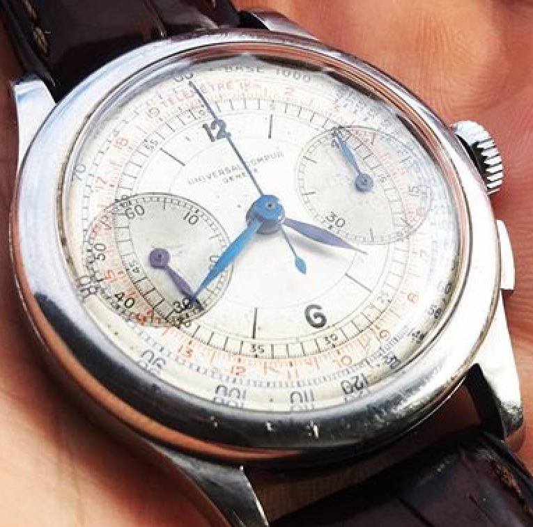

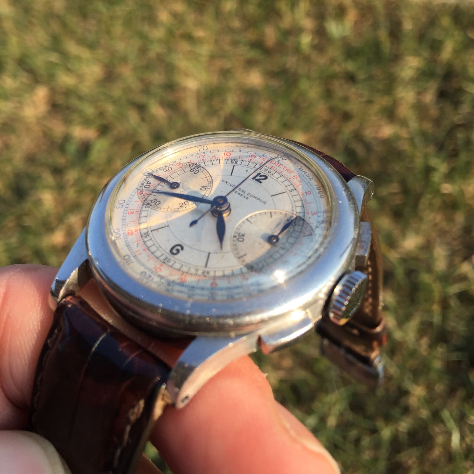

pulling the trigger - any dissenters? UG 285 chrono. Appreciate any feedback before purchase
  1. billving Oct 12, 2016
    559
    324
    image.jpeg image.jpeg image.jpeg image.jpeg image.jpeg dial originality and period correctness
    Lack of compax, compur, etc on dial. Early version?

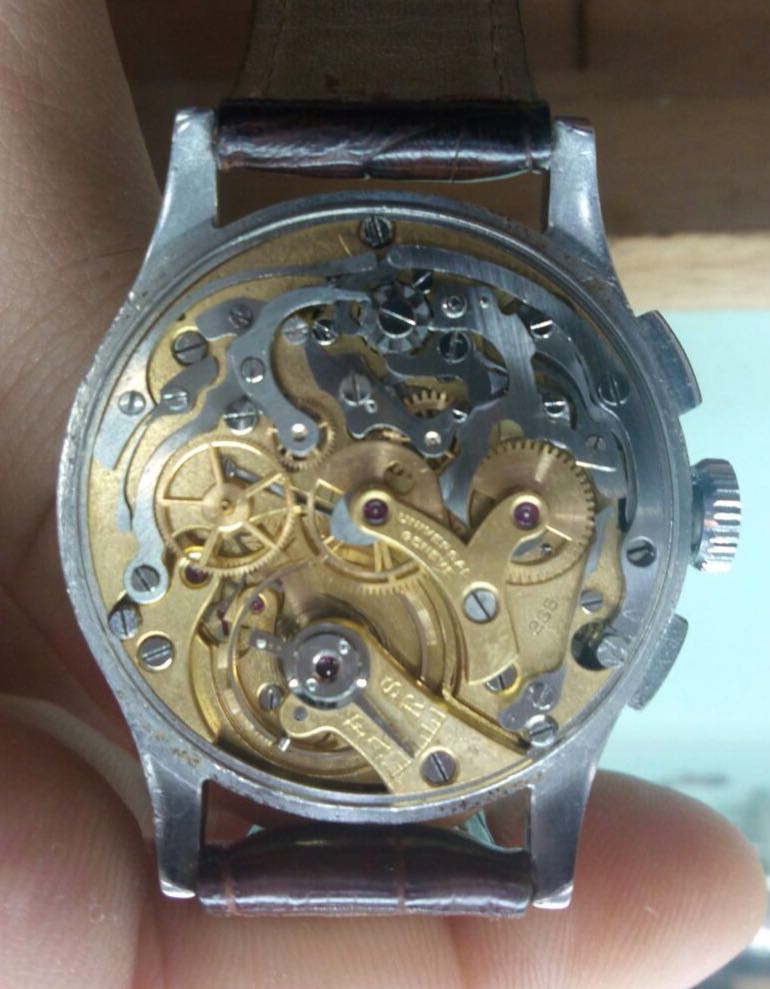

    285 movement.. Looks good?

  3. billving Oct 12, 2016
    559
    324
    Sorry, I know....I should have said.....
    Instead of Universal Geneve on the axis approx from 2 to 10, and compur at 3/4 to 8/9, it has Universal Compur on one line, no compur below.
    I do see and early pocket watch with the same layout.

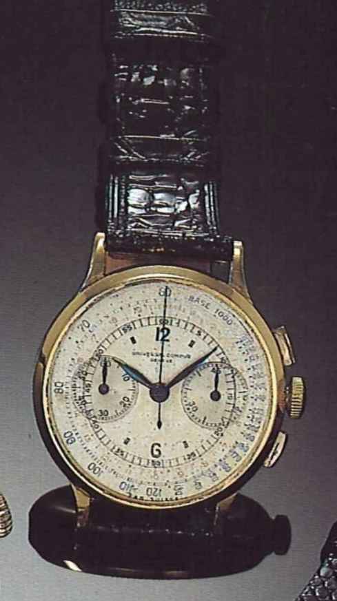

  4. billving Oct 12, 2016
    559
    324

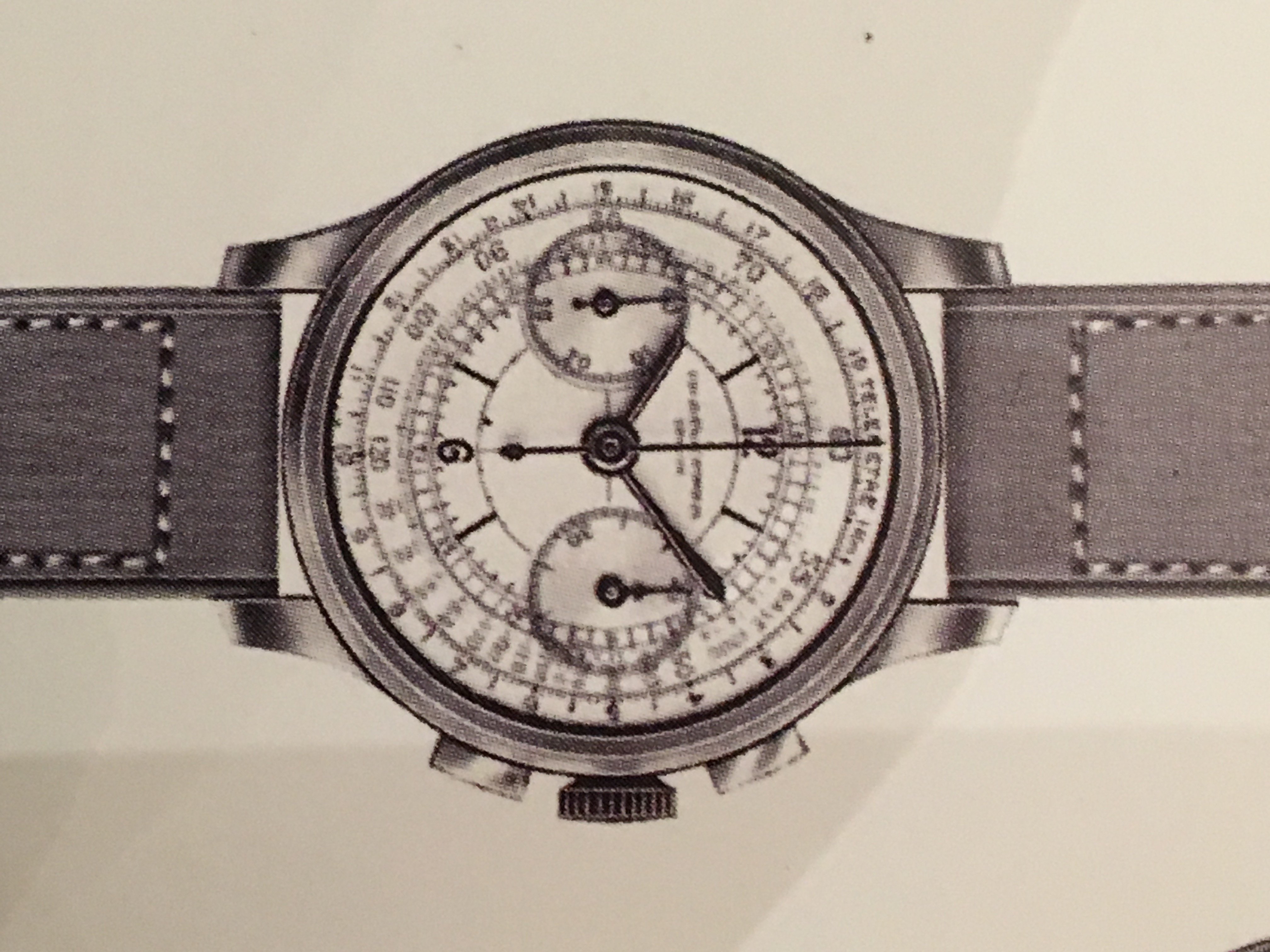

    I did find this iteration of that dial and Universal compur marking
  5. billving Oct 12, 2016
    559
    324

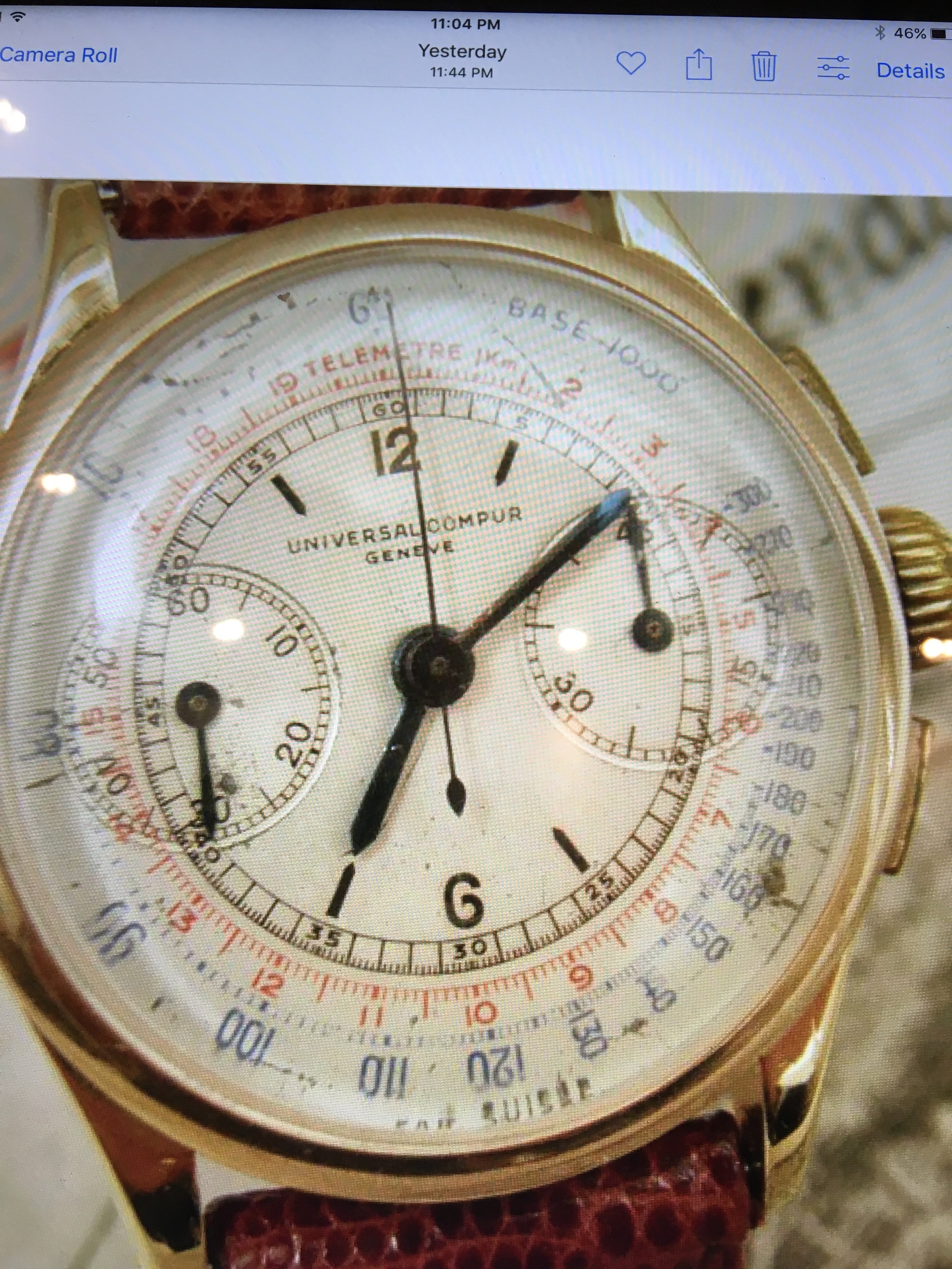

    As well as this one....so I just need to re-look at fonts and printing. They seem ok but I'll do a closer comparison.

  7. billving Oct 13, 2016
    559
    324

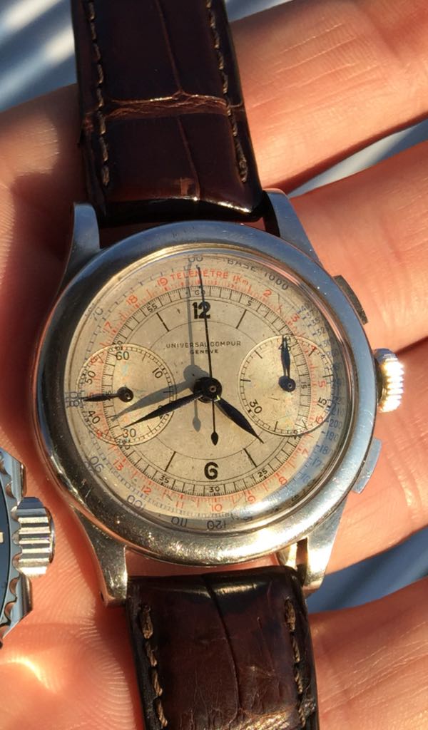

    Ok...another dial. Seem safe there.
    I just don't see a Swiss or Fab Suisse on the one I'm looking it. Did very early ones not have that?
  8. billving Oct 16, 2016
    559
    324

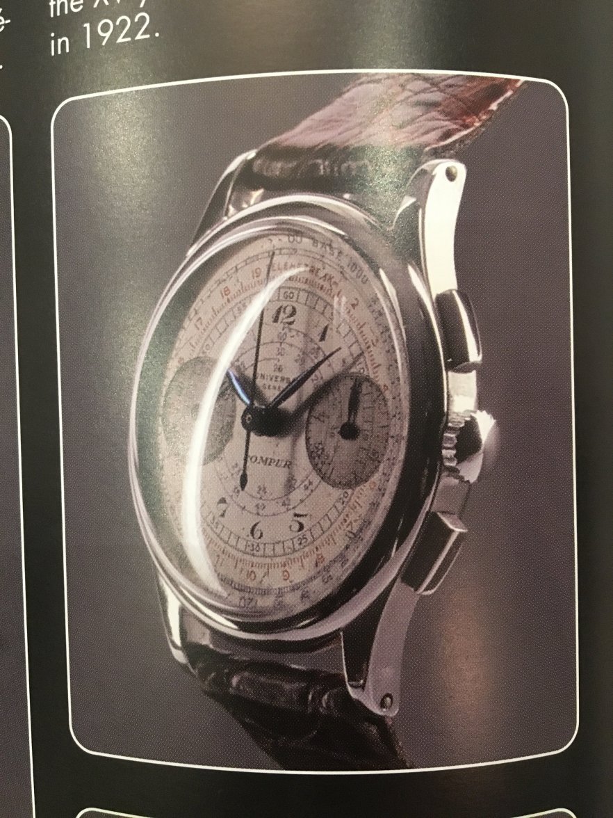

    Sent to me. Sala page 466. Hermes ad , same dial, same script, tachy:Telly reversed, no fab Suisse
  9. billving Oct 19, 2016
    559
    324
  10. speedmaster971 Oct 20, 2016
    63
    19
    For me is good...and very rare nowadays
