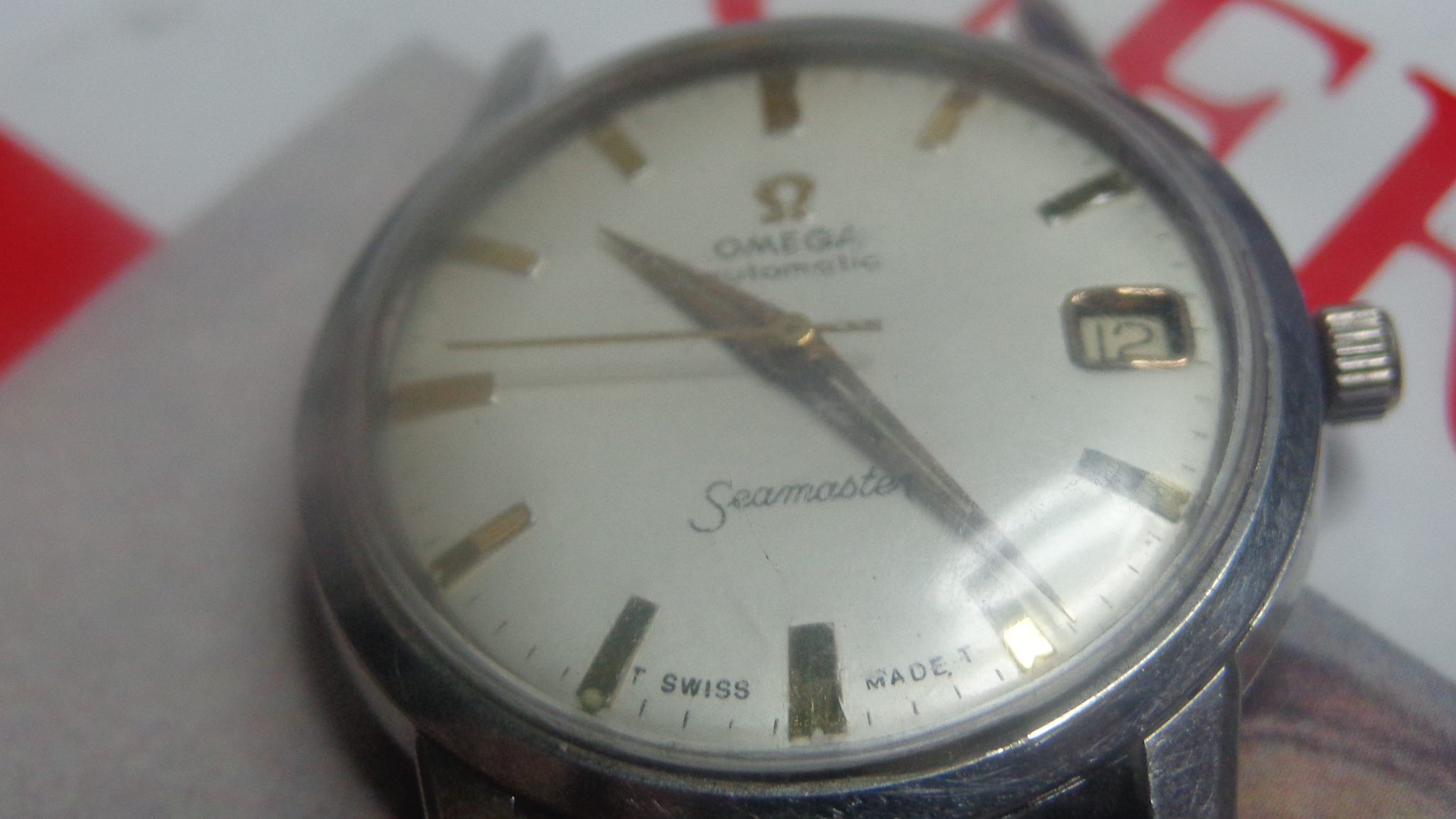

    Greetings to all,
    I have an oportunity to buy this piece for 750USD, its from a peer and it's said to be recently revised, also,
    Watchmaker who is selling it claims its 100% original dial<<<<.
    whats your opinion on that?
    Thank you very much.
    Braz

    it also seems unpolished

    , the 'T Swiss made T' looks well of centre to the 6oclock.

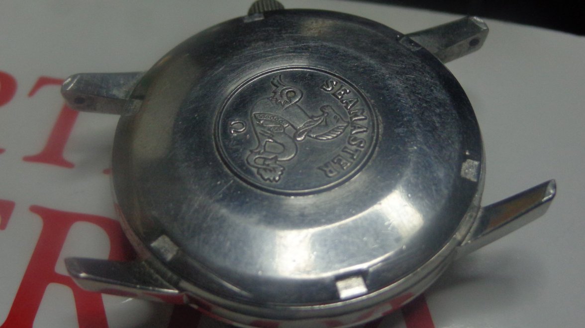

    Over priced with a nasty redial and wrong crown....big pass!

    I don't recall ever seeing a Seamaster with T SWISS T above the minute indices. The font is wrong and inconsistent in thickness as well.

    The " S " in Seamaster is completely off as well...

    They exist, just much more prevalent post-1970. The SWISS MADE on this one should be barely visible, just above the crystal retainer ring and below the 6:00 marker.
    However, this particular watch is a dud. It's not worth half the asking price.
