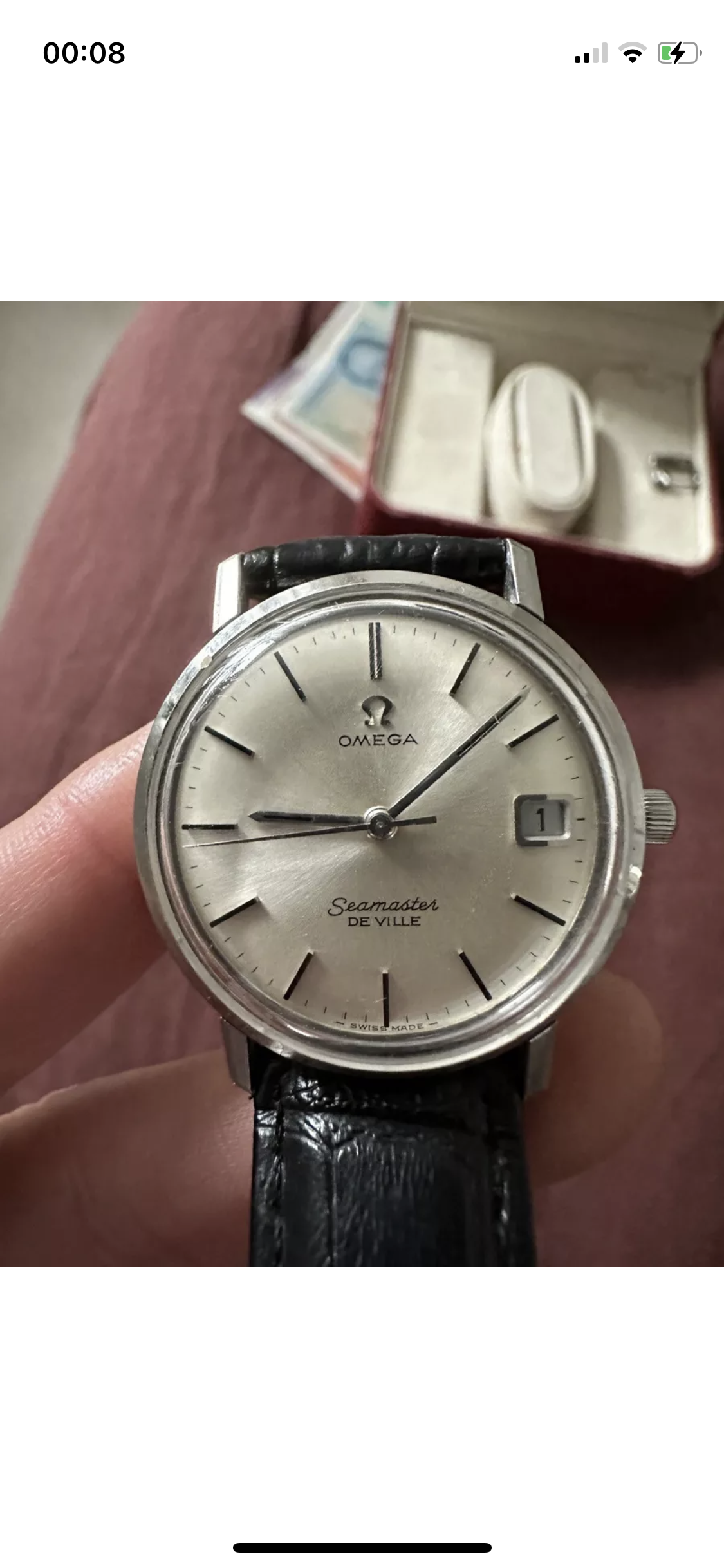

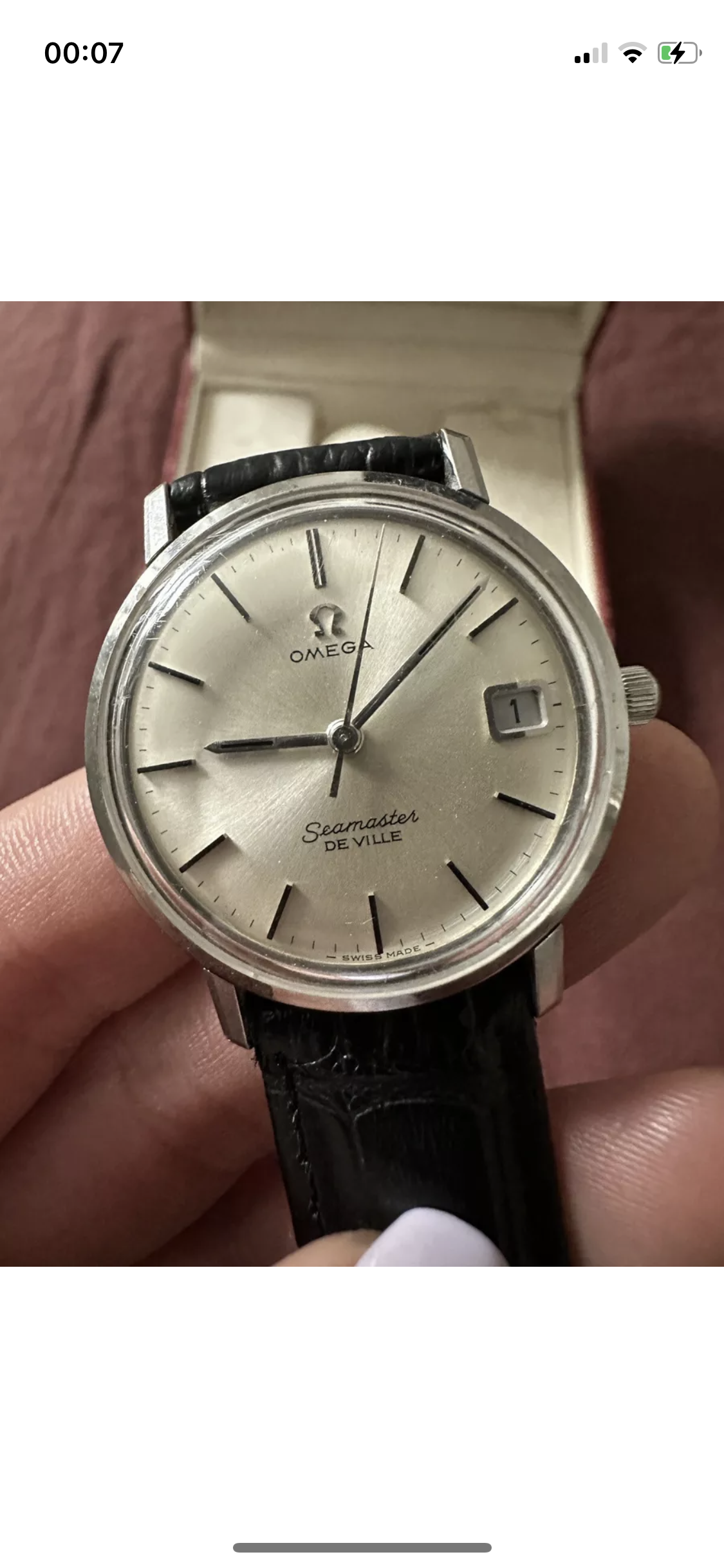

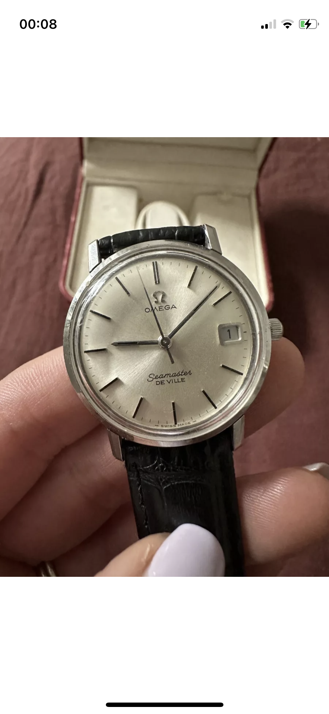

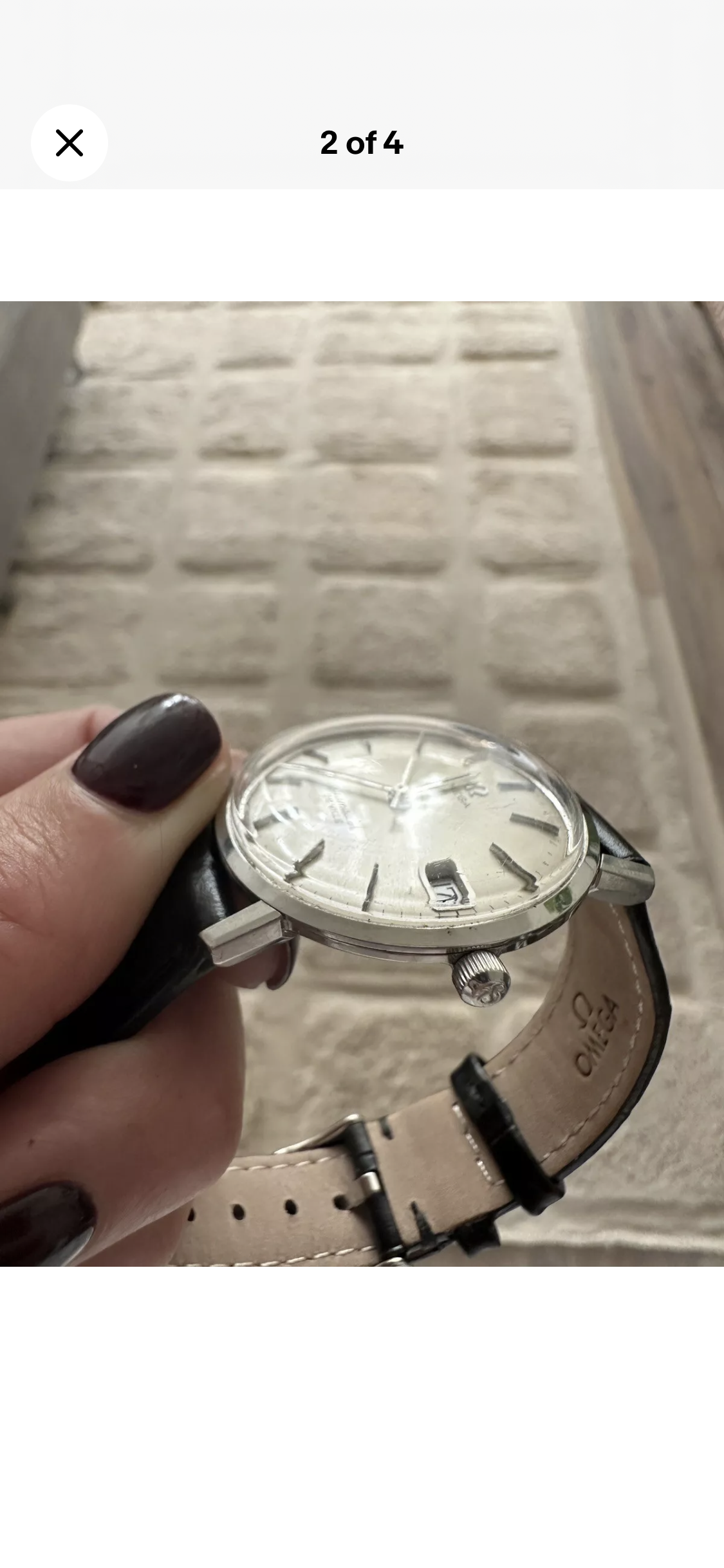

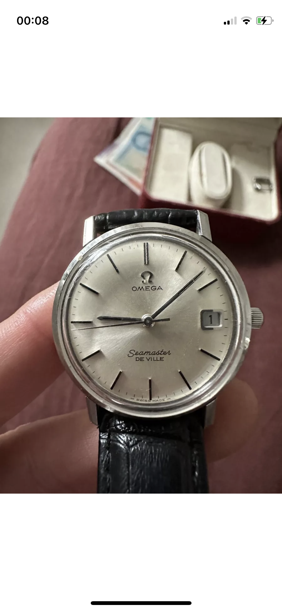

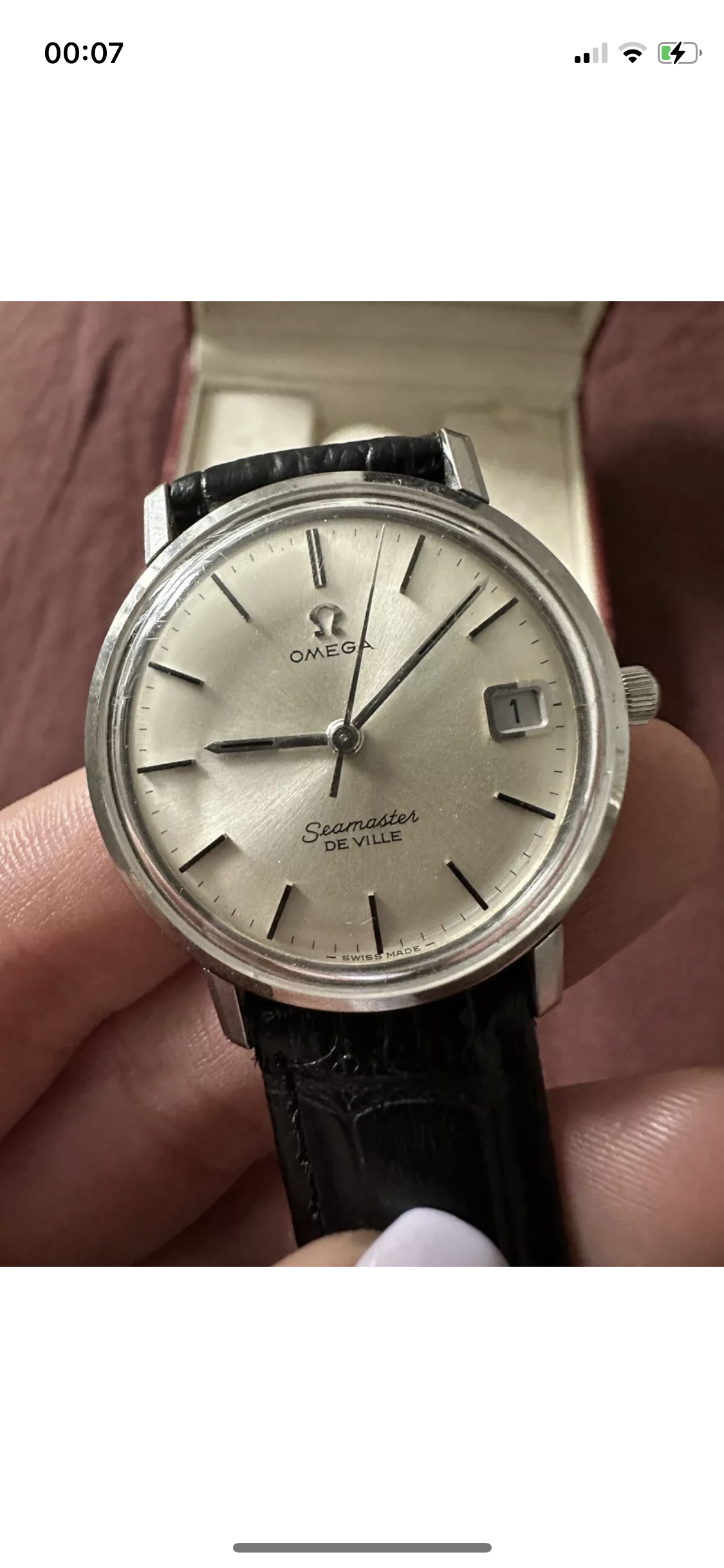

Howdy.
Firstly, absolutely blown away by a world I did not know existed and how much knowledge and passion you all willingly share. Thank you!
I’m really hoping you can help. I’m keen to purchase this vintage watch. After reading pinned threads on what to look for, finding myself even more confused…!
Backstory is dad’s “best” watch. And that’s about all I know.
Questions:
- original? Looks to me as though it is.
- has it been refaced? Oh lordie, forgive me if that’s not the right terminology. It’s the second point in the fishing thread, but after reading twice still not sure on what exactly to look out for…
- value? How much would YOU pay for it?
Thank you so much in advance.

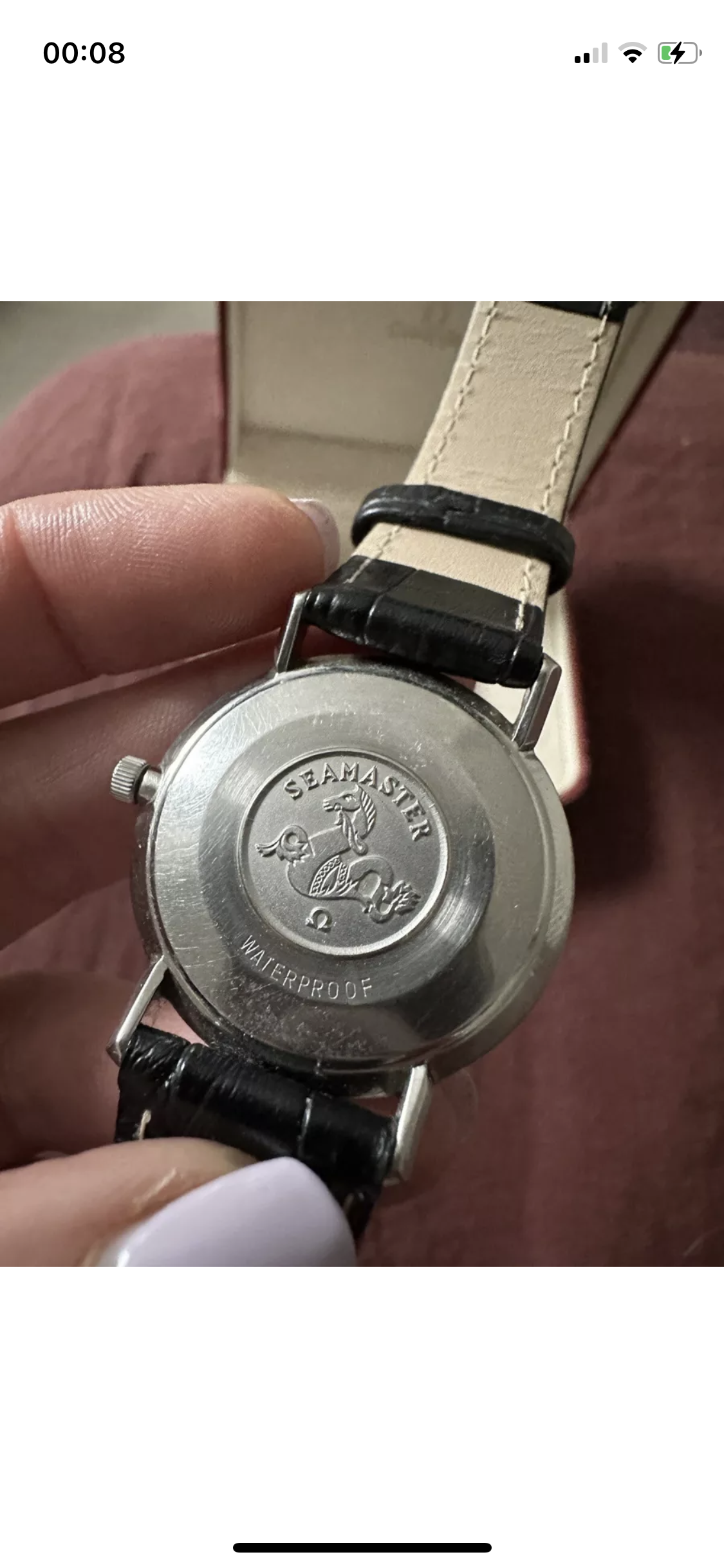

You can always find something for every budget. But no one here can say anything without pictures of the inside of the watch.
We can only help if we have all of the information that’s necessary to buy a vintage watch, that will always include pictures of the inside.
Also, how much is the asking price?
How much is your budget?
Does it have to be Omega?
Is your husband already a watch enthusiast and if so what type of watches do you see him wearing?
Are they modern or vintage, are they big or midsize?
Is he very active and likely to bump his wrist into things in his everyday business or does he work at a desk?
Vintage watches are not waterproof and less resistant to shock than modern watches, did you take that into account?
Are you looking for something your husband will wear on a daily basis or a watch for special occasions?
All of those questions will modify choices.

I'm thinking that your watch's crown is incorrect. Its dial appears original to me. The more knowledgeable will be along soon to offer their views.
I like the watch otherwise and would be tickled to own and wear it. In today's market $550 to $700 ought to buy it.
Some additional examples may be seen in a Google Images search.

Thanks! All easy to answer, if helpful:
£425
How much is your budget? About that. Would stretch to £500 if I knew of value. I was hoping for a “deal”
Does it have to be Omega? Not necessarily. But I like the style simplicity.
Is your husband already a watch enthusiast and if so what type of watches do you see him wearing? Does not own a-one. I wear a vintage men’s watch - have for a decade now, as an everyday (apart from when I’m with the kids). Would be nice to see him have something simple, classic, timeless. 34” barrel would be big enough.
Architect, mostly desk-based.
Vintage watches are not waterproof and less resistant to shock than modern watches, did you take that into account? Yes, thank you.
Are you looking for something your husband will wear on a daily basis or a watch for special occasions? Daily, but would take off for biking, DIY, dishes, etc.
Thanks again.

Thank you and thank you!! Exactly the help I was looking for. The watch is £425, so that’s basically bang on the money. Bit disappointed to learn about the crown , but from what I’m reading it not a “collectors” item, not a dealbreaker? 😀

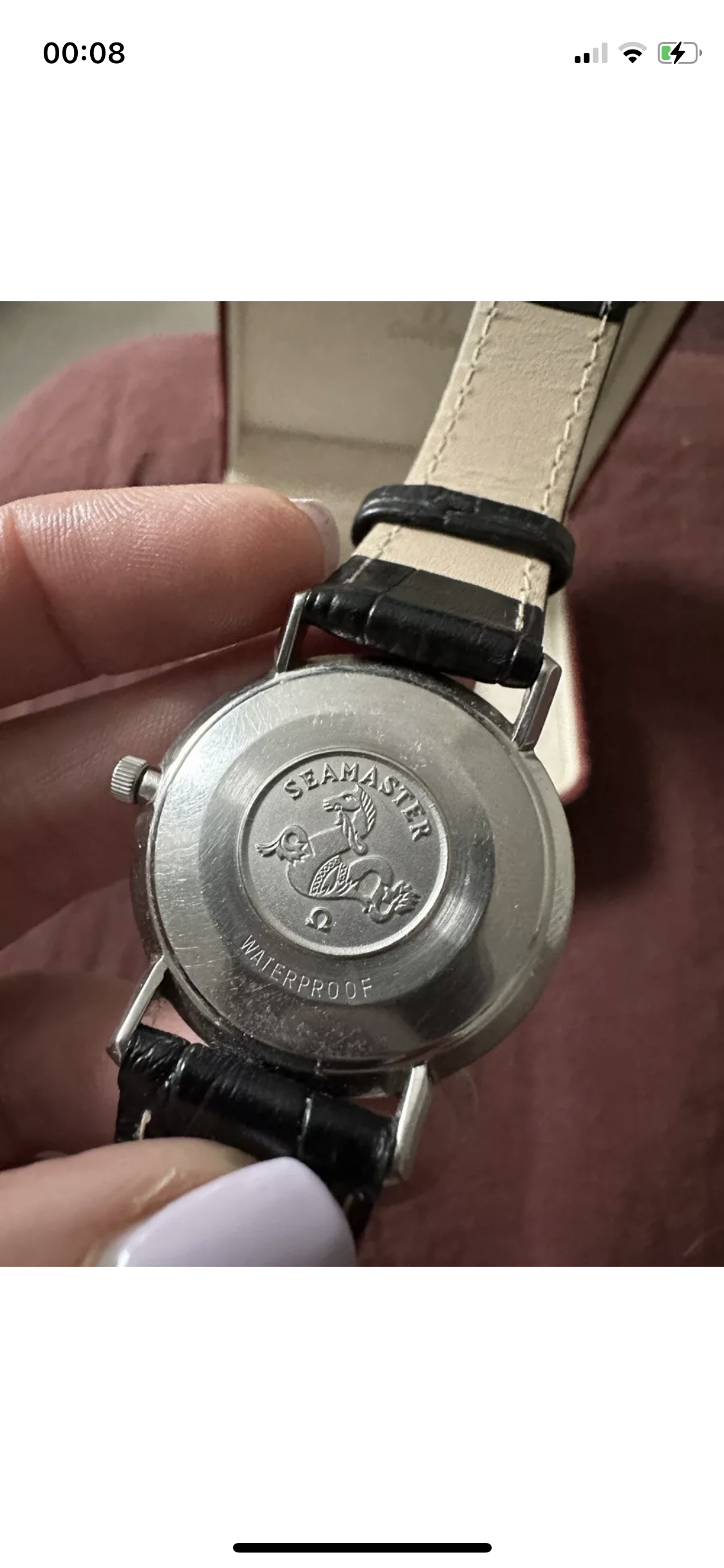

Regarding the watch you posted, can you ask the seller for pictures of the movement and the inside case back ?
Also a more crisp, high resolution picture of the dial?
I agree its pure and clean design should be appealing to an architect.
You probably have to add service costs to your budget. All mechanical watches have to be serviced about every 5 to 8 years in order to be worn regularly.
Some sellers will sell watches as having been serviced but many cannot be trusted on that front.
Since you appear to be in the UK people here can recommend watchmakers, a number of people here ship watches to Mitka, the cost of a movement service is about £200. (That does not include parts replacement if it turns out that is needed).

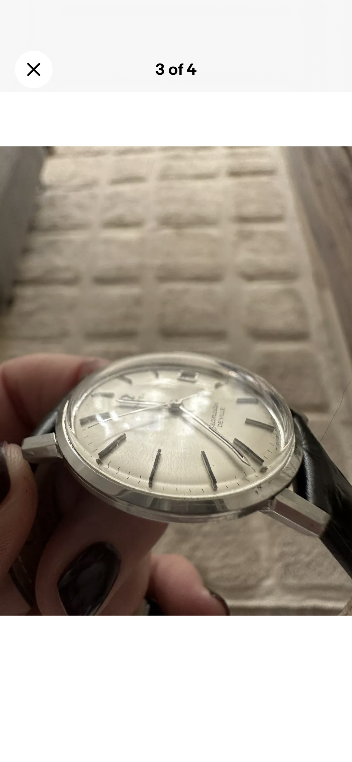

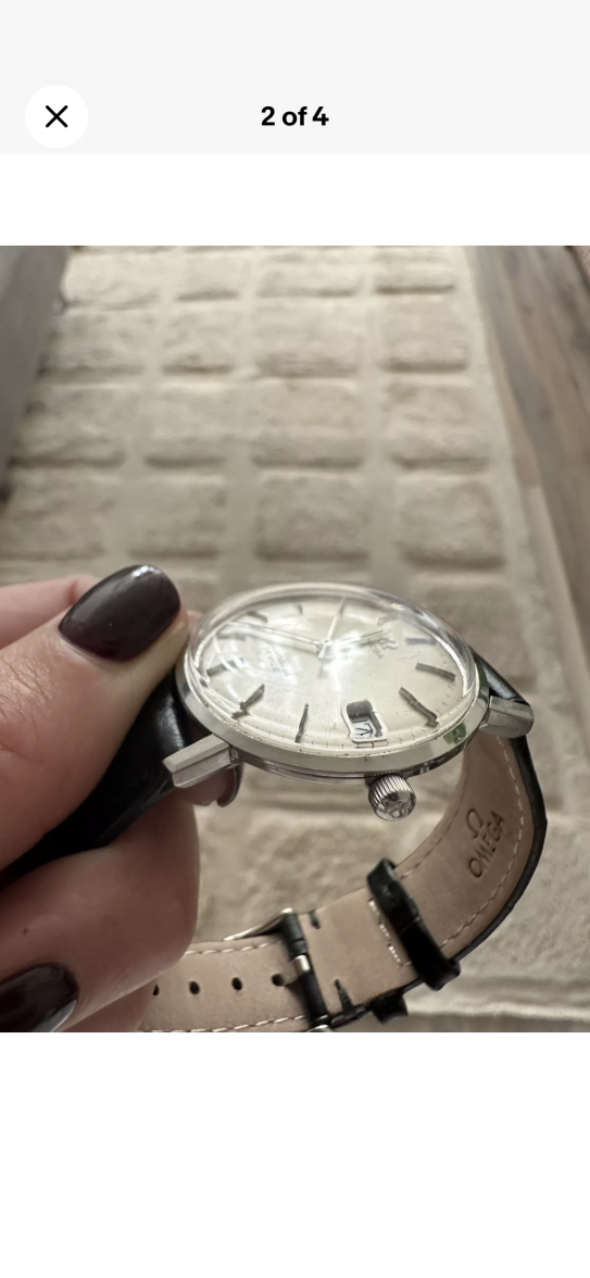

Thanks Syrte! I did ask for inside pics but she said she didn’t know how to open and offered to take to a jewelers. I declined after reading on here that it should be a watchmaker and watchmaker only.
Here are some other pics she sent me on request.
Thank you for the servicing link - very helpful. I had gathered £200 would be the cost. I wonder if I’m happy to take the chance to purchase without seeing the inside, that I have rationale to request a discount to cover the risk.
You buy these seamaster de villes almost always without movement pictures. Normal people can not open them. I would'nt worry to much about it. But yes, there's always a small risk. Anyway, for the 425 I think it's ok. Even with the wrong crown. Count in a service for 200 or 300 and you have a nice daily watch.

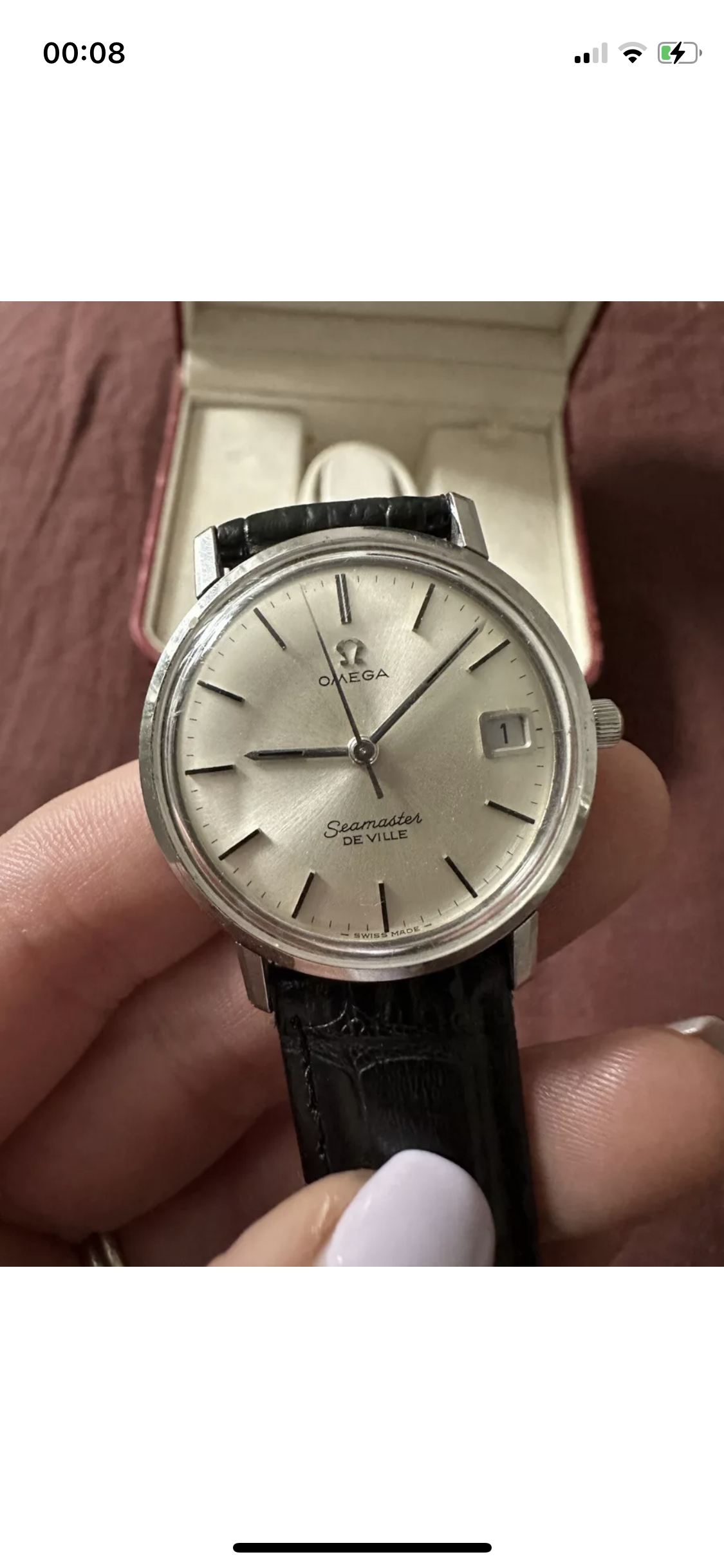

It's a 34mm (without crown) case by the way? Or 33mm?
Good question!! I need to ask as want to make sure it’s regular size.
