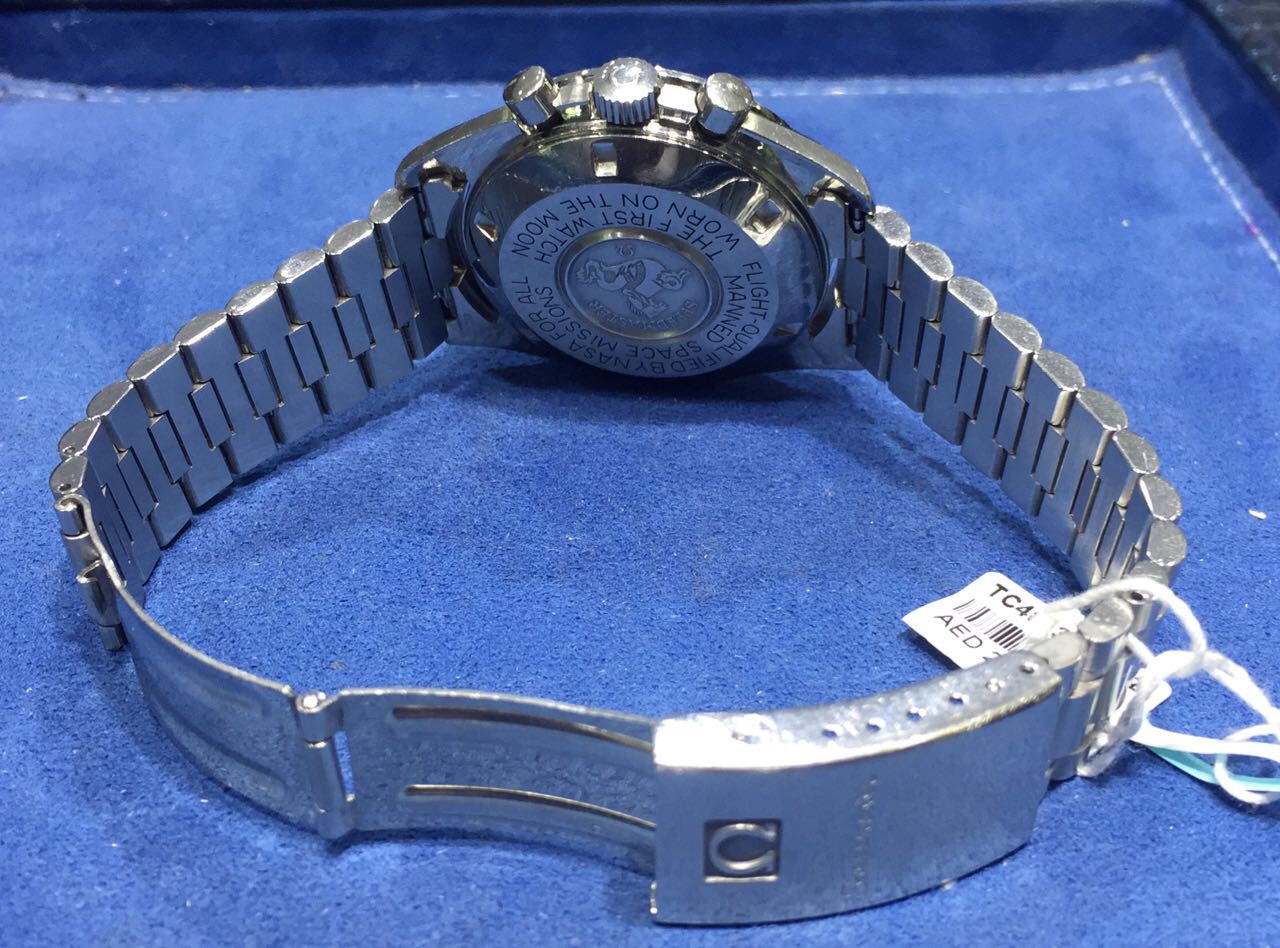

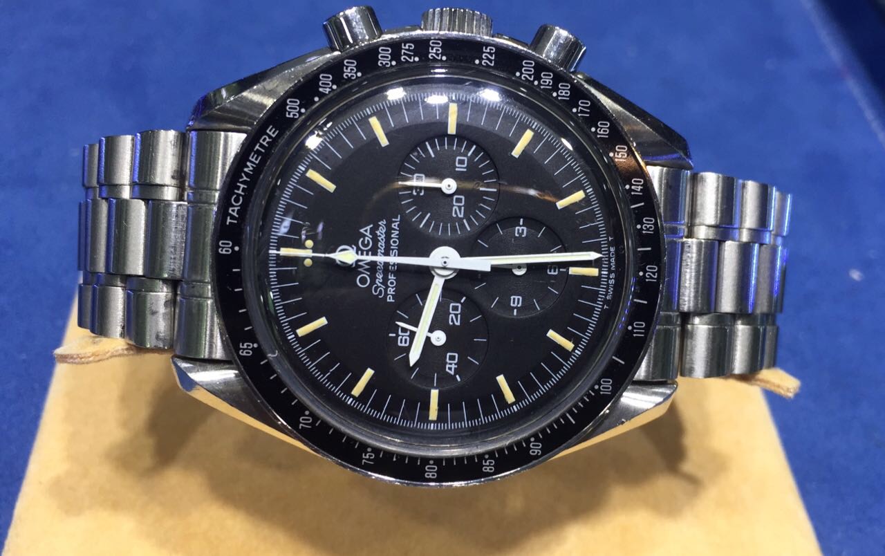

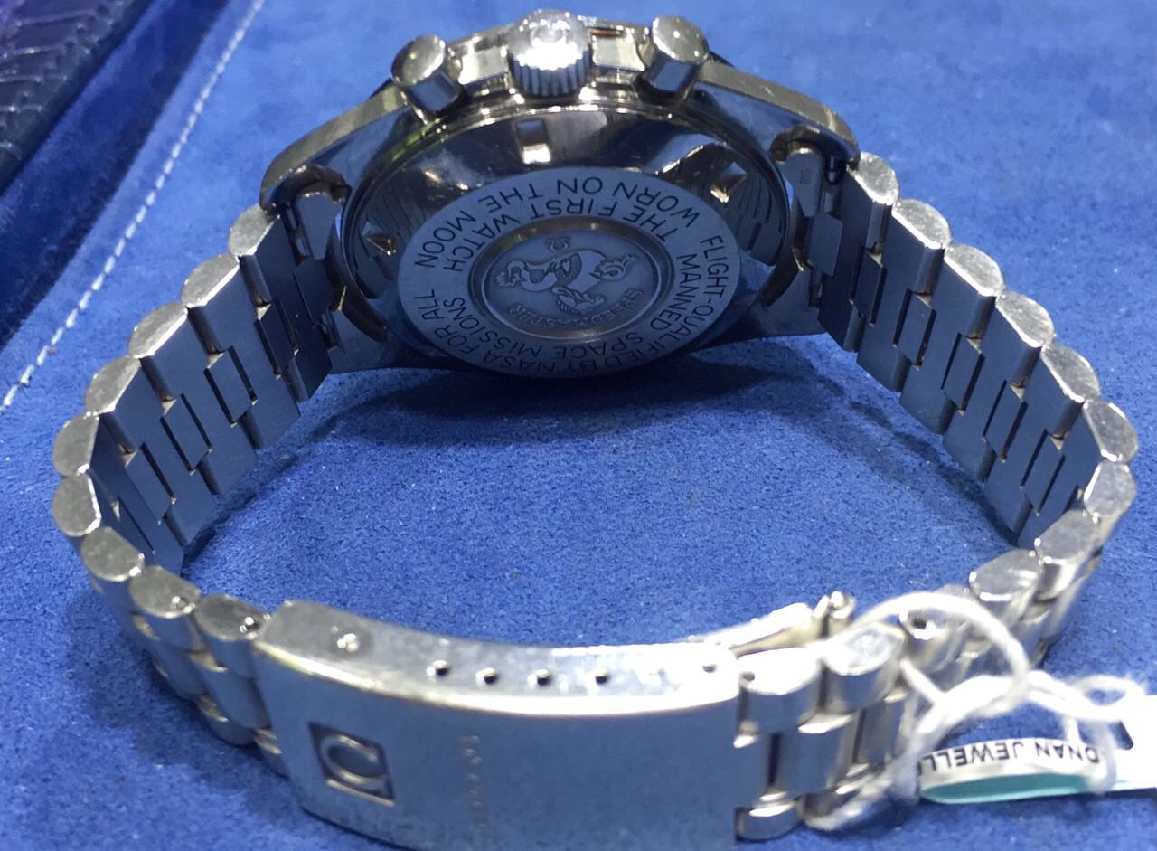

    I was at the dealer (not AD) the other day and they have two 145.022s from a local collector on consignment. I believe one is a later 90’s that was in nearly new condition (all paperwork and boxes). It looks like it may have been serviced in the past two years (I saw what looked like a service card but it was in Italian) which could explain the condition but I honestly felt like it was a brand new watch.
    The other appears to be a mid 80’s version with some patina and character which I rather prefer. The bracelet has a little stretch but the dial appears original (hands might be replacement but I can’t tell). Also in good shape and taken care of by their prior owner.
    Although I like the patina of the older model and the old tritium dial, is there any value difference between the two? Are all post-78 models the same in value (if condition was the same)?
    I don’t have a pic of the 90’s one but here is one of the 80s one. If they were priced the same which would you do? Also the dealer will provide one year warranty on service on either of them.

    The watch in your photo is from the early '90s, not the '80s - unless it was serviced and had its '80s dial and bezel swapped for early '90s specs.
    I would say true '80s Speedmasters may now have a slight edge in value over tritium '90s models - but only very slight, and assuming the '90s model is a solid-caseback model. Display-back tritium '90s Speedmasters will carry a small premium.

    Appears to be a 1479 bracelet in the picture, rather than the more desirable 1450, but the 1479 is still pretty valuable compared to a modern one.

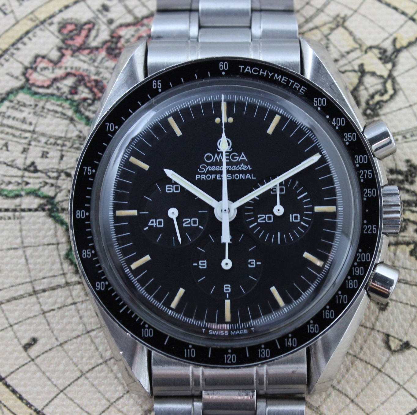

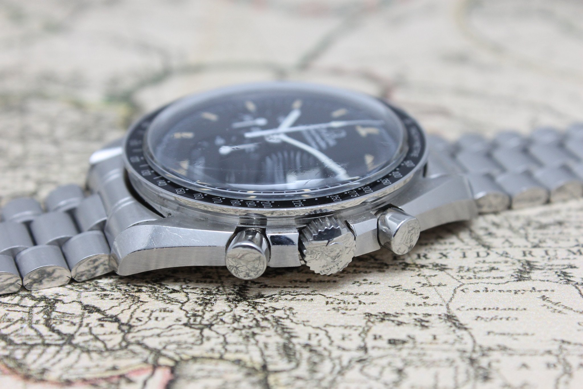

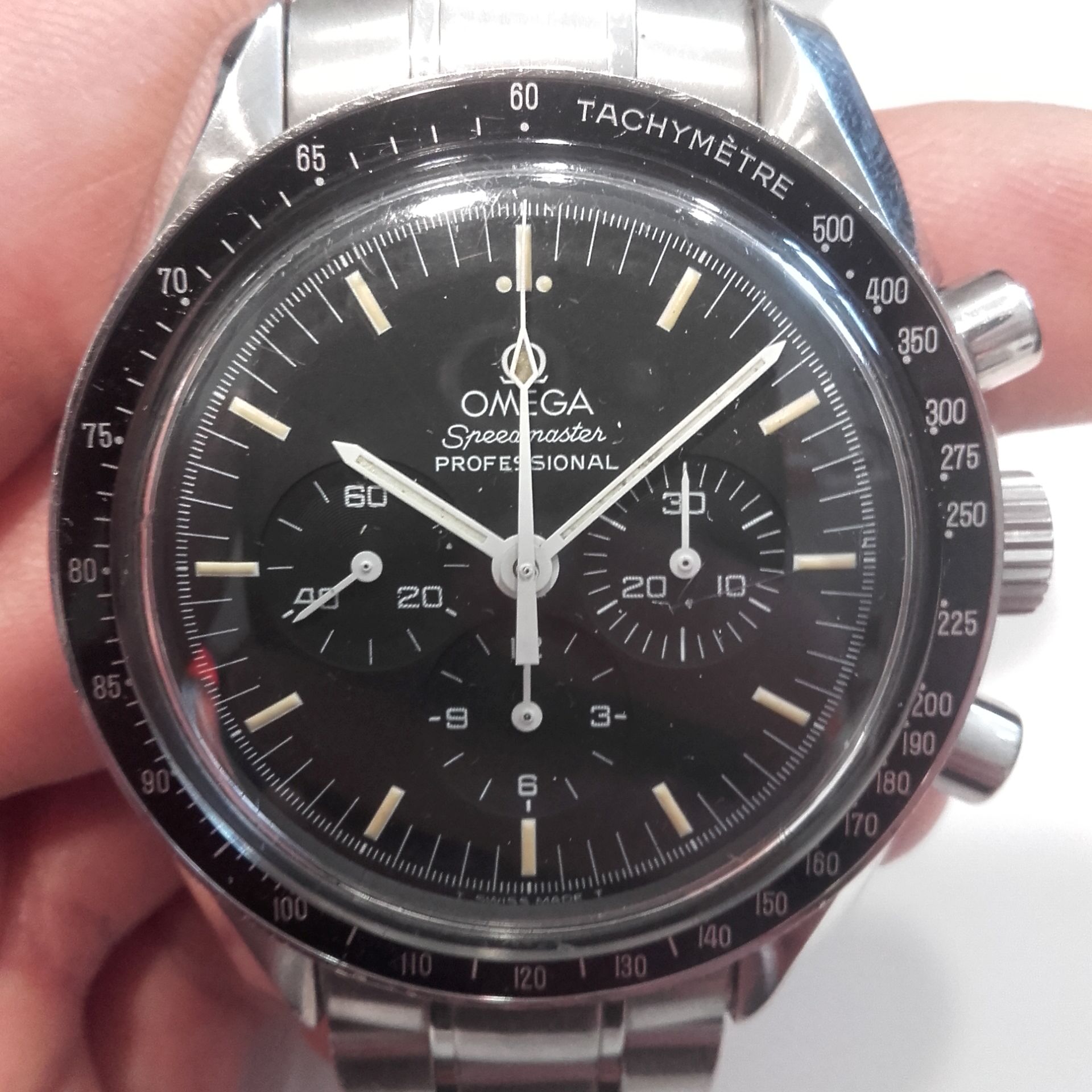

    Hi all, just as a follow up to my first inquiry:
    The dealer is stating that this is a 1985 145.022 with serial number 48275972
    I've added a few new pics. Does this seem legit? Would they have put a 1479 bracelet on a 1985? Is the dial an early 90's replacement during some early service (would it be weird that they would replace the dial after 5-7 years?)

    The dial and the bezel on the watch pictured did not exist in 1985 so they were replaced some time later. Or the movement is a replacement, or the dealer mis-read the serial number. Nice patina on that dial though.

    Based on serial number, that watch is from 1991. The dealer is using the wrong chart to look up the serial number on it. 48 million other Omegas, like Seamasters for example, would be 1985. In Speedmaster Pro family, 48.27 mil serial number is 1991.

    Wow, ok...does this mean the bezel and dial could be original? Would the bracelet match a 1991?
  16. Foo2rama Keeps his worms in a ball instead of a can. Jan 10, 2018
    17,101
    25,346
    Yes I believe so.

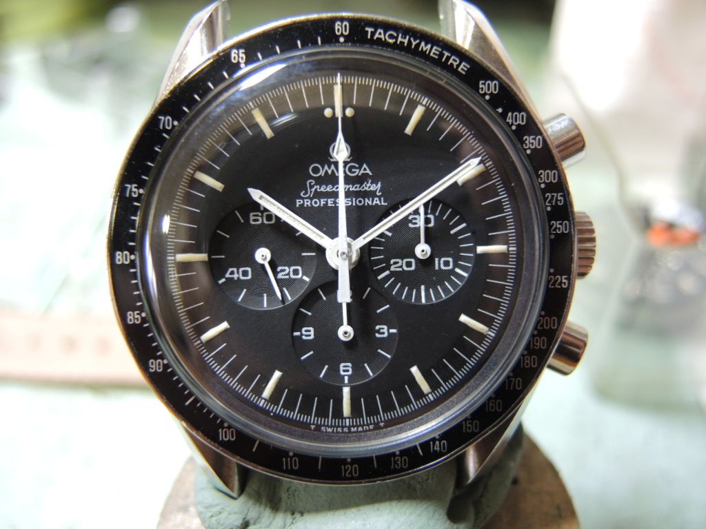

  17. omegasaso12 Jan 11, 2018
    410
    1,408
    Hy,
    here are my 2 examples that are closest to serial you provide.
    First is 48263xxx that is from 1991. Only difference is that my has long S and r on dial.
    Next in line that has little higher number is serial 48347xxx. It has short S and r. Production should be from 1996.
    Both have cal. 861,
    91 has 1479 bracelet, no accent e on tachy
    96 has 1499 bracelet. with accent on e on tachy
    What you provide is something between my two and I think its all correct example.
    I hope you got good infos you need.
