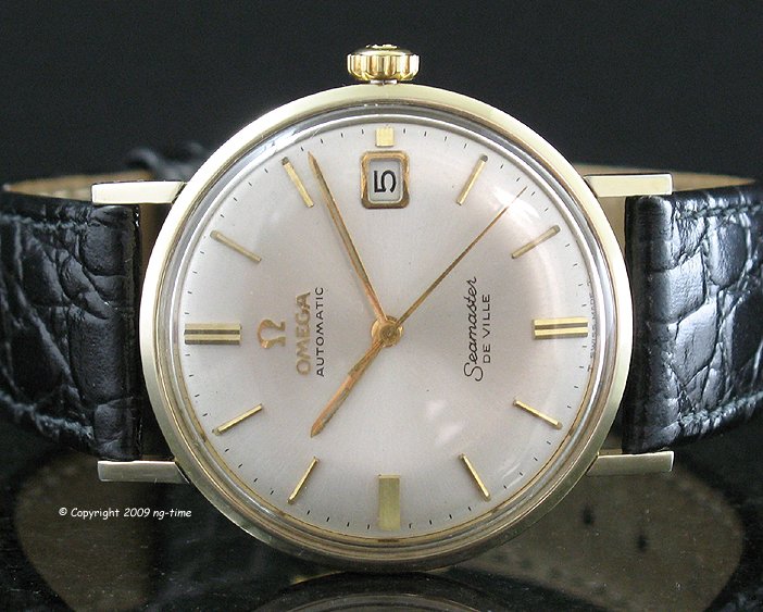

They appear to be generic replacements of an incorrect style. The minute and second hands should just reach the minute track.
See below for a correct original dial and hands.
Ok thanks. This dial is much closer to what the original was. Would it be possible to 'redo' this dial back closer to what you posted, or possible to purchase one like that? If so, do you have any suggestions for where?

It is next to impossible to recreate an old dial. The printing process is pretty much the same used for currency, so without the 'factory plates' It will never be 'good enough.'
Some say there are refinishers in south east asia (Like Veitnam) what can do really good work. A lot of the repainted stuff from India looks real nice in the listing photos. This is going to be somewhat grey market. And needs to be out of the realm of intelectual property rights.
The other option is to wait for a similar watch to show up on the market, and swap dials. Dials do show up on resale and auction sites. It can be a long wait.
There are billions of watches in the world. The case and dial are what differentiates them.
