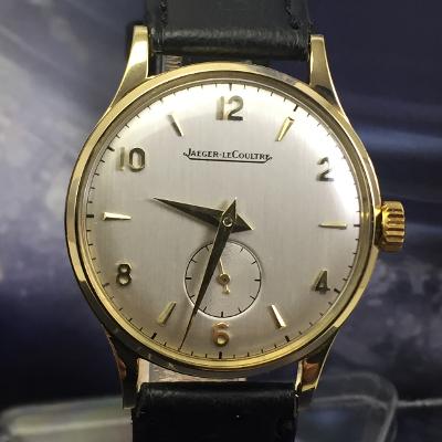

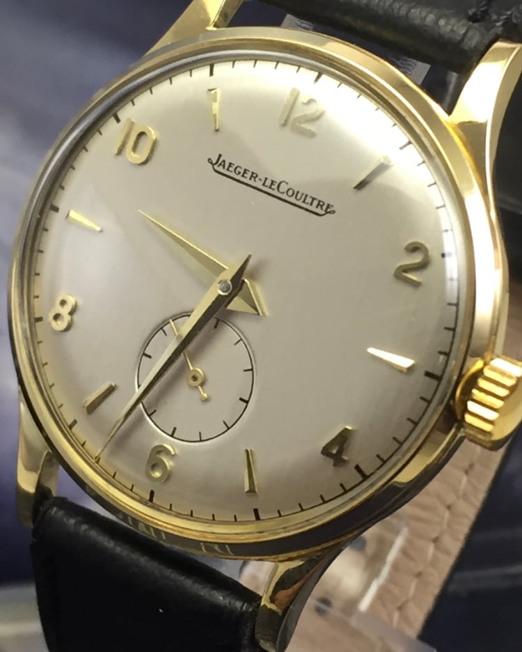

    Hi everyone
    Anything jumping out at you with this 18k cased JLC? Redial?? I have more pics if needed. Asking $2000€

  2. Dan S Jul 31, 2019
    18,776
    43,184
    My eye is drawn to the edge of the sub-dial, which looks a bit soft in that image. Can you post higher resolution images of the dial?

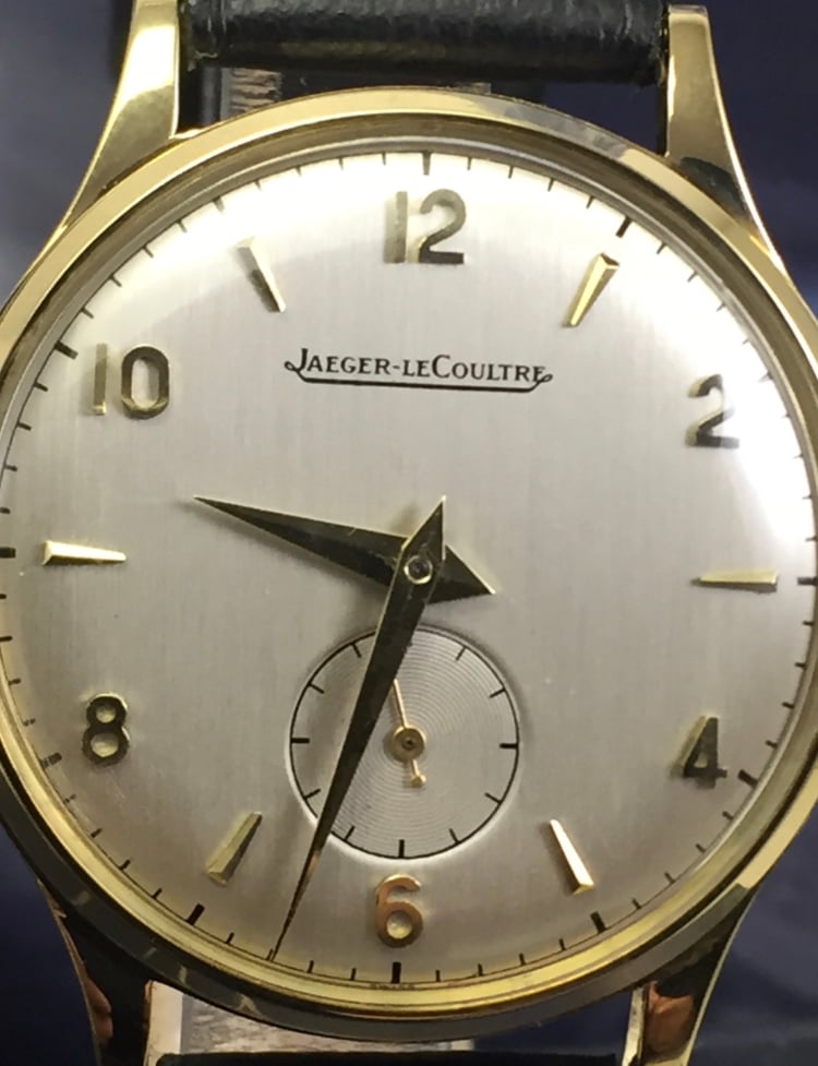

    I’m leaning towards redial. Here’s a couple of pics he sent
  4. MikeMan2727 Jul 31, 2019
    1,654
    8,682
    I would guess redial as well...everything looks just a little too thick and I'm not liking that subdial either.

  5. Dan S Jul 31, 2019
    18,776
    43,184
    I don't like the look of the sub-dial, and the minute track is not as finely painted as I would like.

  7. Larry S Color Commentator for the Hyperbole. Jul 31, 2019
    12,525
    49,717
    Redial.
  8. Syrte MWR Tech Support Dept Jul 31, 2019
    7,422
    20,883
    Redial for sure.
