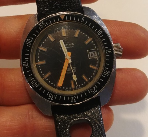

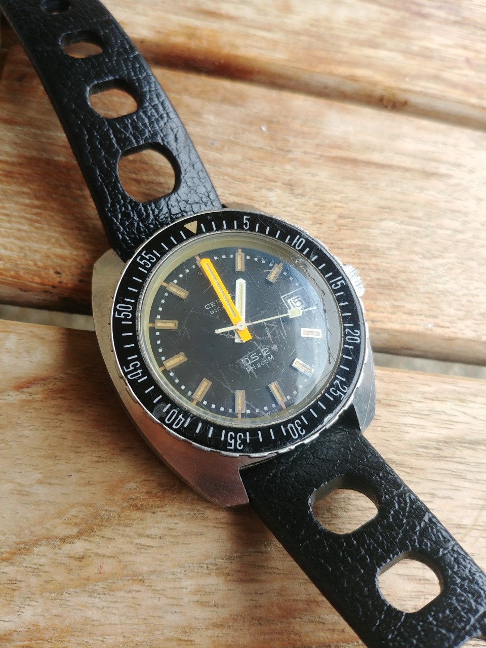

Hi folks,
I don't know if question was raised in the past, but is there a good way to polish scratched mineral glass ?
Did anyone try this before ? https://www.polywatch.de/en/glass-polish
I am about to buy that diving watch from the 70s but the glass is ruined....
thanks for your input

I did polish an old SKX mineral crystal with some diamond paste as an experiment but never used the exact same product you provided in the link. The one I used was for industrial glass polishing if I remember correctly. I was able to remove the fine scratches with no problems.
It depends on how deep the scratches are and if there are any chips. Be aware that polishing it too harshly could lead to a weak point in the crystal(provided there wasn't one, to begin with) that will cause the crystal to crack during vacuum testing(if you choose to do so)
Also, the crystal will have to come out and be reinserted. That is another risk since it could crack during reinstalling.
I'm not familiar with these Certinas but I'm guessing crystals are hard to source if they can be sourced at all.
Based on the picture I wouldn't touch it. High risk, low reward plus that scratch that spans from 3 to 5 o clock is large and deep enough, in my opinion, to cause trouble.
I hope this helps.

I tried it, the result was zero. The scratches were probably too deep for the product.

I’ve tried the polywatch glass polish too (talking about the one from the OP’s link, which is different from the regular polywatch), on the mineral crystal of a Zenith. No luck at all... Either the scratches were too deep or I wasn’t patient enough.

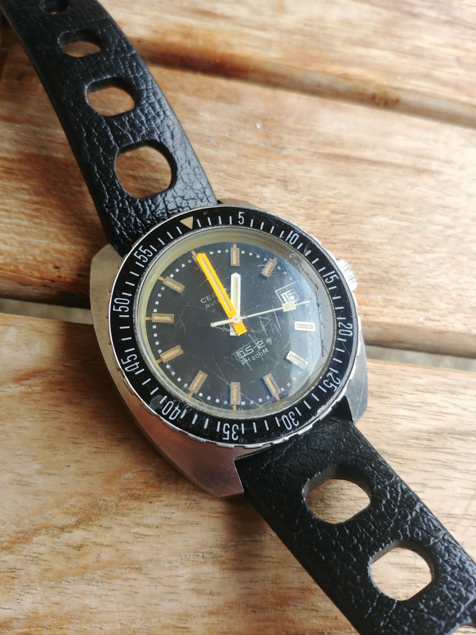

The same for me, i don´t have a chance to get a new glass for my Zenith XL-Tronic. The glass polish didn´t work so definetly no chance to make it look better 😉

That polywatch for mineral glas is joke. Dont buy it.
I tried more times but there was almost zero difference.
I hope this helps.
thanks a lot. I am suprised they fit a mineral glass in 1973-1974 on this Certina... an acrylic would have been easier for me.... 😀

I've had one good result. First I sanded by hand with a series of progressively finer sand papers starting at 400 and going down to 3000. I sanded for about 2 hours hours while I watched a movie. Then I used a Dremel tool with a felt pad and cerium oxide slurry for the final polish. It looks great now. The sanding makes the crystal red hot so remove the movement from the case

there is a better photo of the glass.... I reckon it is heavily scratched.... the idea is not to get a flawless glass, but rather make it a little cleaner

Hard to tell for sure but it looks flat. Why don't you just replace it with a modern sapphire crystal?
I know that in the car restoration business, they sell diamond pads to remove scratches from windows. The vendor stated that if you can feel a scratch with your fingernail, it's too deep to buff out.
