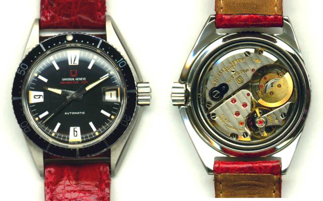

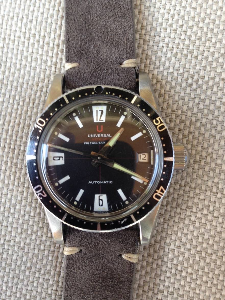

I am currently fairly interested in UG Polerouter Subs. What I noticed, though, is that there seems to be a large number of different bezels, some of which seem a bit strange.
(credit: bluepoint at omegaforums)

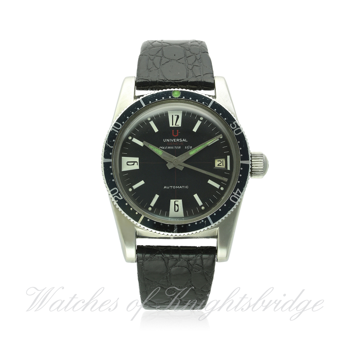

Notice how the inlays look like they have been cut off on the outer rim to fit the bezel, while the inner rim seems to have more or less the right size. Has anyone noticed this before? Does anyone have an explanation for this? Could it be that inlays for later asymmetric cases have been used to replace inlays on earlier symmetric cases but had to be machined for fit on a slimmer bezel? Here an example from polerouter.com with an asymmetric case but fitting bezel inlay.
What do you folks think?
