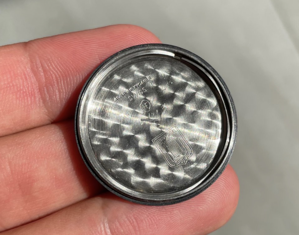

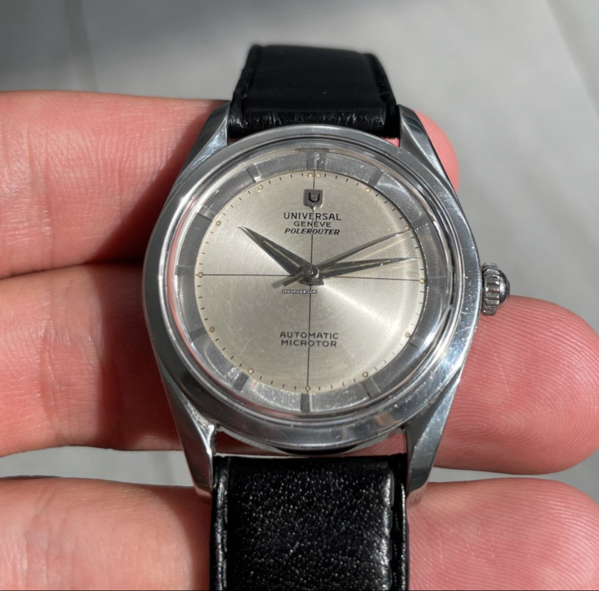

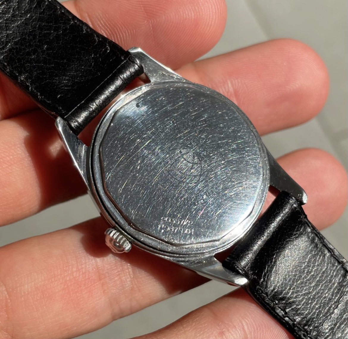

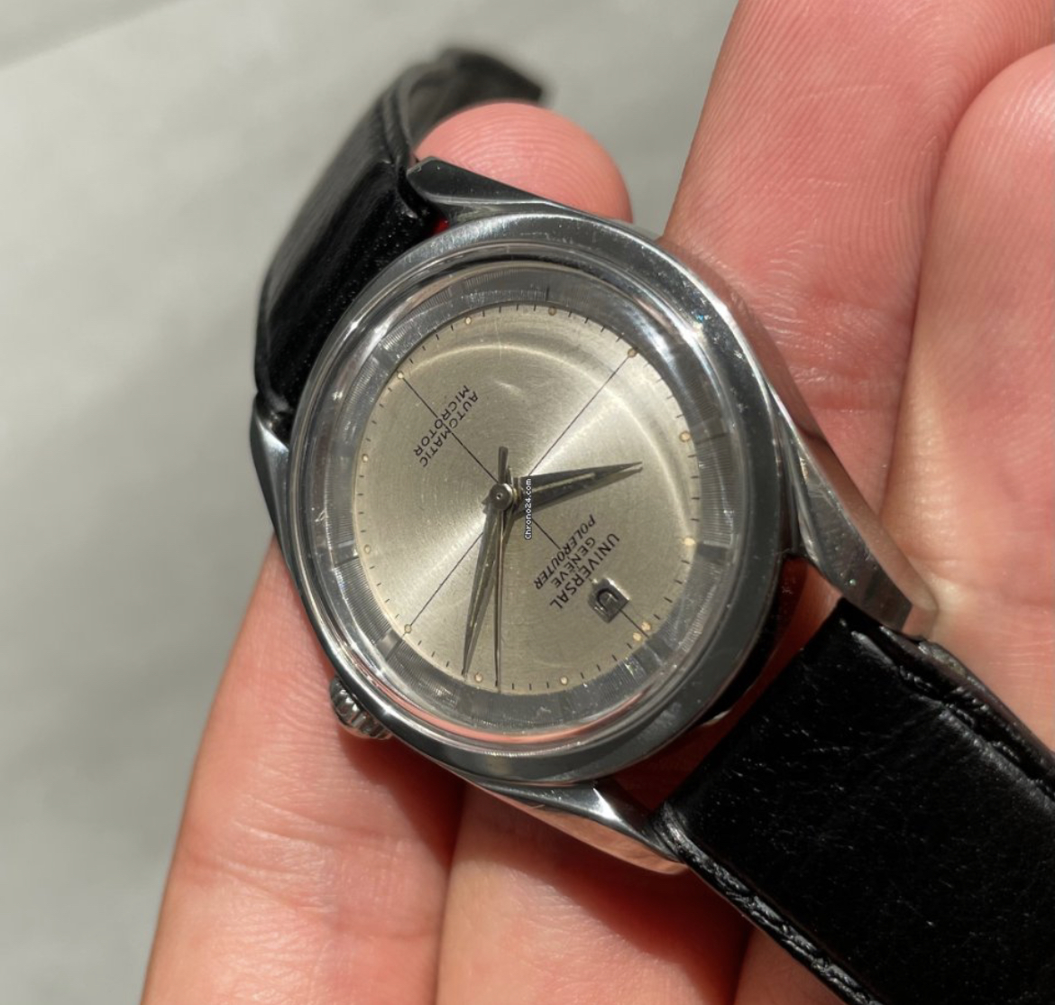

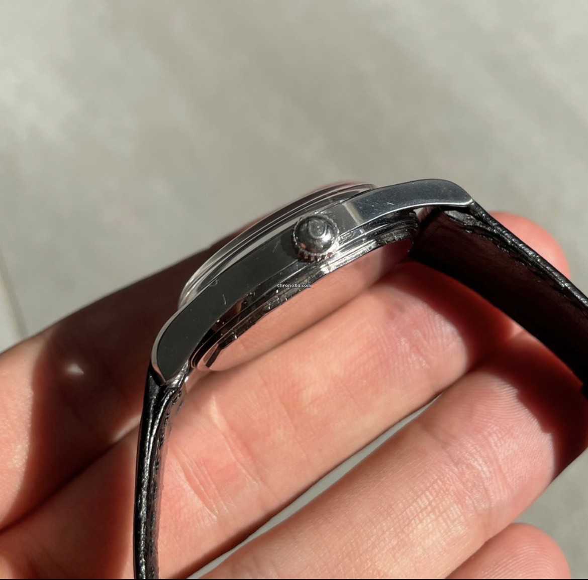

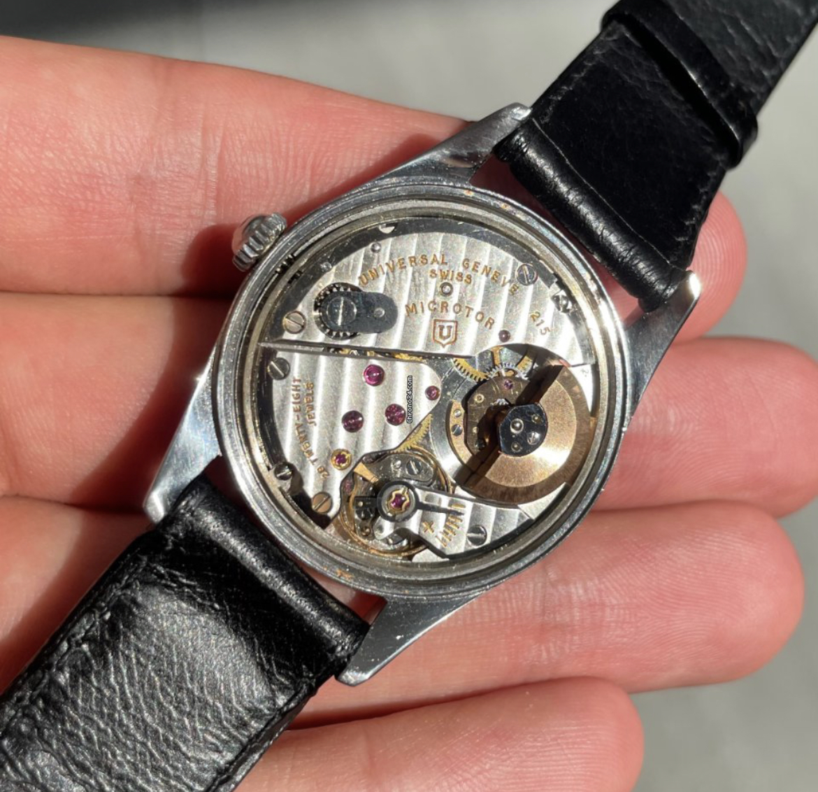

Hi all! I am considering the below polerouter and would love your thoughts on its legitimacy. It all appears correct to me, from the shield applied logo and the dial/case. What I’m not too sure of is the crown, does anyone know if that is the original crown for this ref 20357/2?

wrong era crown i think. could be wrong.
Kinda high in terms of pricing 😉
1,209
3,069
No, I do not think this crown is correct for this watch.
However it's not the worst match in the world and I think it's otherwise a great watch and not crazily priced.

Crown is not correct as others said already - and im always a bit wary of polerouters that dont have matching dial and hands lume colour.
I cant tell if the plexi is signed from the photos, but €2000 for smaller case (33.5 mm) reference with a silver dial seems excessive at the moment, especially if it is missing some correct parts...
Keep in mind its in the UK so unless you're also there, add the tax % on top to import.
