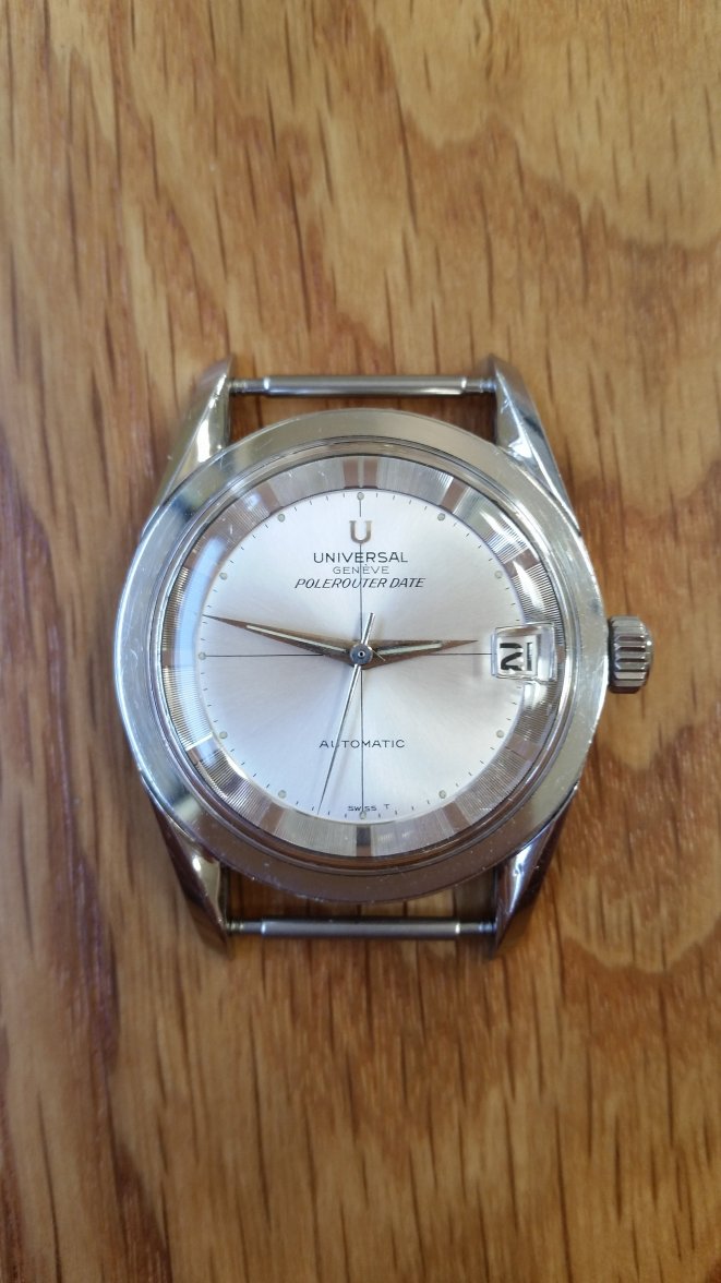

    Found this listing, looks pretty clean, but I note the painted hour marker at 8 is not well aligned with the corresponding point on the chapter ring (this Forum has taught me to look for that). By the way, seller claims it is original crystal and crown.
    Odd thing is, the other hour markers appear to be in line. Is this an obvious tell of redial, or possibly a parallax effect, or something that may have been found on original dials? Thanks much in advance for your thoughts.

    It looks more like the chapter ring is out, rather than the dial marker.

    Parallax and/or reflection issue seems more likely to me.

    Apart from this hour marker for which I don't really know what to think, it seems to me original for 2 main reasons:
    - flat A
    - vertical line does not go through the U logo (which is for me good sign to be an original dial)

    Original dial in great shape. Better resolution close up would be needed to verify orginality of lume, but it looks good. Original crown, original crystal. The upper lugs look to have lost their edge with a little too much time on the polishing wheel
    Not really sure what I am looking at with the 8 o clock marker. The chapter ring looks to be in perfect alignment and the displacement is too much to be caused by parallax. Perhaps the applied marker has been dislodged because it was not glued properly. Could be an easy fix. Depending on the price, might be worth picking it up for the dial and parts.

    The 8 marker looks perfectly aligned to me. It is the shadow/reflection that draws the eye and makes it appear otherwise at a glance. I think it is a nice one.

    Good news: I've landed the Polerouter pictured above, despite having given up on it. It is now in the mail and I will share pics once it has arrived. Thanks, all, for the advice re: reflection - that's all it was. The minute markers are indeed well aligned.
