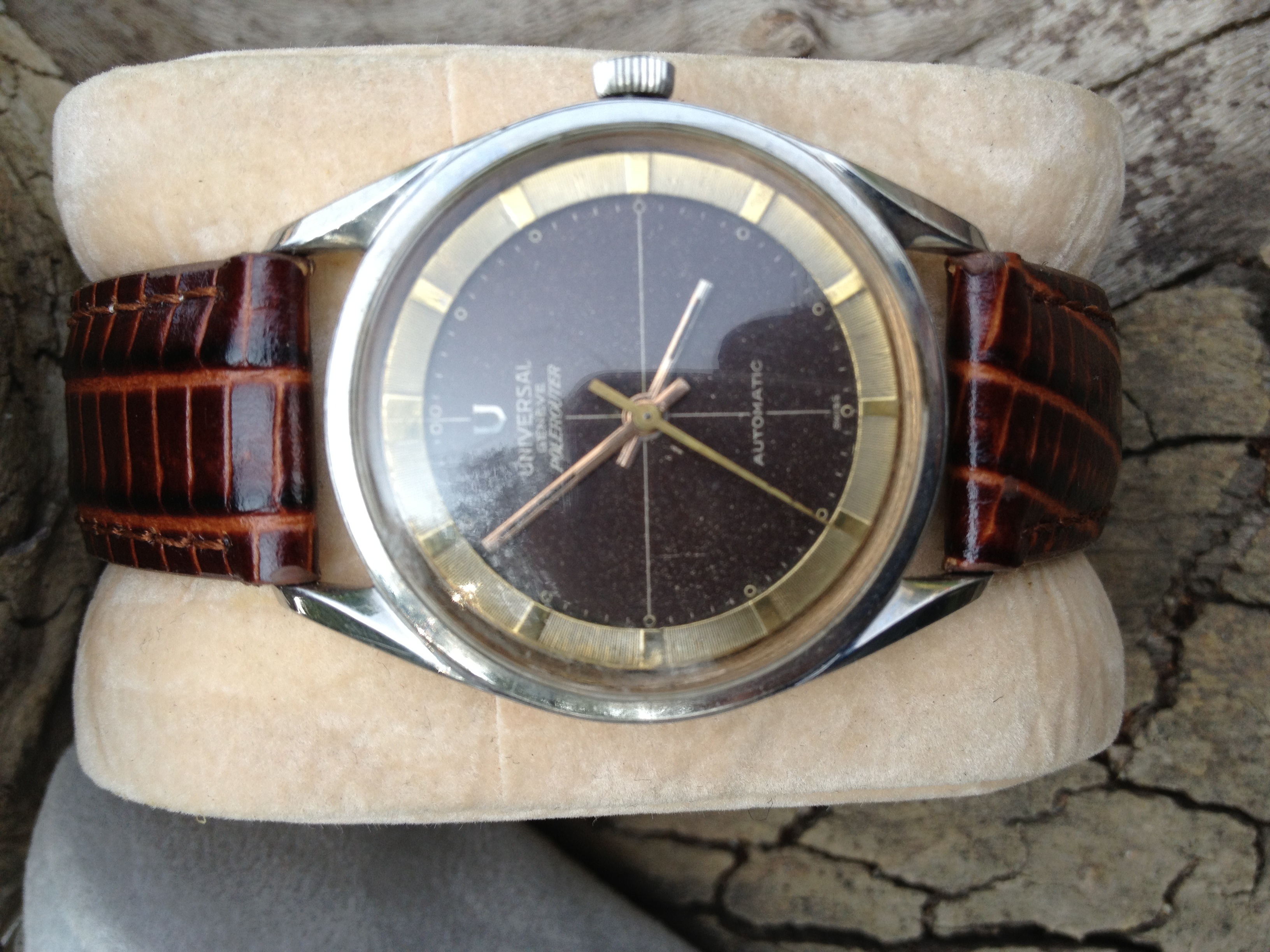

    Seeing this in local website, What do you guys expert in Universal think?
    Is the dial original? The case looks sharp, but what about the movement? What would be the value?

  2. ulackfocus Jun 10, 2013
    25,983
    26,973
    Redial. Wrong fonts. The movement is crappy too - water was definitely in that watch.

  4. CanberraOmega Rabbitohs and Whisky Supporter Jun 11, 2013
    5,570
    6,208
    And it looks like the micro rotor has been scraping the inside of the caseback.
  5. woodwkr2 Jun 12, 2013
    1,366
    819
    Micro rotor scraping the inside of the caseback is, unfortunately, an all too common occurrence. It has to do with two things: 1) the strange anchoring system that universal employed with varying degrees of success and 2) watchmaker's unfamiliarity with these unusual movements and errors in servicing.
    I'd pass on this watch. Looks like it is either a franken with a redial or a (formerly?) badly damaged watch with a redial.

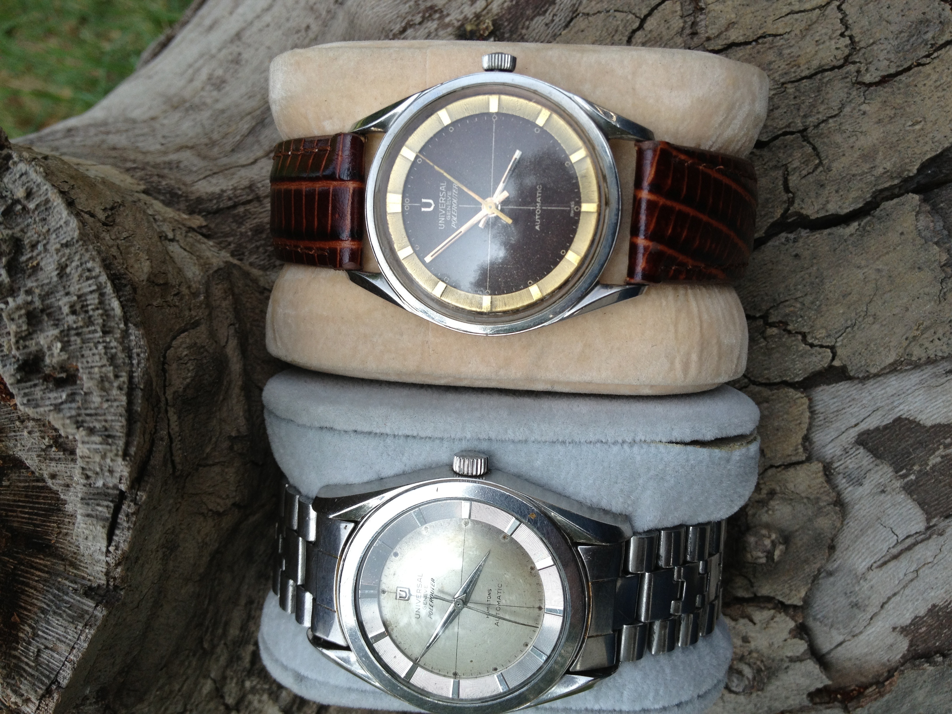

  6. sohail Jun 13, 2013
    445
    155
    Compare the markings regards
