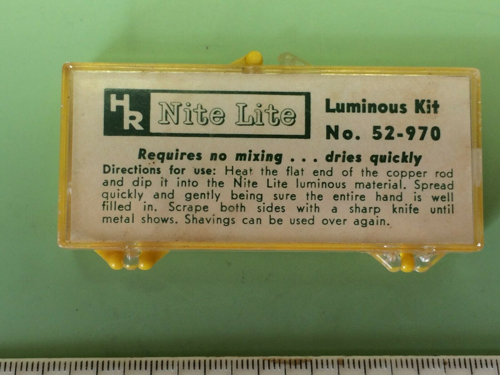

"Nitelite" appears to share its name with a brand of lume from around the time, and you can still find some old kits for sale on the bay (though they're radium, so good luck finding a watchmaker that will touch it, let alone asking what the rules are for sending radium in the post 😗).
Im wondering if "Dubonnet" or "Deep Blue" are also brands of lume from back in the day... I cannot find anything on them as yet.
That could explain the description and visual disparities - perhaps its a compound that reacted to turn blue under UV instead of white/yellow/green??? 👎

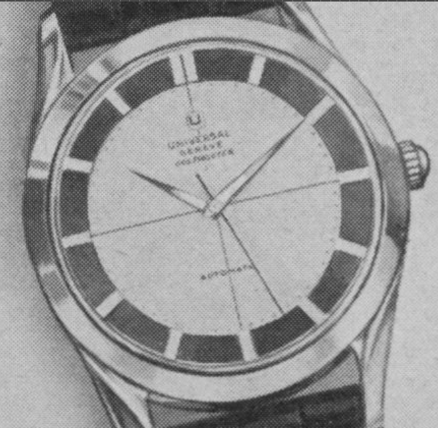

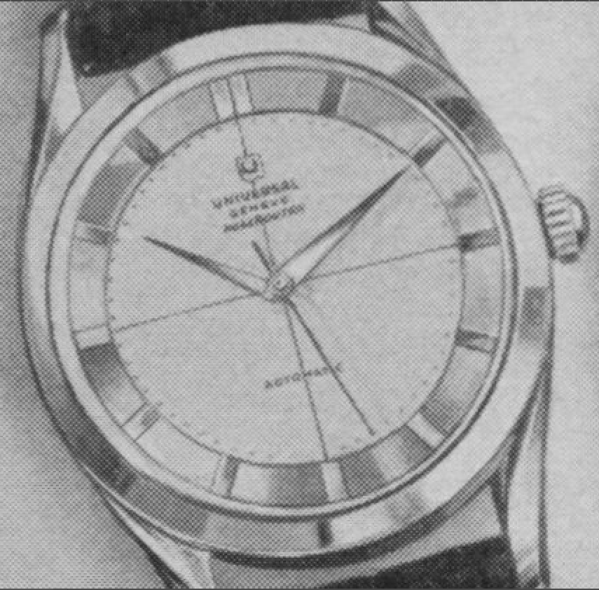

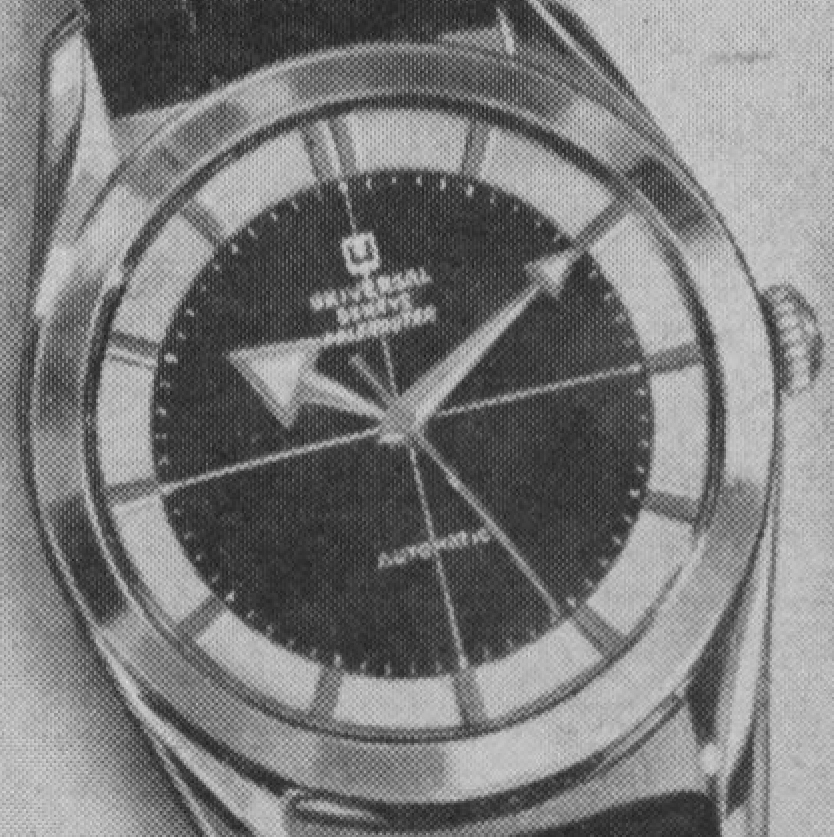

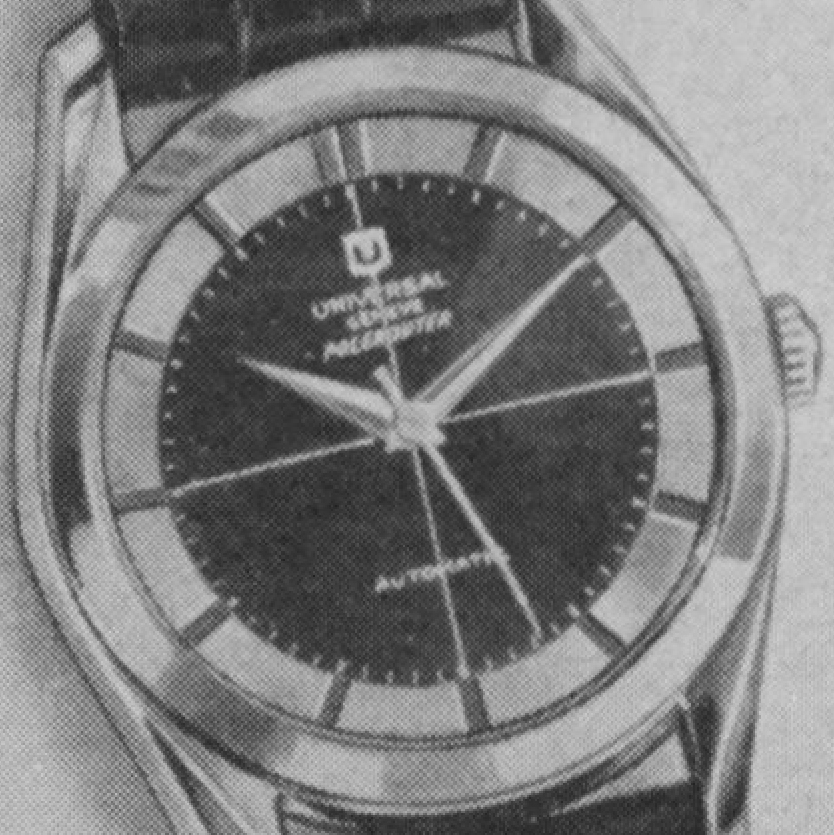

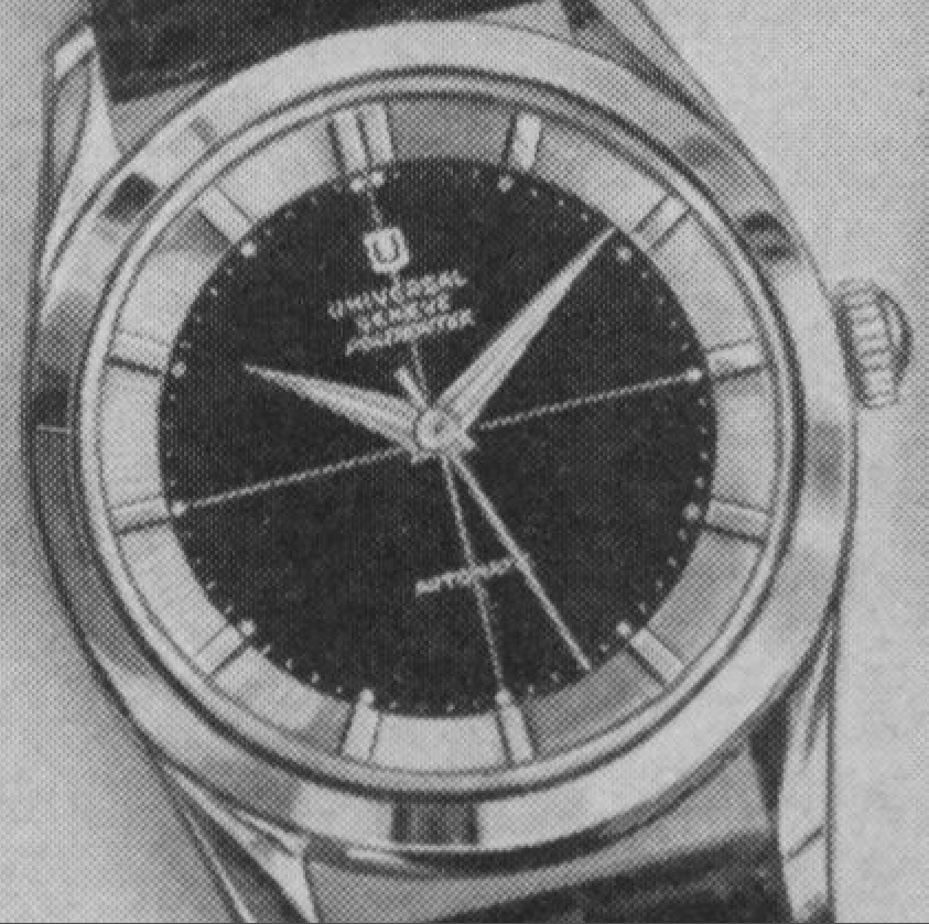

I have obtained a higher resolution scan of the interesting 11-model Polarouter ad from 1956. Many thanks to Vitezi for finding the reference (Chilton's Jewelers Circular/Keystone, Vol. 126, No. 6-12, Mar-Sept 1956, p. 272). This one is sharp enough to show the halftone dots of the actual printed advertisement. Therefore it shows the maximum information that can be gleaned from this ad without being able to see the original artwork used to make the ad, which probably no longer exists. From these images I can say that at least one of the watches says Polarouter, not Polerouter. Also, from the way several of the watch hands appear, I think it is possible that these are drawings of some kind rather than photographs. Here is the new scan:
And here are enlarged details, starting at top left (20214/12). This one clearly says Polerouter:

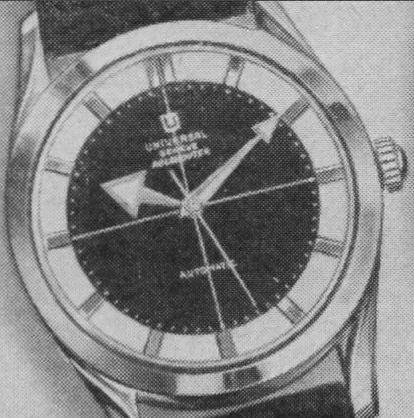

Row 1, Watch 1 (20217-4). Inconclusive, probably Polerouter:

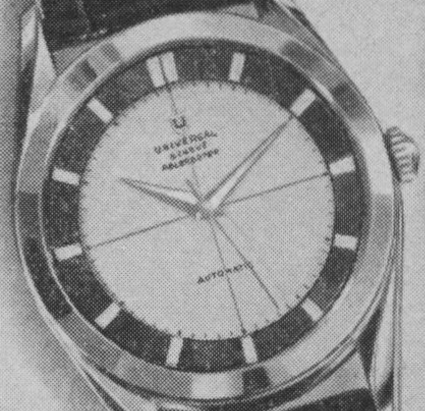

Row 1, Watch 2 (20217-10). Polerouter:

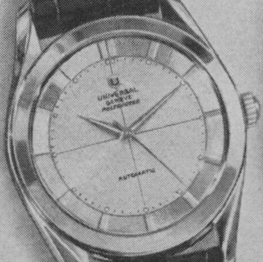

Row 2, Watch 1 (20214-2). Inconclusive, probably Polerouter:

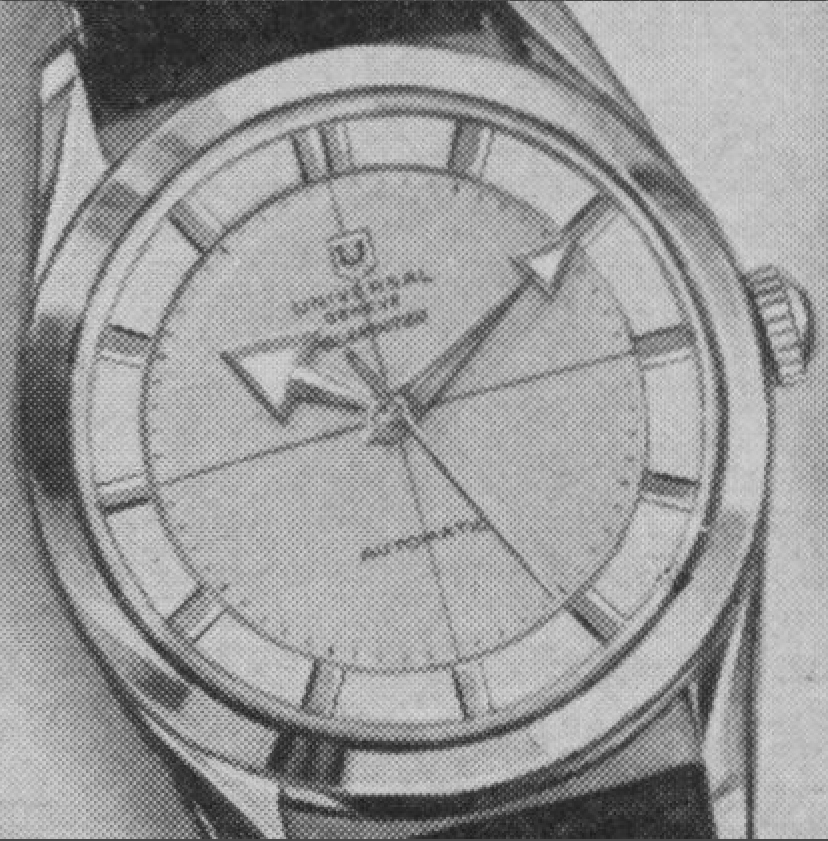

Row 2, Watch 3 (20214-14). Definitely Polarouter. I don't think white broad arrows were ever made, or broad arrow Polarouters:

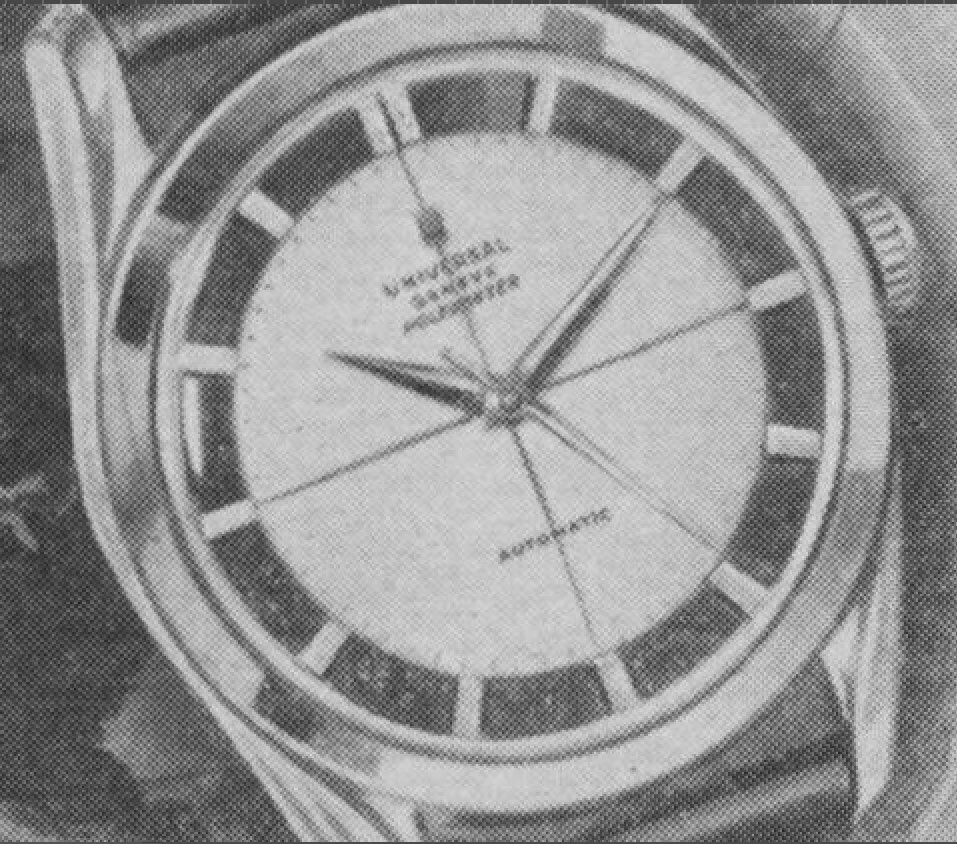

Row 2, Watch 4 (20214-4). Polerouter:

The hands of Row 2, Watch 1 (20214-2); and Row 2, Watch 5 (20214-11) do not look right and make me wonder if these are drawings rather than photographs. I suppose they were still marketing the old name, Polarouter, in 1956 even though they had already shifted to Polerouter to help sell out the old stock. The fact that at least one dial in this ad says Polarouter, while all the others say Polerouter, I suppose argues against my theory that these images are drawings. It seems more likely that UG sent over a bunch of watches with mixed dials to the photographer's studio. The big question is whether any white broad arrows were ever produced, or if any Polarouter broad arrows of any color were produced. I have only seen black broad arrow Polerouters.

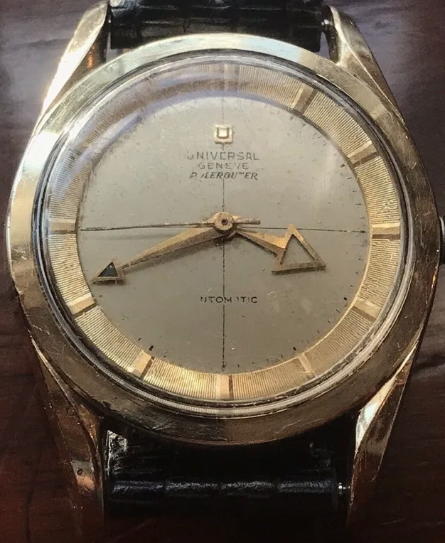

I agree that it does appear that the 20214-14 dial says Polarouter. This would be surprising as to my knowledge we've only ever seen sub-references 1 to 6 in the Polarouter references, 20217 and 20214. This suggests to me that either these are illustrations or perhaps the resolution is still not high enough to discern the difference and we are trying to read too much into it.
I thought the variety in the crown shapes was interesting. No two crowns seem to look exactly the same, which suggests that these are illustrations. I also agree with your observation about the hands in some of the pictures.

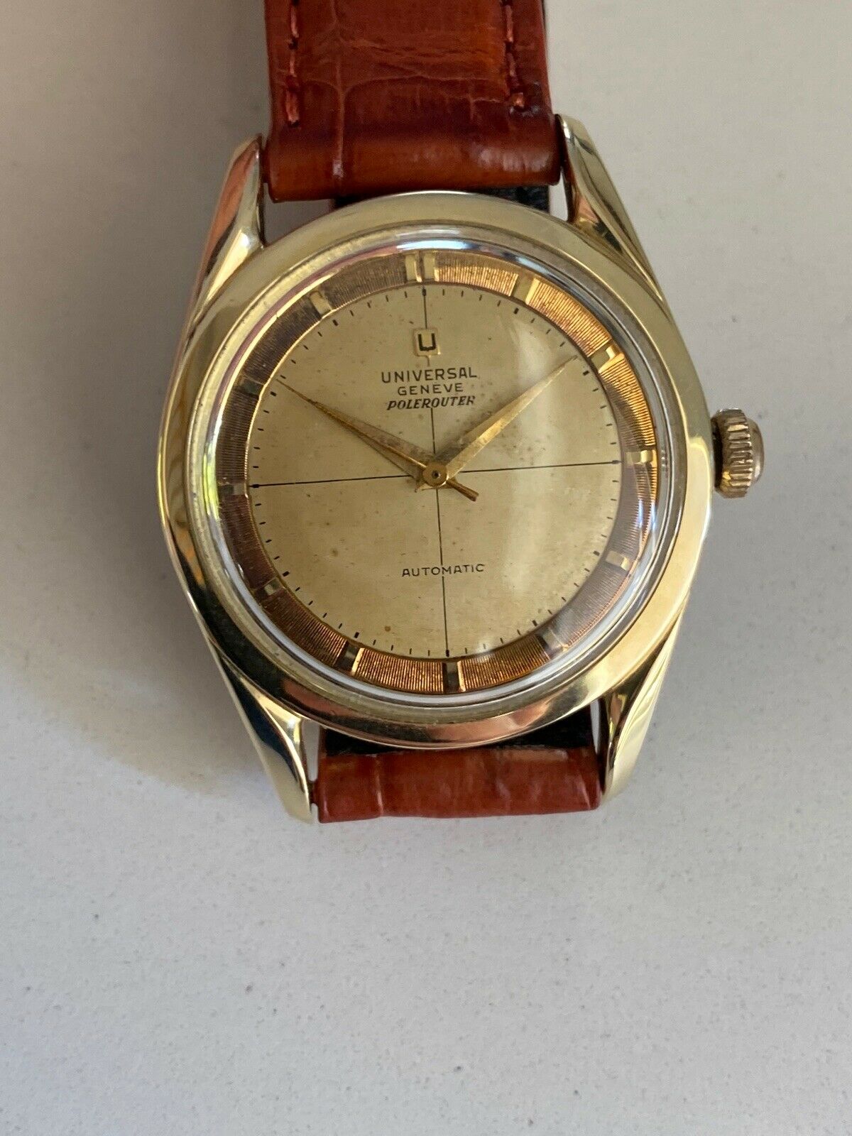

As stated in the advert, the 20214-14 has a golden, rather than a white, dial and these definitely exist. I attach the picture of the 20214-14 from the reference gallery, which I have tucked away in a drawer somewhere. Unfortunately, it is in a sorry state with very little of the original lume and a very scruffy dial. It has an interesting inscription from St Mary's University in San Antonio to the basketball coach, who was the first coach to introduce black athletes to the University.

Interesting. Are there any traces of luminous material on the chapter ring?
1,209
3,069
The only remaining actual lume was the dark green mouldy lume in the minute hand that you can see.
Although we do see Broad Arrows without lume in the ring, my view is that these all started life with fully lumed rings and either the lume has fallen out, the lume was intentionally removed or the ring was replaced.
My plan is to get the S20214-14 relumed. I wouldn't ordinarily make any attempt at restoration of any watch but I felt that the reluming of the ring and hands was completely reversible, unlike the reluming of a dial say.
There are later microtor Broad Arrows with golden dials too. See the 20363-5.
