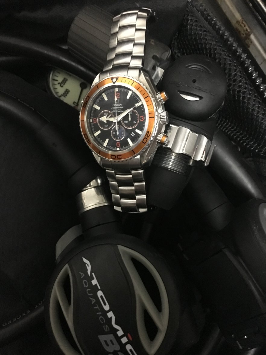

    As the PO chrono has wonderful fake screwdown pushers... (yup you cannot unsee it...)
    So can you use the chrono pushers underwater? The manual makes no reference to this, and the OB gave a not very sure "yes, you can" to this question.
    And obligatory pic.

    Can't see the pic, but yes Omega's Chronodiver watches have pushers that can be used underwater starting with the Seamaster Pro Chronograph 2599.80 in the early 1990s and continuing through to the modern Planet Ocean Chronographs. Its a surprisingly uncommon feature among chronographs really.
    And while the pushers are not screw down, they are screw in, with multiple seals in them:
    [​IMG]
    [​IMG] [​IMG]

    Thanks @dsio you caught me in the 30 seconds I was editing the post to include the pic from my phone!
