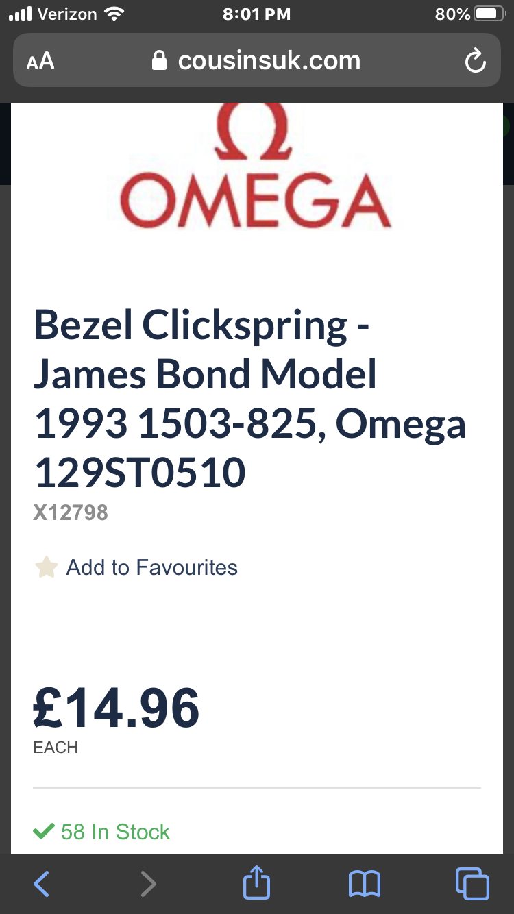

The bezel click spring for this watch is 129ST0510.
Cheers, Al

Thanks Al really appreciate the info. Just had a look and Cousins UK has it in stock
Cheers
JJ

I may need one too. Mine seems to be slipping/rotating with my bezel. It began after a swap. Unless there is a need for adhesive to keep it from spinning.
This will work for a 42mm 2201.50 PO?
42
27
I figured out the issue. The tab that holds it in position sheared off. Crazy diy modding.
so on to cousins it is. Probably order a few considering... as long as it’s the correct part for the 2201.50
5
