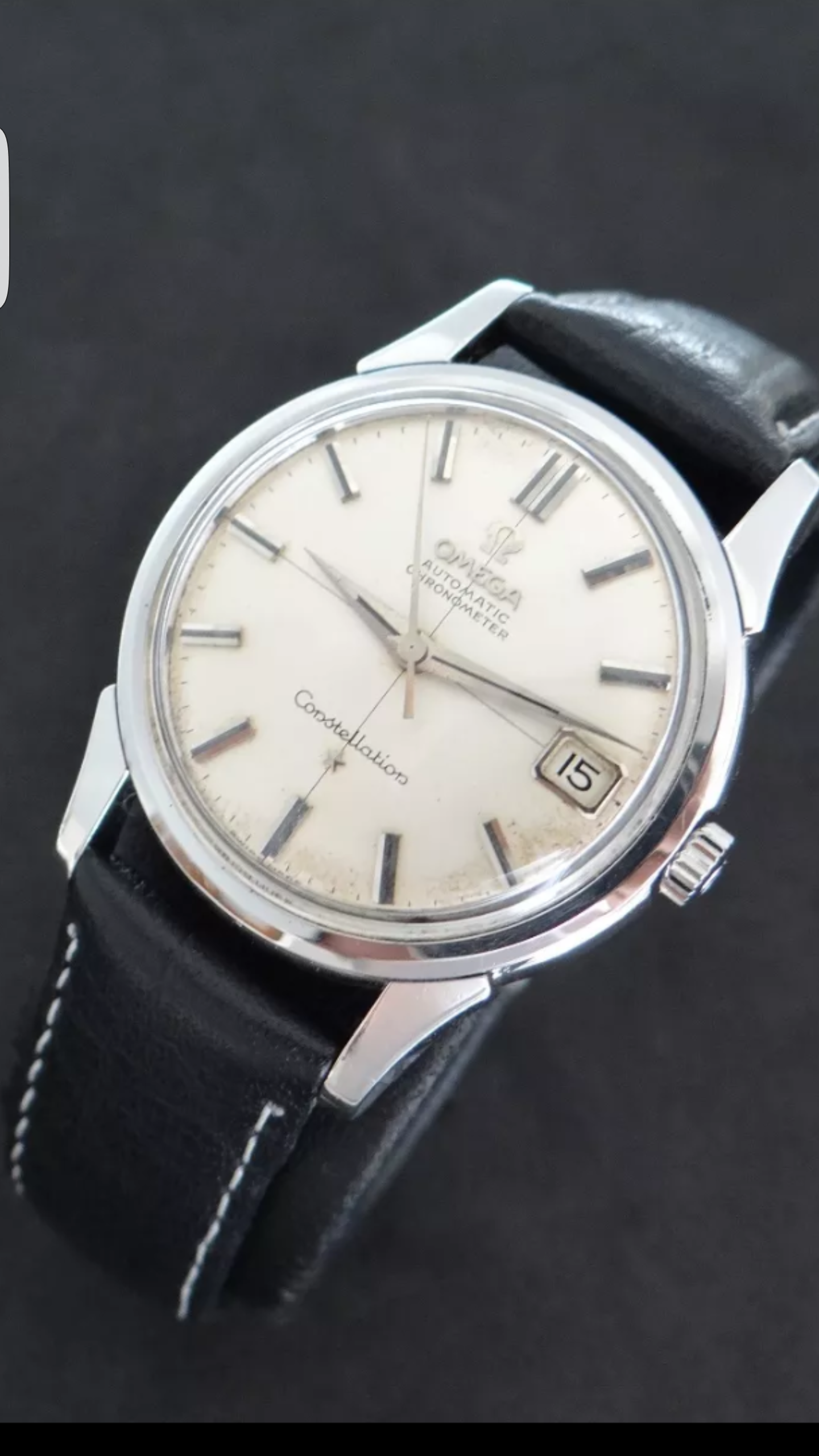

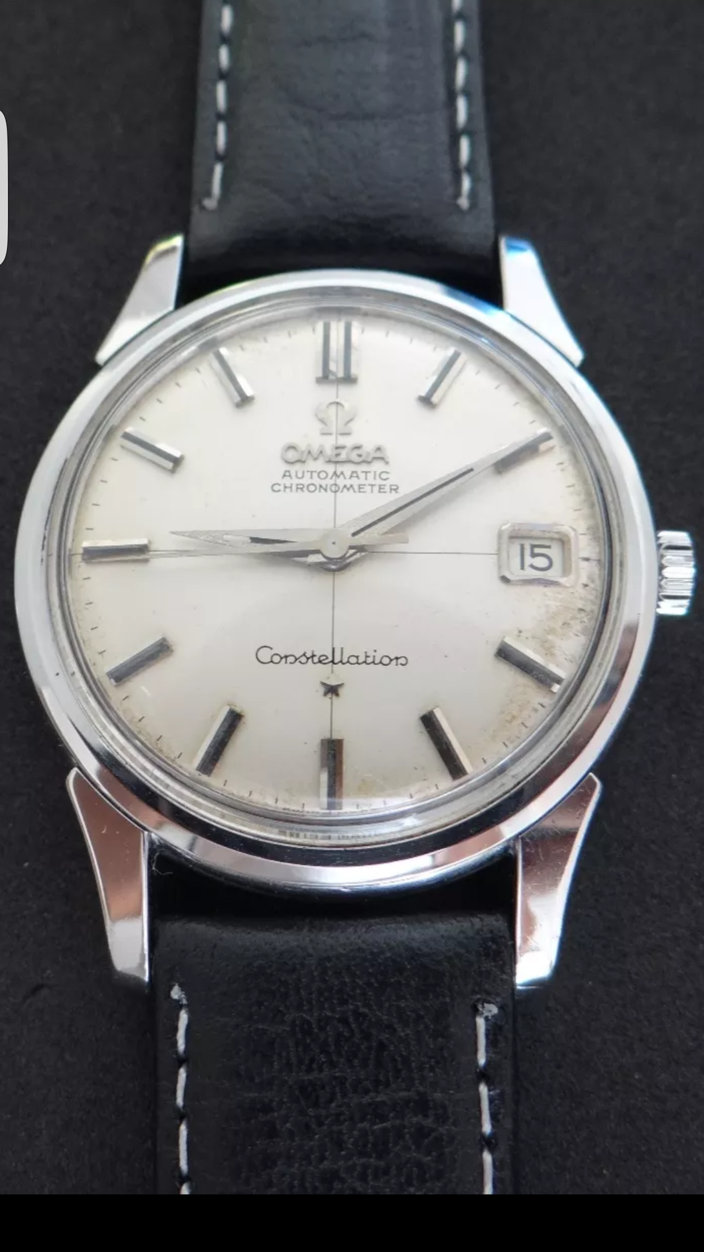

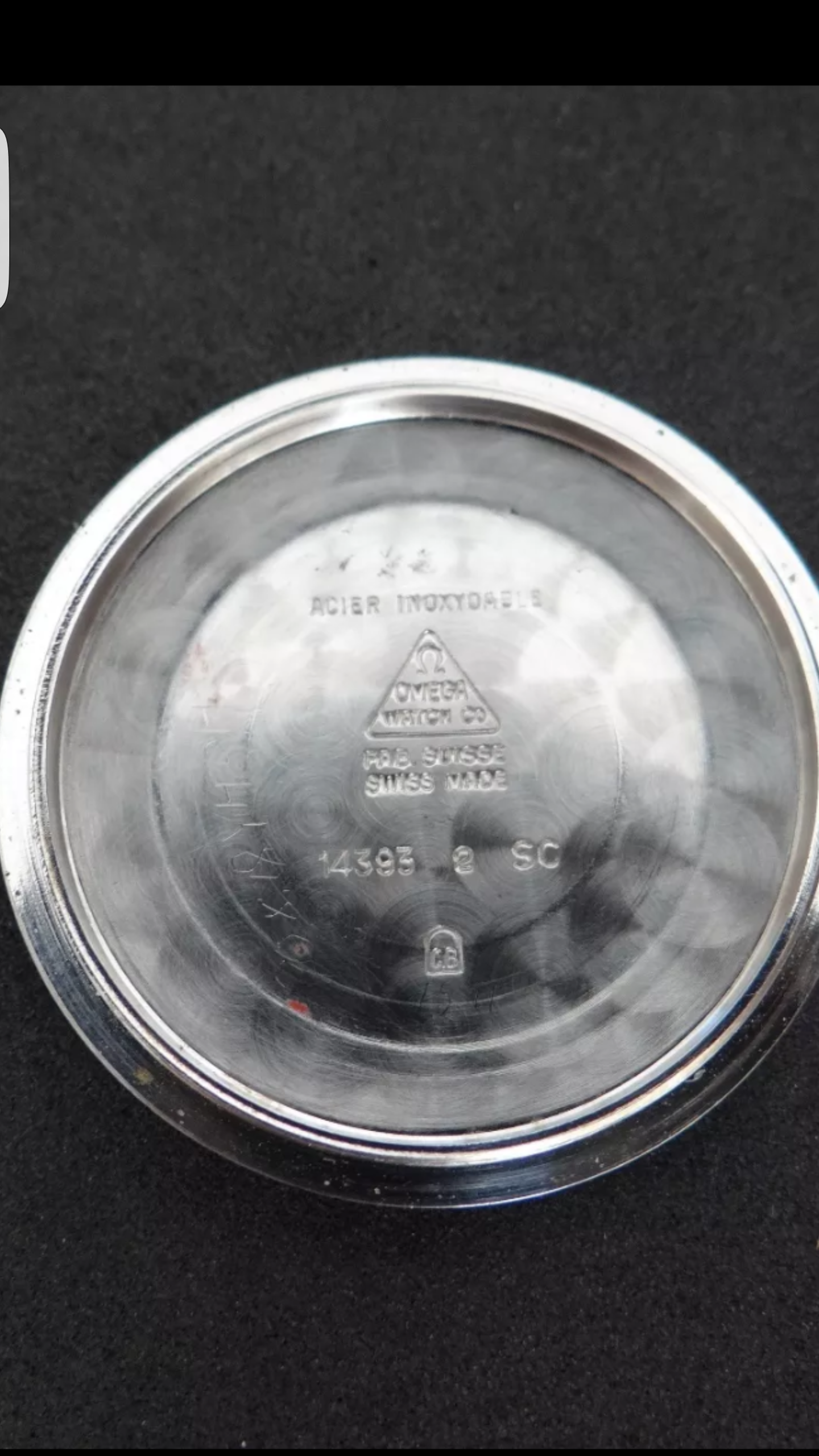

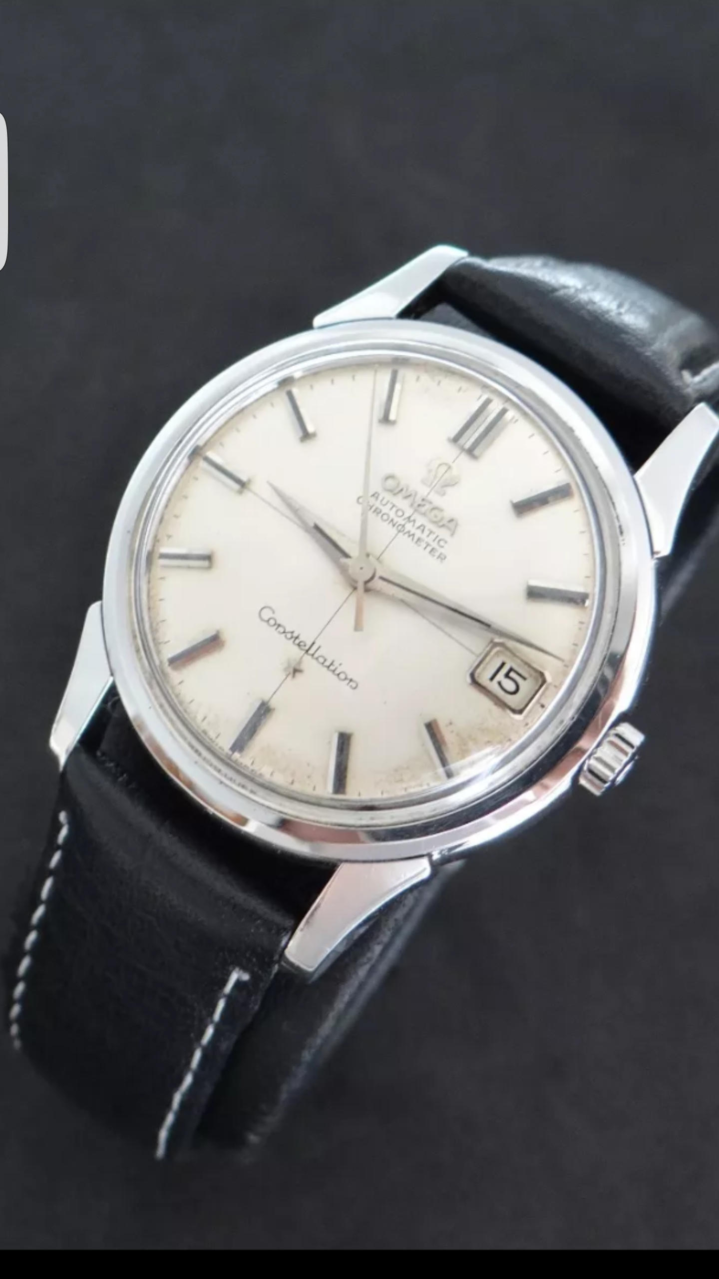

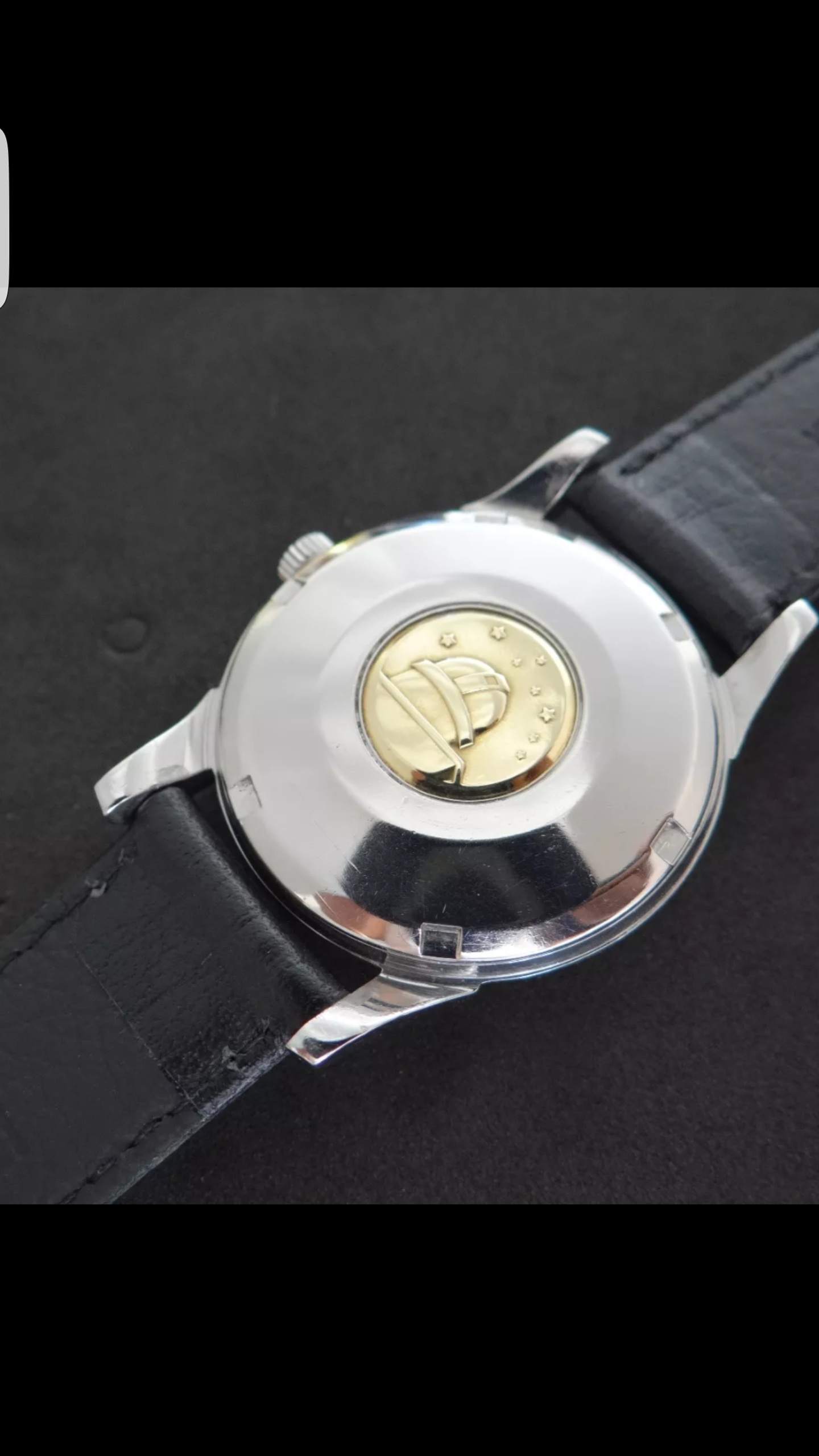

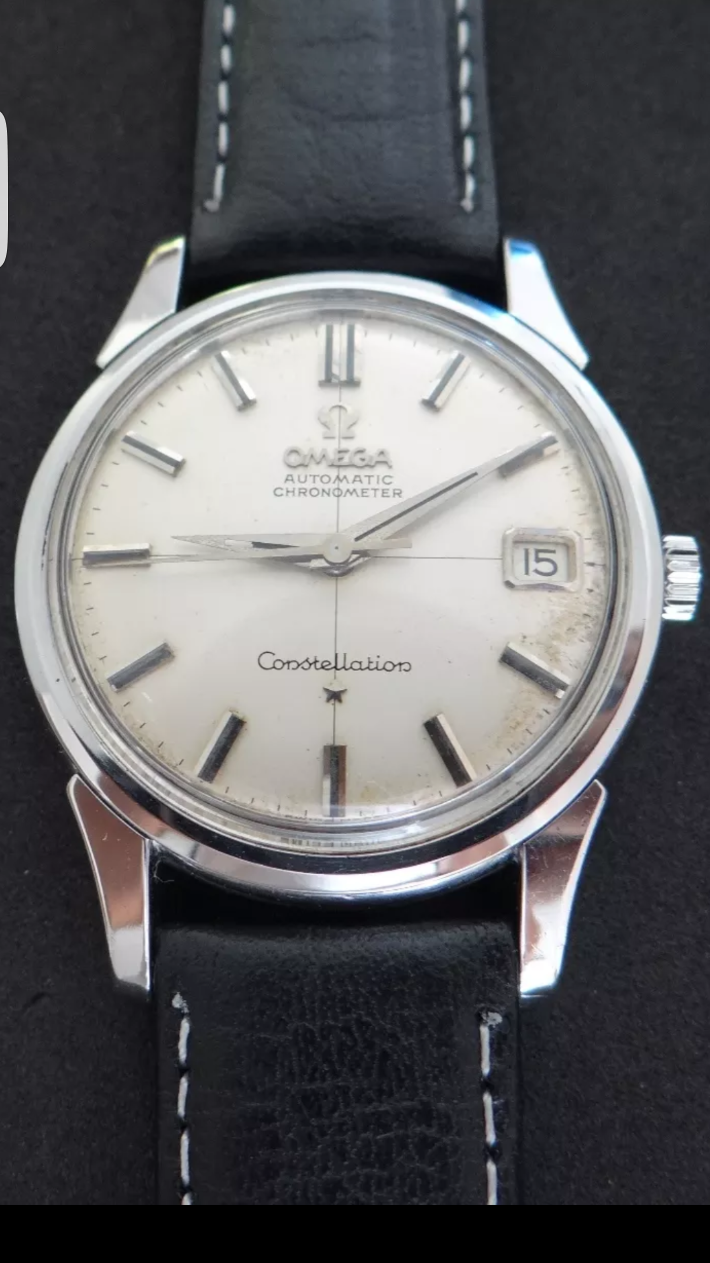

Hi, im new to this forum, and i have found a lot of good information on here which has made me think twice on several omega constellation watches on ebay. I found one that im haveing a hard time distinguishung if its real or fake. Can you guys help me?
I have also seen some omega constelation watches that are enscribed, "T Swiss Made T", are those "T"s suppose to be there?
I appreciate any help.

Hi Fir.
I'm newish but I'm going to try to answer this for you because the older crankier dudes are tiring of people showing up for info-
ne'er to be seen again.
The mods may move this, you should have started a thread in Vintage. This thread is for known fakes and fraudsters.

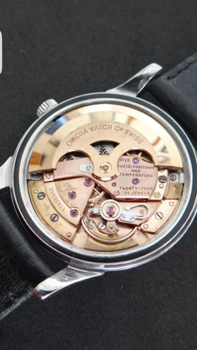

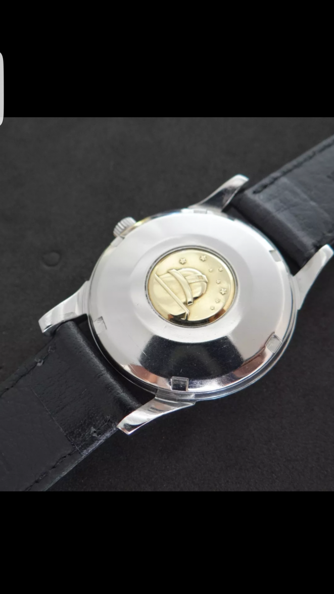

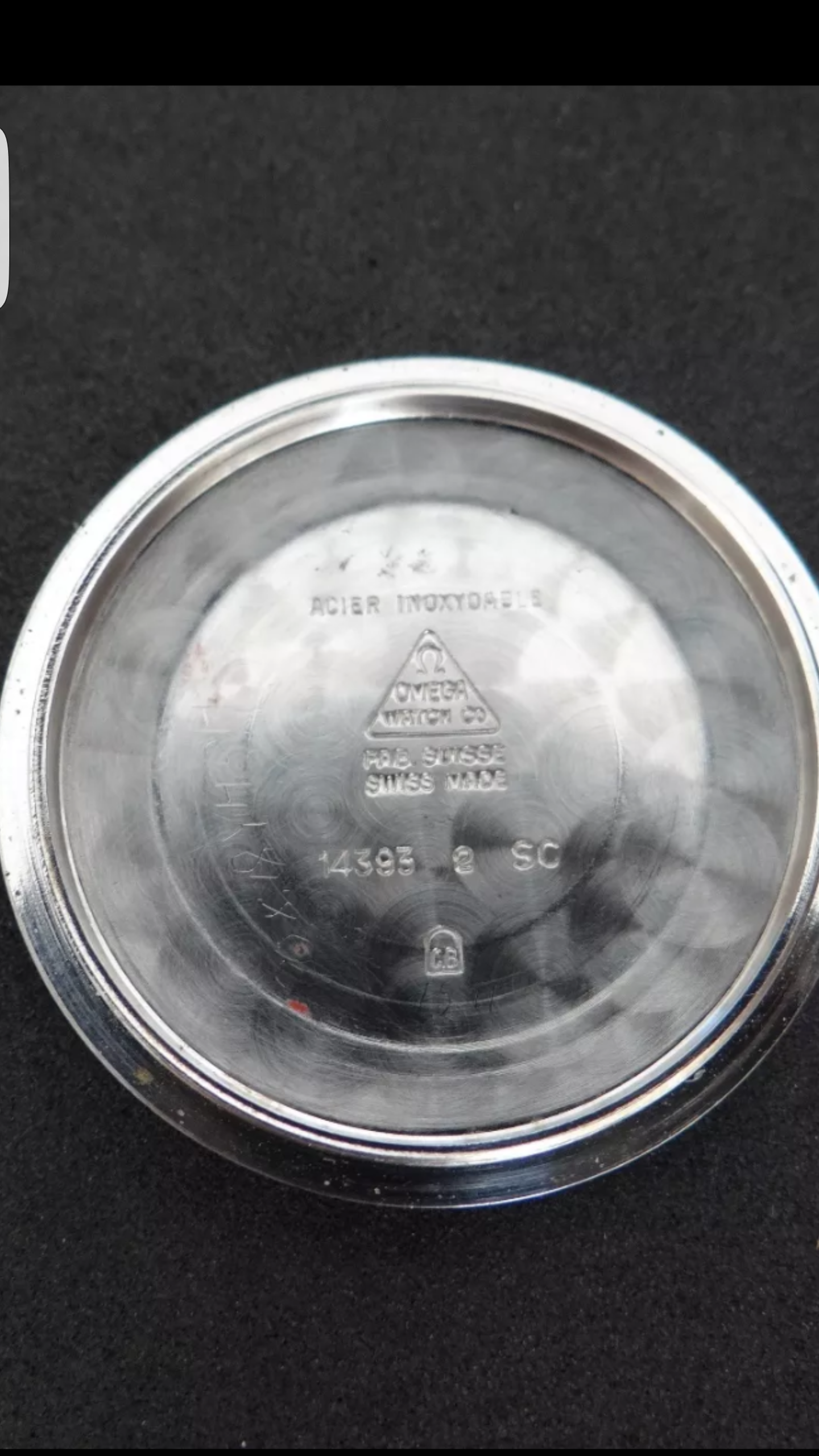

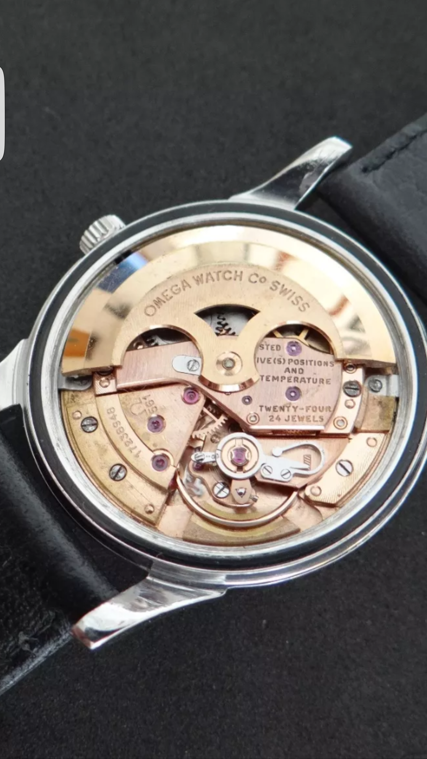

T signifies Tritium, or lume which you don't have on your dial. You example has onyx markers and matching hands. The dial looks OK to me, but dirty. wrong crown. The movement caliber is correct but may have some surprises lurking, multiple screw heads are rusted out and quite a bit of residue, as well as deviation of colors on the movement indicating over polishing or tampering. The inside of your caseback shows the reference number, the SC signifies center seconds, the seconds hand is in the center rather than in a sub-dial.
Stick around and you can find everything you need with the search function here and on Google search to educate yourself.
Welcome

Rman,
Thank you for all the advice. I really do apreciate your response. Im just starting my omega collection and i could use all the advise. I really dont want to get stuck with a fake.
Thanks again

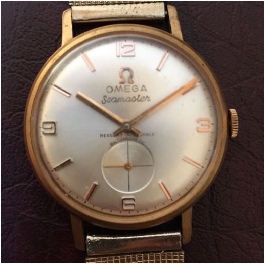

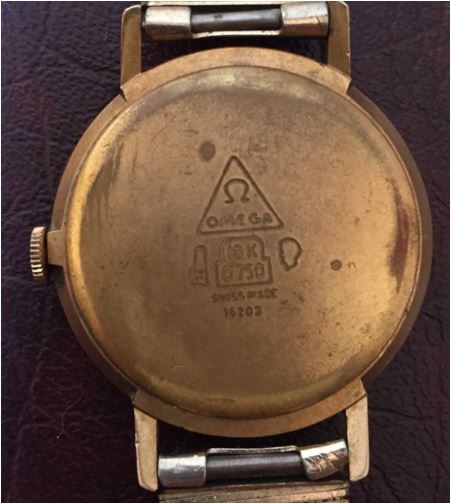

1,872
1,405

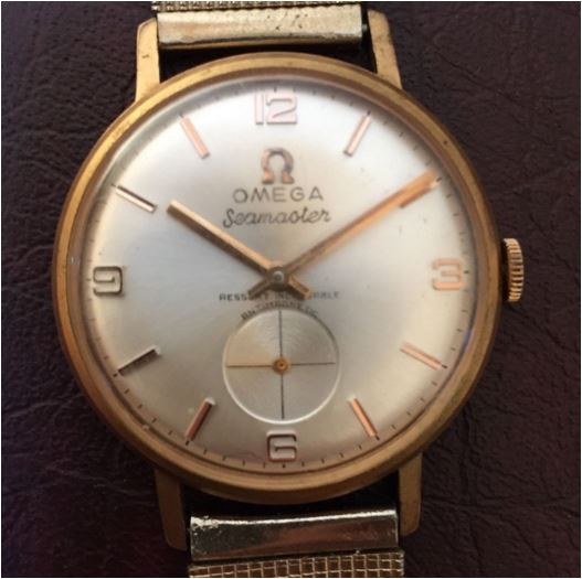

It's a Turler, so hands are okay. 😁
Just wanted to confirm, as I've seen tons of Turler Omegas but never one with that particular text and hands. I guess the parts bin specials go WAY back......
