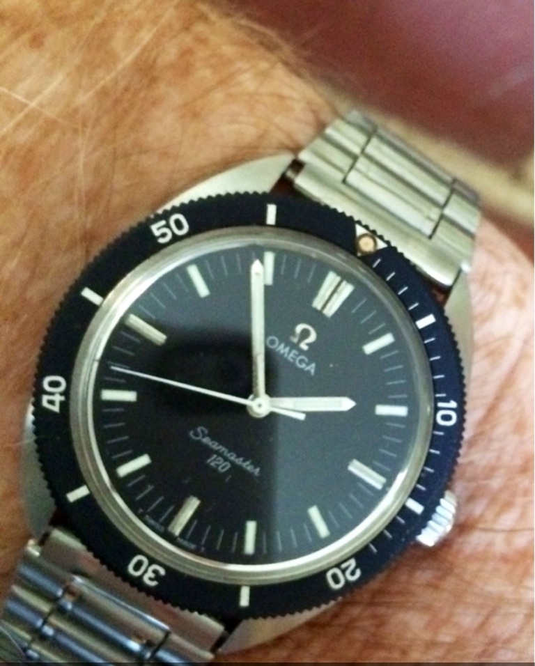

    what do you think about the font on the Seamaster dial ? "120" ?
  7. peatnick Dec 31, 2015
    2,484
    22,874
    Dial on 120 look ok, here's my 135.027 to compare
  8. Jacek Dec 31, 2015
    16
    i ask the seller, the hands are gold color...
    I'm afraid that the dial is relumed or repainted

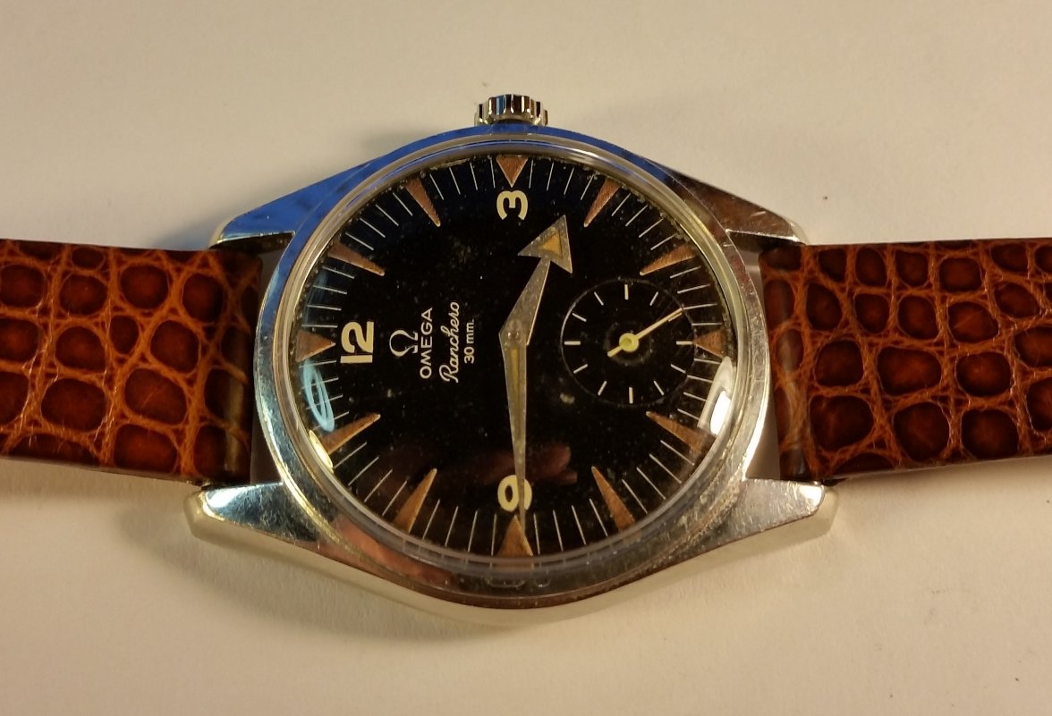

    The Ranchero 1 dial doesn't look correct (compared with my own and other web images) and the second, black looks to have been repainted.
  10. redpcar Dec 31, 2015
    3,669
    7,725
    Huge RED FLAGS on the Rancheros. Redials or replacements from aftermarket. Hands are wrong (and ugly). Not even sure about the cases. Stay away unless they can be purchased for the value of the movements. They are anything but authentic.
    I would be very wary of the seller.......
    There are plenty of very nice original Rancheros pictured on this site. Search for them. Here is a pic of mine for your reference.
