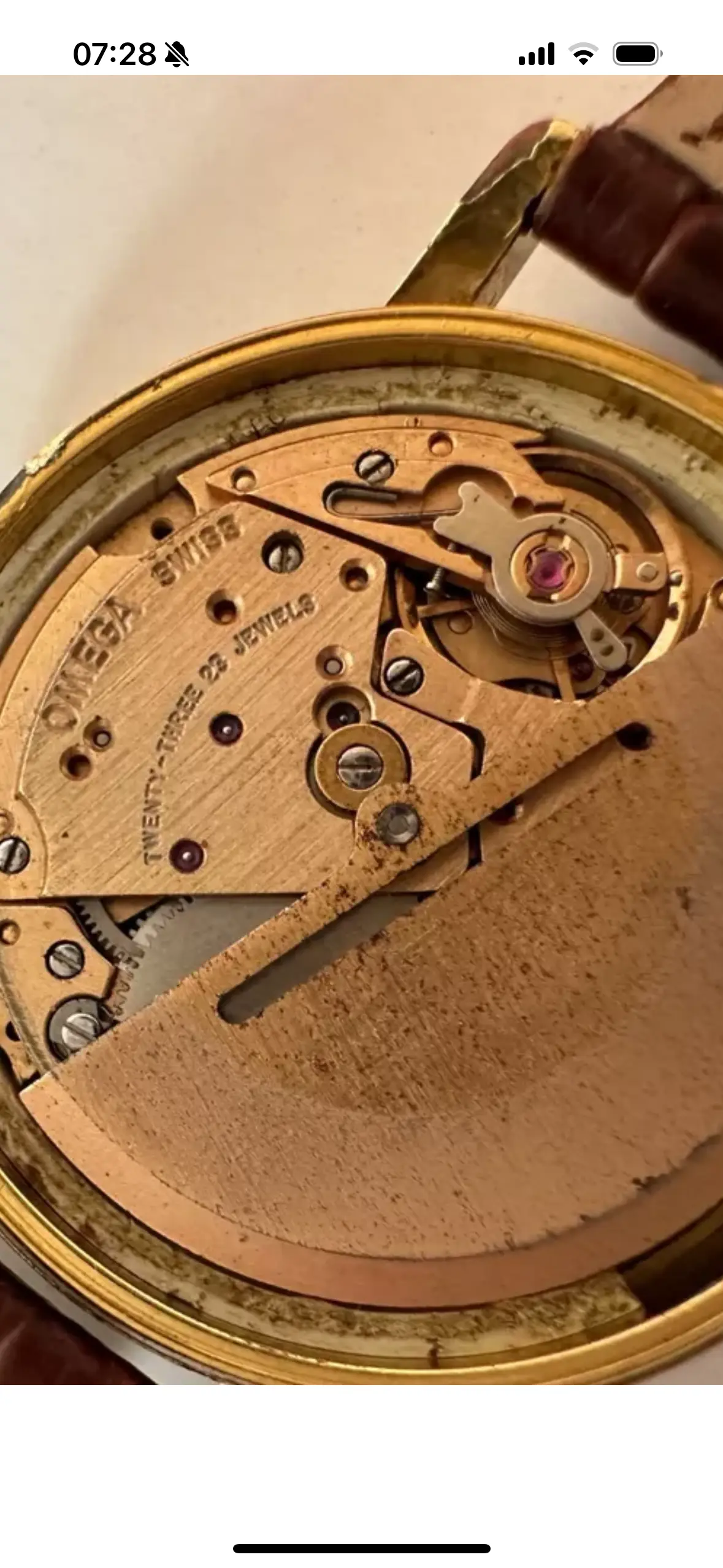

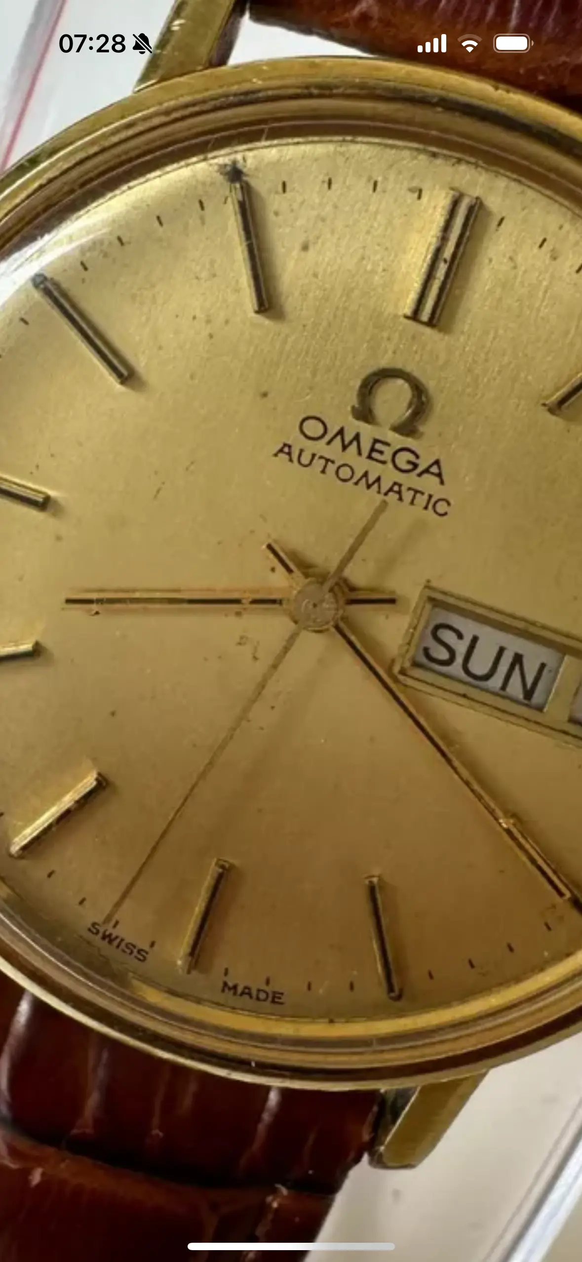

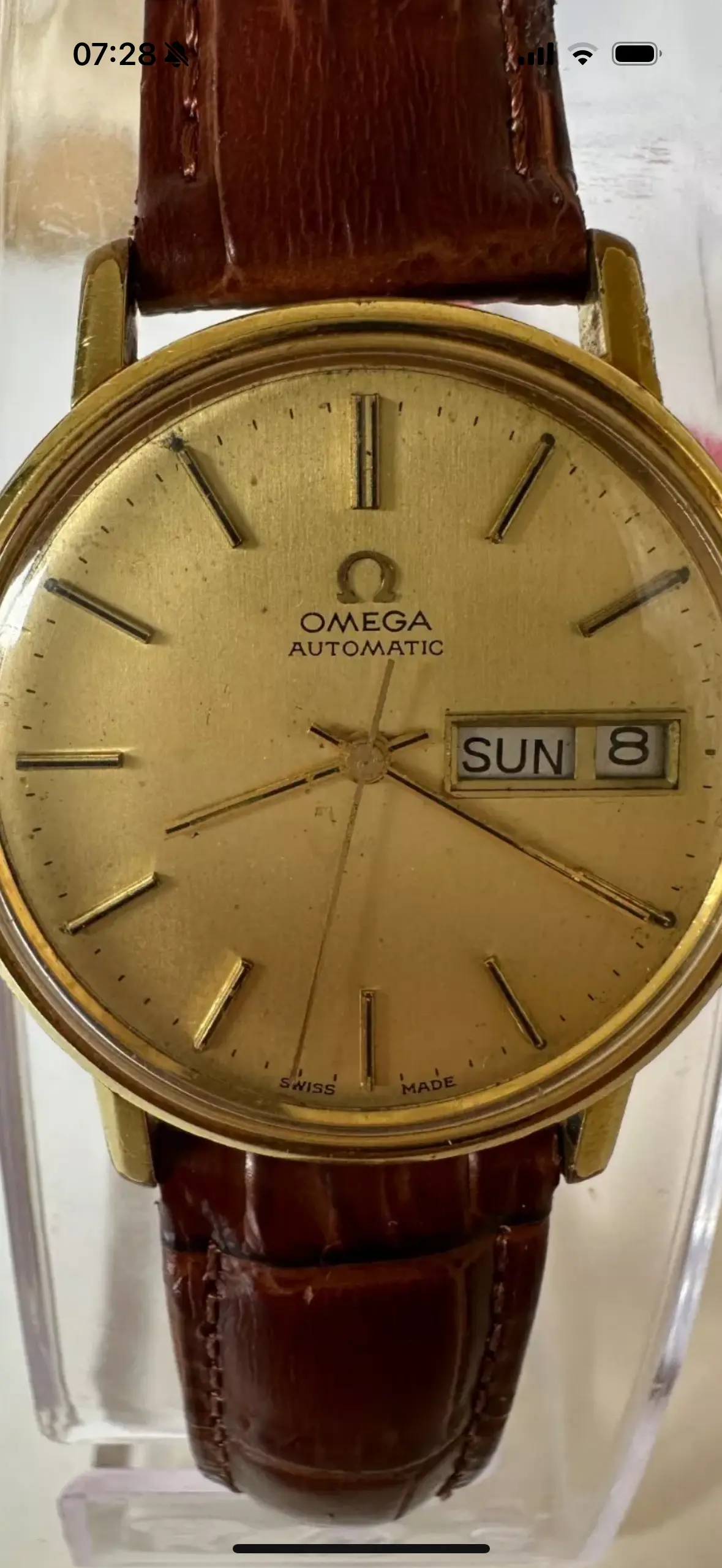

Hey! I’m learning so much here and think I’m starting to identify the right things, would love to check that with you!

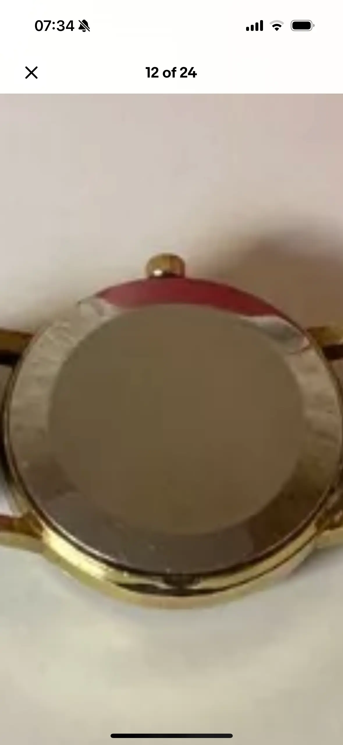

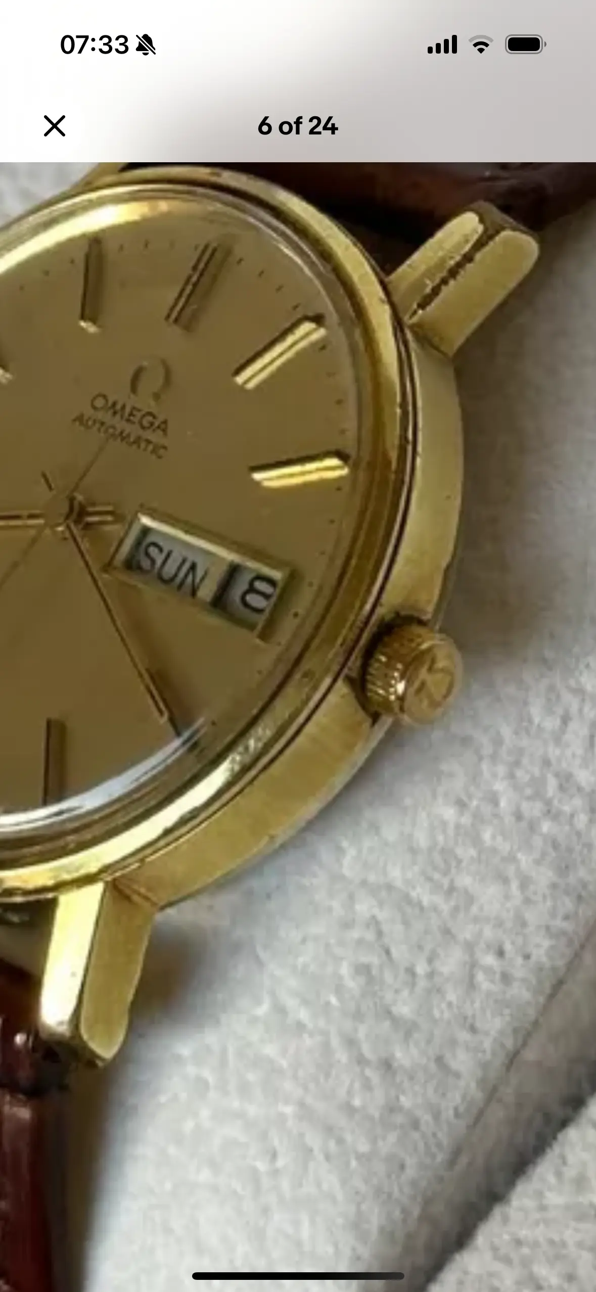

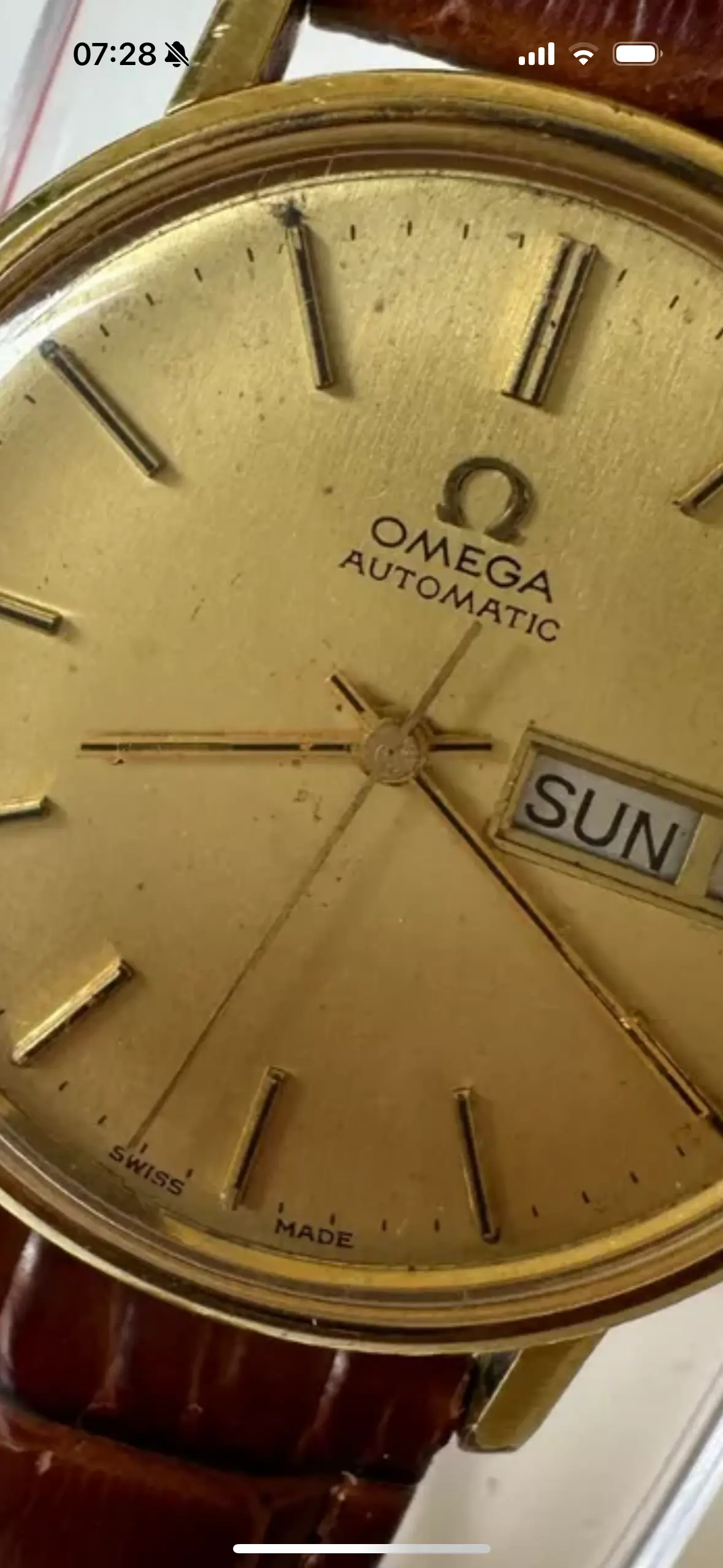

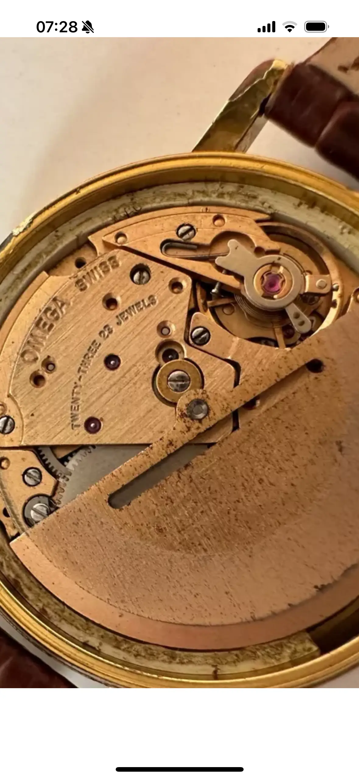

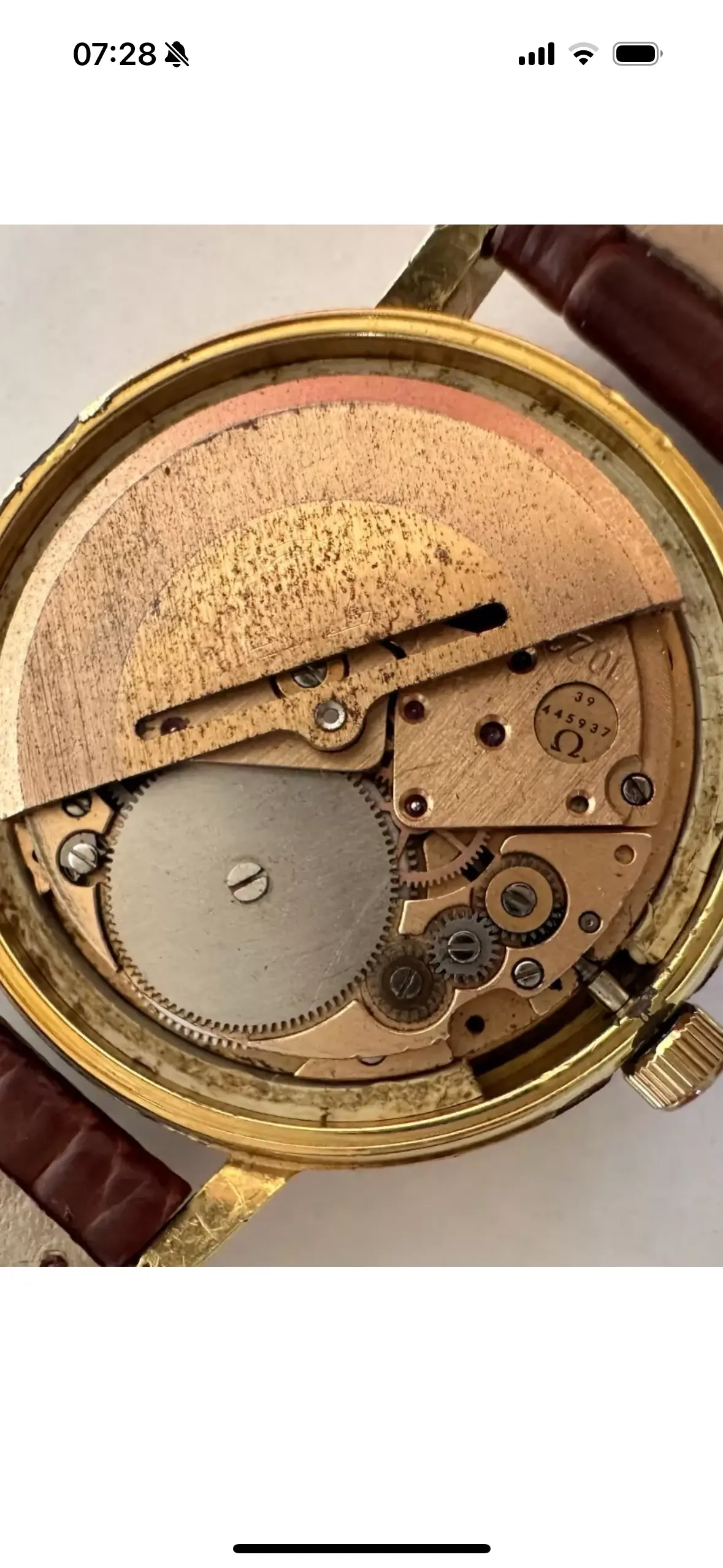

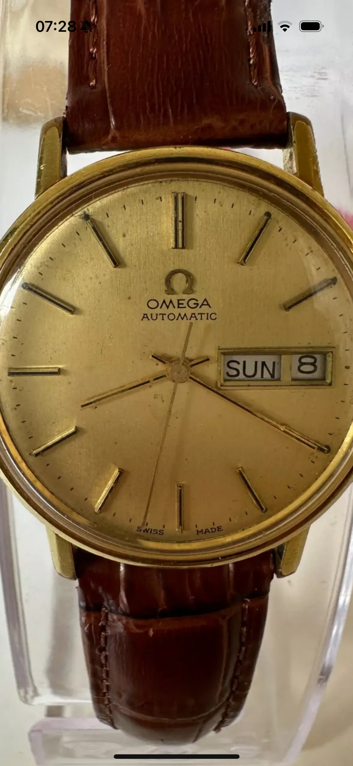

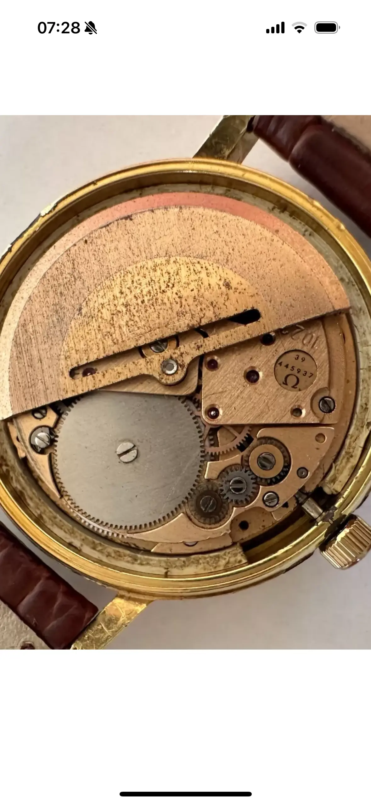

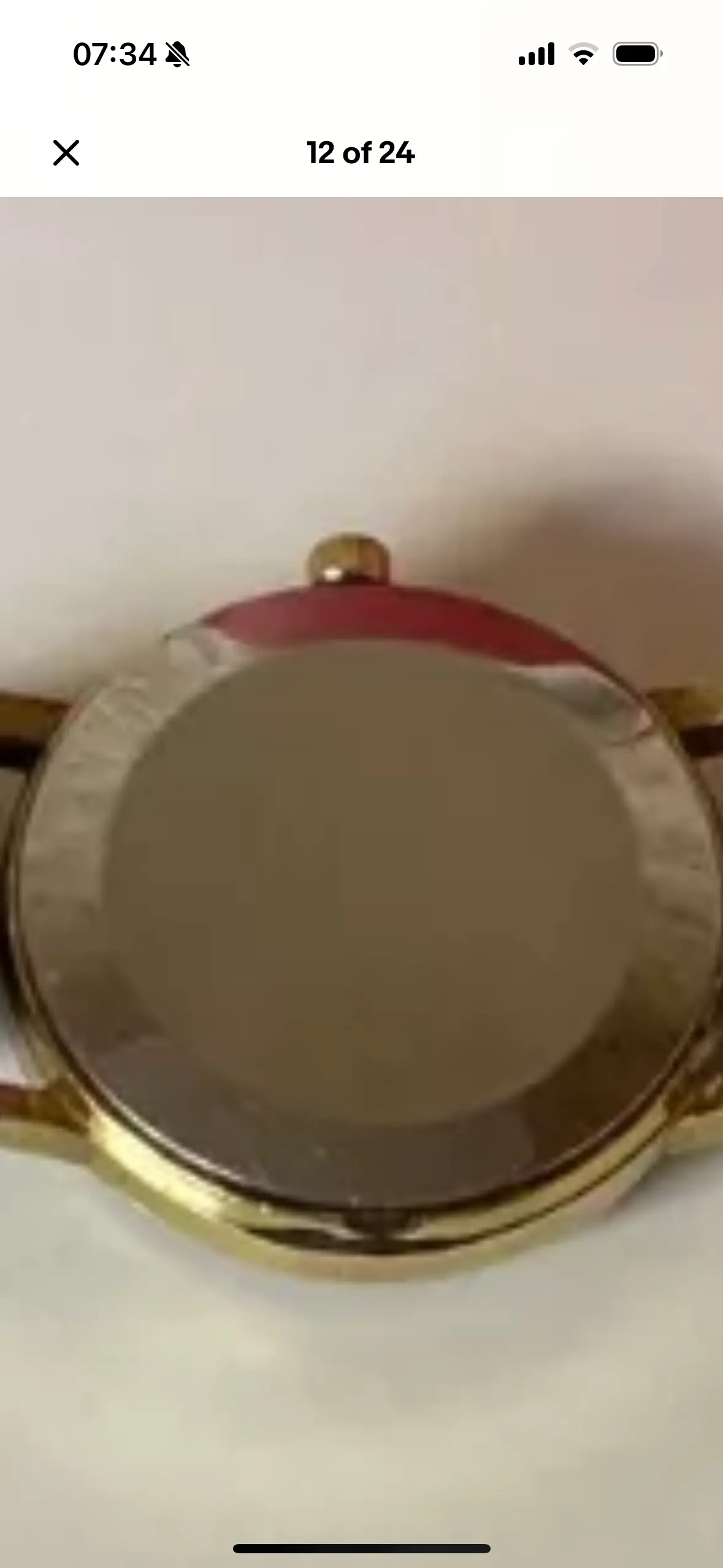

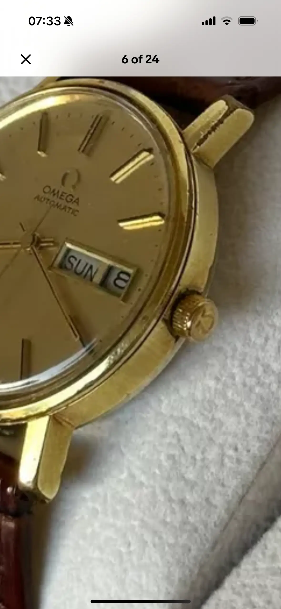

To me - the hands look correct, the face looks patinad and unpainted, the Swiss Made looks a little far apart? But the hour markers look correct. I’m not detailed enough for the crown yet. In terms of the parts in the movement - the main wheel looks like a replacement? And there is no seamaster logo on the case back
Would welcome your thoughts on my knowledge and the watch

Th dial May wel be original but frankly it’s irrelevant. The overriding issue with this watch is the condition, especially the case and movement. The case is toast as the gold plate has worn away and isn’t really economical to repair on a watch such as this, especially in this condition. The movement is rough, the dial has marks. There are no real redeeming features.
