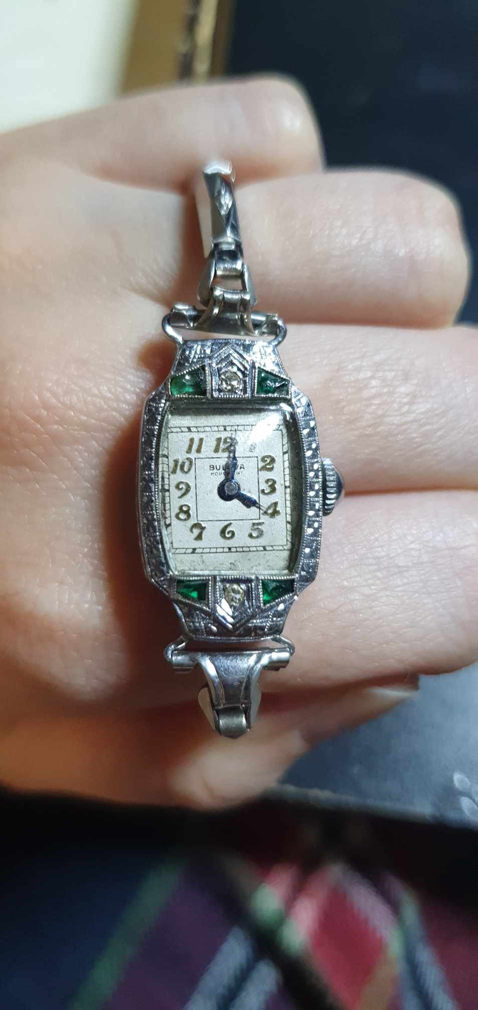

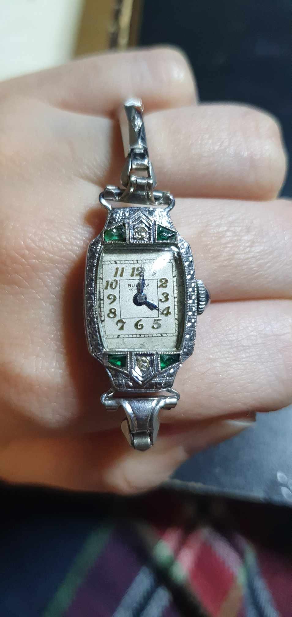

Please help with this art deco ladies Bulova watch!
My 93 yo neighbor gave it to me, can't remember too much about it. Bulova support has no vintage records from the era. MyBulova doesn't have it in their catalog. Reverse image search found nothing. Reddit threads have come up empty. Watchophilia either. But the design is very similar to others from the period.
I'm starting to believe I can't find any info because it's not legitimate, based on some info from watchophilia.

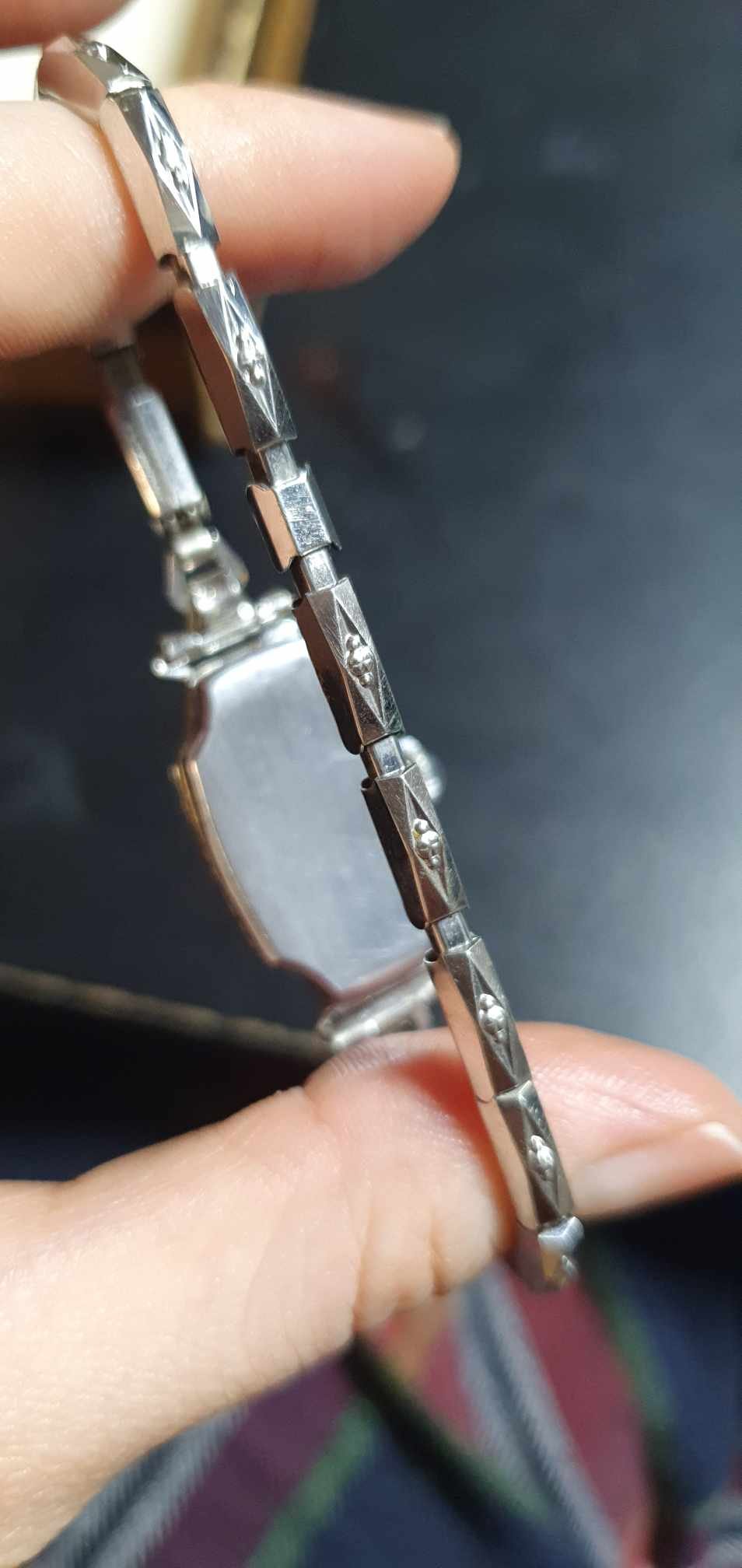

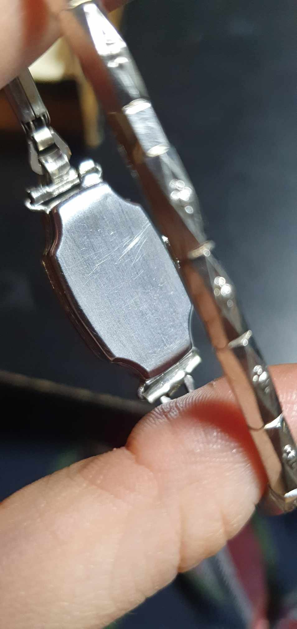

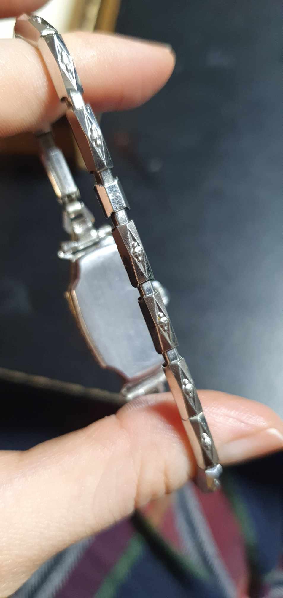

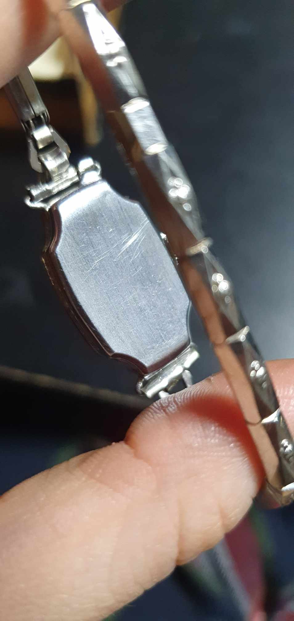

1- no marking on the case. The only marking is Kreisler USA on the band. From research I do believe the two companies did have a supply relationship, though.
2- the shape of the border around the numbers does not match the shape of the case. Square border on case with rounded sides.
3- we're in NYC, Bulova homeland, so perhaps there was a market saturated with counterfiets at the time.
Do you think the lack of marking is just due to practices at the time?
If you believe it's not legitimate, do you still think it's worth cleaning and repairing? I think she's so pretty.
Any idea what you think the metal used is? I can't tell if the green are true stones or glass.
Thanks either way, it's cool to see everyone's watches here! If you happen to know any vintage Bulova enthusiasts who wouldn't mind their contact info shared, I will gladly reach out to them! Thanks and be well 😁

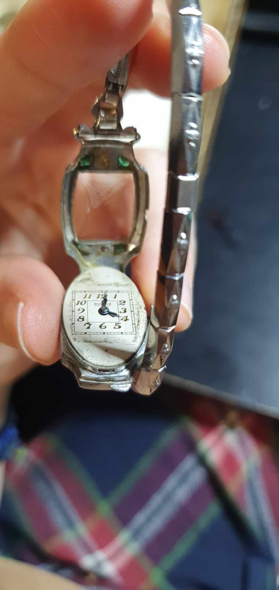

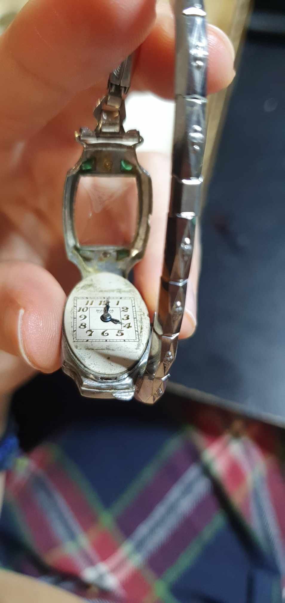

If you gently apply upward pressure to the crown and wiggle it a bit the movement should separate from the back and the information on the inside of the case back and on the movement may reveal all.
13,636
18,994
The dial says “Bulova Movement”. This means that the dial and probably the case are aftermarket. That would explain why you can’t find the watch in any Bulova catalog.
This was done a lot during WWII, as replacement parts for civilian watches dried up due to wartime needs.
The movement should have a symbol or date code that will tell us when it was produced. If it really is a Bulova, or course. You see, these replacement cases were of standard sizes and could have fit many different branded movements that used the same sizes.
You’ll need to get to a watchmaker to take it all apart for you.

Edit - I think @bobbee may be right about the case. Looks like the Rita to me also. However, the dial and hands are replacements. For a watch like this, that is a very minor matter
